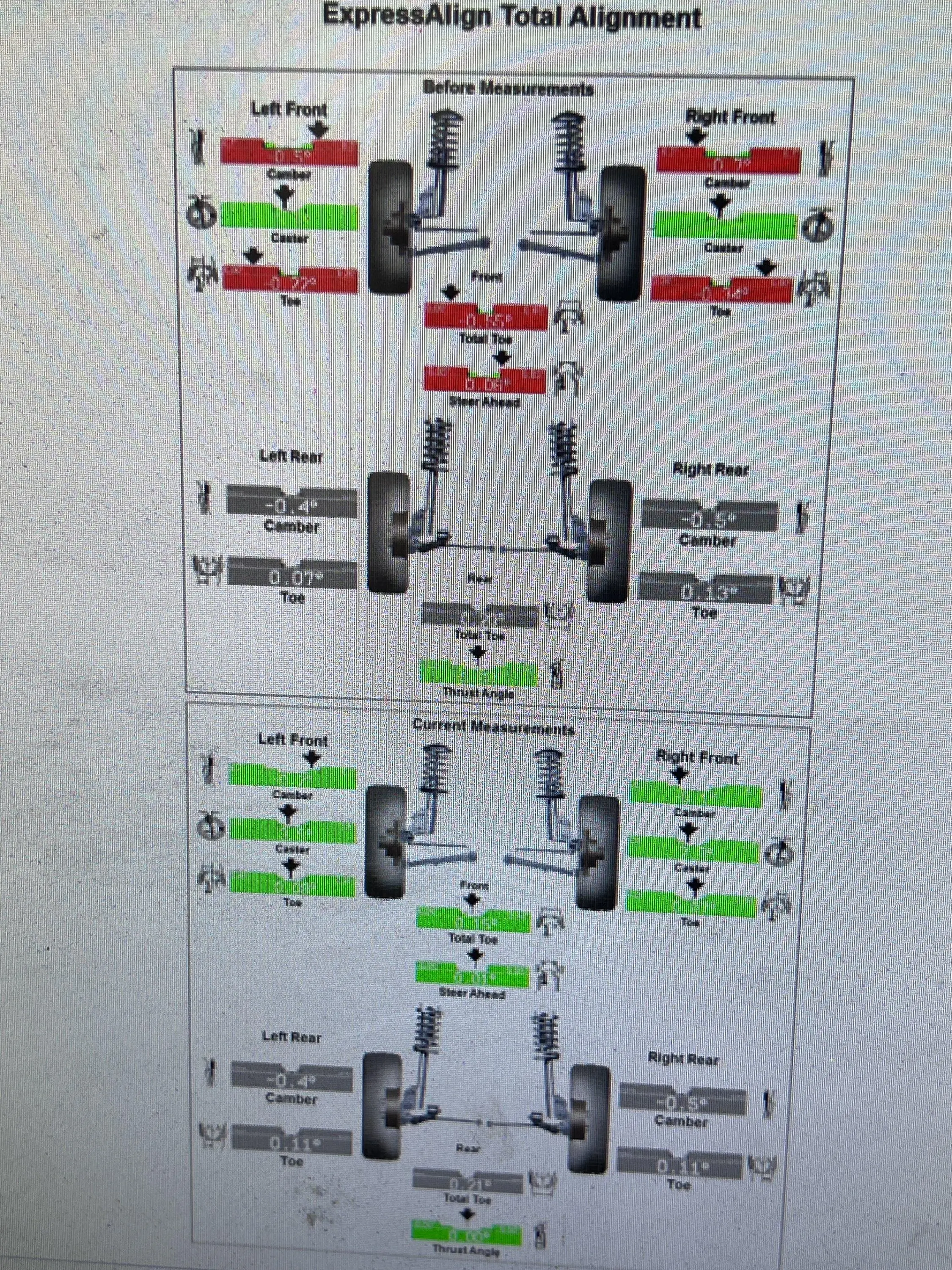

Uneven, inside wear on both front tires - alignment?

Probably right about the bumper + winch leading to alignment issue.
Why have you realigned 4 times? Is that 4 separate weight changes?
Winch and leveling kit, then suspension lift and UCAs, then 37" tires, then aftermarket tierods.

Why have your tires not been rotated? This should have been caught when they were rotated many miles ago.
I am with this guy! Also check you didn't tweak a tie rod. Now its time for new tires and an alignment.

OP, I am not sure if you are aware, but Discount Tire will rotate your tires for free. If you ask them to take a glance at the tread wear they will even give you a headsup if they see something funny.

Well, alignment looks fixed! Thanks all.
Ford Bronco Uneven, inside wear on both front tires - alignment? IMG_3177

You get new tires? It's not worth driving around on cupped tires, handling will be crap.
Fresh Goodyears rotated in with the back pair which were still ok, then alignment done. Will probably end up with KO2’s or something later
