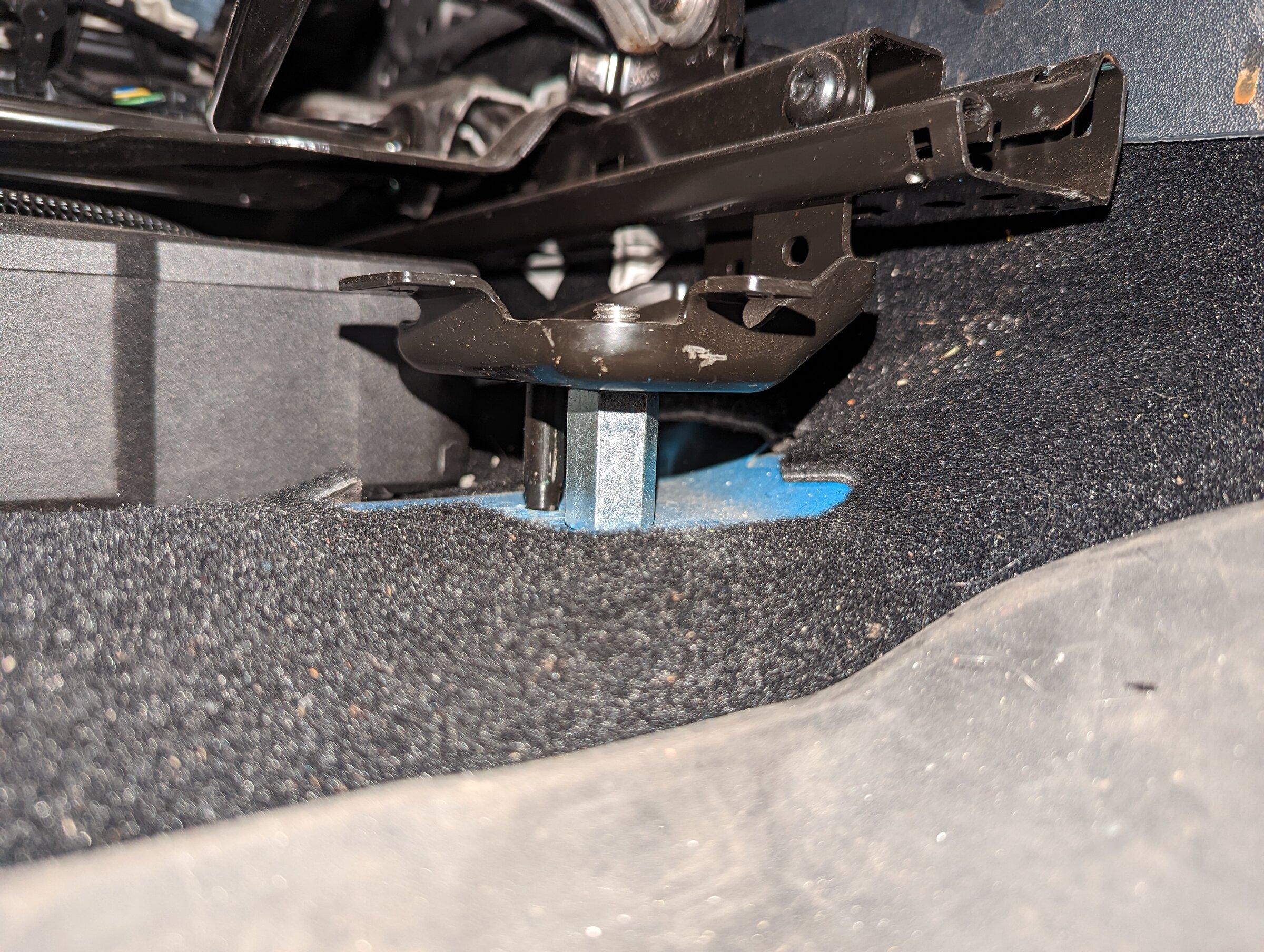

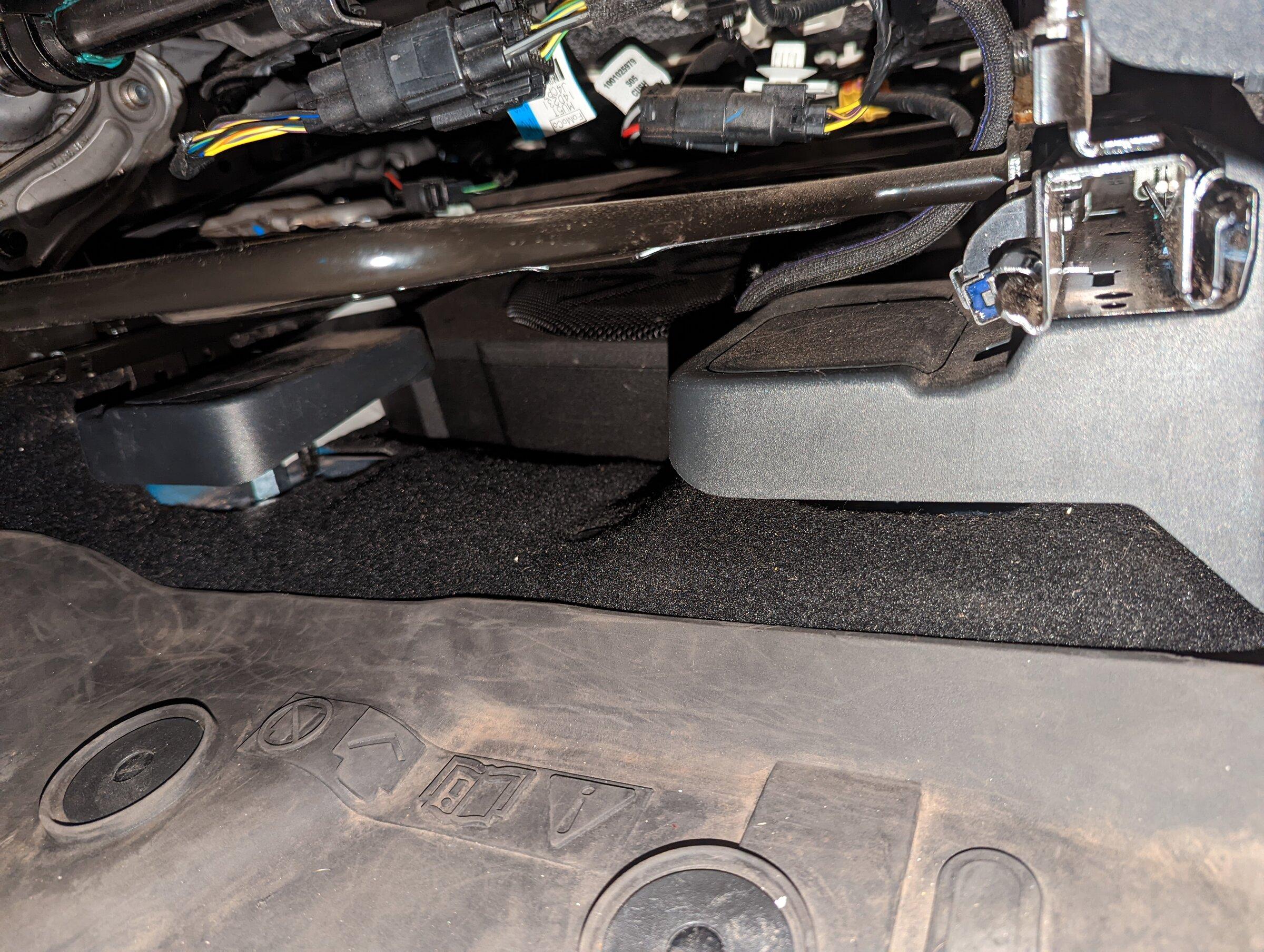

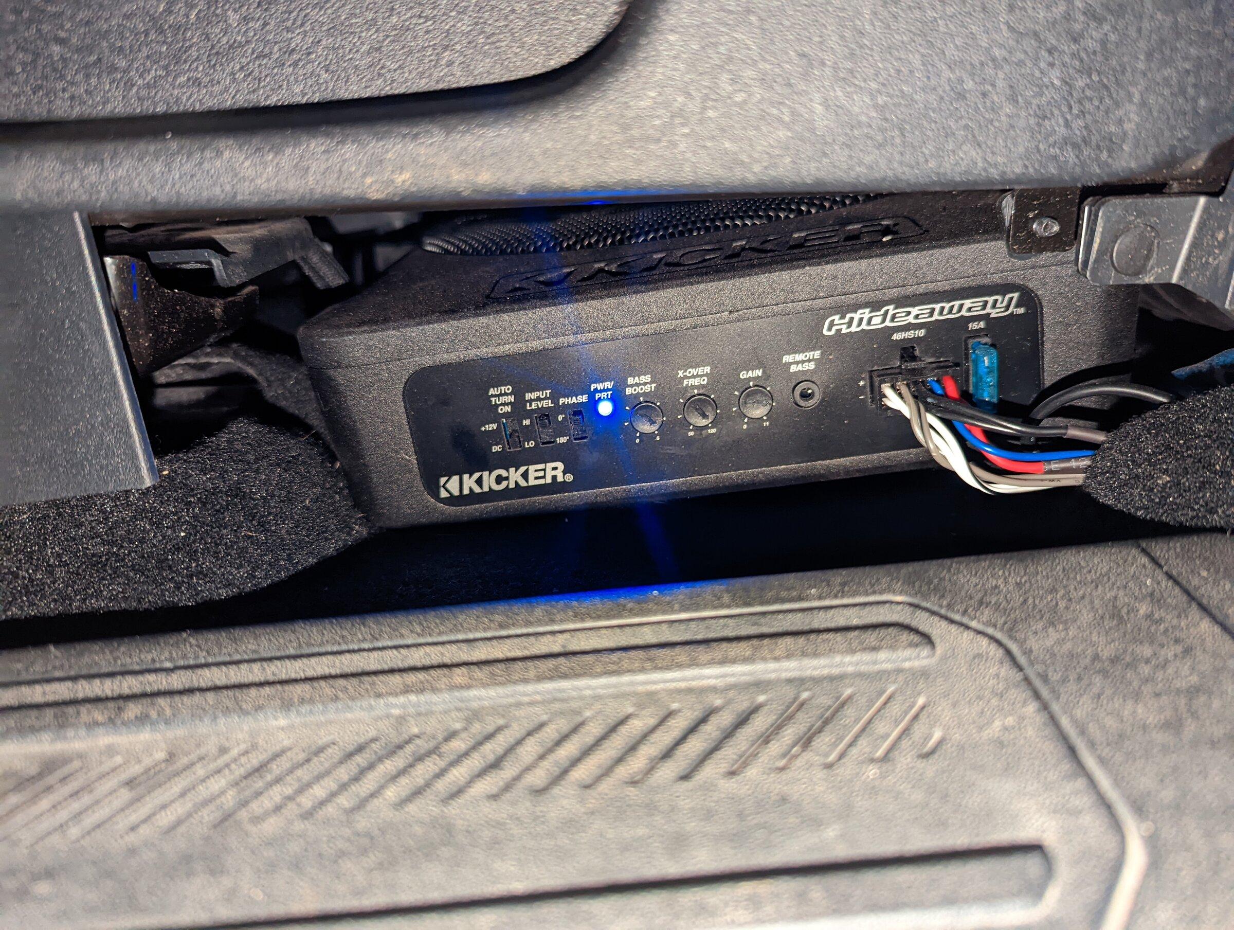

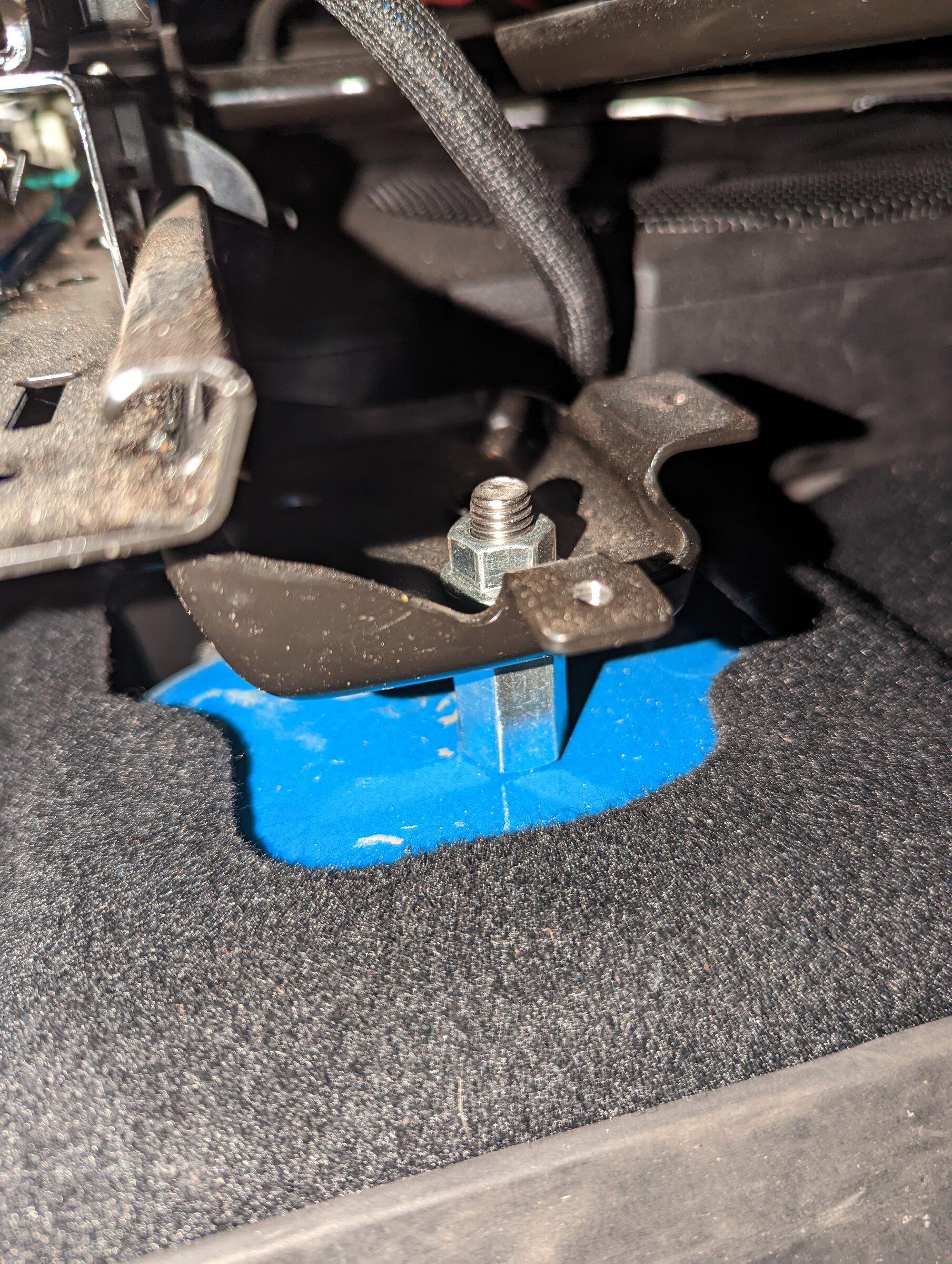

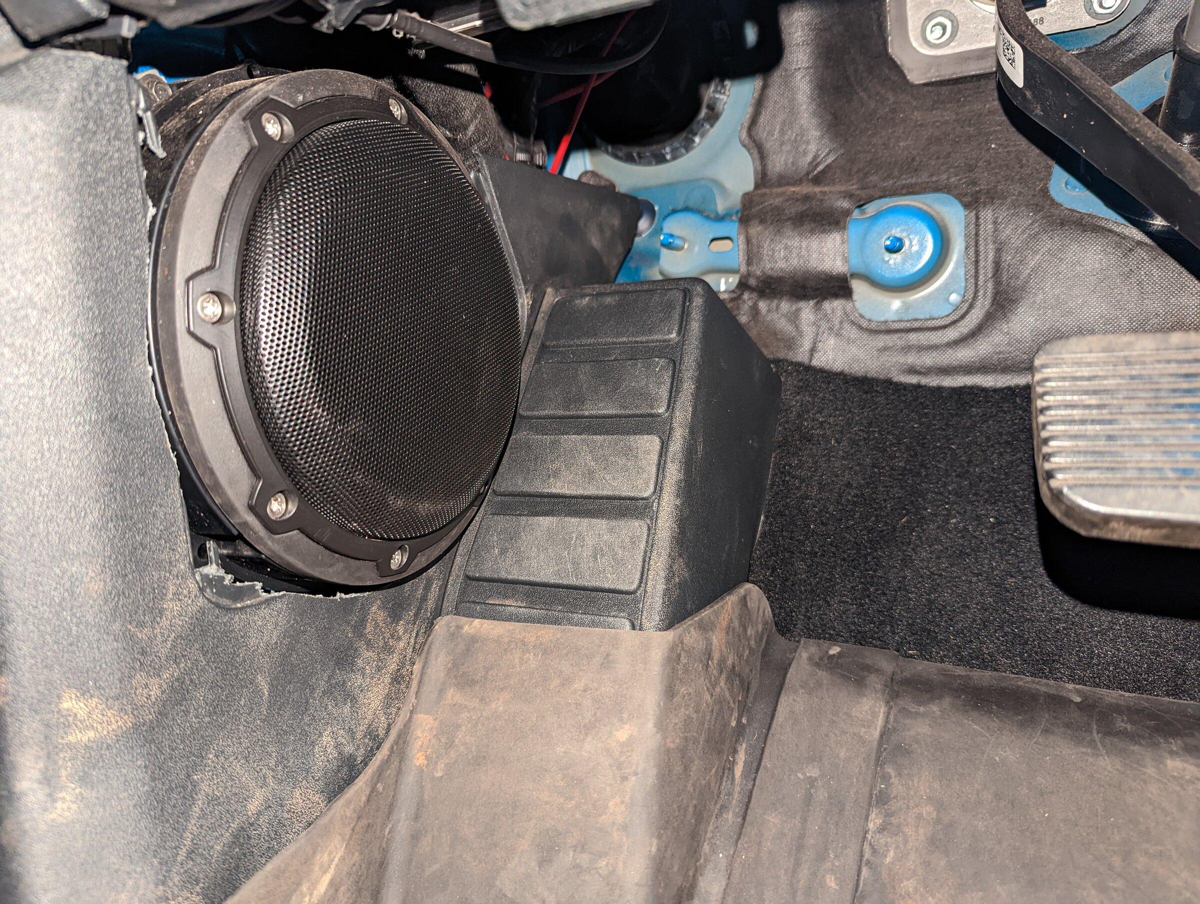

How’d you get the hideaways under the front seats? I had dismissed that idea based on many others indicating it wasn’t feasible.
I used spacers and threaded rod ....I raised the seats just over 1"...heres pics. This is a 2 Dr mod...more dores need the heater duck removed or rerouted....a much bigger job on the moredoor.

🤔 Hmm…i also dismissed this idea based on the same reasons! I would like to see a photo of this particular component of the build! If it’s feasible then that’s the route i’d rather take!
Easy on a 2 dr

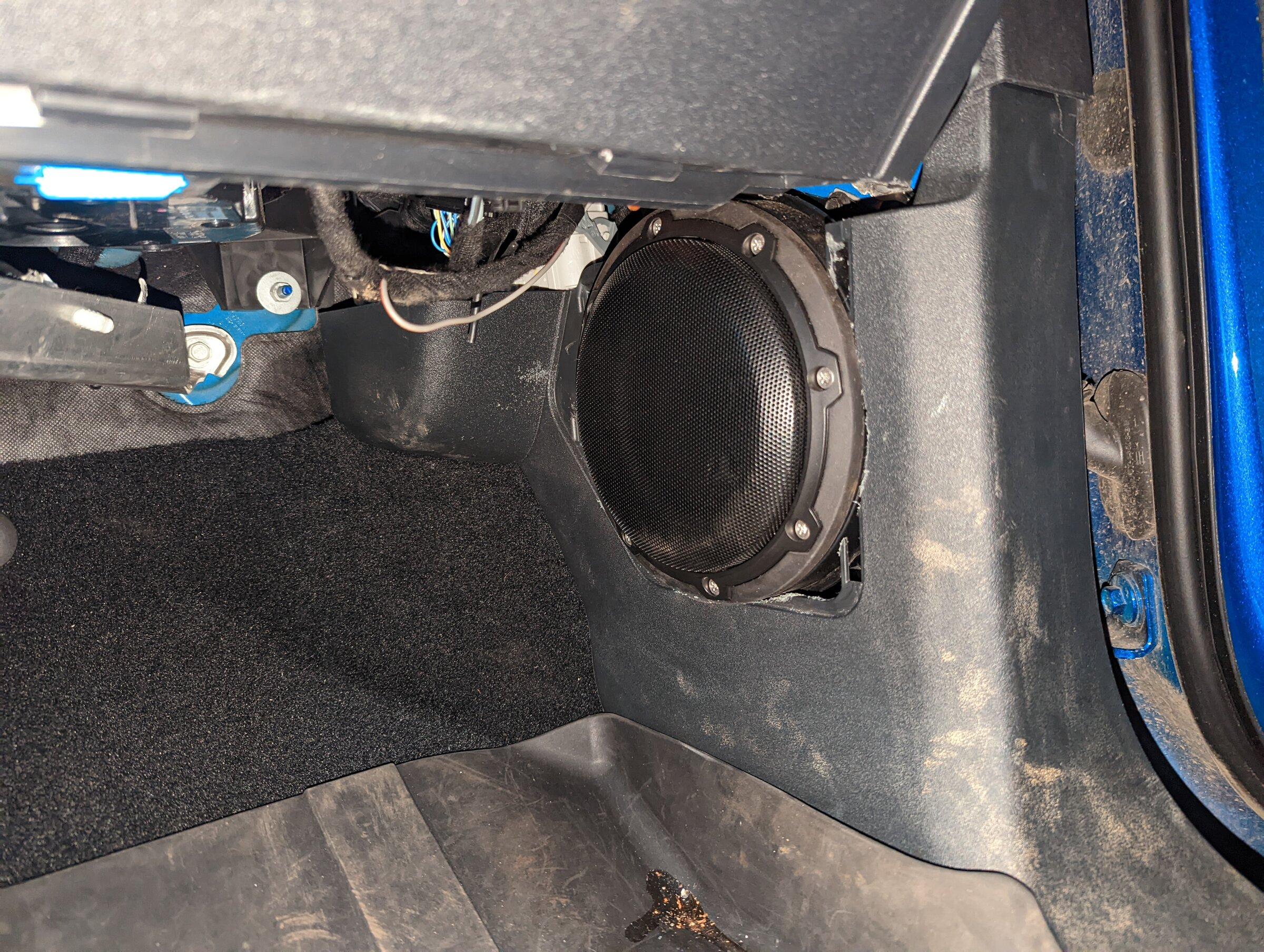

Sounds like a good system.
Since you amplified the kick speakers, did you have to add anything like the Zen interface to mitigate the B&O DSP?
No, I just used the kick speaker as inputs to the new soundstream amp ... I tried the amps built- in hi and lo pass crossovers, but like the way it sound better in full range position. I assume this is because the B&O system is already sending a (relatively) low pass signal to these.
They speakers are made for 300hz and lower but definitely respond to higher tones than that
