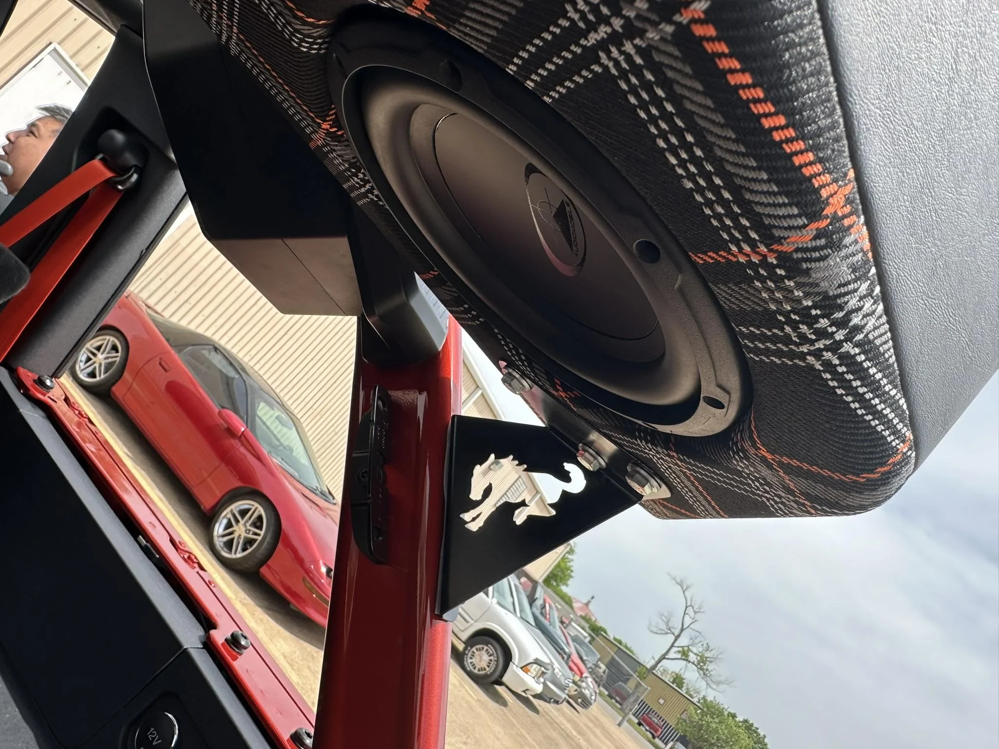

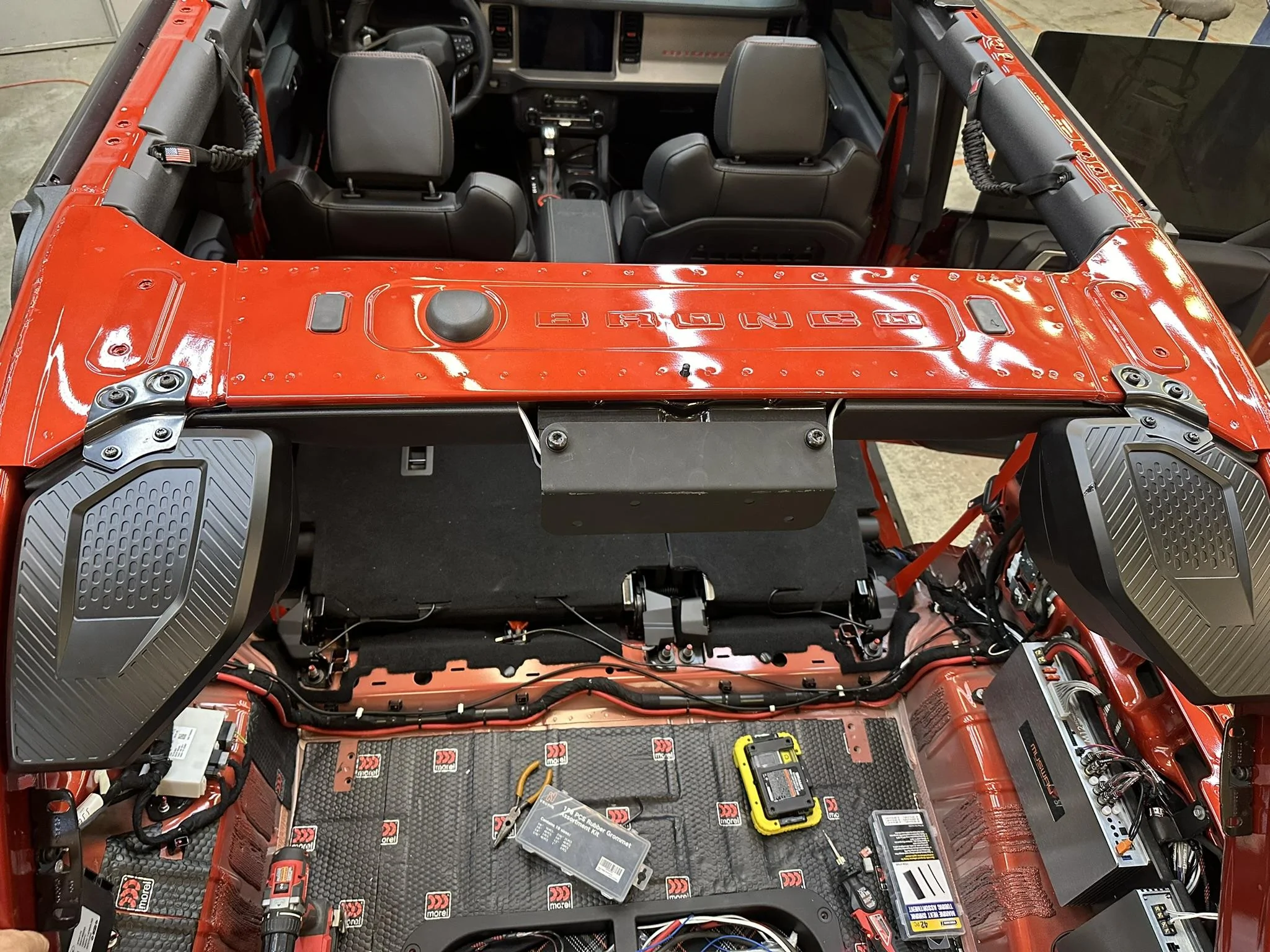

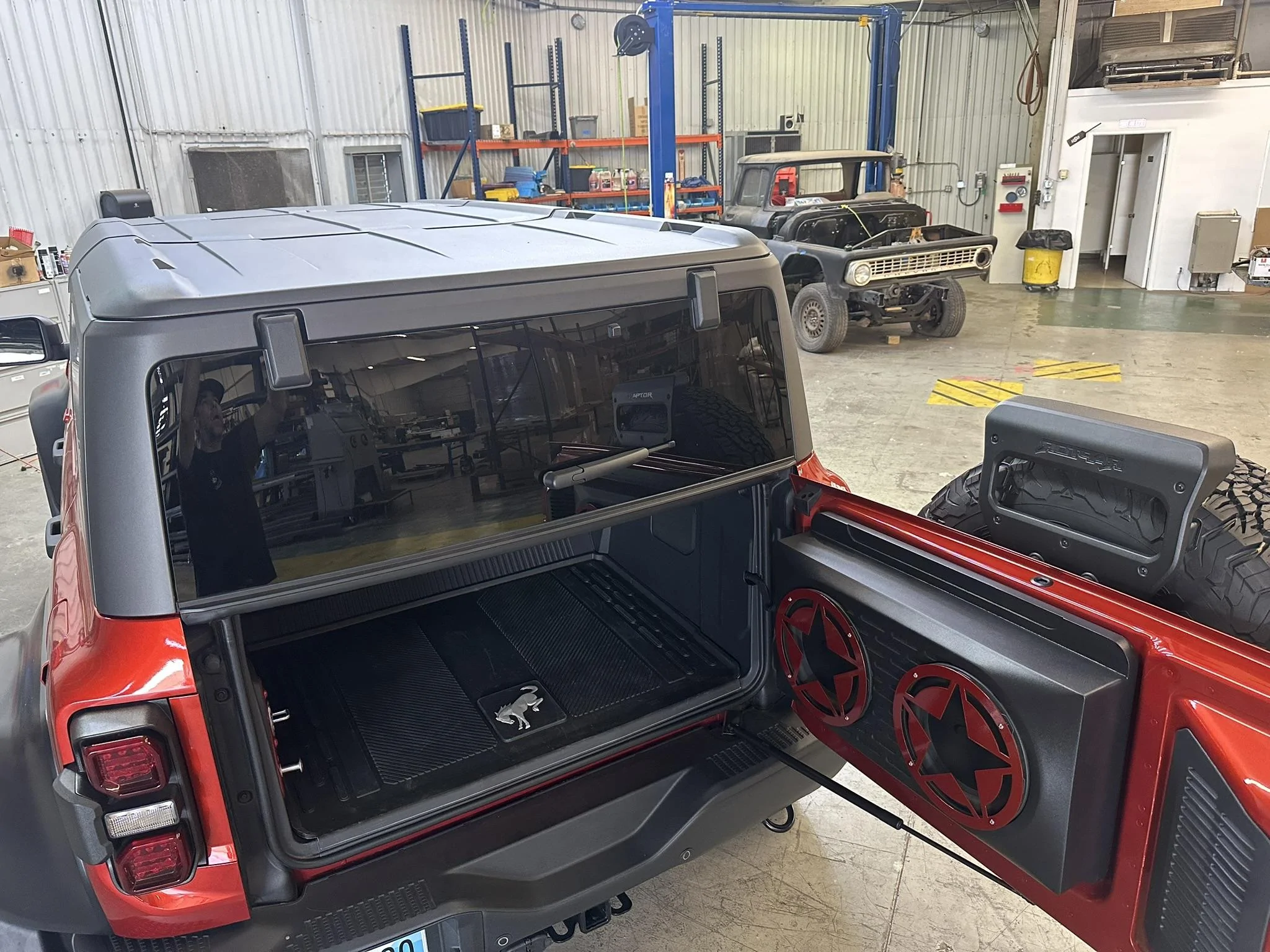

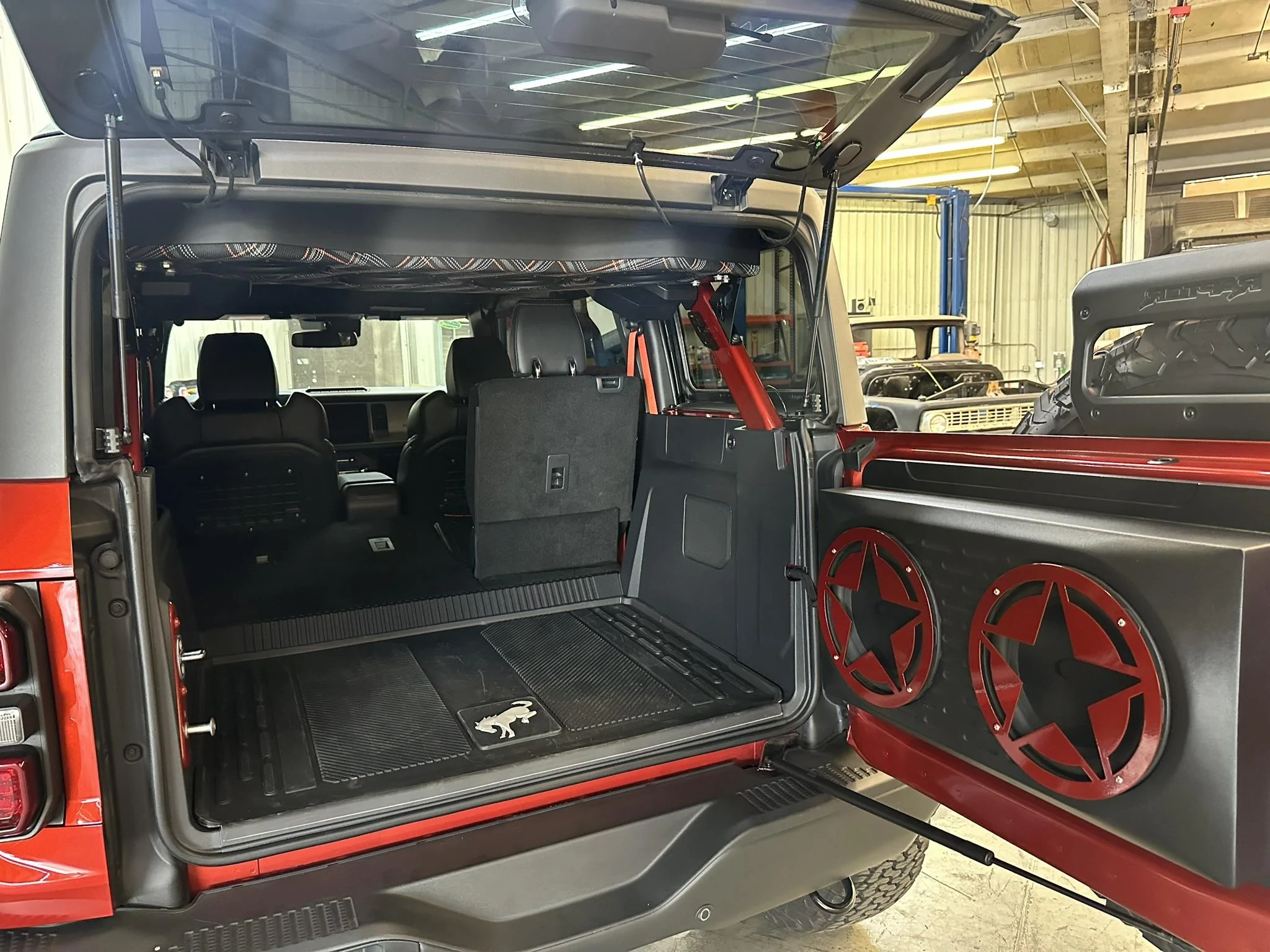

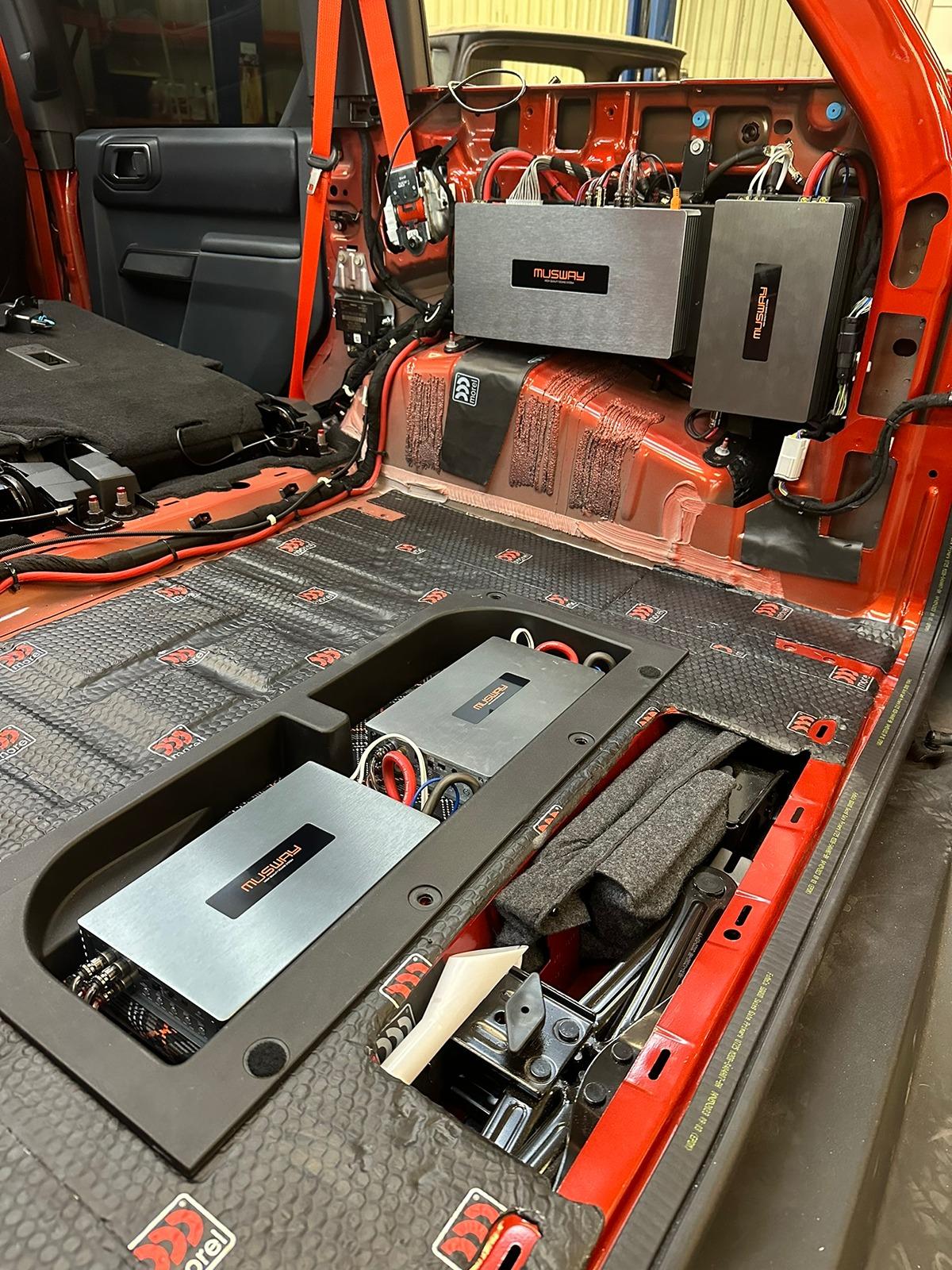

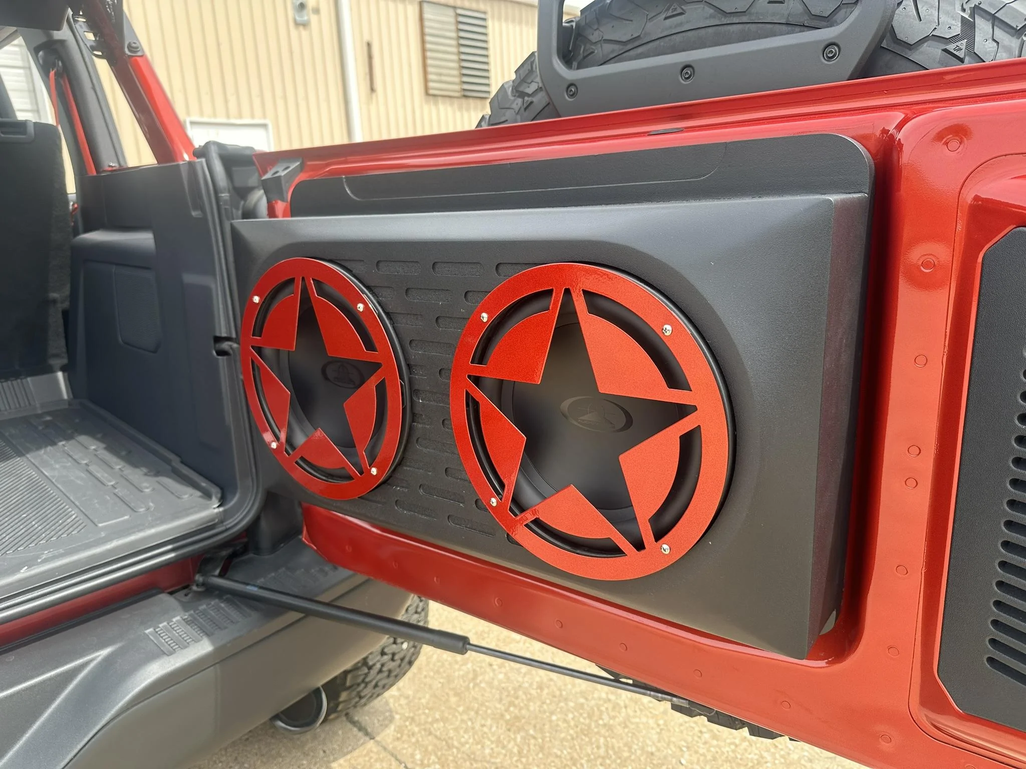

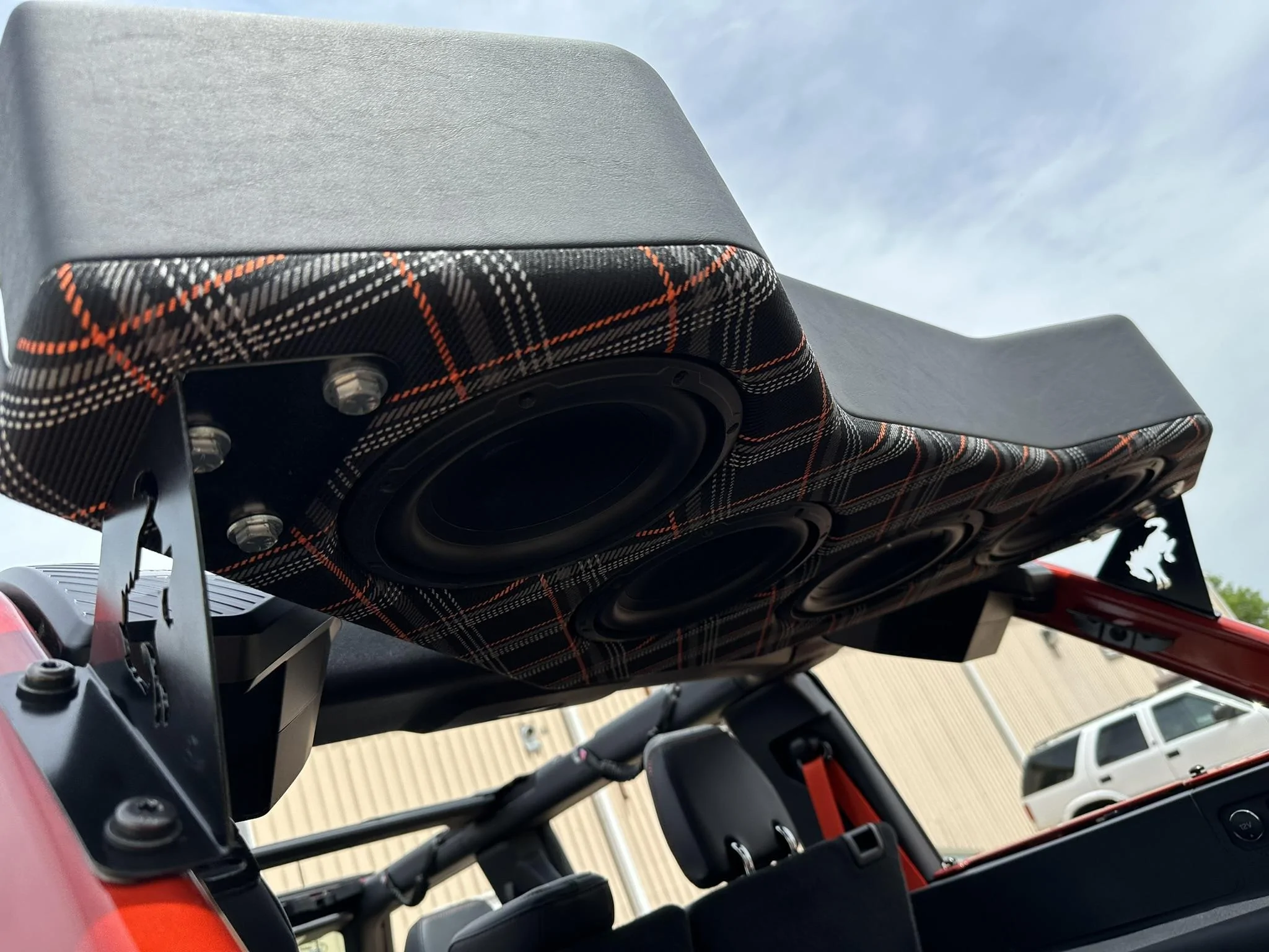

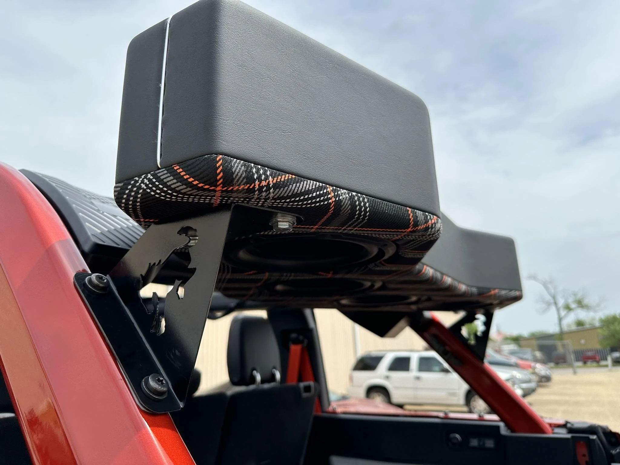

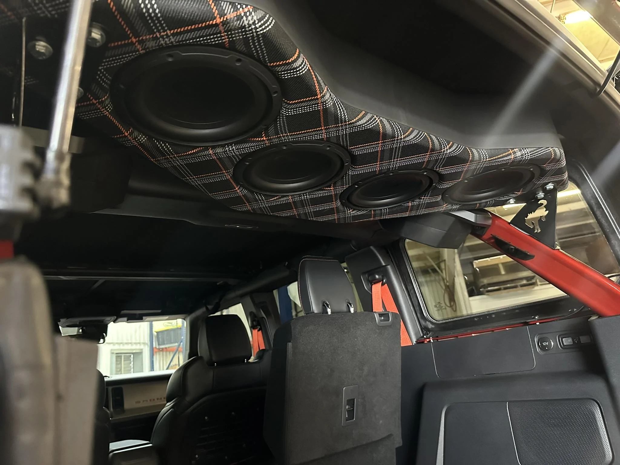

I see this is an older thread but I just recently finished my Bronco. This is my "Ultimate" Bronco Audio system.
Some notable facts about this system:
1. Not a single hole drilled into any steel. In fact the only holes drilled were through plastic to run wires into the floor storage.
2. Both subwoofer enclosures, right side amp rack, and fuse holders under hood all bolt to OEM mounting points.
OEM head unit
Mobridge Ford A2B CANBUS interface and preamp
Musway M12, 12 channel amplifier with 14 channel DSP
Musway DRC DSP controller
Musway BT adapter
(3) Morel Hybrid Integra 42 4" speakers (left, center, right)
(2) Morel Hybrid 6.5 inch bidbass drivers (front kick panels)
(2) Morel Hybrid Integra 62 in rear pods
(3) Musway ONE.1000 mono block amplifiers
(2) Audiomobile EVO 10D4 subwoofers in tailgate enclosure
(4) Audiomobile EVO 8D4 subwoofers in a roof/roll bar mounted down-firing enclosure
Morel Acudamp sound deadener throughout

Tell me more about the box you enclosed the 4 8" subs in? Custom? Who built it?
Very nice build!

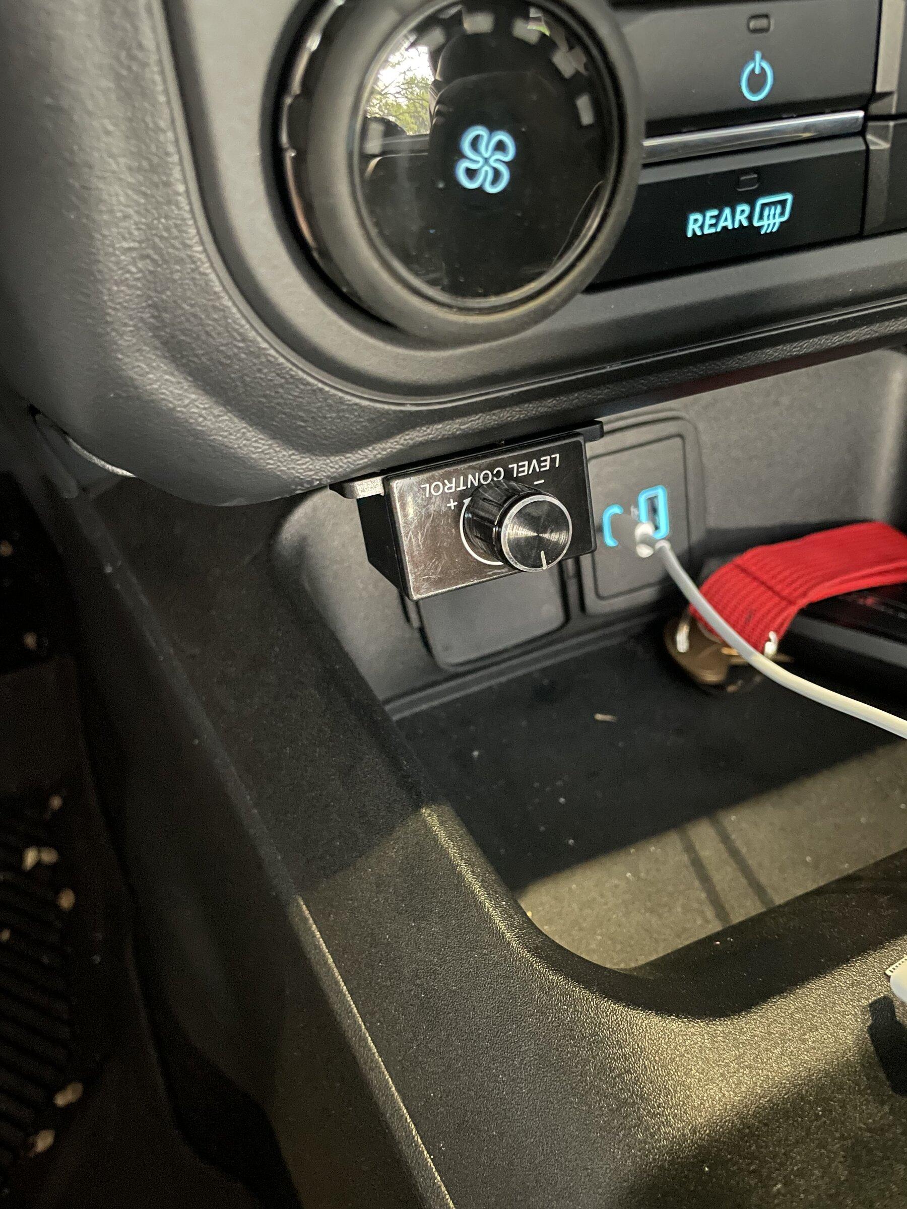

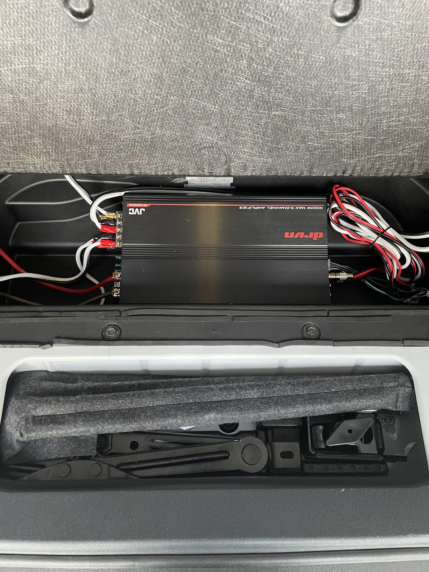

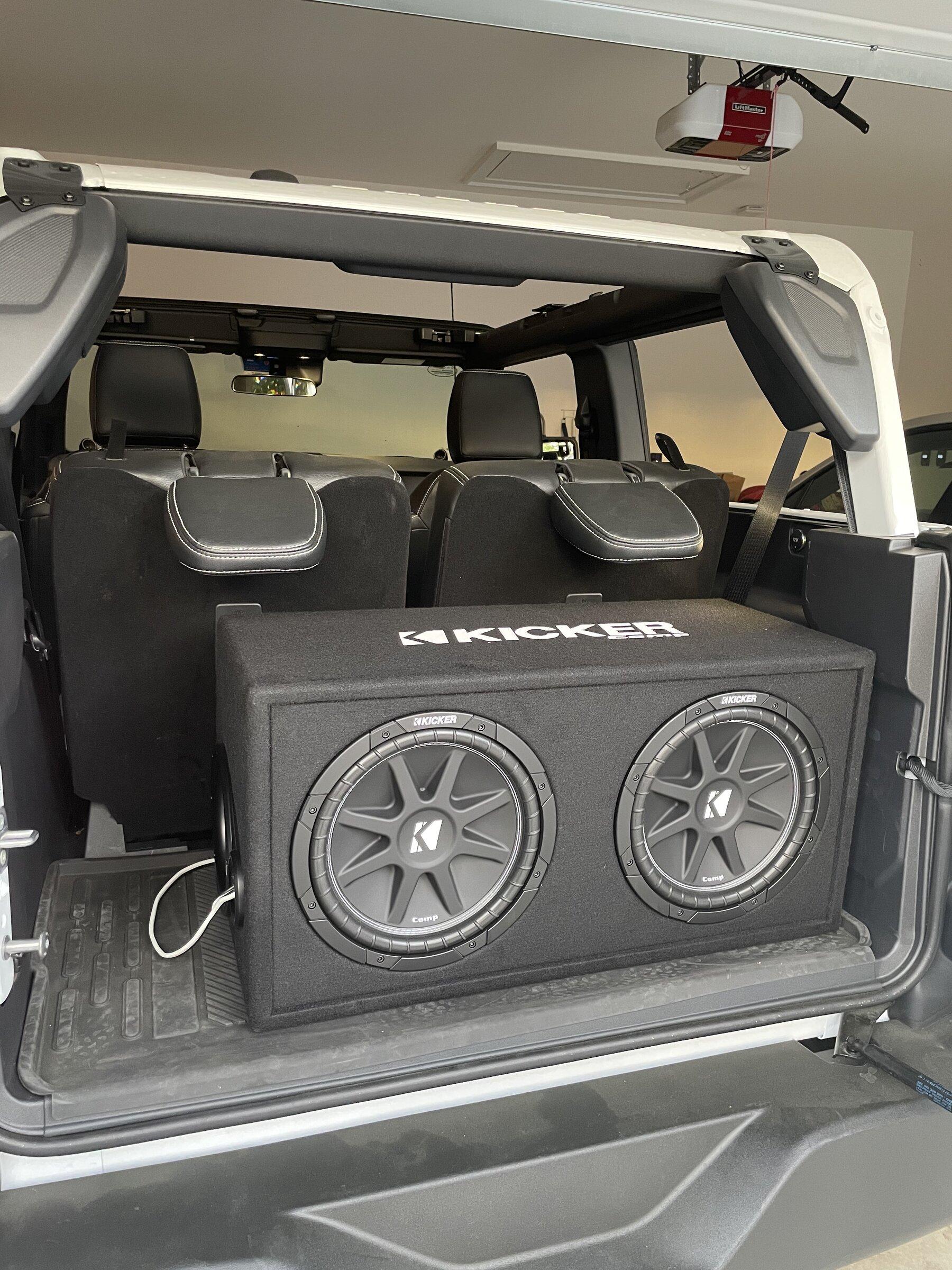

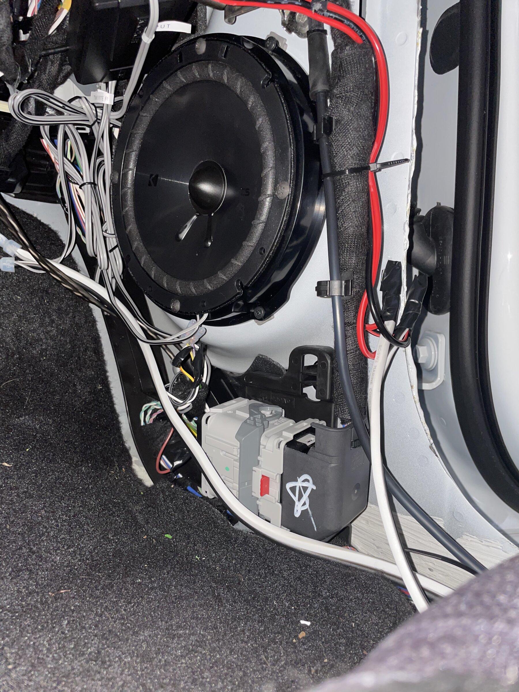

After 2 weeks I finally finished installing my 1000watt JVC amp, dual 12 inch kicker comp c in a 32/17/16 ported enclosure (with a bass knob), Pioneer 4inch TS-G400 in each dash corner and rear pods, and 6 3/4 inch Kicker 46CSS674 in the (ironically) kick panels. I hope the amp installment can give some ideas. Feel free to ask any questions.

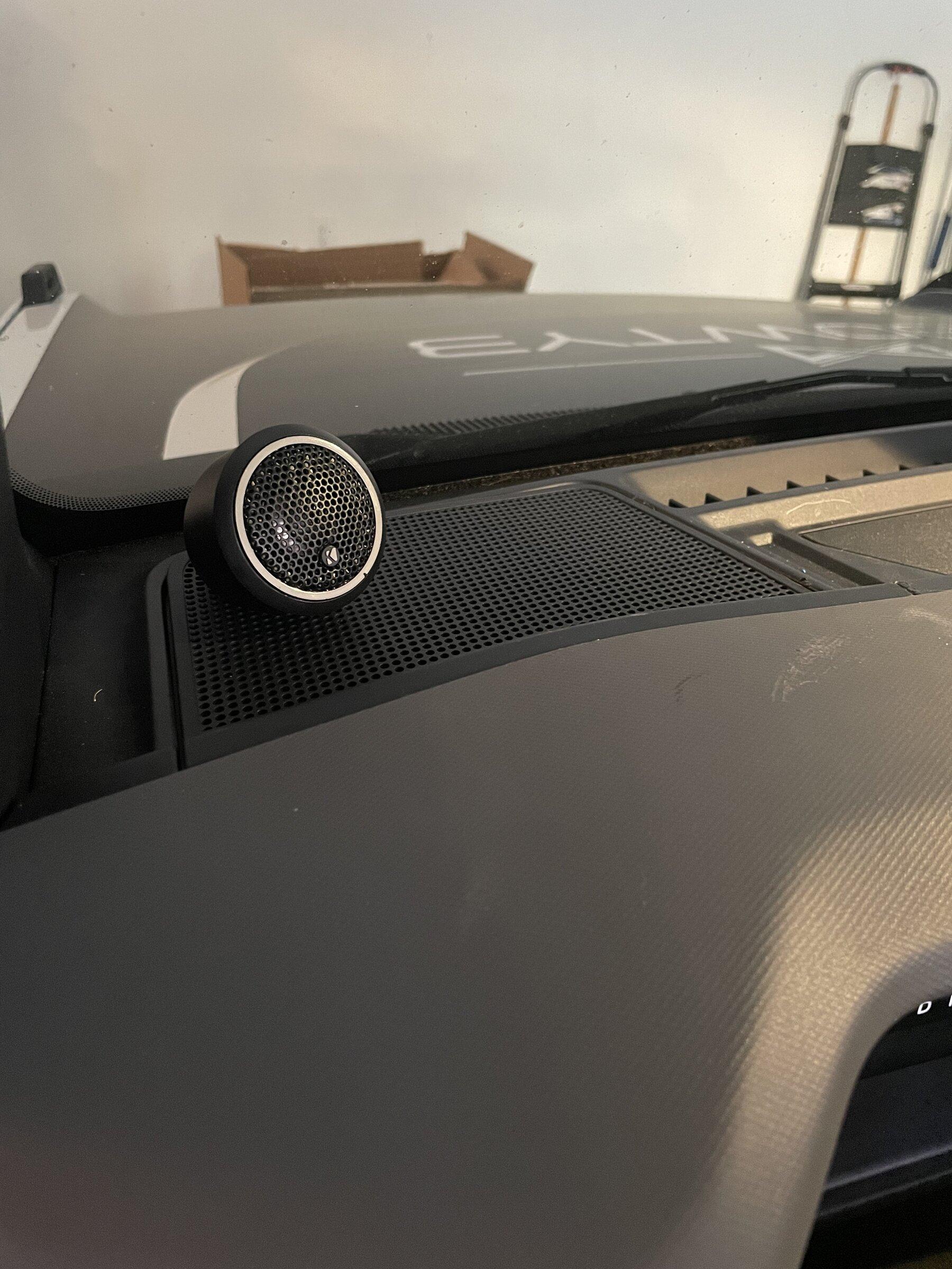

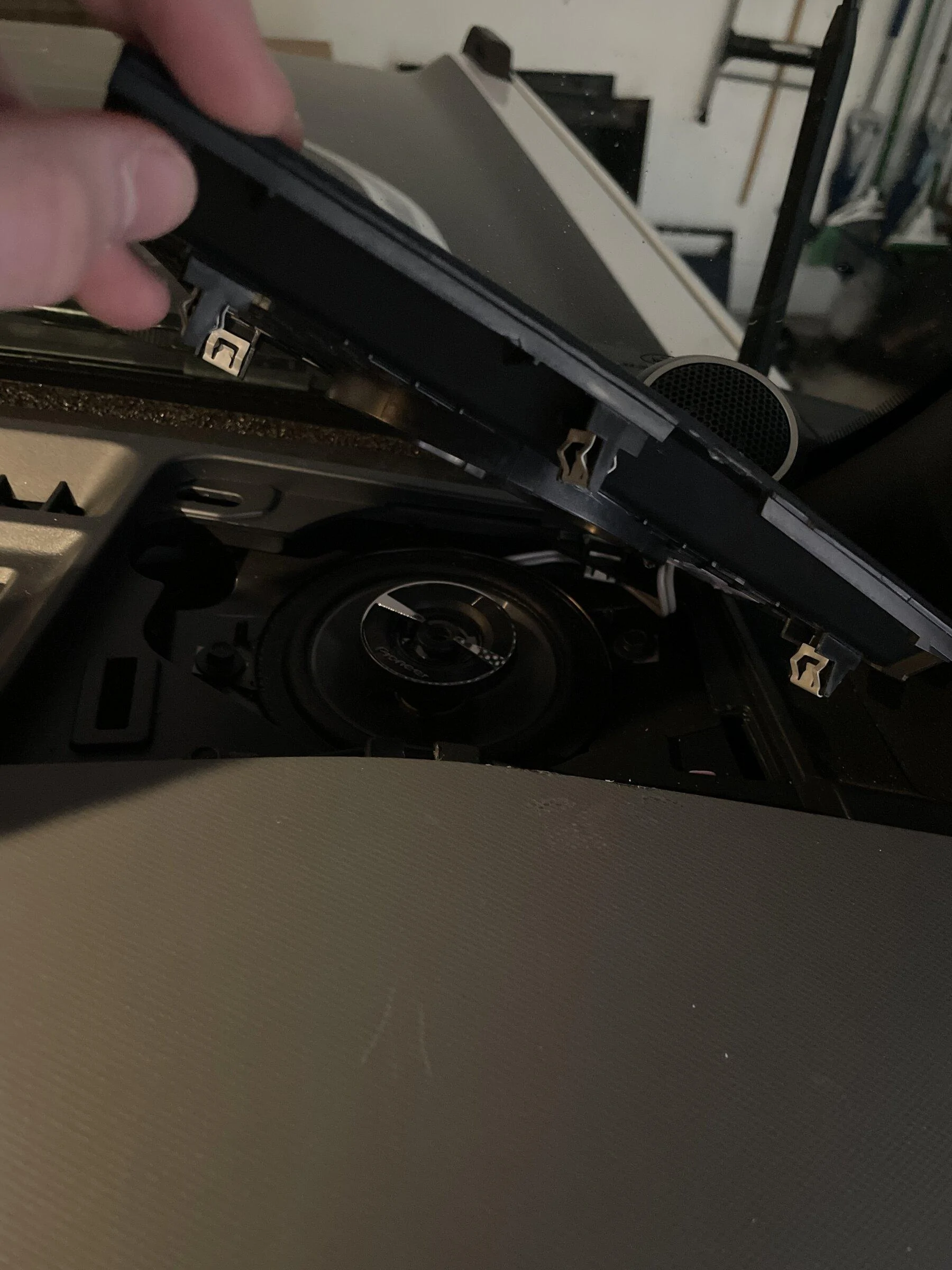

Finally, some pics where someone mounted pod tweeters. Did you have any issue with this mounting location? Does it rattle at all with midrange beneath the grill, etc?
Didn’t have any rattle at all. Highly recommend it, as it really fills in the top end of the EQ very well across the whole car. I just ran the wiring directly down the kick panel and under dash, took some persuasion but there’s a clear cut path.
Awesome, I feel like that is a much easier way that mounting on the a pillar with ducts and airbags. Appreciate the feedback! It looks fantastic.
