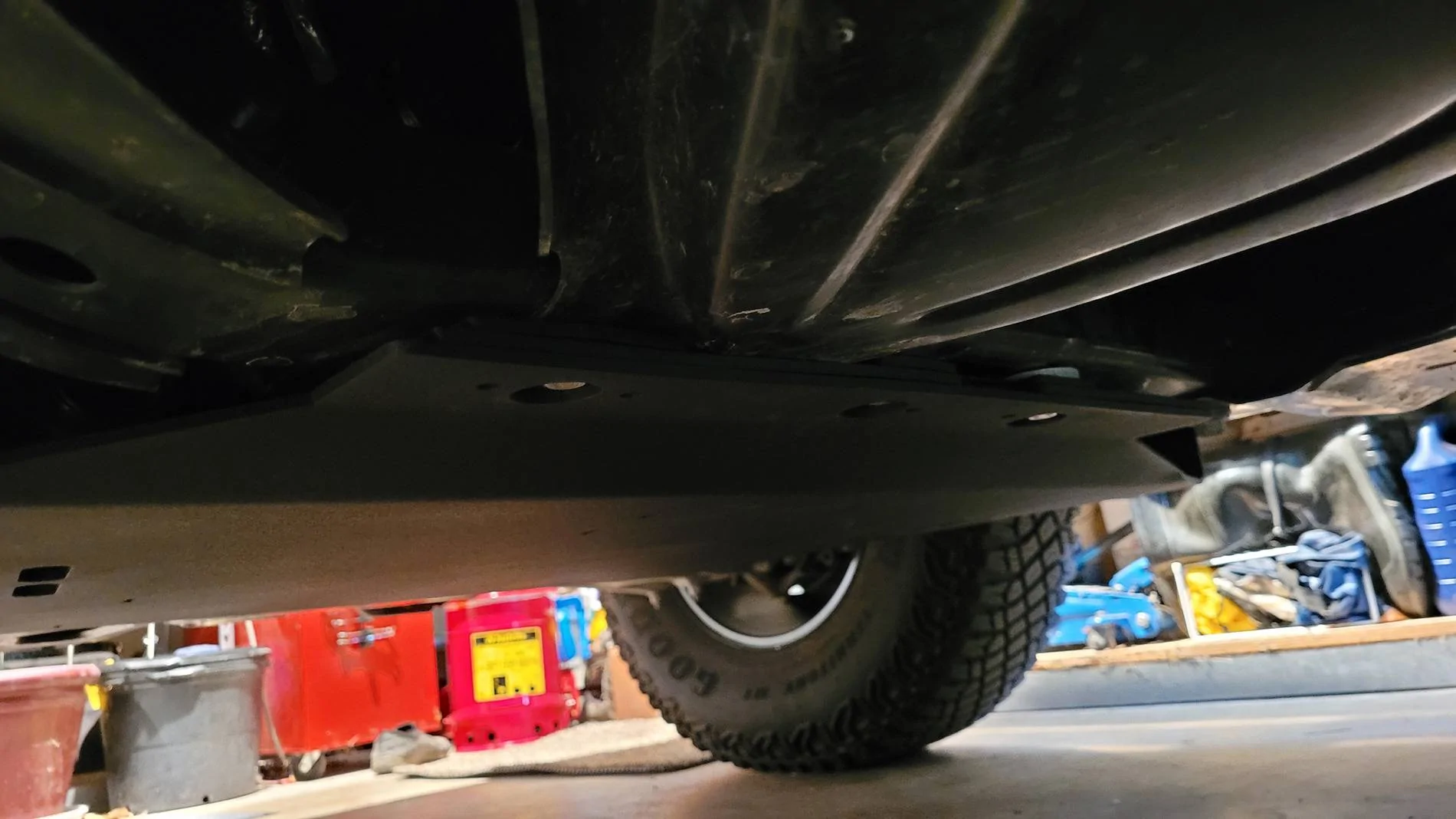

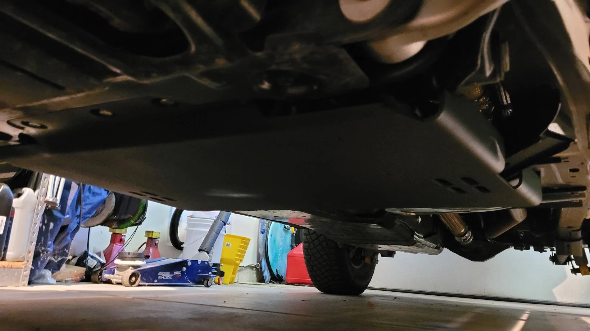

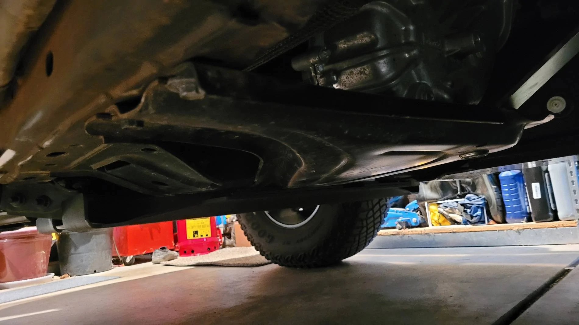

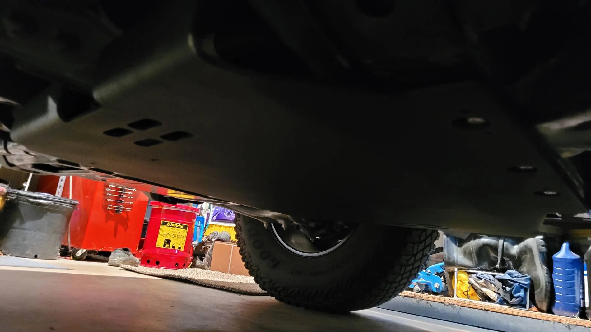

I installed mine today. Super happy with the fit, quality, and strength. I wanted to show how the factory transfer case skid integrates as I did not see a clear picture of this anywhere else. They give you a spacer for the passenger side bolt.
Ford Bronco Transmission skid plate installed 20241203_160515
Ford Bronco Transmission skid plate installed 20241203_160443
Ford Bronco Transmission skid plate installed 20241203_160524
Ford Bronco Transmission skid plate installed 20241203_160549
