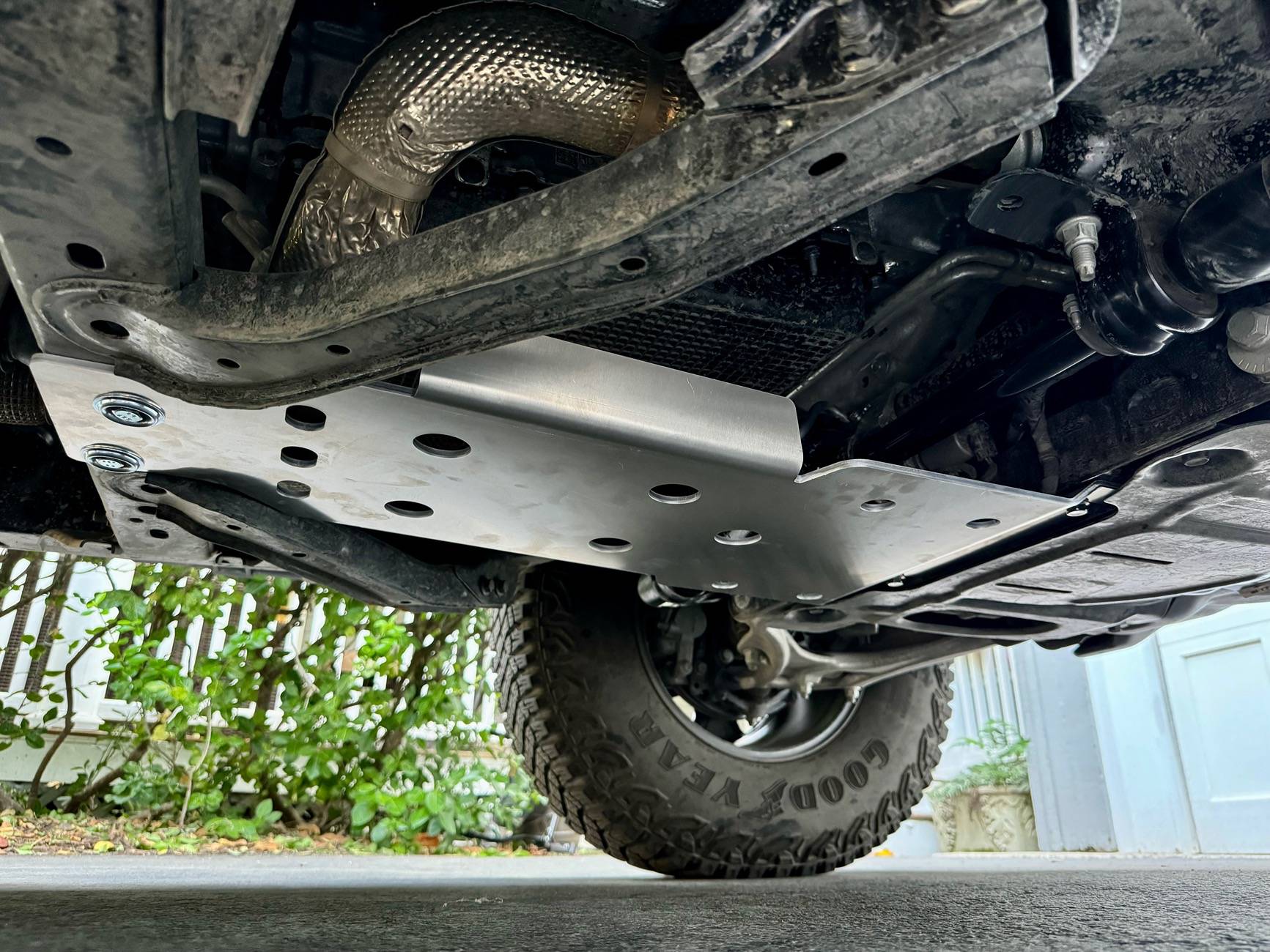

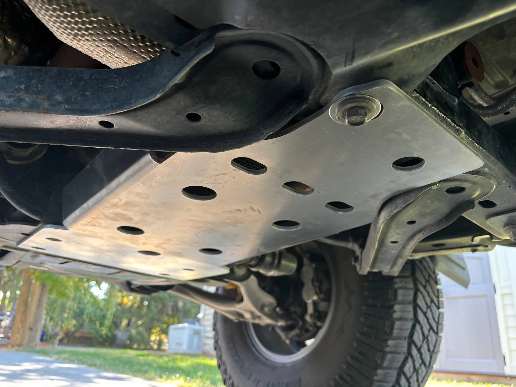

I recently installed an ASFIR trans skid plate on my 23 Badlands 2.7. Straight forward easy install but…. I’m wondering if I should find a way to get a second bolt on the trailing edge..?

They used to provide different styles bolts and washers. What you show in the pic would have a tendency to catch on rock and potentially damage the head. Is that hardware what they sent with the plate?

No hardware 😕

Mine came with hardware for both locations.
Give them a call they are very helpful and I have no doubt they will take care of you.
Here is a picture from their website
Ford Bronco ASFIR Transmission Skid installed IMG_1113
Thanks!

Definitely call them then. The way you have it mounted is not good.
When I got my tranny plate from them I also got the cross member skids (as someone above noted) - they hang very low and mind have decent amount of rock rash. I also got the transfer case reinforcement bar. The latter mostly because it brought me over the free shipping limit. I also had found a 5 or 10% coupon.

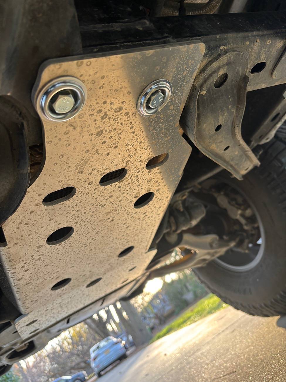

I installed one on my Wildtrak after I added the sway bar disconnect. Mine had 4 bolts.

Yeah, that's not right, give them a shout. You should have four bolts with "pocket" washers. I have their full skid package on my HE and they were great to work with.
And as BroncoDymond88 pointed out, get the crossmember arm protectors. I installed everything before I hit my first trail and glad I did. The crossmember protectors show signs of big hits that would have made an impression on Ford's formed crossmembers. I doubt that I would have been able to add protection after the fact.

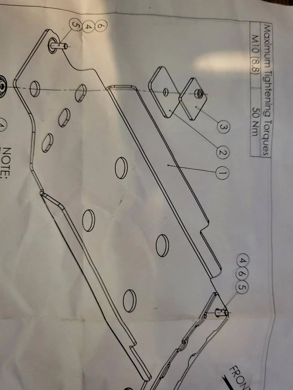

Ford Bronco {thread} {filename}
You should have gotten a threaded plate that inserts into the cross member to thread the second bolt into. Give them a call
Ford Bronco ASFIR Transmission Skid installed 20241031_115434
Parts 2 and 3 in photo
