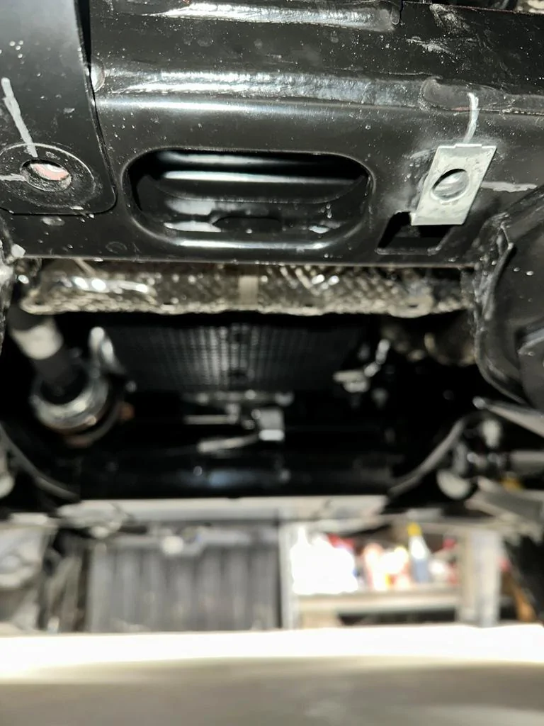

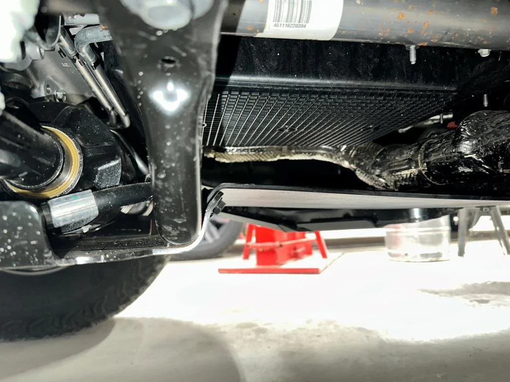

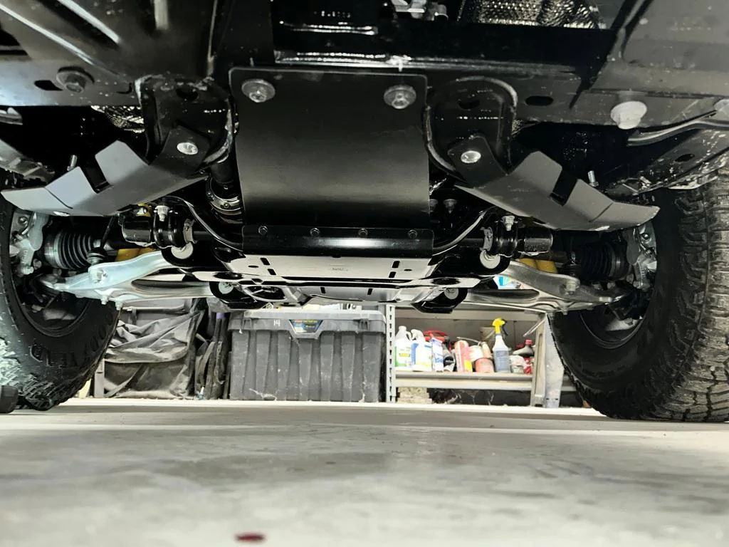

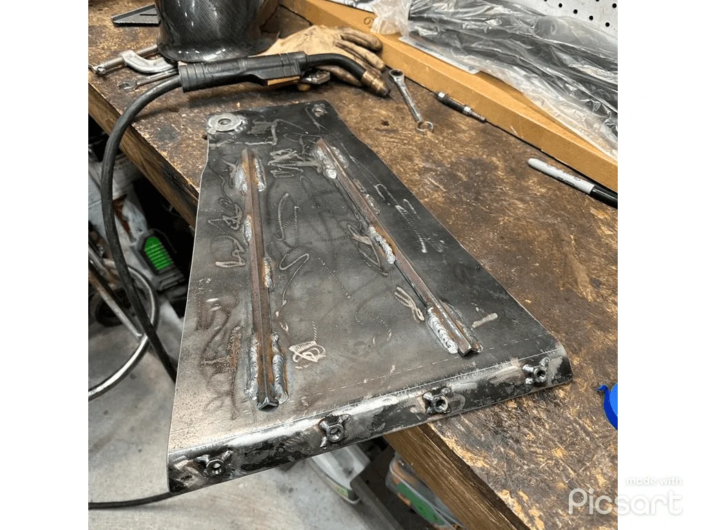

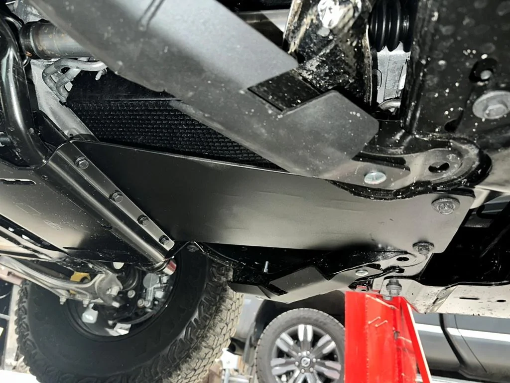

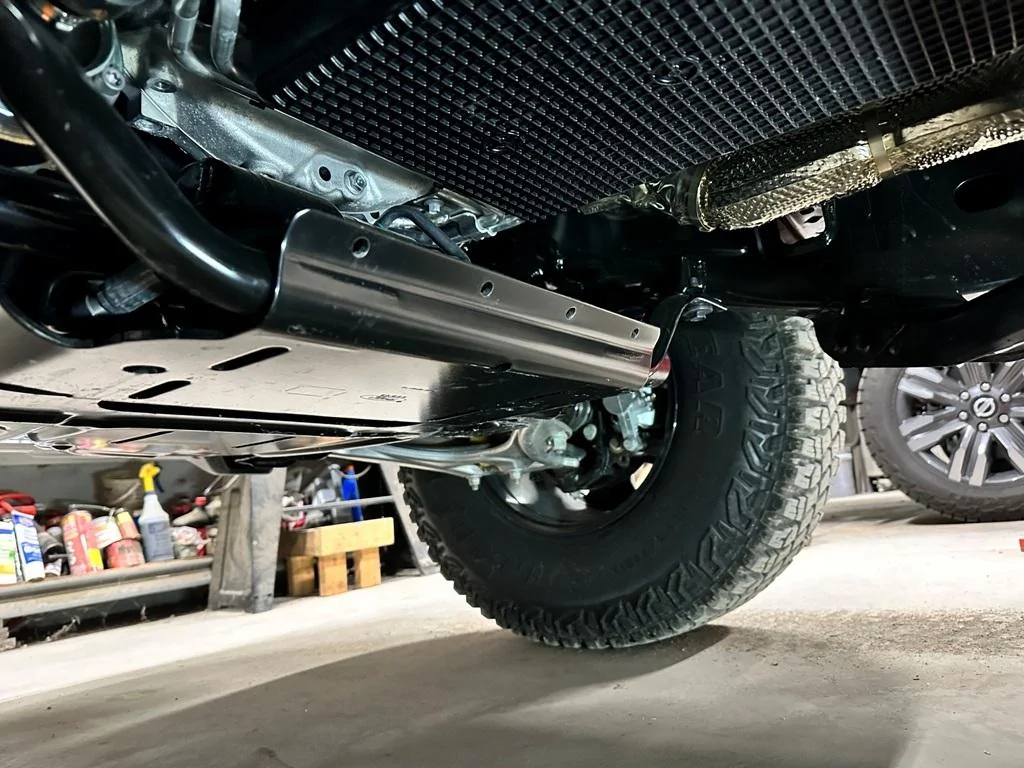

Just finished making a transmission skid plate.
I wanted to maintain maximum ground clearance and make a skid that was easy to install/remove.

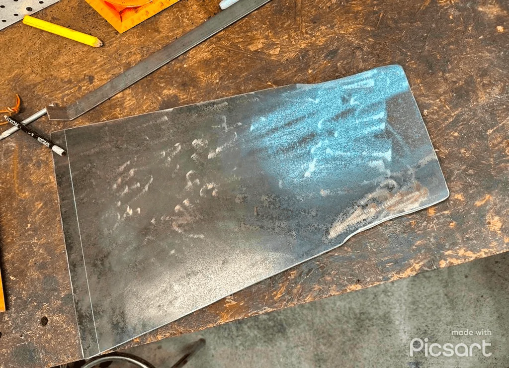

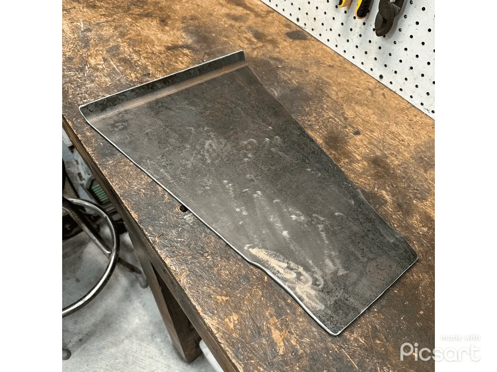

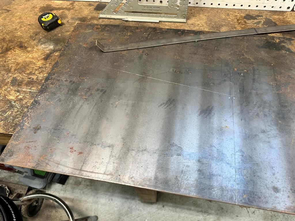

Had a piece of scrap 3/16" steel plate out in the shop, so it was the chosen one.

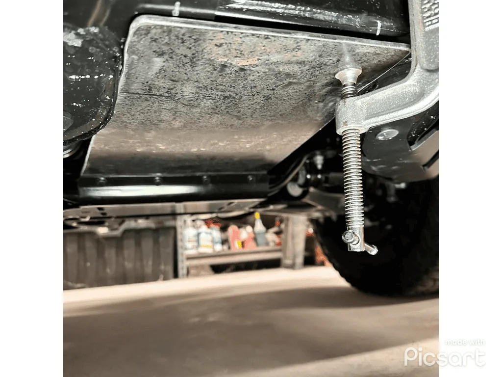

Used M8 10.9 bolts and weld nuts to attach the new plate to the factory skid. For the back I purchased a factory transfer case skid plate M10 clip nut and bolt from Ruxer Ford.
My buddy works for a machine shop and had the lip on the plate bent with their CNC press brake.
Welded 1/4" angle stiffeners on top to make it a little stronger. Haven't had the welder fired up in a while and it shows :) .....but it's solid and not going anywhere.
The plate weighs in at 11.6 lbs. and the overall cost was $28 since I already had the plate.

I did something similar, but considerably uglier.
It gets the job done, only out for my time, as it was scrap steel I had lying around as well.
Good job on the bend and weld nut idea.
Ties in nicely.
Much better than my iteration, which was a flat tombstone of plate with some plasma-cut holes/slots for bolting up.
Makes me want to go back and redo it now!

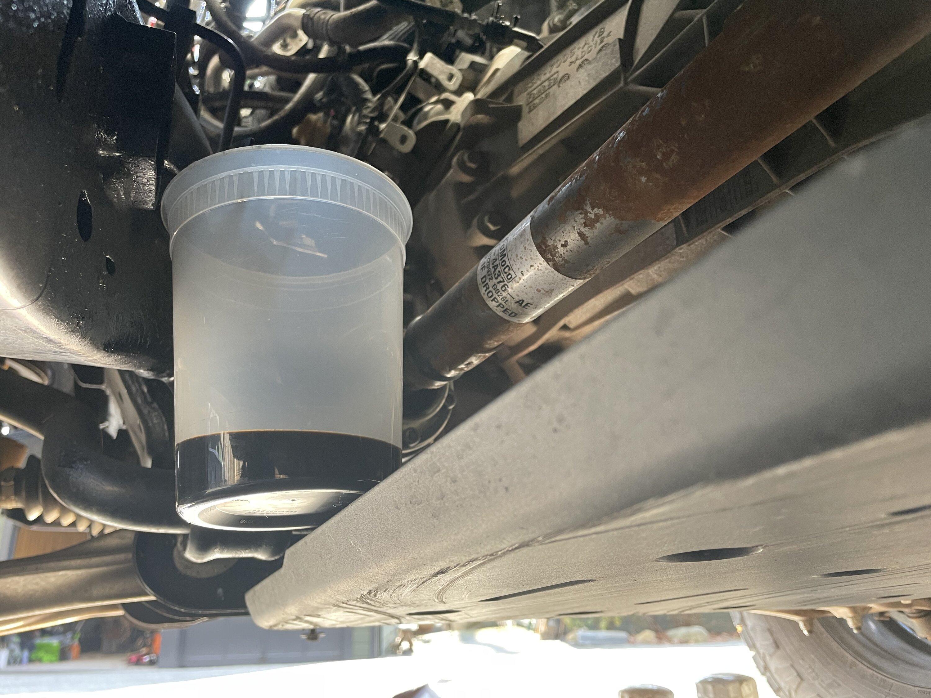

Not to mention it comes in handy for oil changes! Holds a quart container perfectly just under the drain valley for removing the oil filter.
