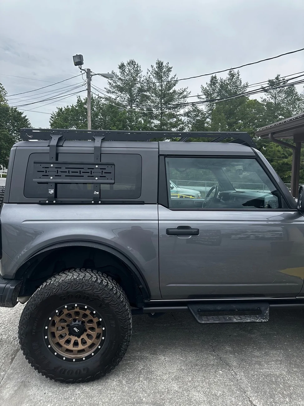

Anyone ever install the pak rax without taking the top off? Looking for some idea's.
When I installed mine my buddy lifted it and I put blocks in then installed it. Then lifted it pulled blocks and set it back on the pins. Should be able to get some help setting the blocks while you lift it.
