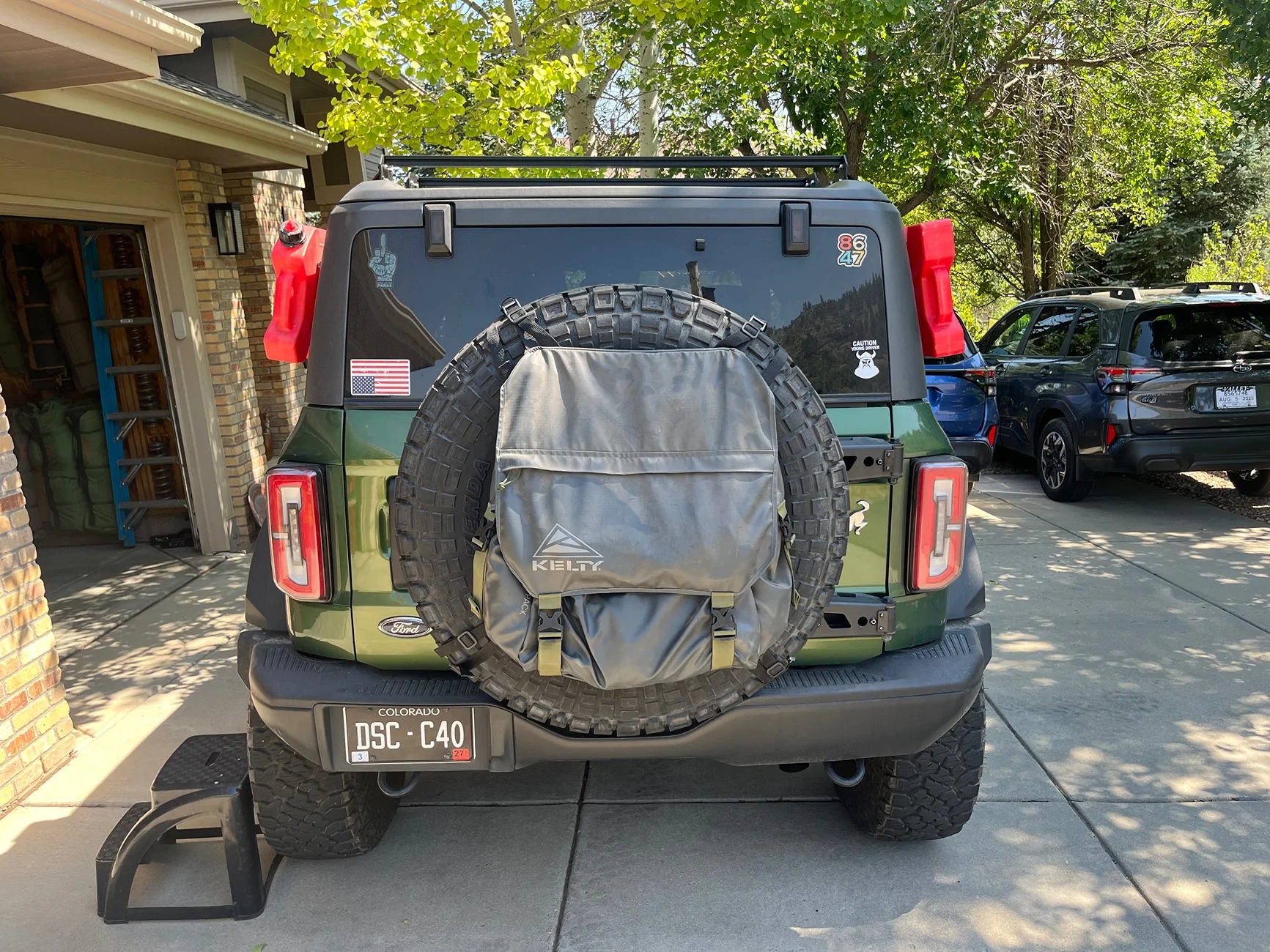

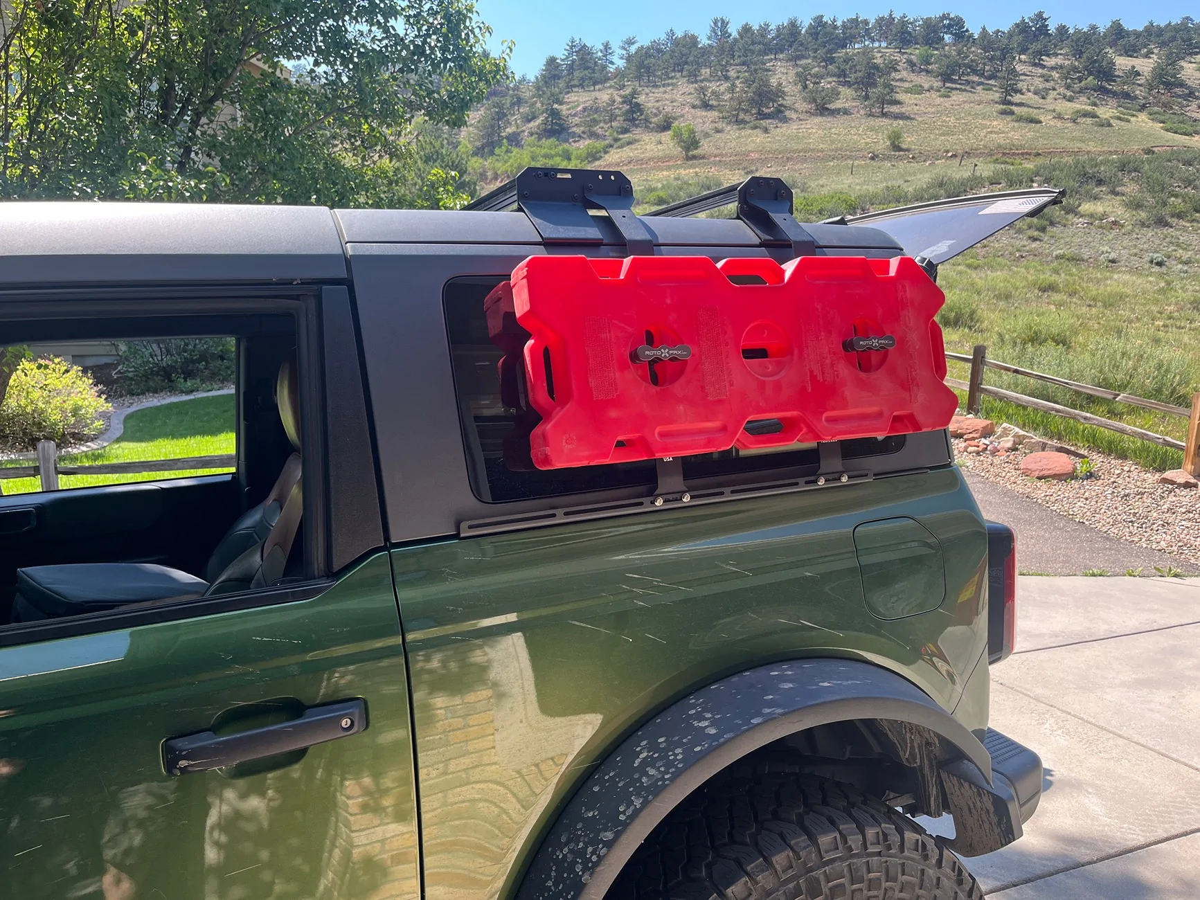

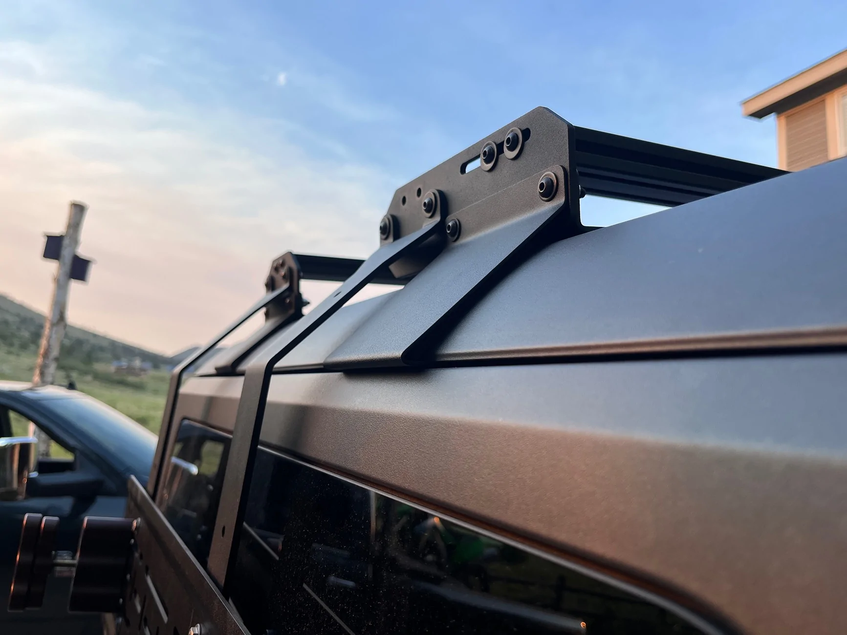

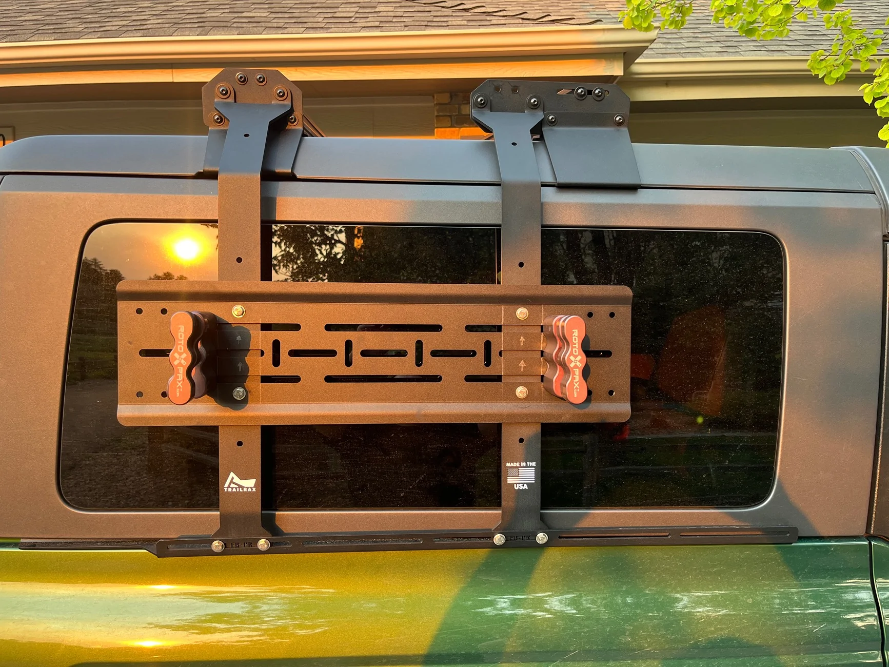

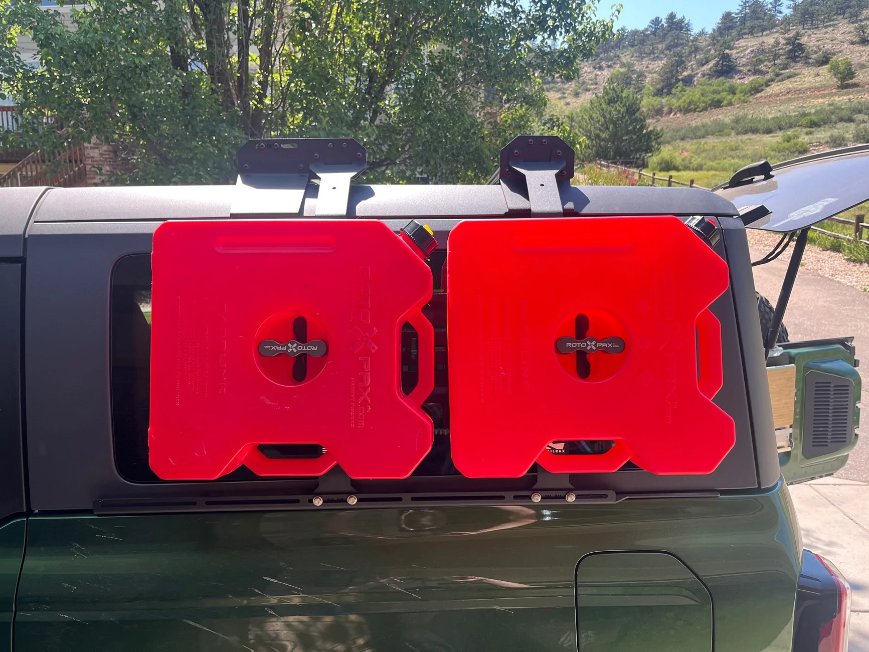

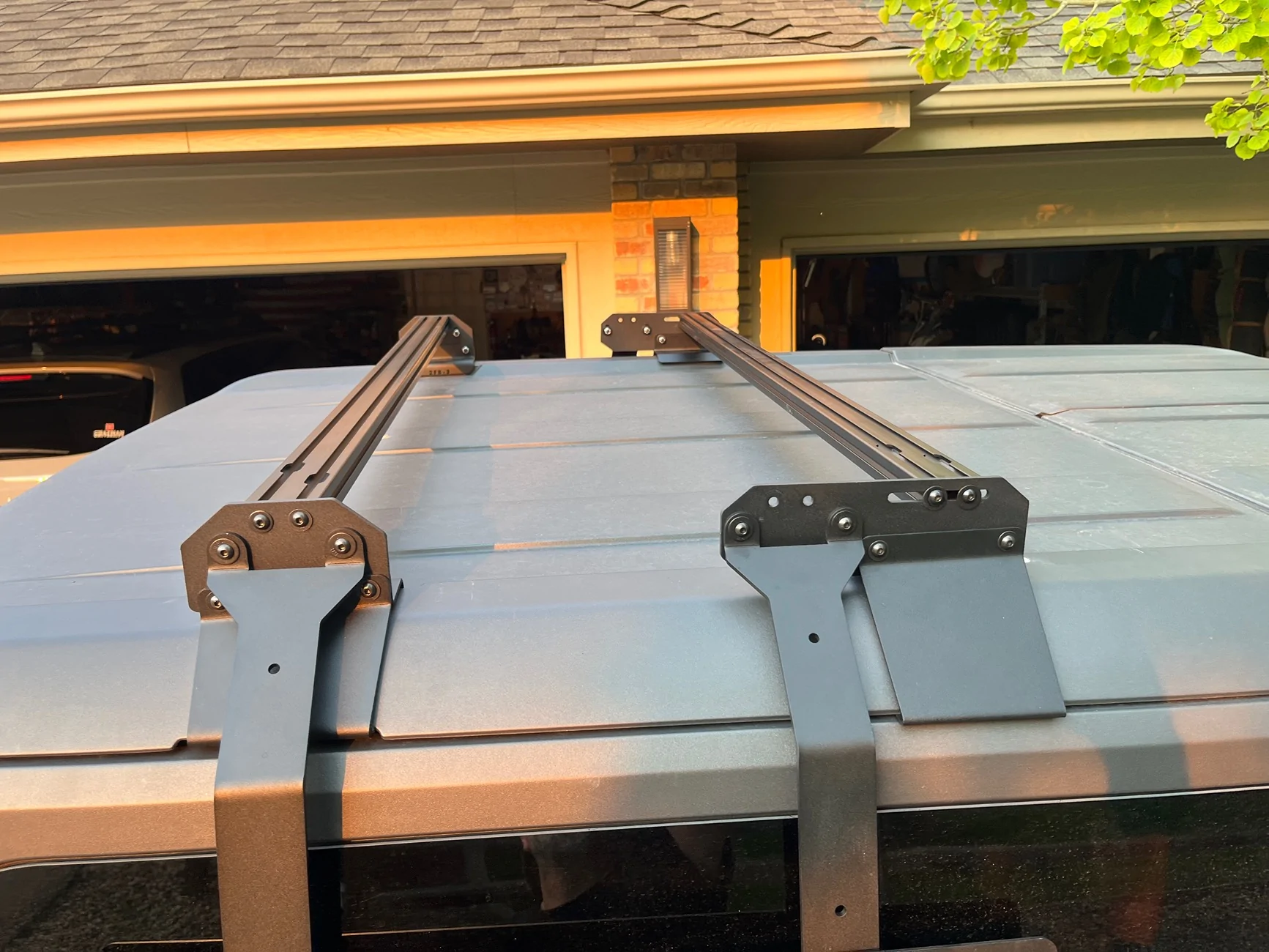

It lives….2door stand alone Pax Rax.
Installation was very challenging at first because TR doesn’t have instructions for this set up and the old YT video featuring the 4D is out of date and or just plain wrong. After many emails with TR they helped me work it out…mostly.
As far as I’m concerned it’s impossible to install the forward / top clamp into the hardtop seam with the foam installed as shown in the YT video and as recommend by TR. I ended up trimming the foam back away from the edge that inserts into the seam.
I’m headed up into the Flat Tops area of the White River National Forest in a few days, that should be a legit test.
