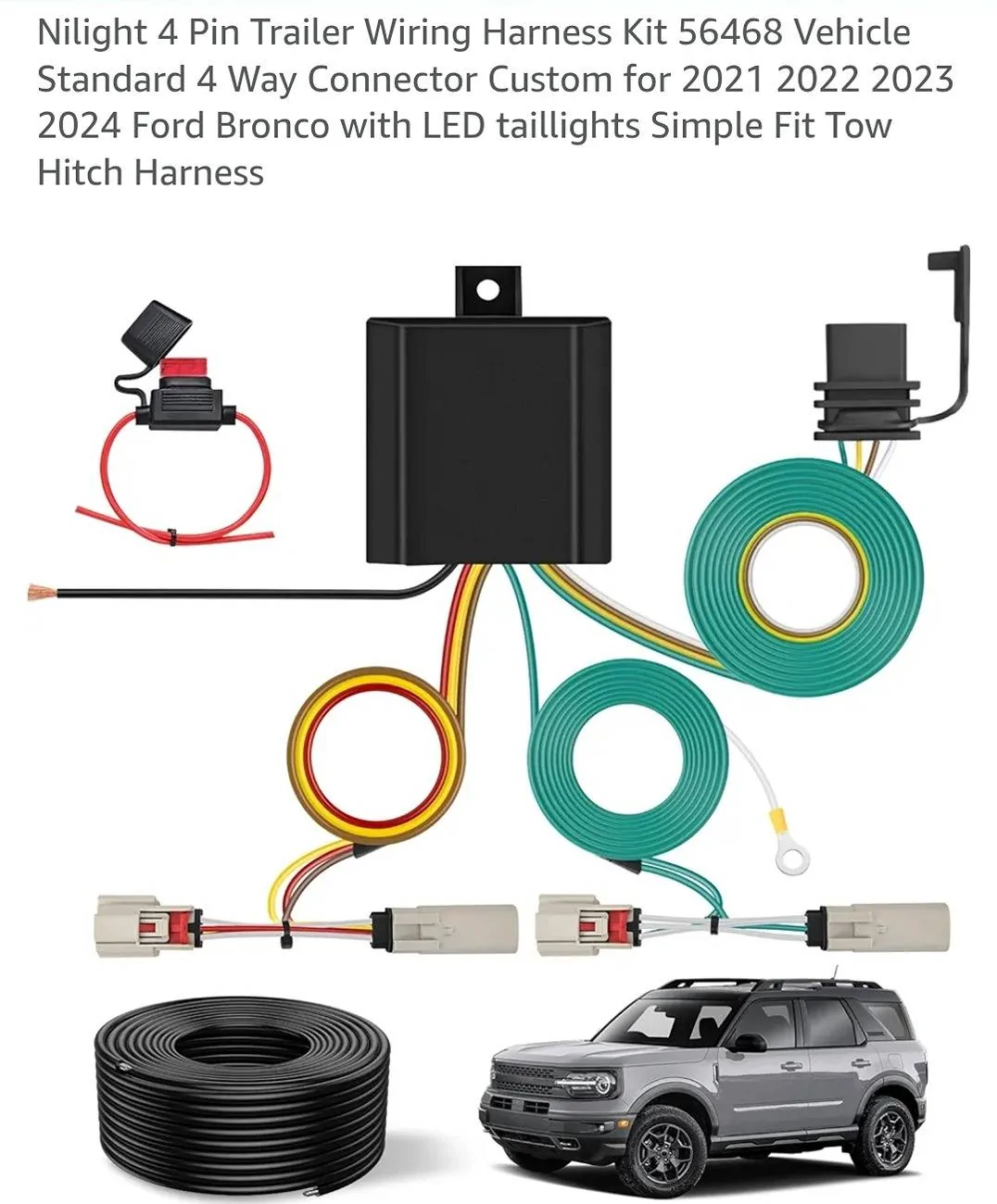

I used the generic version of a Curt 4-pin which has some black box that takes the LED taillights signals/current and effectively transfers it to the 4-pin and trailer lights and signals work.
~$40-50 on Amazon; ignore the Sport in some pics, lol.
Ford Bronco Trailer lights 1000028293
https://a.co/d/9nXSkfj
