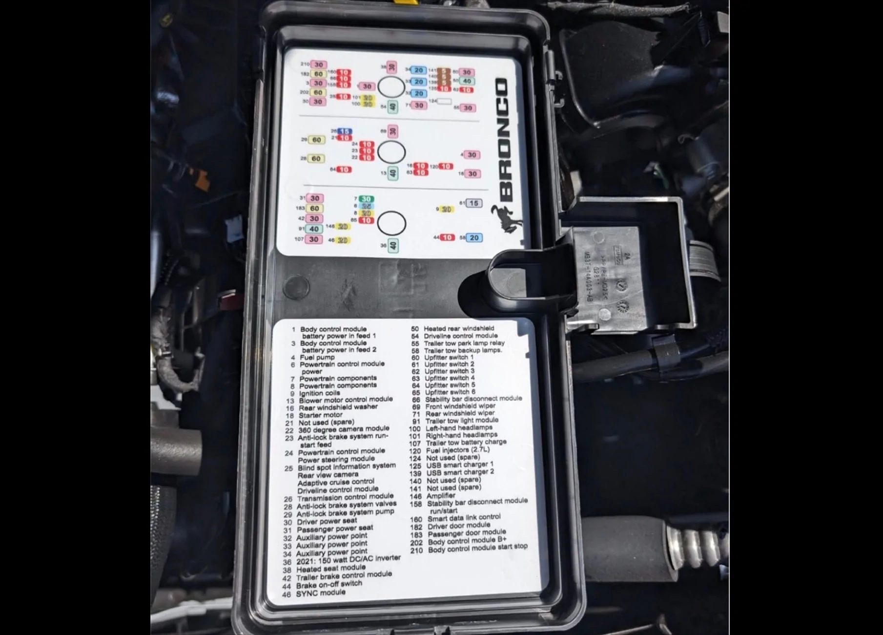

Lost power to my trailer lights thinking it's a fuse. Looking at the manual it could be 1 of 4 not real specific in manual. Anyone know witch one it is.

When you say trailer lights, you talking about turn, stop, marker, all? Factory tow package or add on?

There are 5 in the box under the hood I would check.
Ford Bronco Trailer lights fuse 1685016631657
Ford Bronco Trailer lights fuse 1685016769947
Ford Bronco Trailer lights fuse 1685017018564

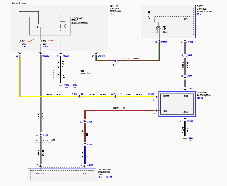

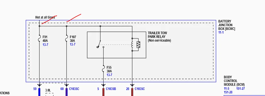

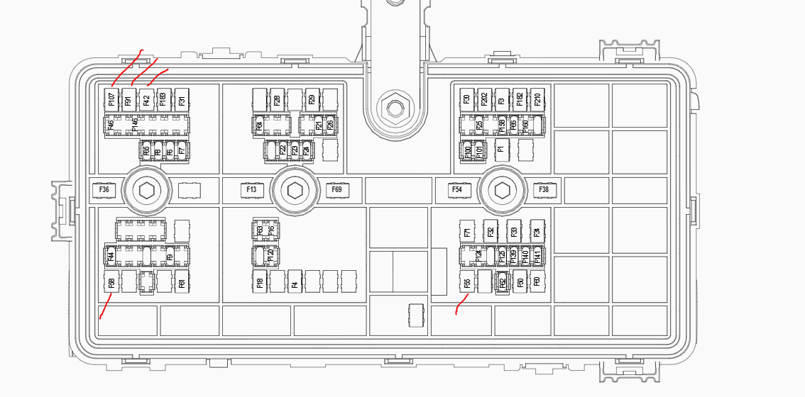

Update. I figured it out. I had a 30 fuse blow from when I backed my boat in and awhile ago and the light was exposed. I found this diagram someone posted online that helped me narrow down to the the 3 trailer light fuses. Once I replaced it it fixed the problem. Hope this helps.
Ford Bronco Trailer lights fuse IMG_0214
