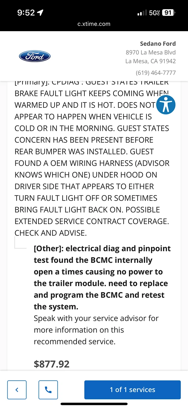

Good for you. They just sent me this.
Ford Bronco Trailer Brake System Fault IMG_4234

That ended up fixing my problem for now. New BCMC warrantied by ford.
