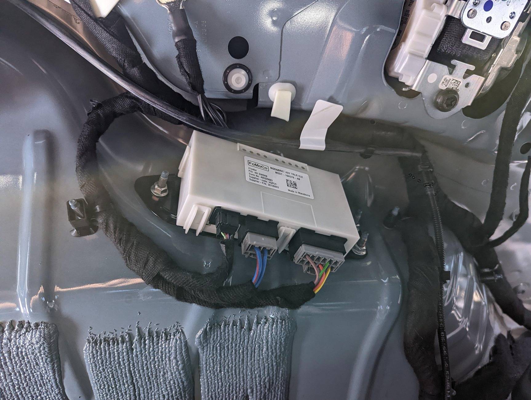

Try unplugging the connector on the right side of module.
If the issue goes away, the issue was not with the tow module, but the wiring that leaves it.
Keep in mind you will not have brake trailer lights functioning.
If you had the wiring added, there could be a problem at the connector,

That orange wire in the harness I'm talking about, is the battery charger for the 7-pin connector.
That is regulated by the relay internal to that module.
That is fed by one of those blue wires in the center of the module.
To my knowledge, there's been no software /firmware update to that module.
If battery voltage is jumping around, and you hear clicking, that is a good indication that there's wiring fault, ground fault.
Temporary removing of the right connector, if the faults go away, you've isolated the issue the wiring.
That right connector's wiring goes up to the driver 's wheel well front side to a connector, then back to the 7-pin connector at the hitch. It touches nothing else.

Where is this module? I'm getting the same issue, though mine came with tow kit from the factory in 2022 but this past week the erroressage started showing up and shows up about 50x per drive haha.
RoverDude
Oct 28, 2021
327
378
Maryland
2021 Bronco (First Edition)
Cargo area driver side underneath the plastic trim
