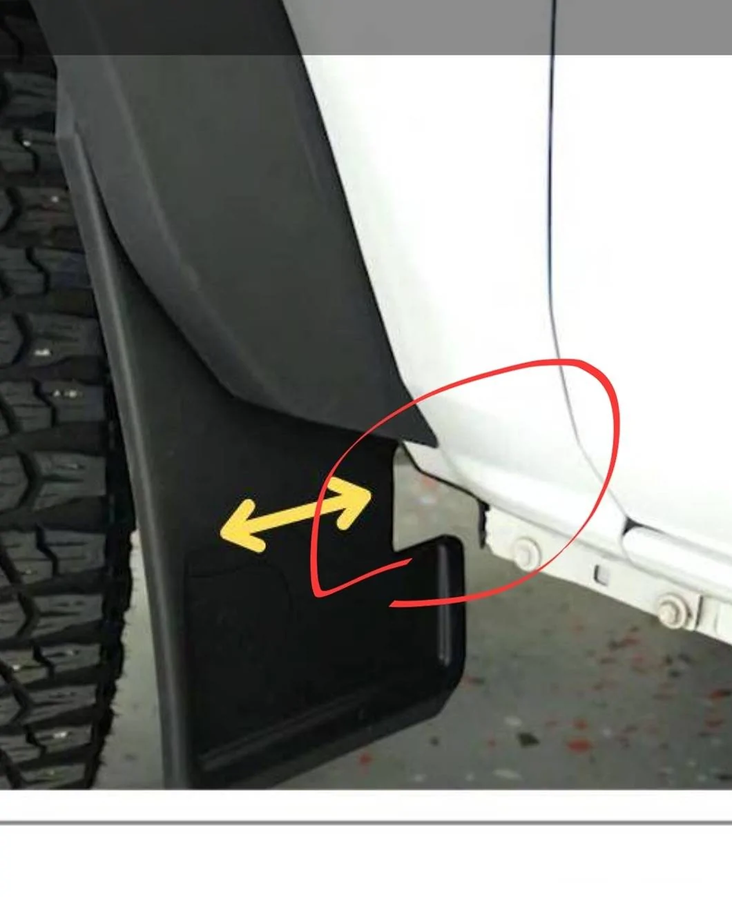

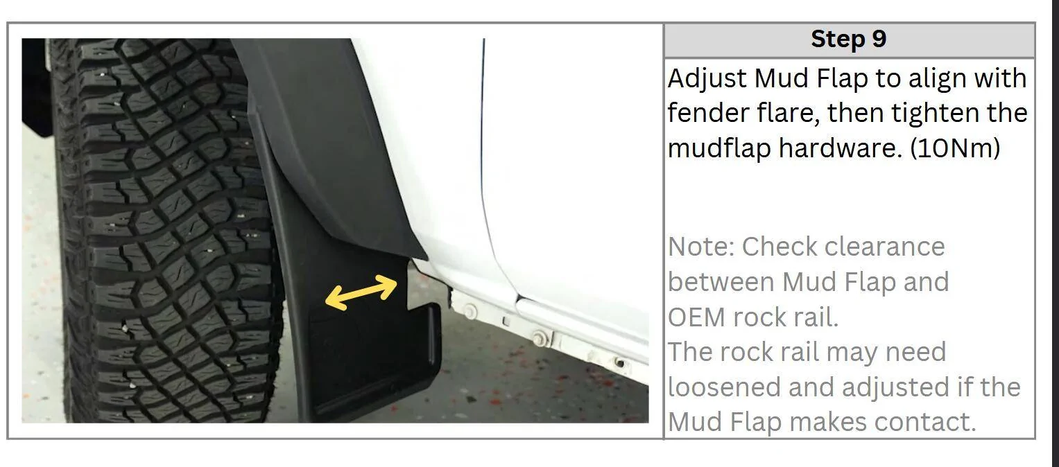

Has anyone installed these with Ford OEM Rock rails? When going to install the flap on the front, the rock rail is pushing into flap so you can't install it? Instructions say to loosen and adjust the rock rail, but as far as I'm aware there's no adjusting the rock rails.
I have a 23' Sas Badlands

We have installed these on vehicles with the factory rock rails. The tip of the rock rail should just barely touch the mudflap. The rock rails don't have a ton of adjustment, a quarter inch or so in either direction, but should be enough to give a little additional clearance. Shoot some pics over via email or DM and we can take a look!

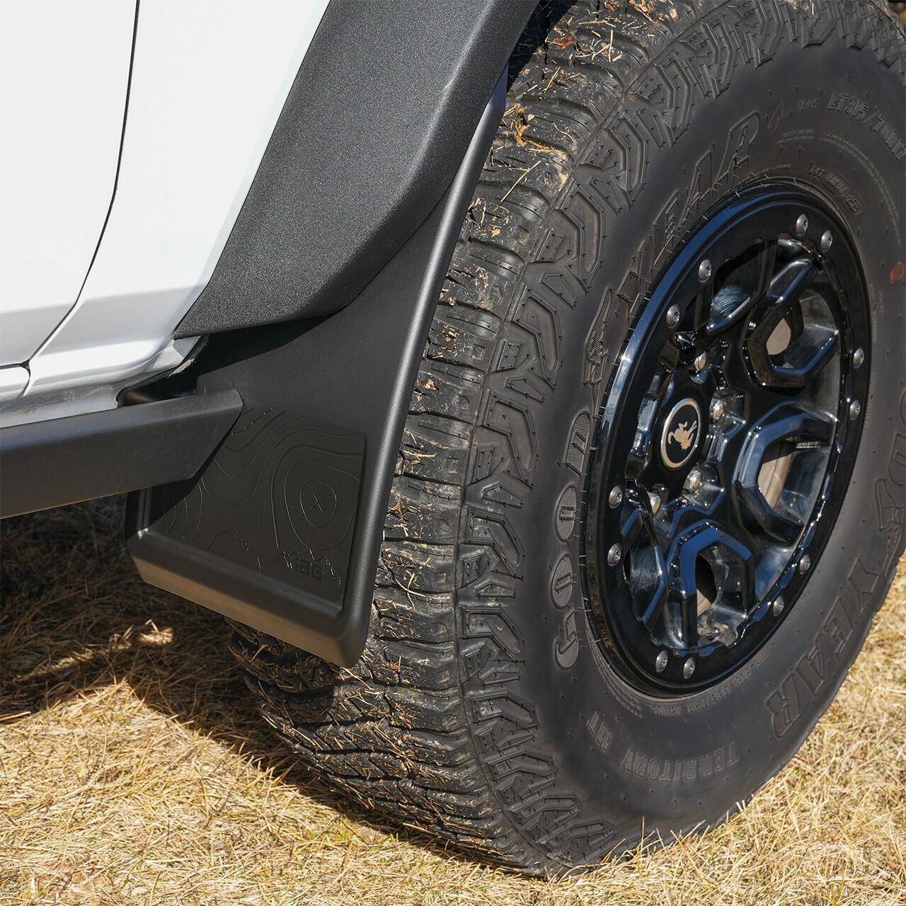

You mean the factory rock rail - though earlier you seemed to indicate the rail was meant to just touch the flap; why then need a pass through?
The cutout is for the factory crash bar, not the rock rail. The white truck pictured does not have crash bars as it is a SAS model.
