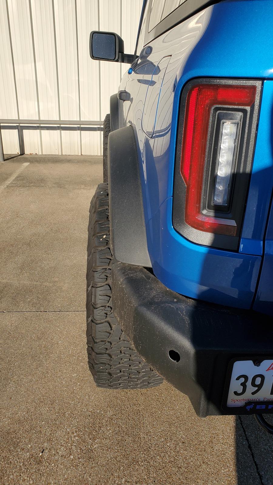

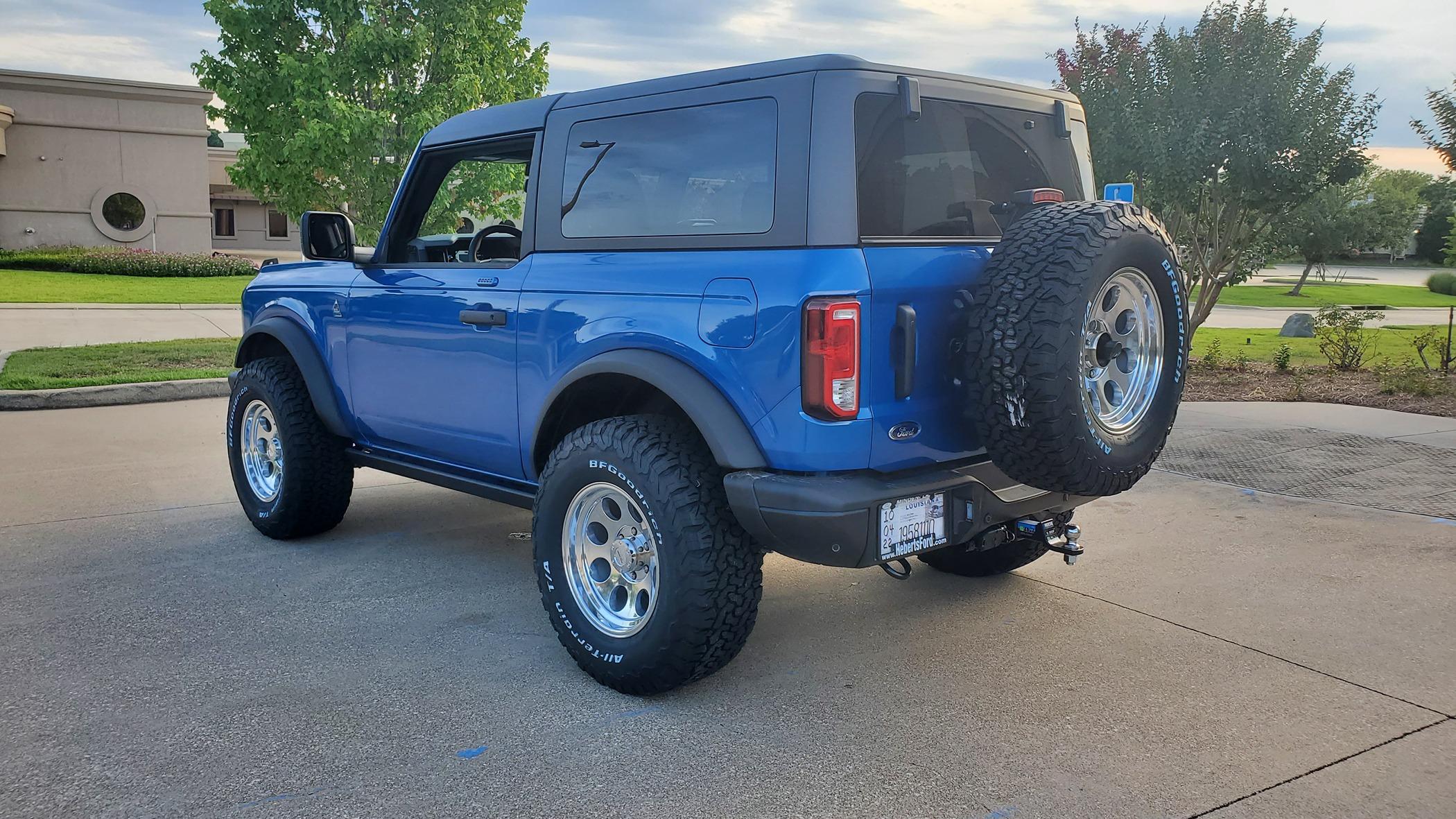

I'm a pizza cutter guy, ran the 35 x 10.50s on the stock non-squatch wheels (8" wide +55mm offset) prior to jumping to 37 x 11.50 pizza cutters on a 9" wide wheel w/ +12mm offset. With that being said, the tire manufacturer will specify a max wheel width for mounting. The Method wheels may be too wide for a 10.50 tire.
