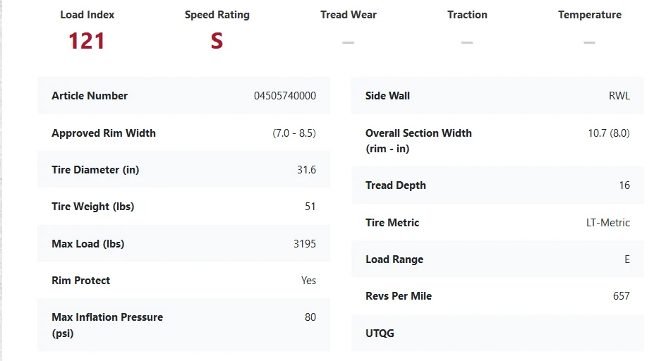

Double check what your load rating is to confirm, S/L, C or E?
Per generaltire.com the max is 8.5" width:
https://generaltire.com/tires/light-trucksuv/grabber-atx
Ford Bronco Largest wheel width for BD stock tires? 1638033513128

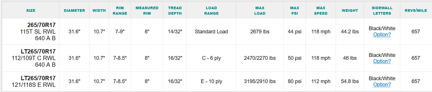

Per tiresize.com the max is 8.5" width:
https://tiresize.com/tires/General/Grabber-AT-X-265-70R17.htm
Ford Bronco Largest wheel width for BD stock tires? 1638033388060
