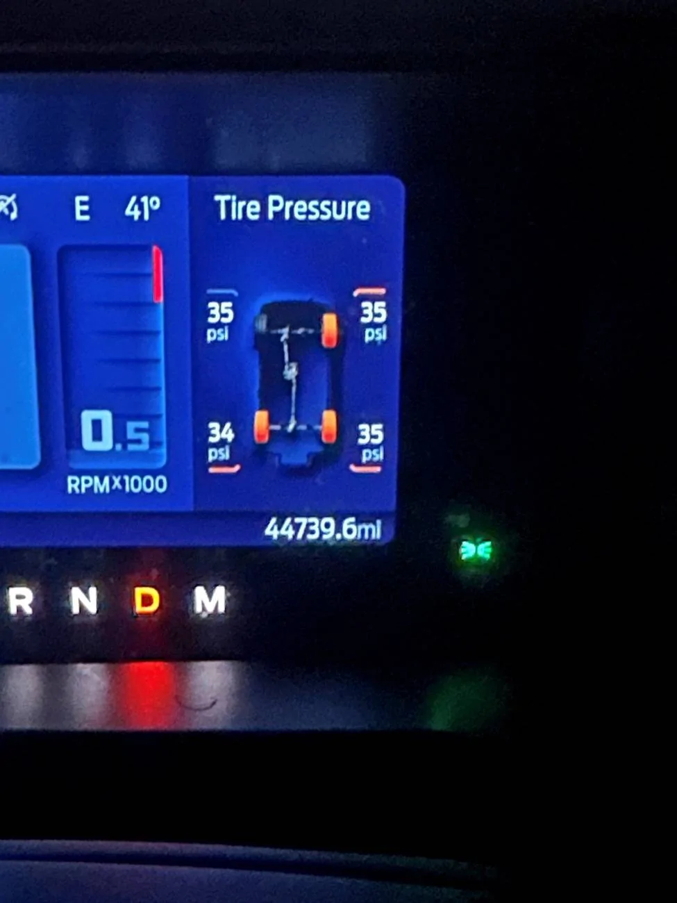

We had our first couple days of cold weather in Dallas which caused my TPMS Warning to come on showing 29psi in each tire. I inflated all to ~35psi and I'm still getting the warning 24 hrs and 50 miles later. Is there a reset on this?

2021 Bandlands non-sas. I've always run around 33-35psi. It's weird if you look at the picture that 1 tire at 35psi doesn't have a warning, but the other 2 at 35 do.
I think I'll give it another day to see if it goes off.

This is what happens with mine: I like to run around 35psi. I don't get warnings precisely at 32psi; I don't even get them at 31psi (with the cold weather this week, had three at 31psi but only one in warning). They will all get back to 35psi, but the one in warning will not go away right away. So I think what's happening is the psi shown is an approximate/rounded number, but the computer is looking for a combination of say 31.5psi for a period of time, plus 35.5psi for a period of time, before turning on/off the warning per tire. Or something thereabouts. This has happened several times and is annoying, of course.
