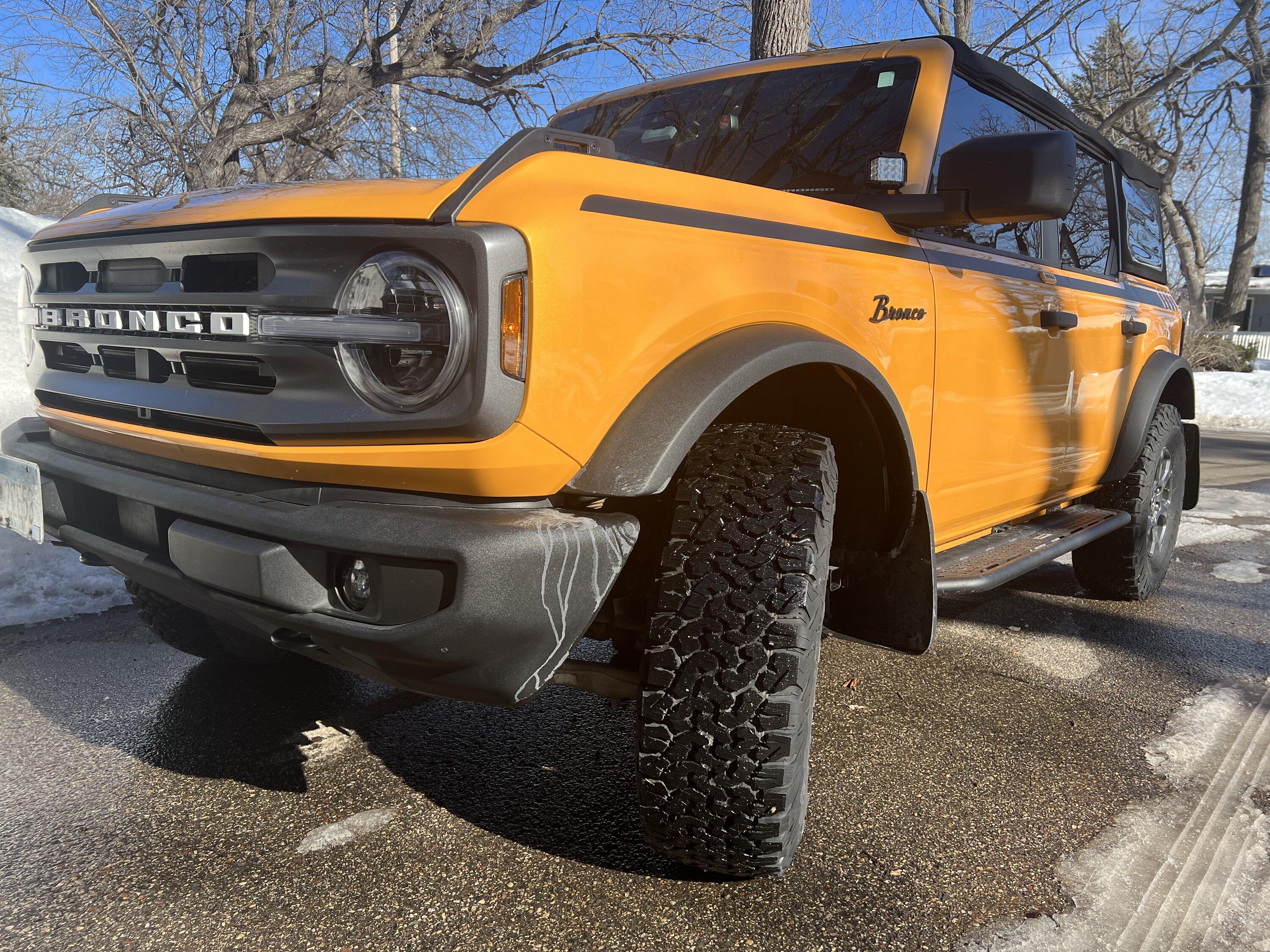

Thanks @dgorsett for the advice one spacer made a big difference on it fitting better with the additional width and those spacers. One did the trick for me and two wouldn’t have left me enough thread for the lug nut.
Here is a picture of my KO2 285/70/17 on my just washed Bronco. I feel like pictures does t do it justice cause in person it looks way different.
Before new tires:
Ford Bronco Tire newbie looking for advice 939365A7-4448-4D5A-A86D-98460BE04502
After new tires:
Ford Bronco Tire newbie looking for advice 2644D64D-45DE-4C63-87FD-E30999B2A028
Ford Bronco Tire newbie looking for advice 15ABAA85-95F1-42AF-896B-0B1CBCDA607C
