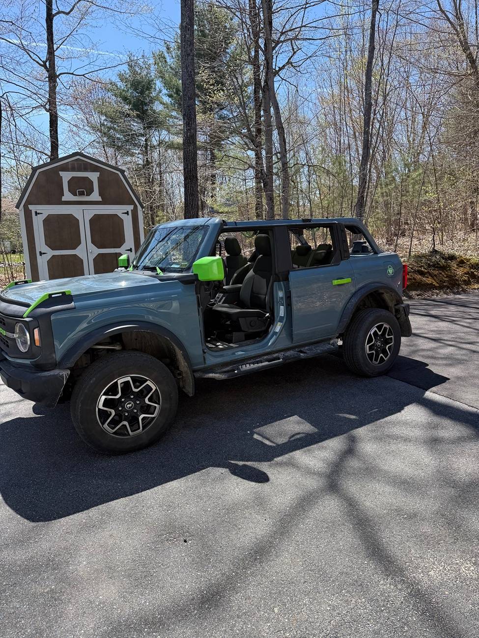

I am looking for advice, I want to put on the biggest and widest tires I can for all terrain. I have a 3” lift, and I have 1-1/2” spacers on all four of my wheels. I don’t mind removing the crash bars, I’m just not sure what size tire to go with, I would like to put on 35’s, oh and my bronco is a 2022 base model with a four cylinder. My rims I bought off from someone, they are 18” rims.
Ford Bronco Looking for advice on biggest and widest tires IMG_0735

37s 100%. Good luck.

You can easily go to 35, or 37, but 18" rims are tricky (not many tire choices).

With the +55 OEM wheels and 1.5" spacers your good up to 35 x 12.50, just pull the crash bars. Not a whole lot of options for 18" wheels tho.
So if I bought some 17” wheels I would have more options?
These are available in a 36.8"x13.3" (real size) in 18":

Ironman tires makes the All County MT in 35x12.5r18. Although I had them on my 2 door wrangler and I thought they were heavy, loud, and just trash tires. But they look decent I guess.

Your lift is irrelevant.
Have you actually measured clearance when turning your wheels to see what your scrub radius is?

I have 37x13.50r17s…think that is about max on bronco without serious modification…
