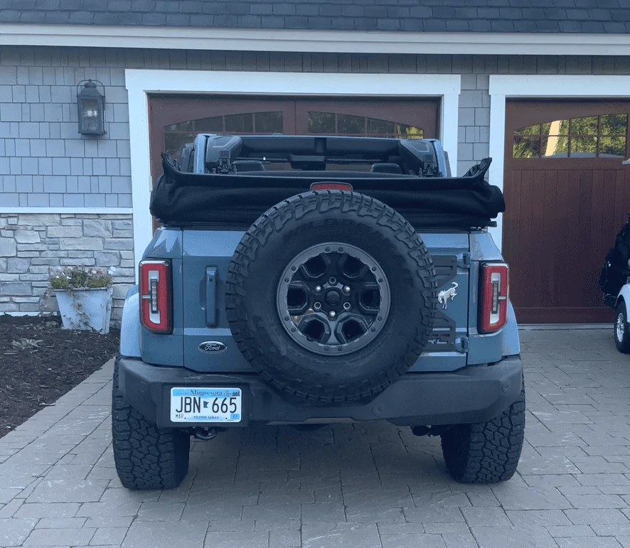

I replied to your post in the 33s thread. Im probably going Falken Wildpeaks . They claim they hold less rocks in the tread because of the design. I looked at the Rubitreks as well but you cant get them in a c load range in the 285/70/17. Ive seen a few badlands broncos on lots with Ko2s on them with rocks stuck throughout the tread so that eliminates them for me too unless i can find a cheap takeoff set. New they cost at least 50 bucks more a tire than the wildpeaks too.
The Wildpeaks throw rocks dramatically less than the stock Sasquatch Goodyears and also less than the K02s. You will love the Wildpeaks! I got mine at Discount Tire on a price match at 4WP. I'm not sure if $249 per tire is the best deal but it's a fair price.

@MnLakeBum How is the ride on the Falken Wildpeaks, are they as quiet as the KO2's?

I haven’t had the KO2’s but I’ve been in my buddies Rubicon that has them and the Wildpeaks are certainly not noisier. The techs at the truck shop that did my tires and lift kit recommended the Wildpeaks and they aren’t any noisier than the stock non-Sasquatch OBX tires. Wind noise with the soft top is what you hear above 50mph, not the tires.

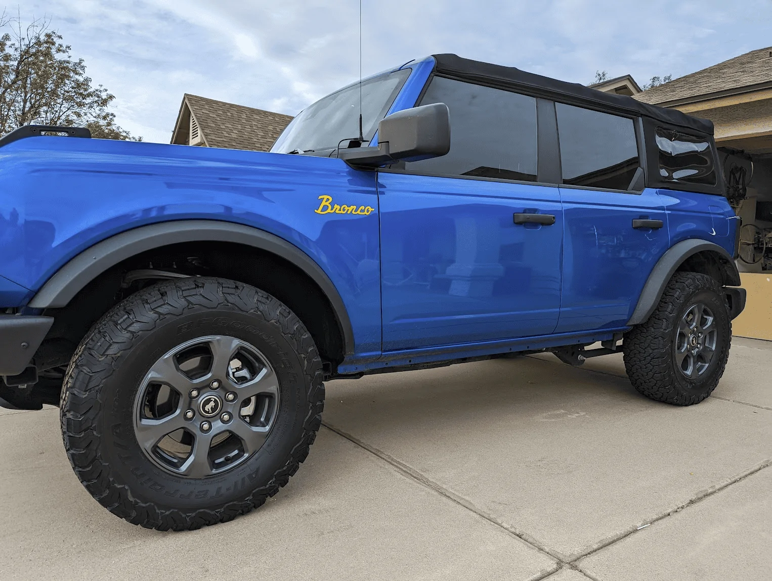

If it helps, I just got your first choice tire installed on mine last week, same size even. There's zero rubbing and the ride is great:
