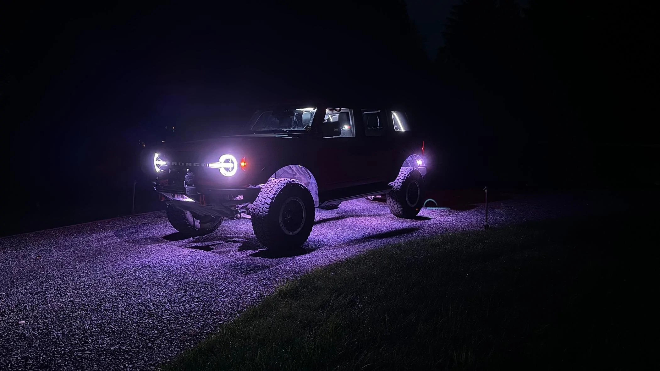

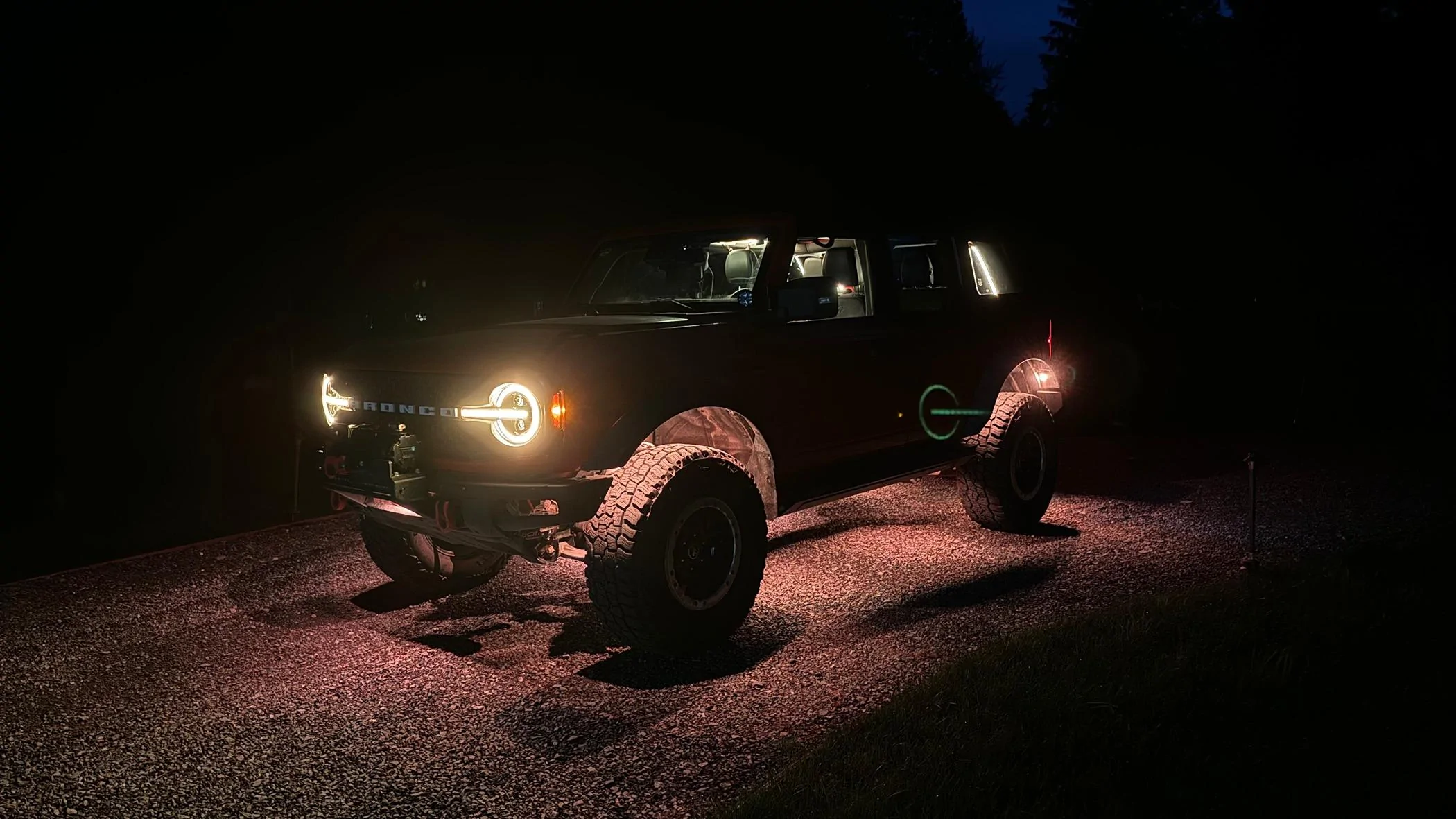

I’m sure I did it all wrong but have 2 cheap eBay lights in each wheel well and on at each end of each rocker skid/step…better than nothing…
I did not realize there was a wrong way to do it... It looks like the ground is lit up underneath you. I think if you had pointed them up toward the bronco it might have not worked as well.... But wrong? I don't know about that. I think it looks great and should be helpful when you are out on the trail in the dark!

Thanks!…I am happy with them so far….A Little sarcasm for the folks/posts here with fancy (expensive) lights and/or saying not to put them in wheel wells…Party on!

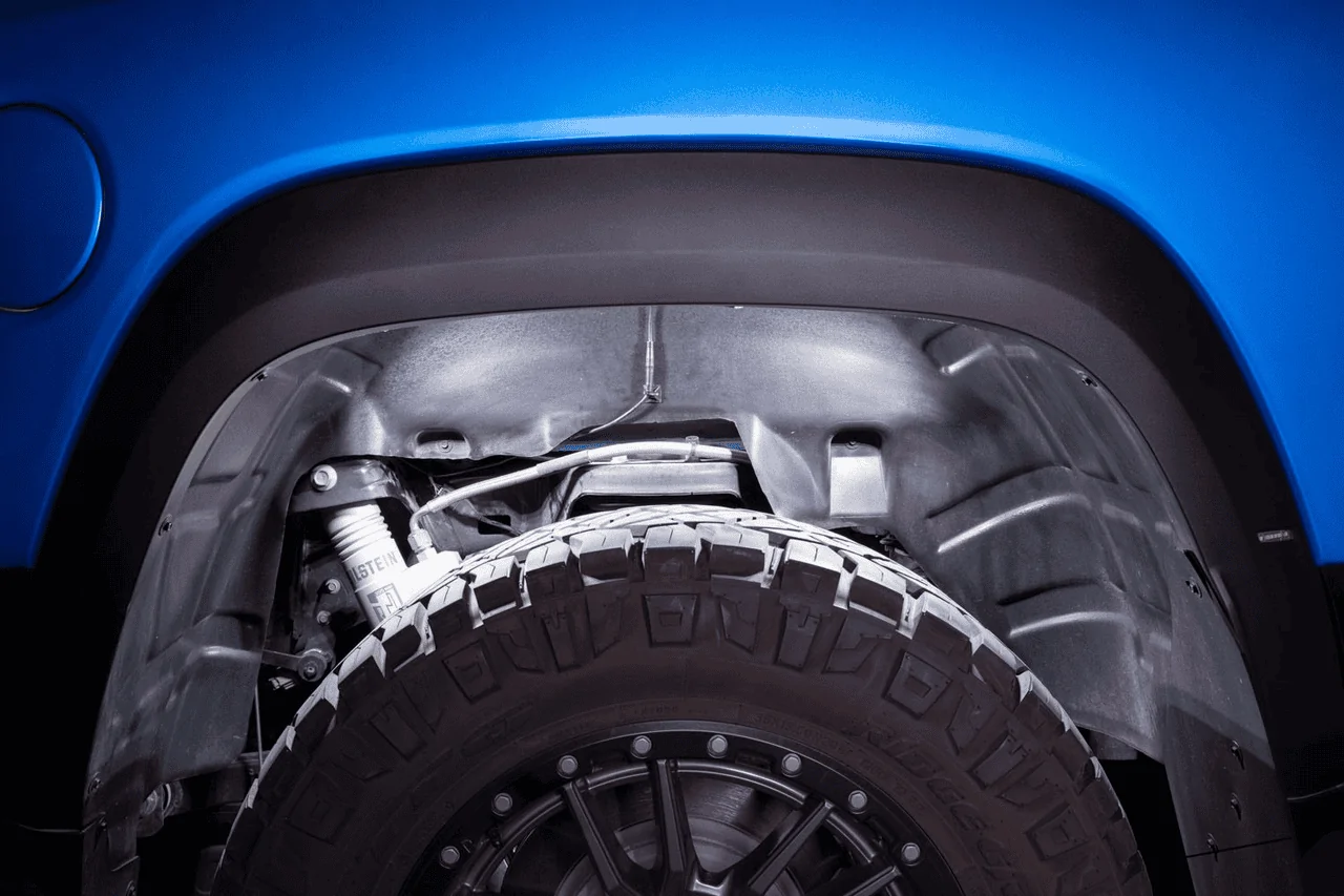

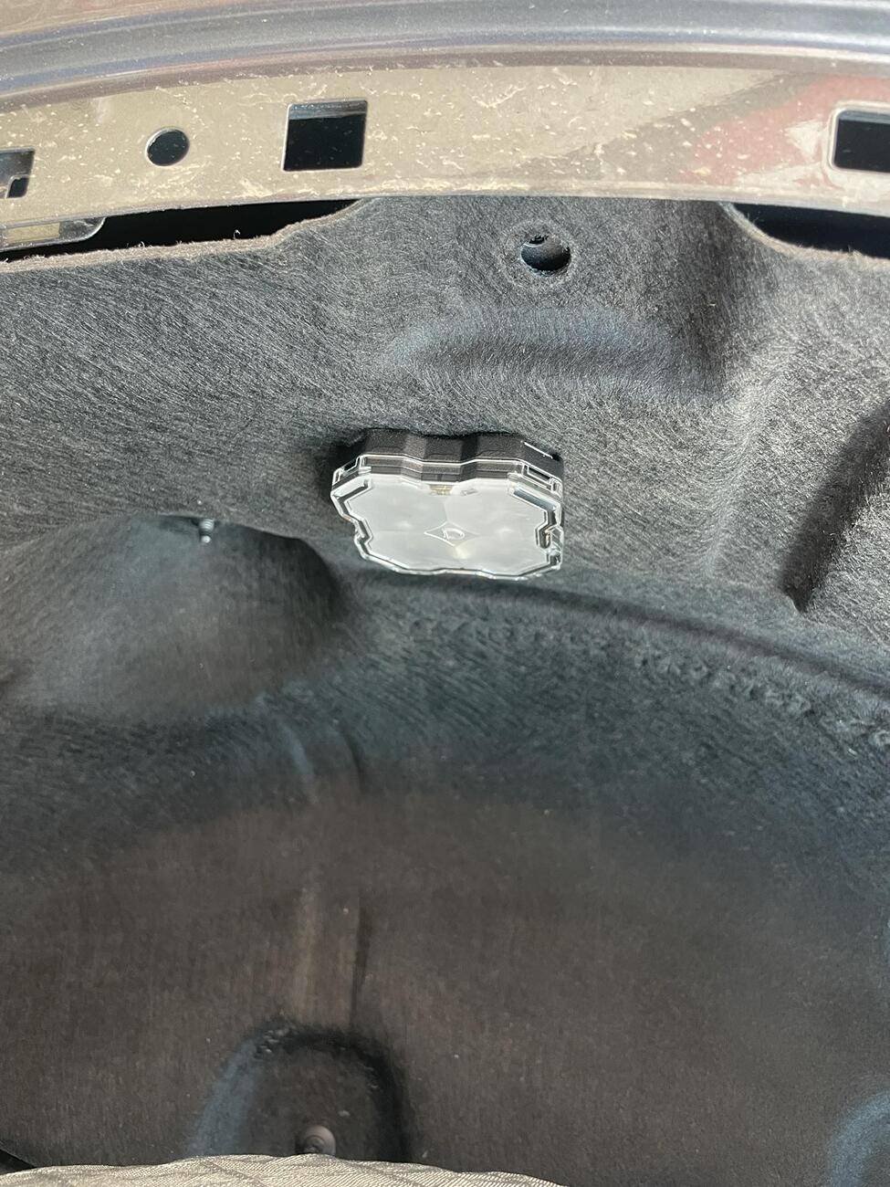

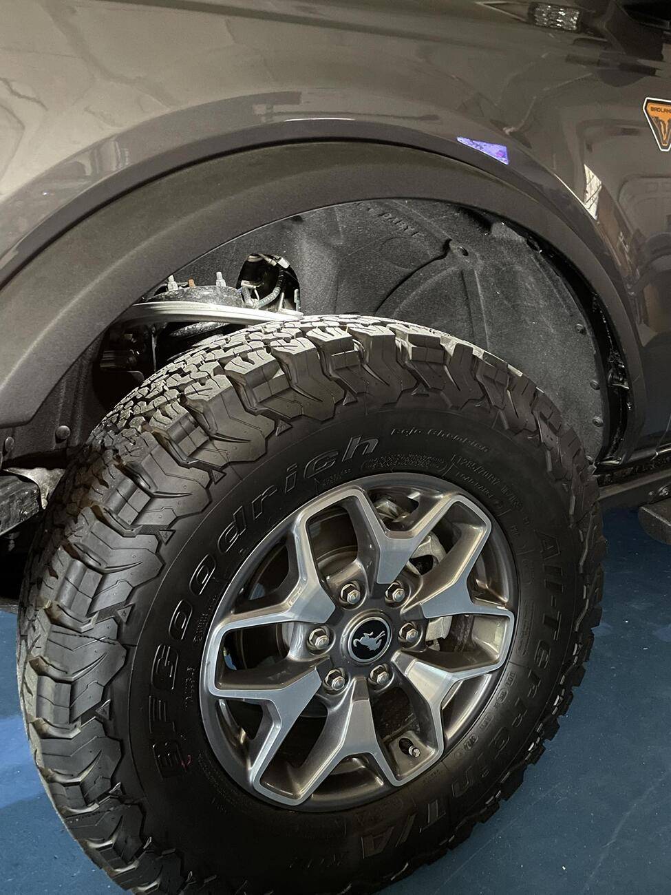

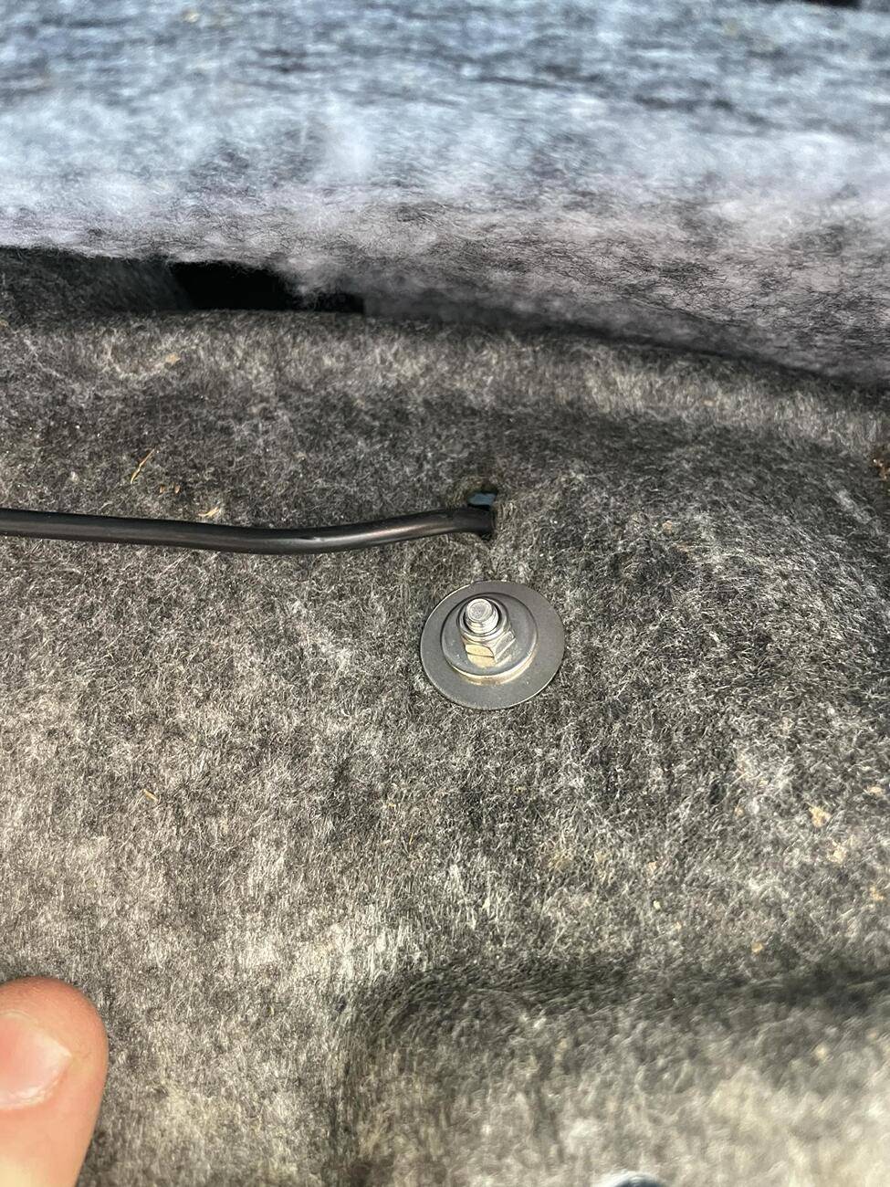

Here ya go. Some photos from todays install. Pretty easy. Pull your mudflap off. Remove some bolts/screws from the liner and pull it down. Then you can put some holes in the liner and install your rock lights. In the case of the DD ones we did the RGBW kit so we made 2 holes (1 for the wire, 1 for the bolt). I also used a larger washer to ensure it didn't pull through but that liner is pretty strong.
That’s a clean, nice install! Thanks for sharing and forfor helping me correct my order. I think I still have a set of street-glows in my garage that I was going to put on my 2010 Camaro. I have some lighting trendz flow series I need to put on my challenger scat but the bronco has gotten more attention from me than any car I’ve owned.

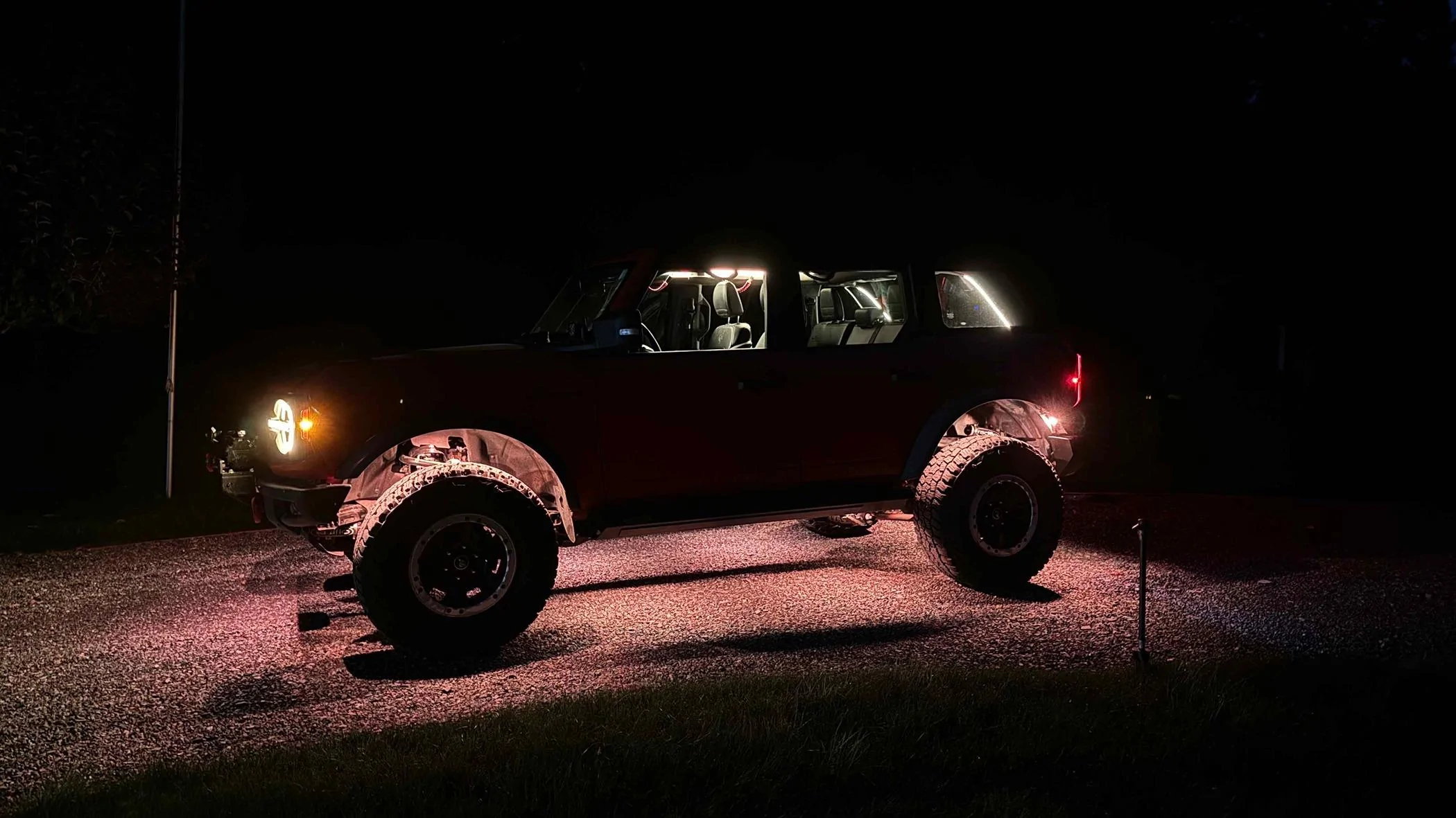

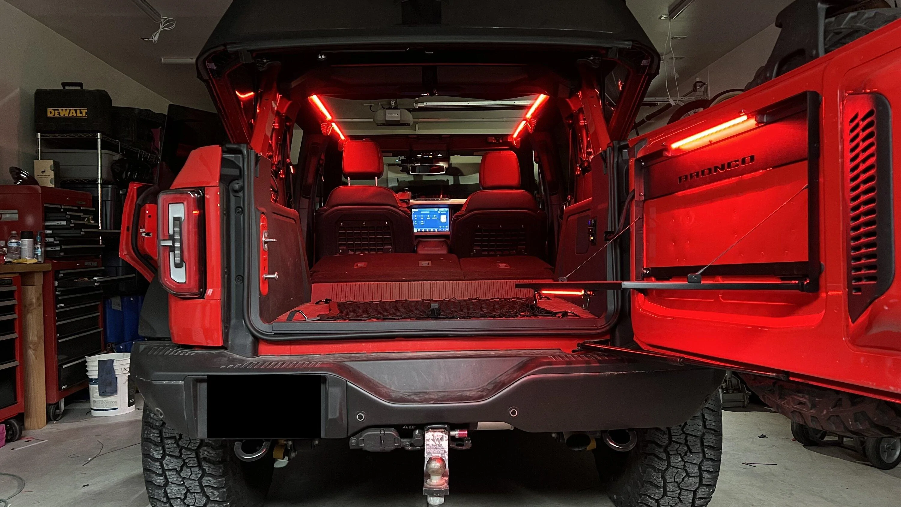

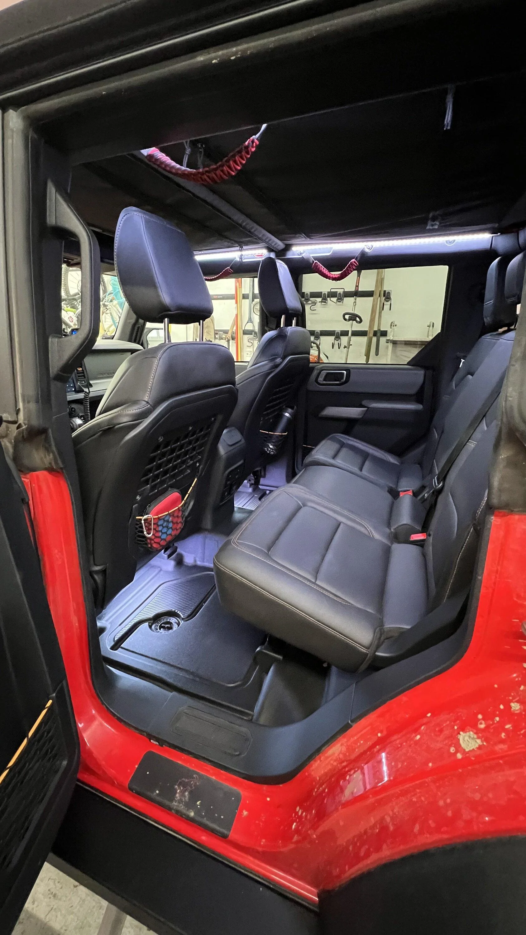

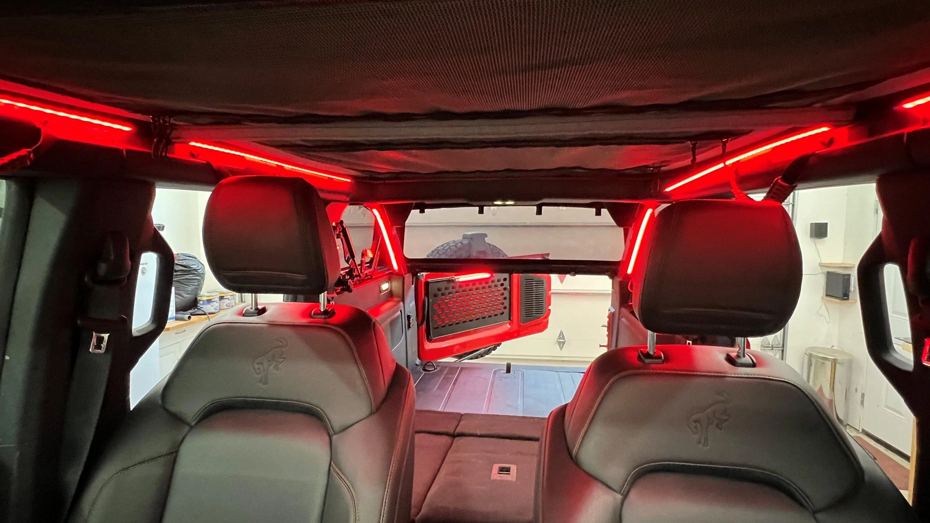

I installed ~18 pods, found a LED controller that uses the same app as my headlights, also a couple more controllers for the two LED zones in the cab. All the zones are sync'd or can change individually. Pretty much had to solder everything, 4 or 5 tiny wires per pod, soldering extension wires then to pigtails, must have a few hundred solder joints. I don't really use them often, I've probably used them more when I'm working underneath the Bronco than on the trail, lol. The interior lights are more practical, I lit that mofo up.
Love the interior lighting
What did you use? Brand/style/length?
