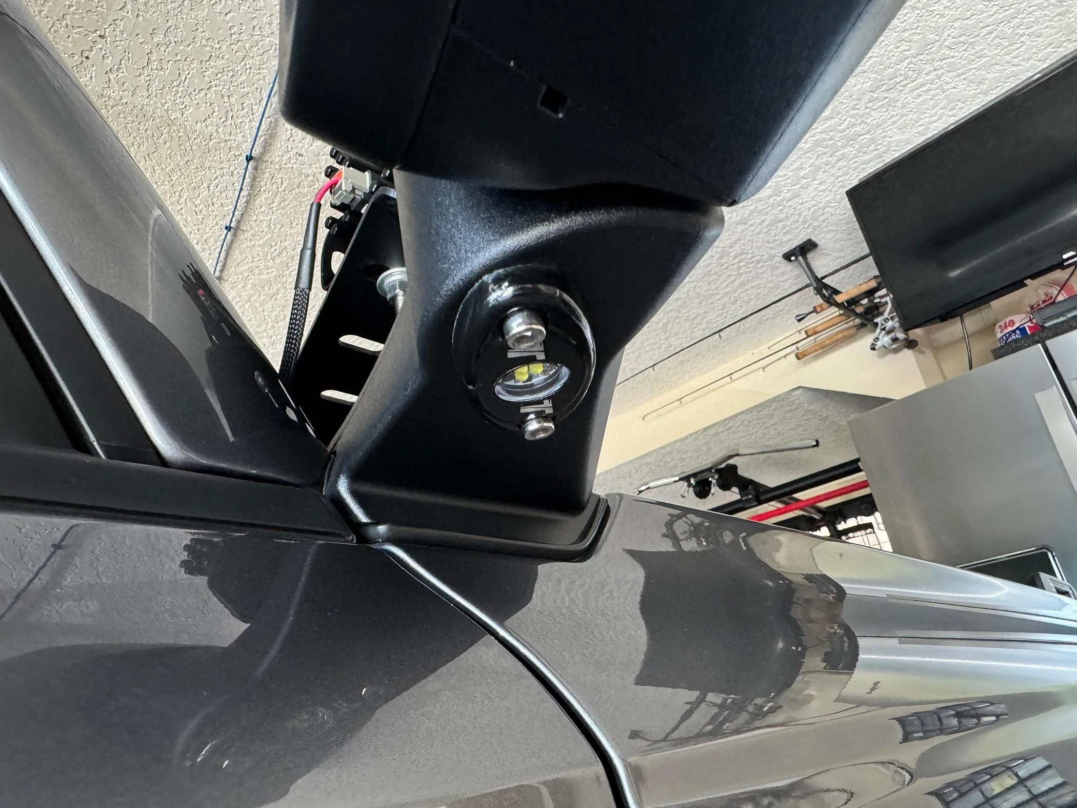

I don't have a need for rock lights but I did install 2 under my mirrors and tied into the dome light for puddle/approach lights.
Ford Bronco Thoughts on rock lights? IMG_8580

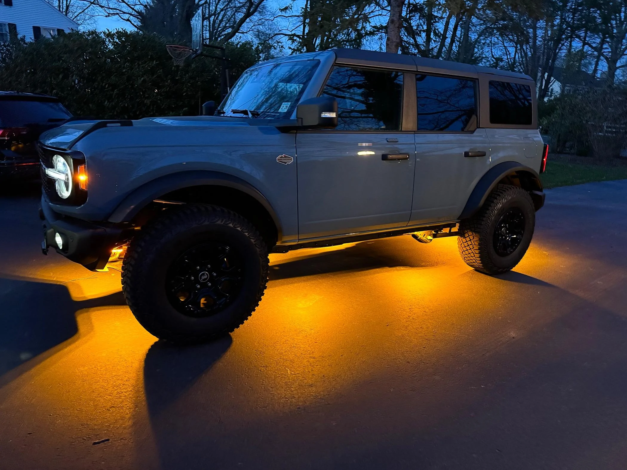

I went with Diode Dynamics. Very easy to install and high quality. I used the 8 pack but now they also have a 10 pack. The lights are white but I have the amber covers on.
Note: I moved the front two after I took this photo to eliminate the shadows.
Ford Bronco Thoughts on rock lights? IMG_4058

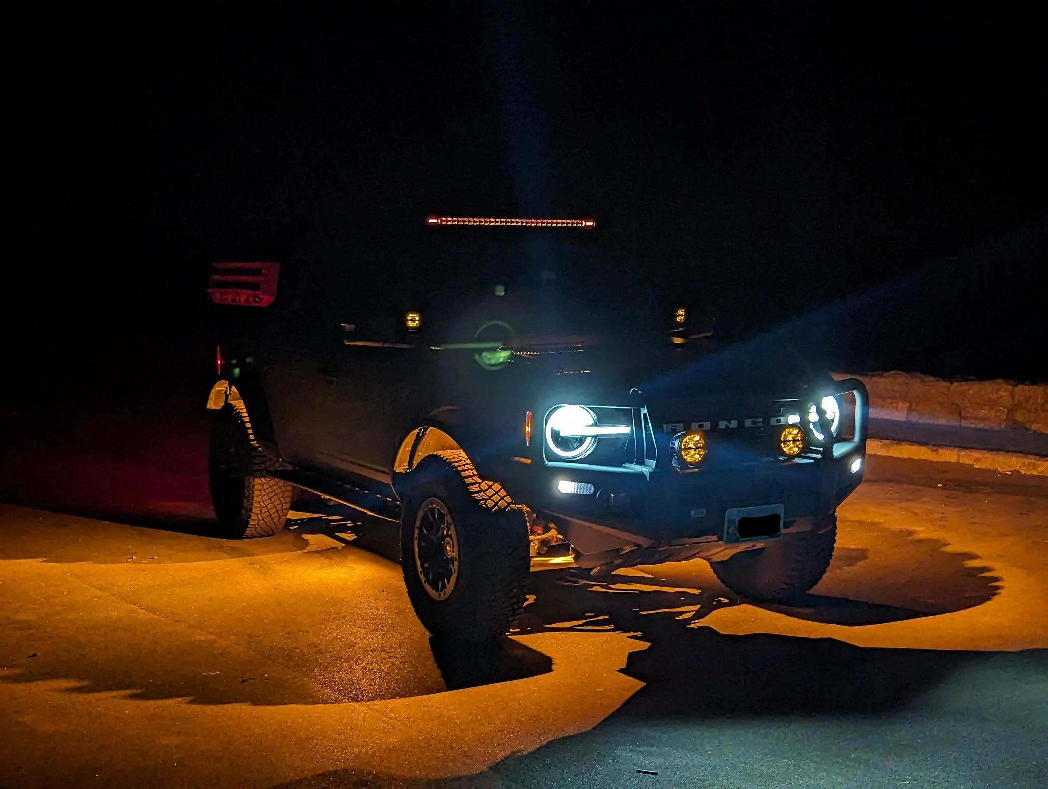

I installed ~18 pods, found a LED controller that uses the same app as my headlights, also a couple more controllers for the two LED zones in the cab. All the zones are sync'd or can change individually. Pretty much had to solder everything, 4 or 5 tiny wires per pod, soldering extension wires then to pigtails, must have a few hundred solder joints. I don't really use them often, I've probably used them more when I'm working underneath the Bronco than on the trail, lol. The interior lights are more practical, I lit that mofo up.
Ford Bronco Thoughts on rock lights? IMG_0173

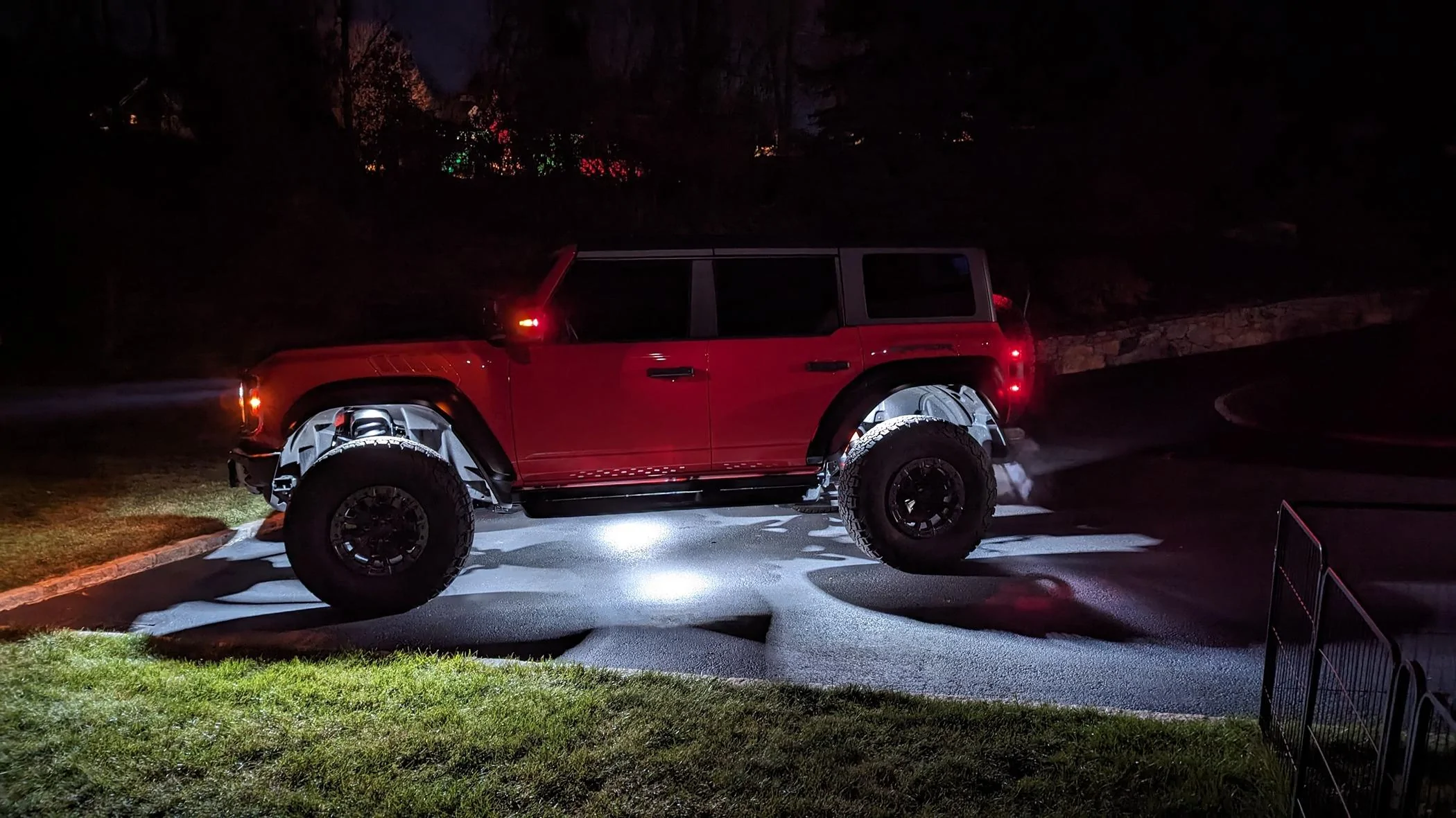

I have 6 of the rigid lights. I spent some time hunting around for where to put them in the wheel wells, and in general I'm pretty happy with them (I can get some pics of the specific positioning if you want). The one in the middle is mounted to the frame (using an existing hole.. but at the moment I can't recall how I did that.. I'll have to look tomorrow.. currently storming here). It's mounted to the side.. of the frame, not the bottom, but using some of the angled rubber mounts that rigid provided to point it down and out.
Wires from the back and middle are running through plastic conduit (that bendy stuff that basically comes in rolls). Mostly zip tied to whatever was handy and tucked away.
Drilled through the wheel well liners to run the wire behind them.. and then used water proof connectors after about 18 inches of cable from the light to make it easier to get the liners out when I (or the garage) needed to.
Using two relays for powering the lights. One connected to the upfitter switches, and the other connected to one of the wires for the under mirror lights ... that way the lights come on whenever the puddle lights normally would (unlocking the vehicle, opening the doors, that kinda thing).
Ford Bronco Thoughts on rock lights? PXL_20230906_004941538 (2)

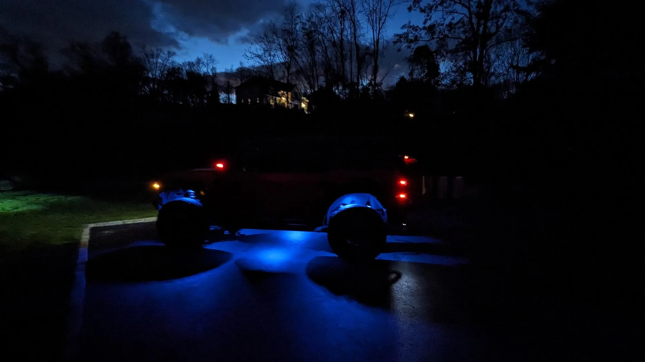

I went with the KC Cyclones 6 light kit (thought I'd need 8 but the 6 works well. The clear is SUPER bright! I switched to Blue - if I get hassled for illegal color I'd switch to amber or diffused white (although I think amber is also illegal in New Yorkistan also)
Original install thread:
https://www.bronco6g.com/forum/threads/kc-cyclone-v2-rock-lights-installed.85071/
Some pics for here:
Ford Bronco Thoughts on rock lights? PXL_20231127_220934399
Ford Bronco Thoughts on rock lights? PXL_20231125_232108260
