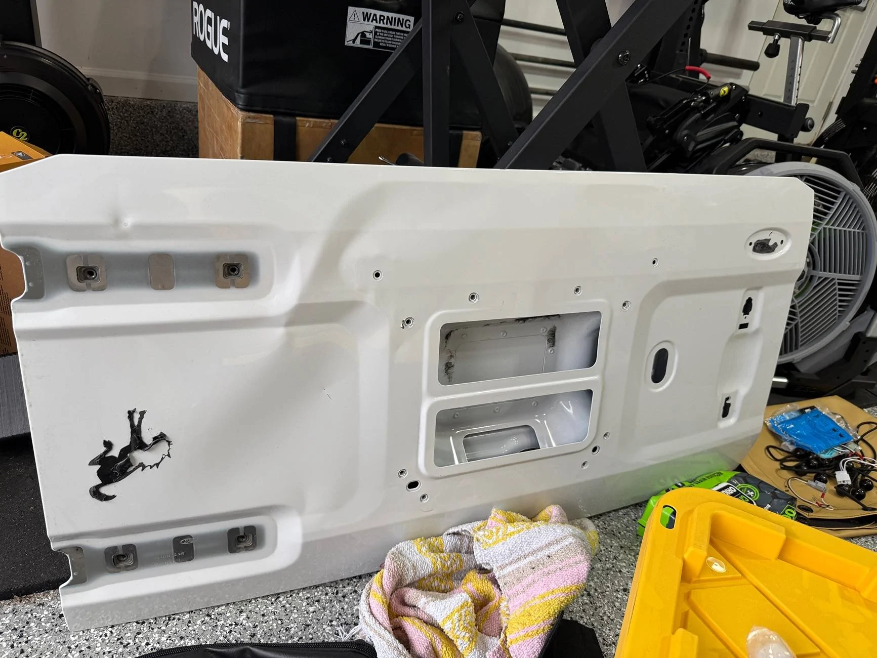

I decided to keep trying. I found a beat up dented tailgate on ebay in my same Oxford White. So I bought it and drove up to LA to pick it up. I brought it back to the body shop to see what it would cost to use that one, but they didnt want to touch it (even after I explained the tailgate reinforcement wouldnt cover up most of the dents so they didnt really need to do a lot of body work). Between the two body shops, I had the impression that they really just wanted that sweet insurance money and weren't interested in cash paying customers with niche issues.
Dented tailgate donor:
Ford Bronco The DEFINITIVE "hinge nut insert fell inside the tailgate" thread IMG_5745

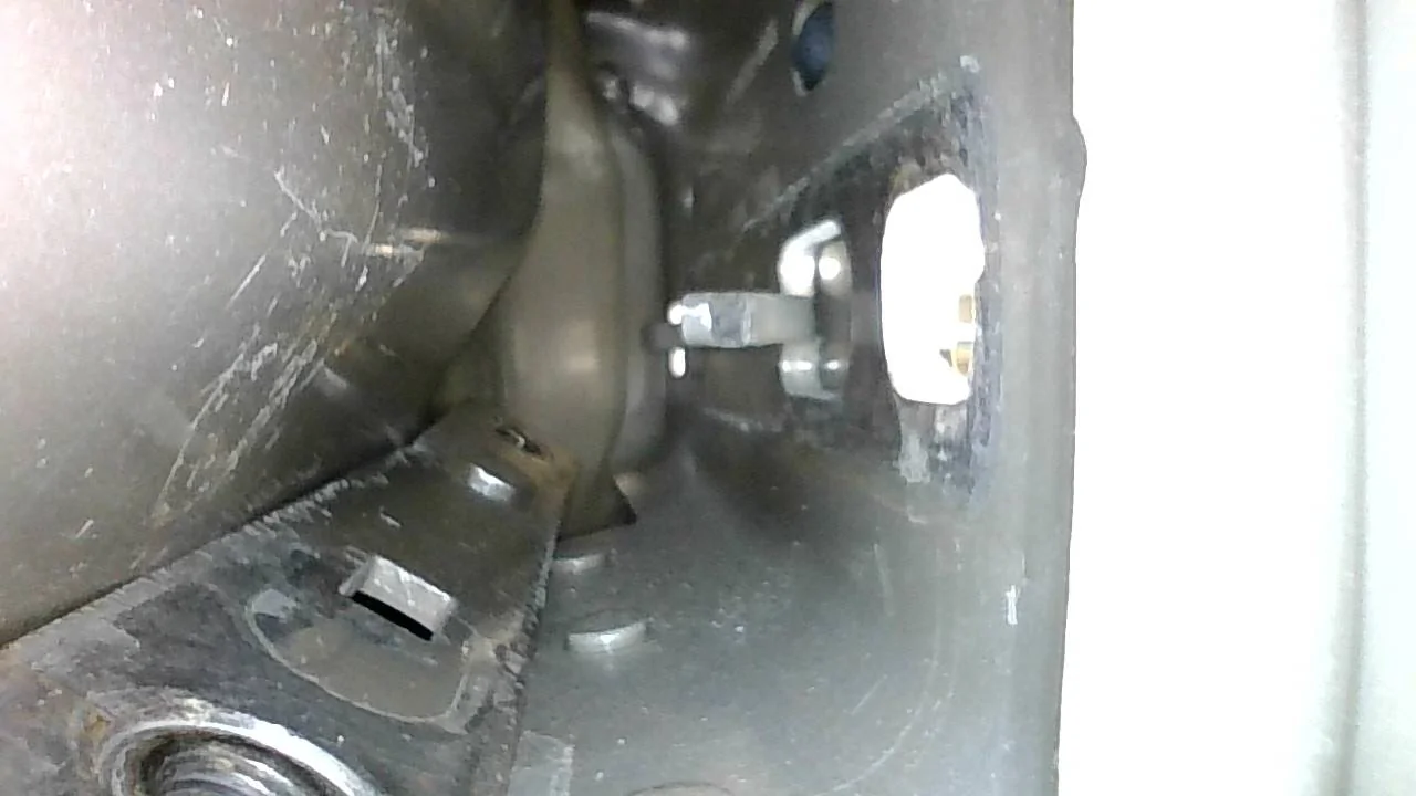

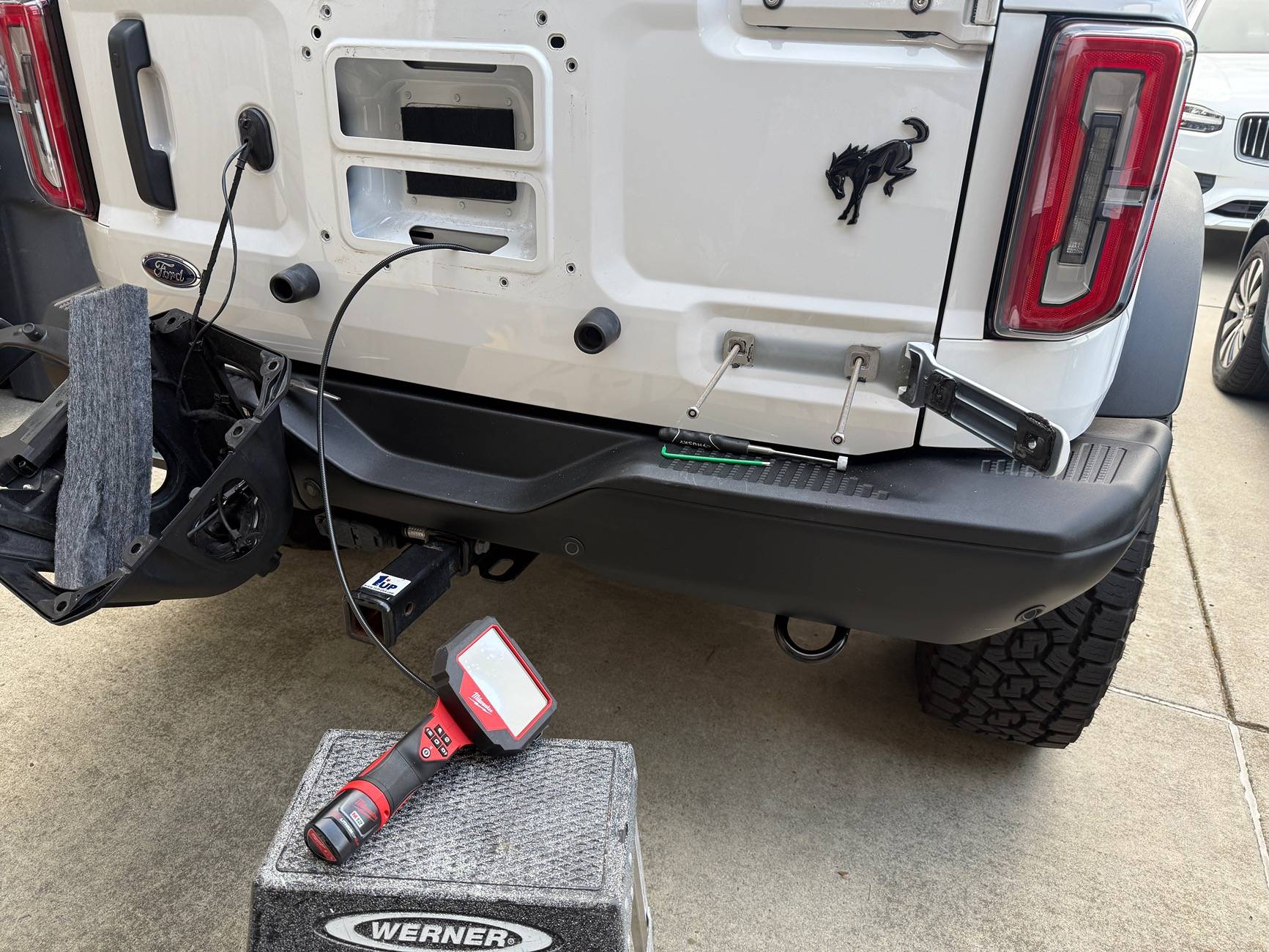

So I decided to spend more garage time. I bought a Milwaukee m12 borescope camera, a whole bunch of long needle nose pliers off amazon, and long M8 bolts. Using the boroscope, I first went into the dented tailgate to photograph what right looked like:
Ford Bronco The DEFINITIVE "hinge nut insert fell inside the tailgate" thread PIC00001

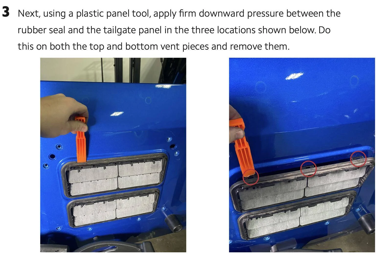

Then on my original tailgate, to get access for the borescope, I removed the vents on my using the JCR tailgate table instructions:
Ford Bronco The DEFINITIVE "hinge nut insert fell inside the tailgate" thread Screenshot 2025-07-06 at 12.35.06 PM

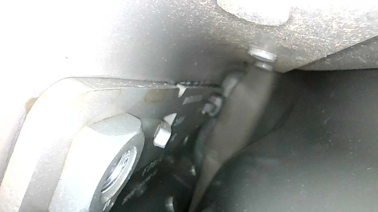

Then after removing the nvh fabric filler, I could get access to take a picture of what the problem was:
Ford Bronco The DEFINITIVE "hinge nut insert fell inside the tailgate" thread PIC00003
I could see that the bar was bent. So using the borescope camera, i used some craftsman hook tools to re-orient the bar so that the screw holes on the bar were lined up with the tailgate openings so that i could thread the long M8 bolts into the holes to maneuver the bar. After a lot of effort, I got both in there and could maneuver the bar. I could see through the camera that the bar was bent, as well as the hook. I could feel some flex in the bar, so I figured it being bent was how it came off in the first place. So i began twisting the bar inward and outward while pulling against the tailgate and VOILA! I felt it snap into place:

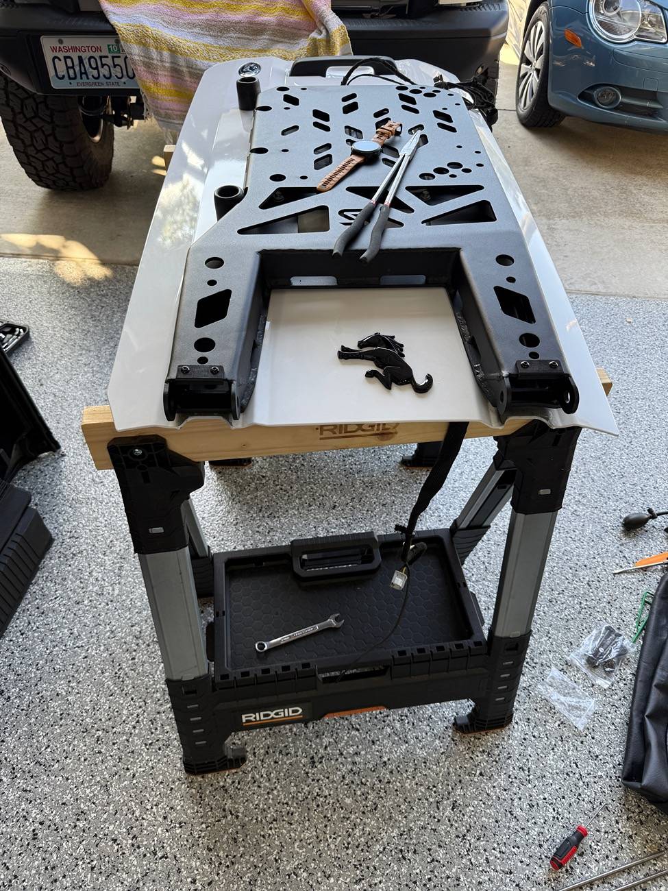

Then I tried again, but this time, as part of the Turn Offroad Install Process, I took the tailgate off and laid it flat face down on some saw horses. That made it SUPER EASY to get the plate lined up again. Highly recommend you do that if you're having problems %#^$-ing around through those tiny holes. Then I installed the tailgate reinforcement directly onto the tailgate with it still off the truck (different than the Turn Offroad Install video). Getting the heavy tailgate + reinforcement plate onto the Turn hinges was not jiving, so I eventually removed the hinges and mounted the hinges to the tailgate as well, then used the saw horses to hold up the whole tailgate while I bolted up the whole assembly to the bronco. I was doing this by myself, but I defintiely was not going to continue messing with nut insert while right side up. I got it all bolted up and the tailgate was aligned perfectly! Really impressed with the Turn system.
