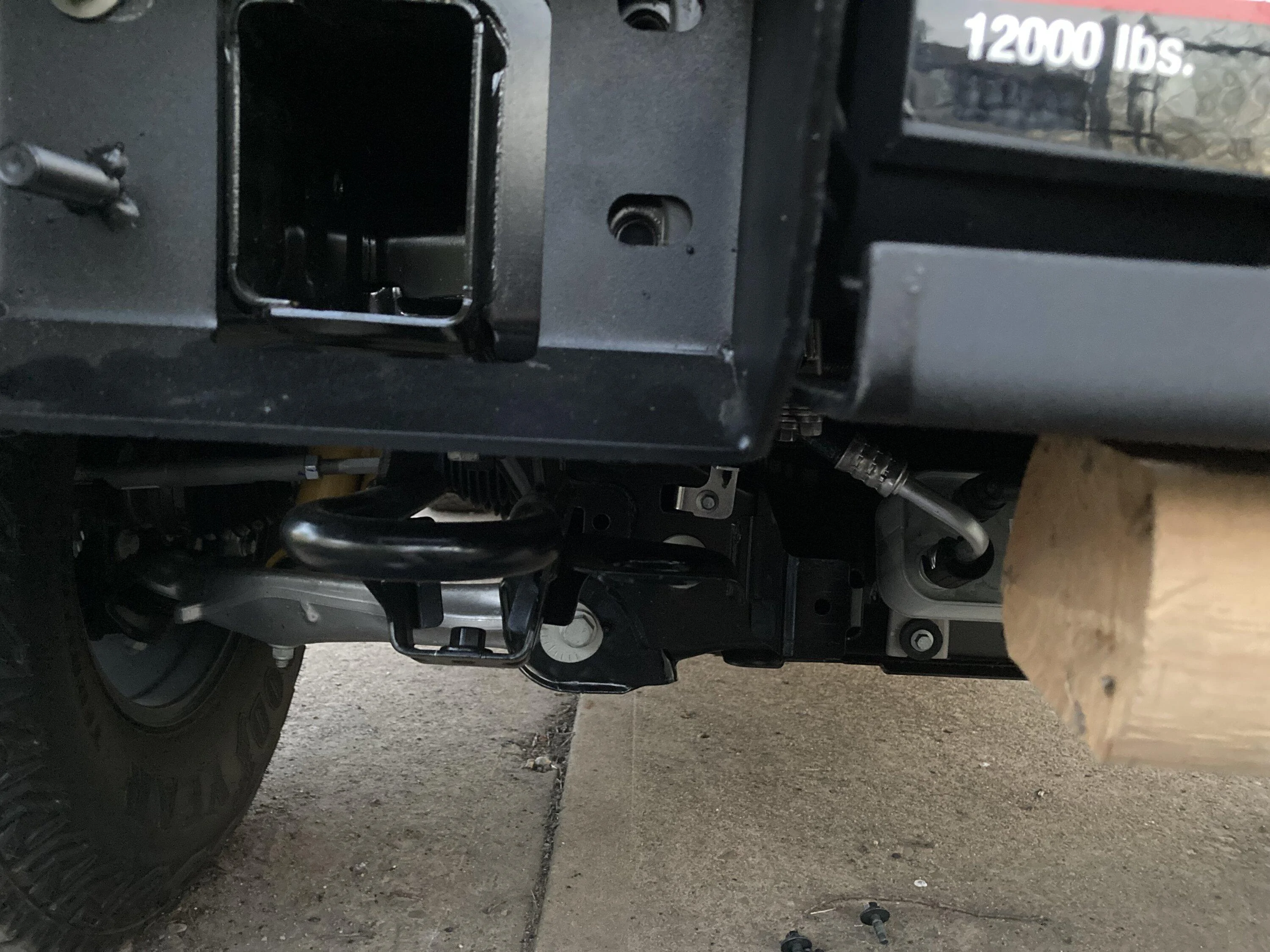

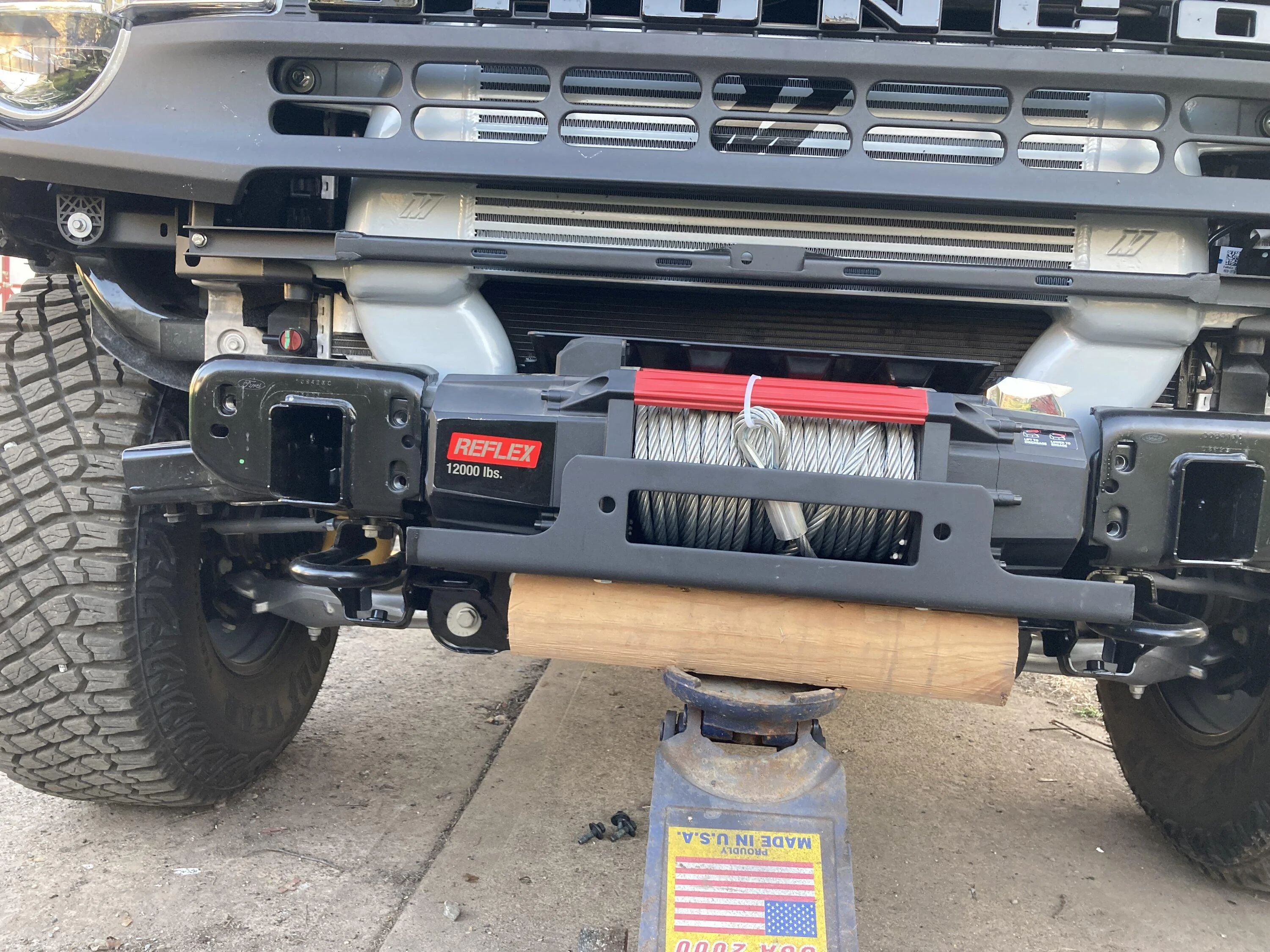

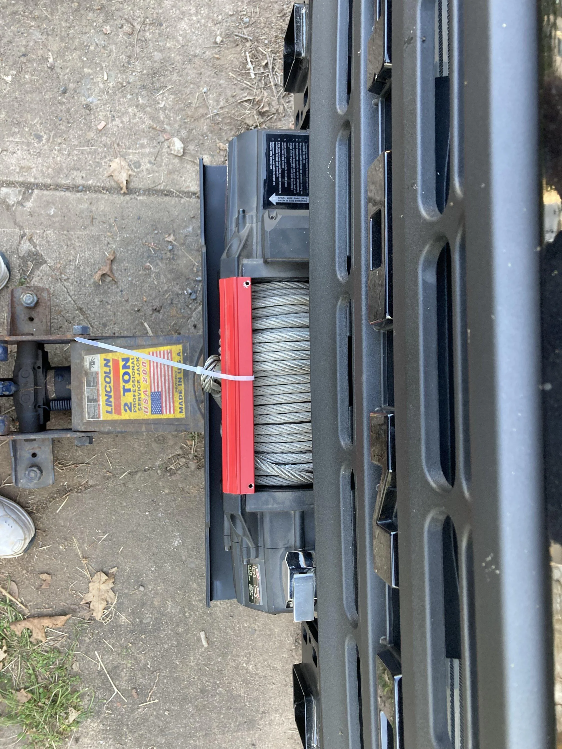

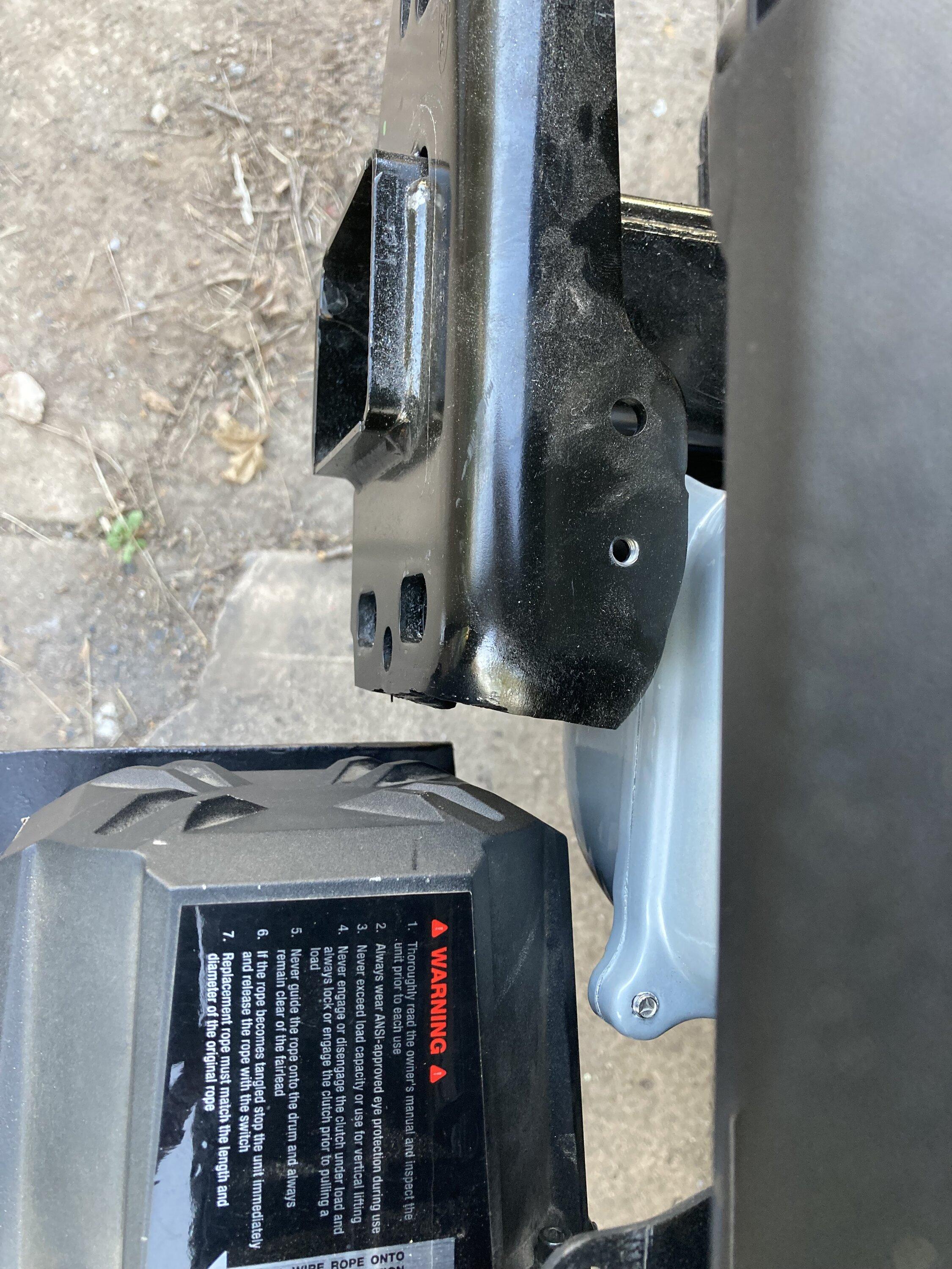

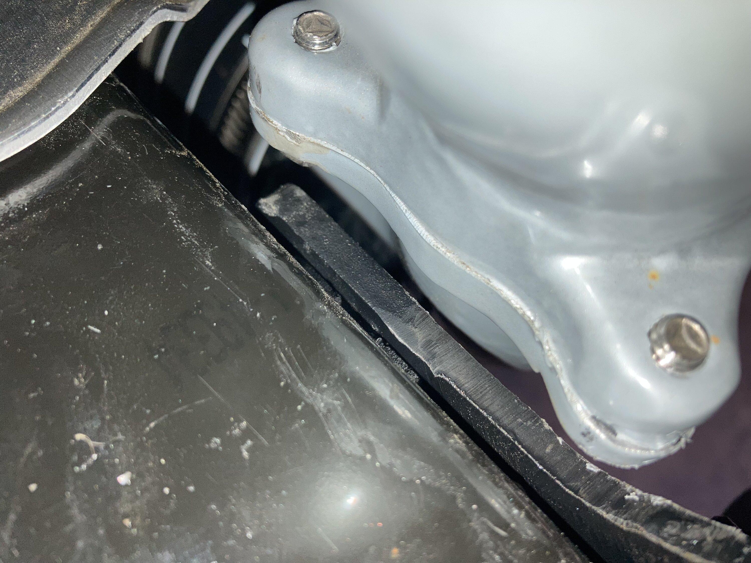

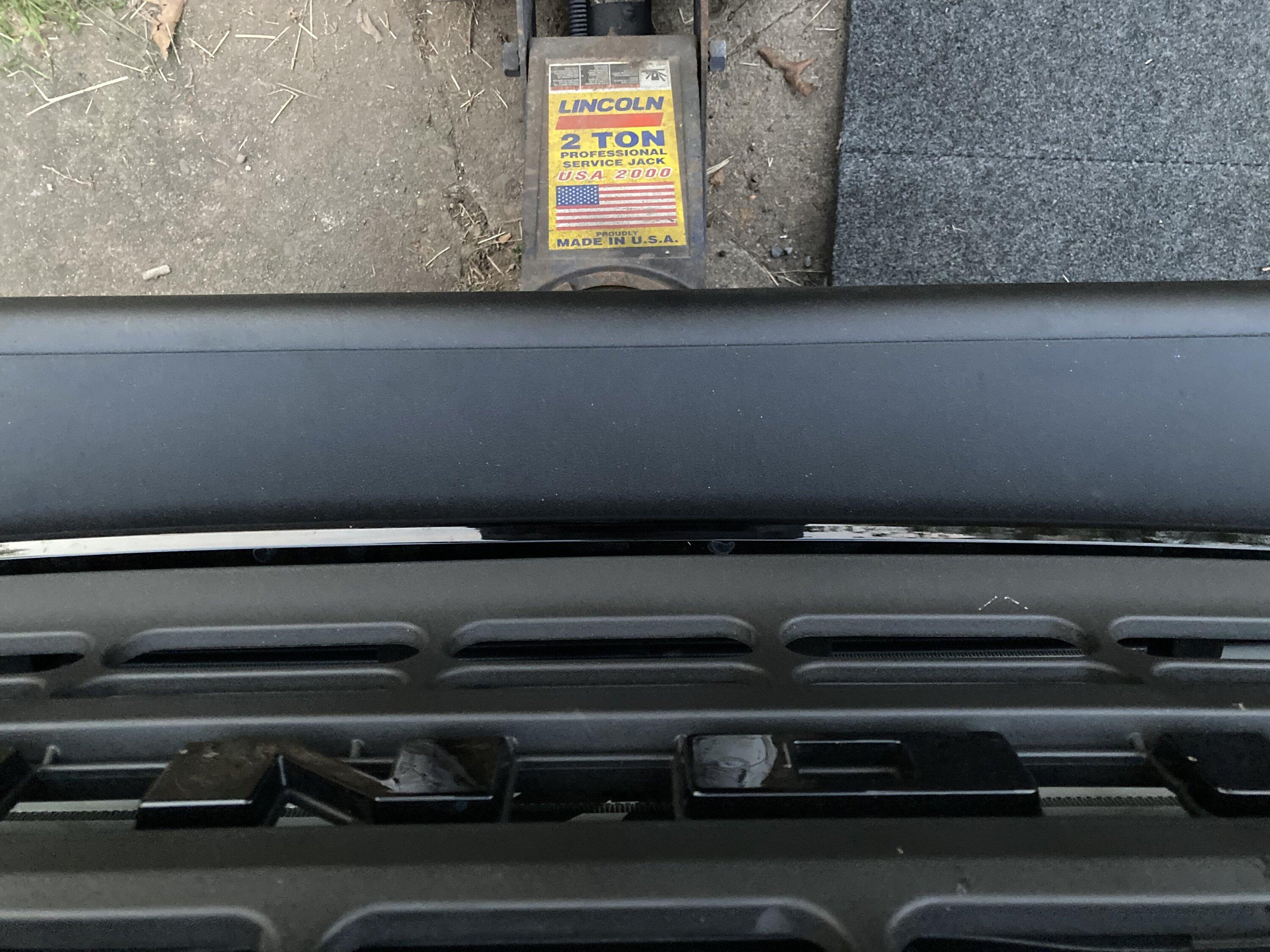

Lost some more bits tonight>>>>>>>>>>>>>>

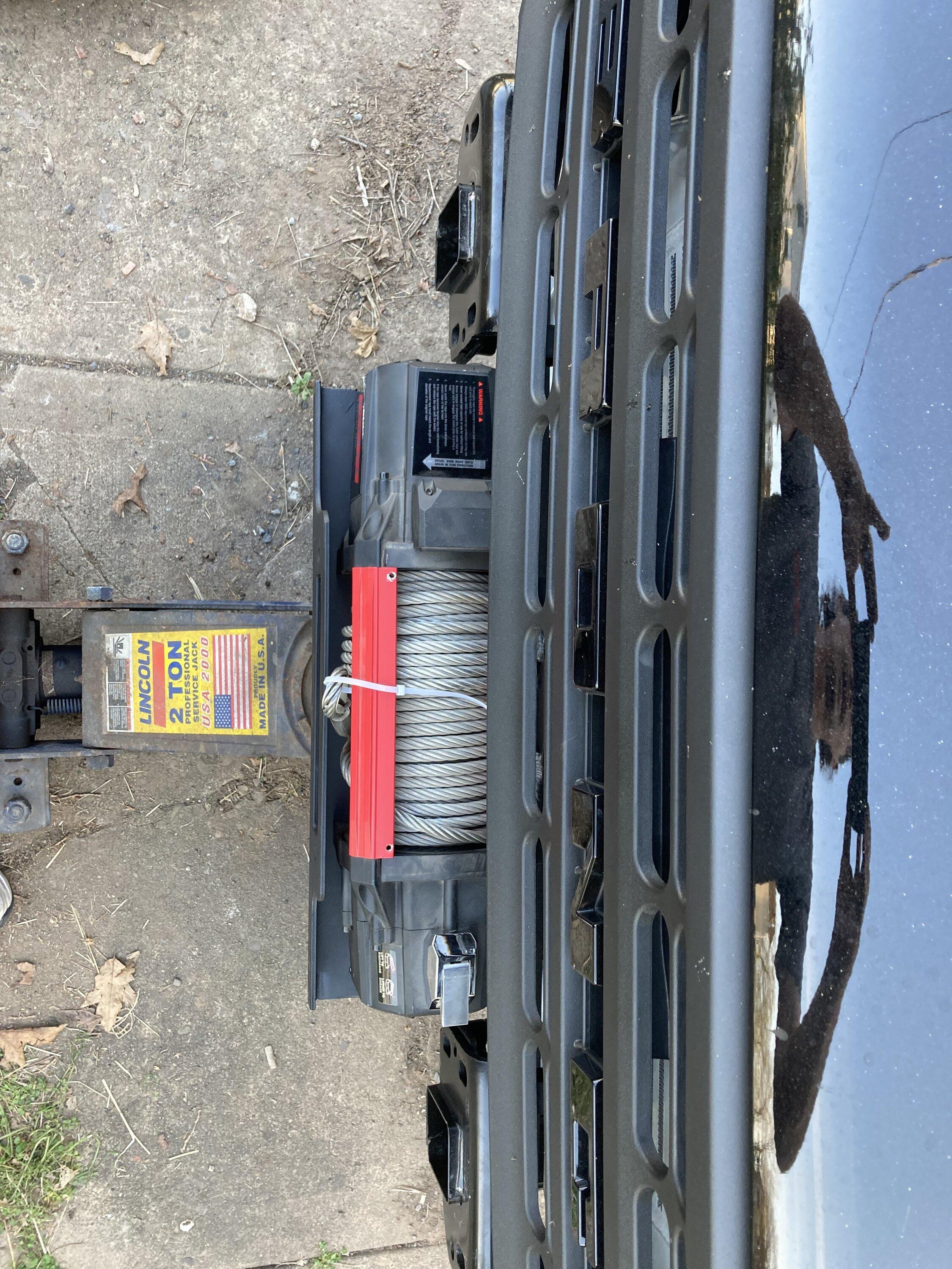

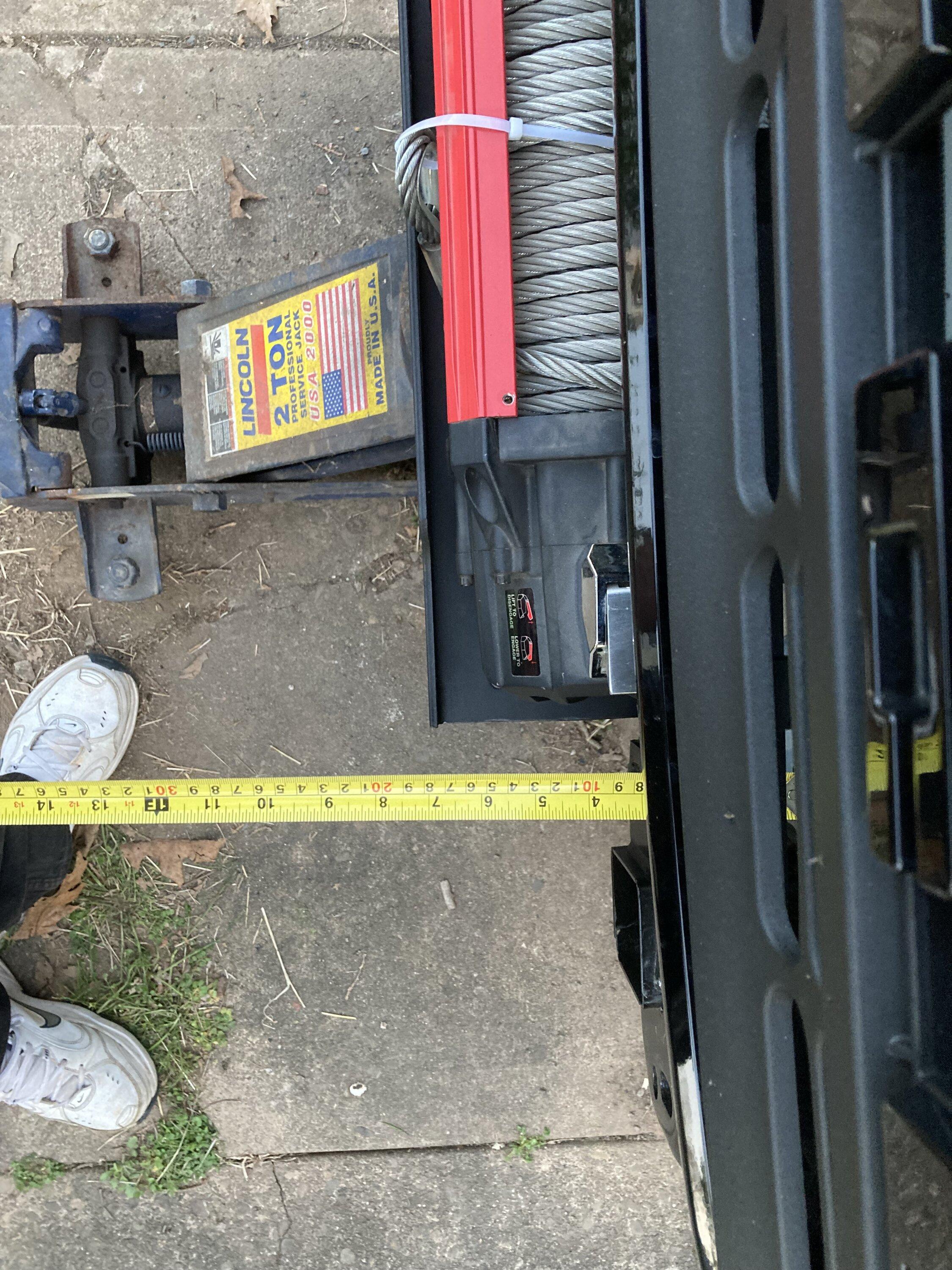

I believe this is the shot you were looking for @Aztec1382
Ford Bronco The "Baus" Bronc IMG_0536

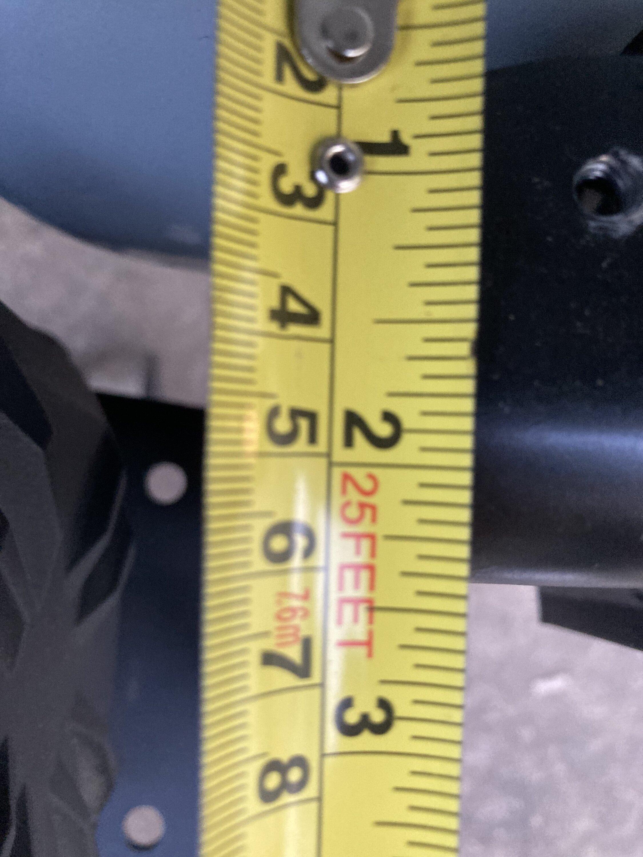

One with a tape measure, if it helps. The end of the tape is on the pipe. The front of that pad is 2 3/8 off the pipe.

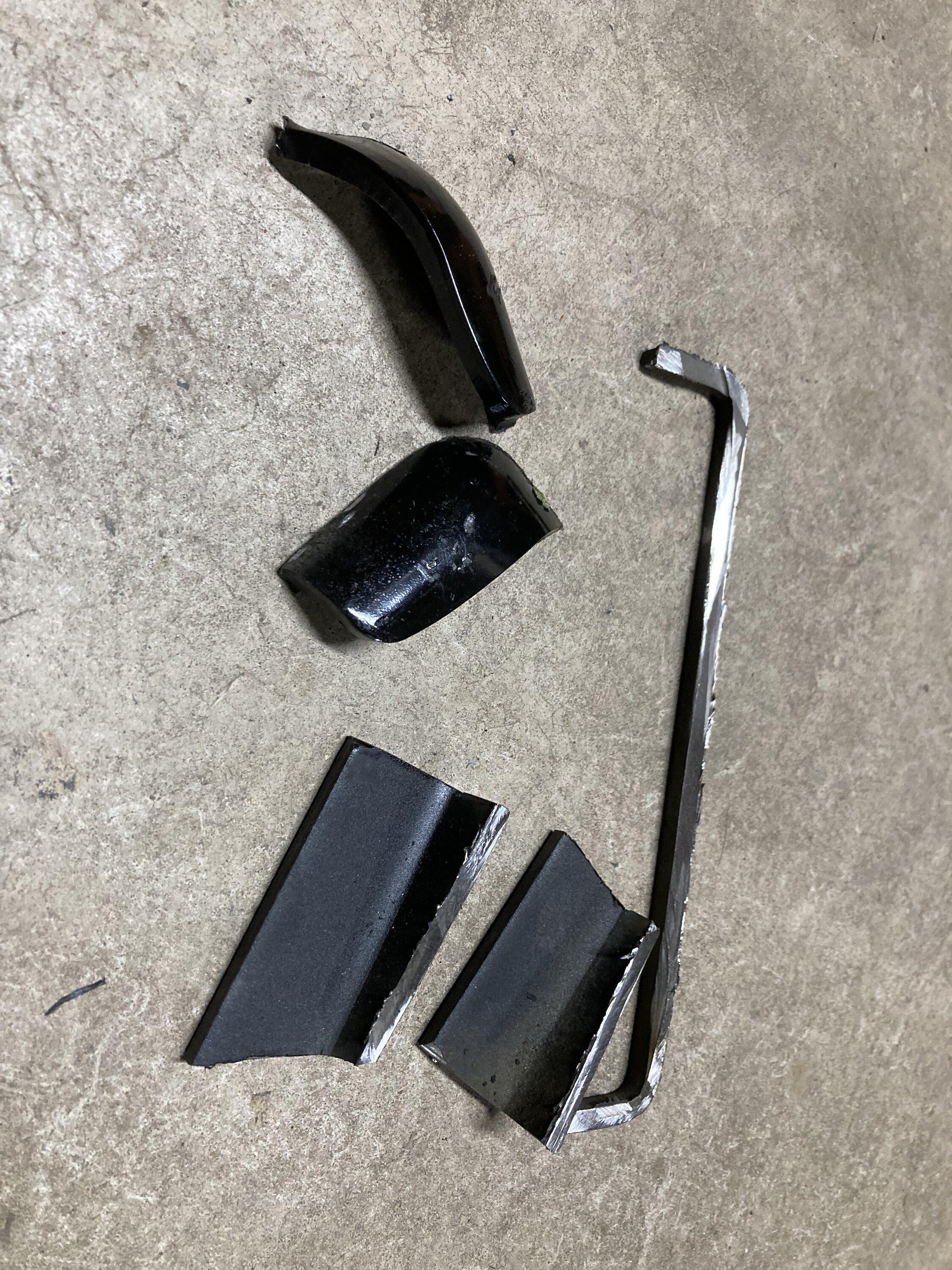

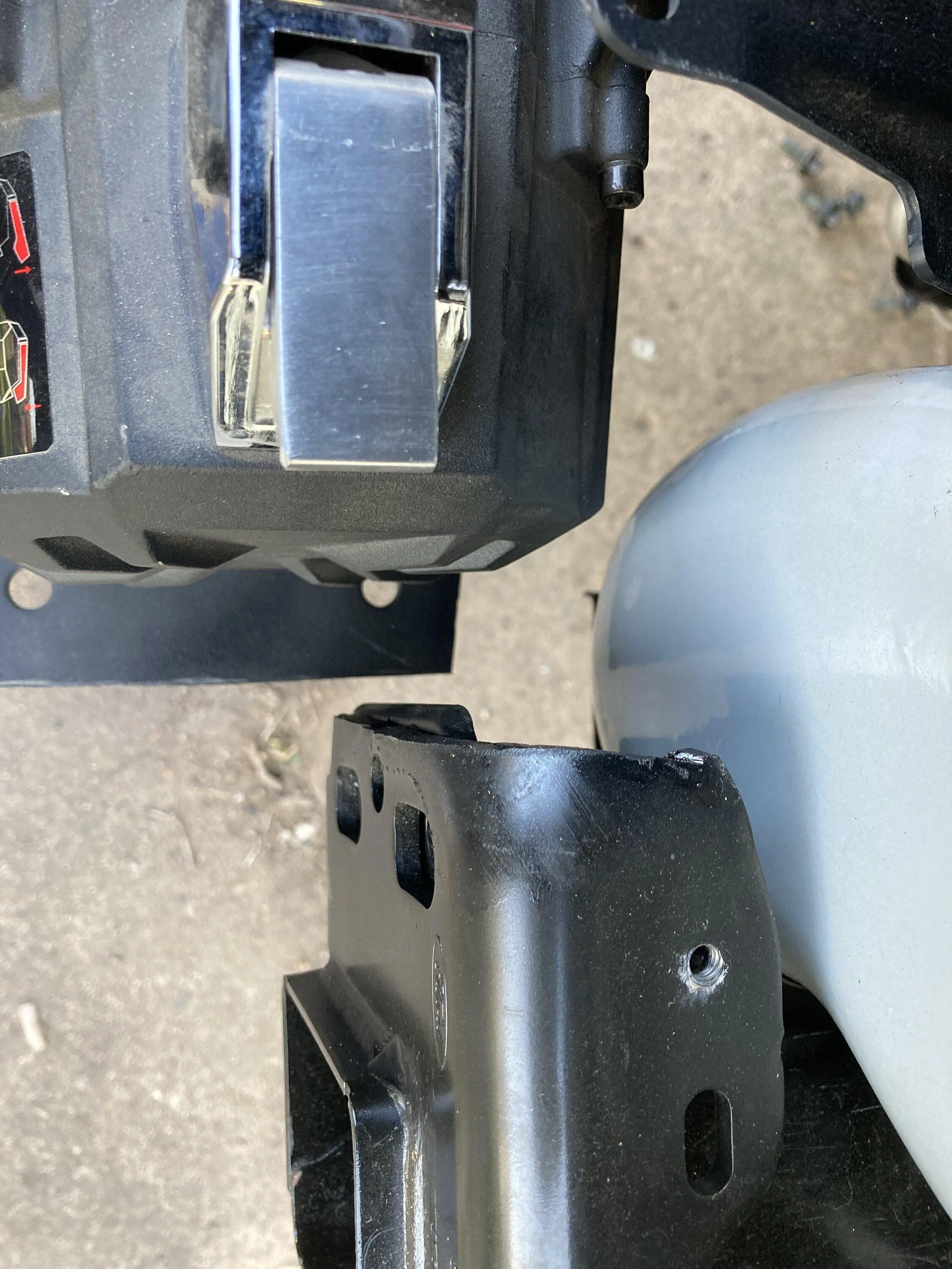

Some shots of the "bits" missing. :LOL: And the clearance I have now.
Ford Bronco The "Baus" Bronc IMG_0539
Ford Bronco The "Baus" Bronc IMG_0540

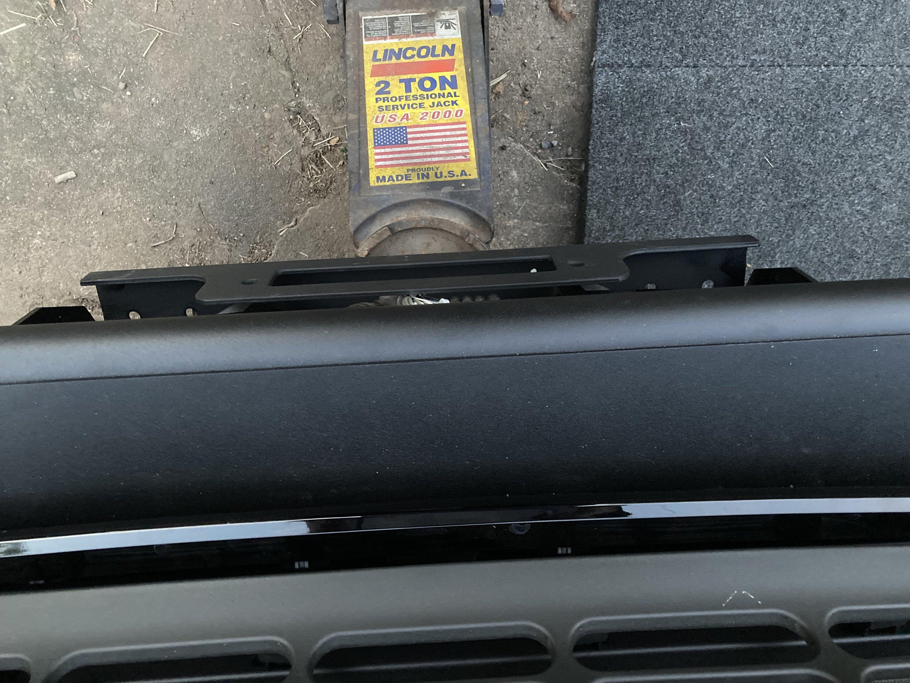

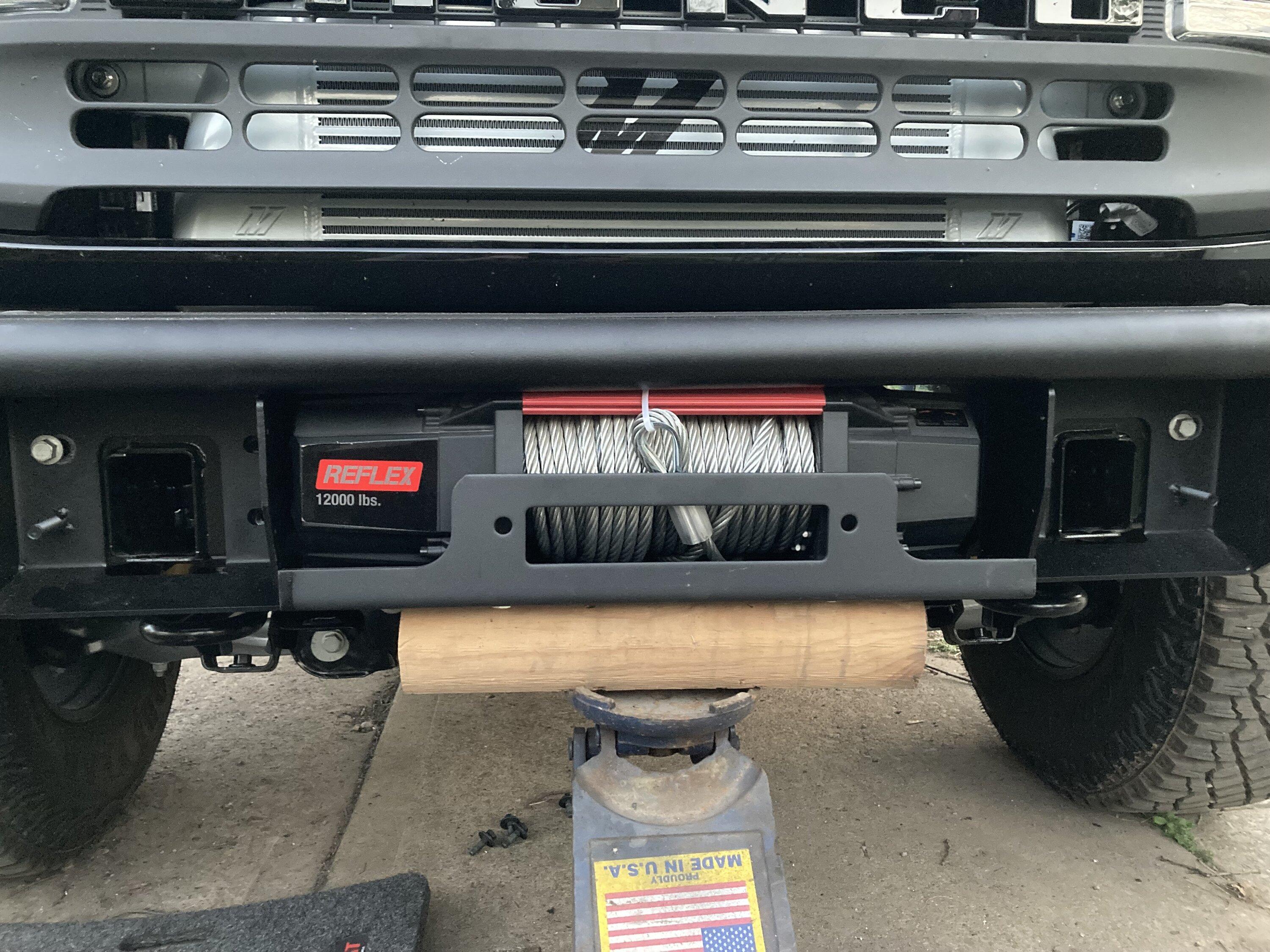

I hade to see if it was any better now with the bumper on.
In this pic I got the winch plate up to the bottom of the bumpers "pocket".
Still tucked in nice.
You really have to lean to start to see the winch.

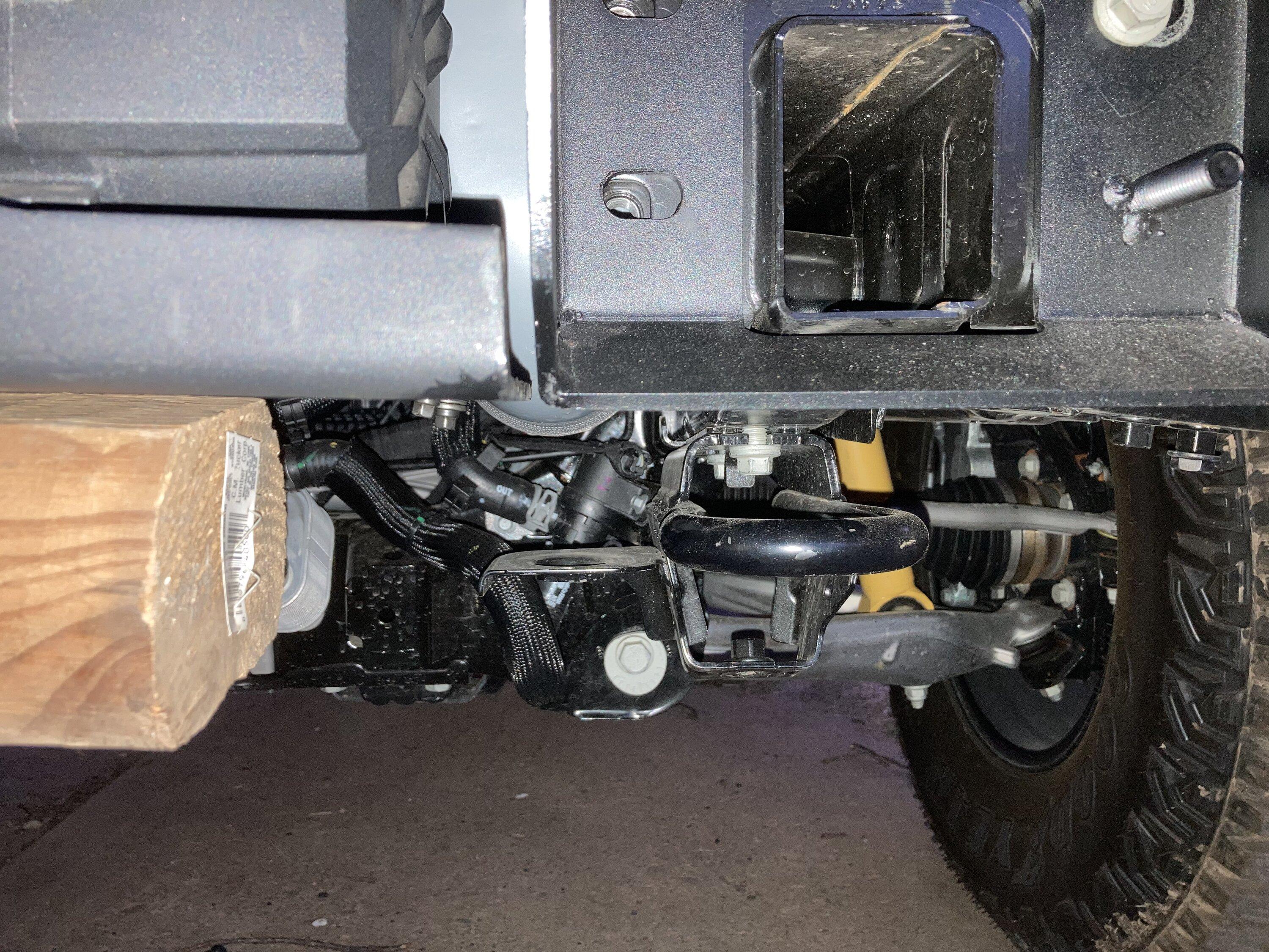

Messed around some more and managed to get the plate up to damn near the bottom of the frame and still not hit underside of the top of the bumper. 😁 I was losing light and had to go pick up my son from soccer practice. Hence the flash on the second. You can also see it is not as high up as it is on the opposite side. The surface I am working off of is not level. When I get it in the garage to finalize the template it will be better.
Ford Bronco The "Baus" Bronc IMG_0545
I'll be making some frame bracket templates starting tomorrow so stay tuned. If ya'll need anymore shots let me know. 😁

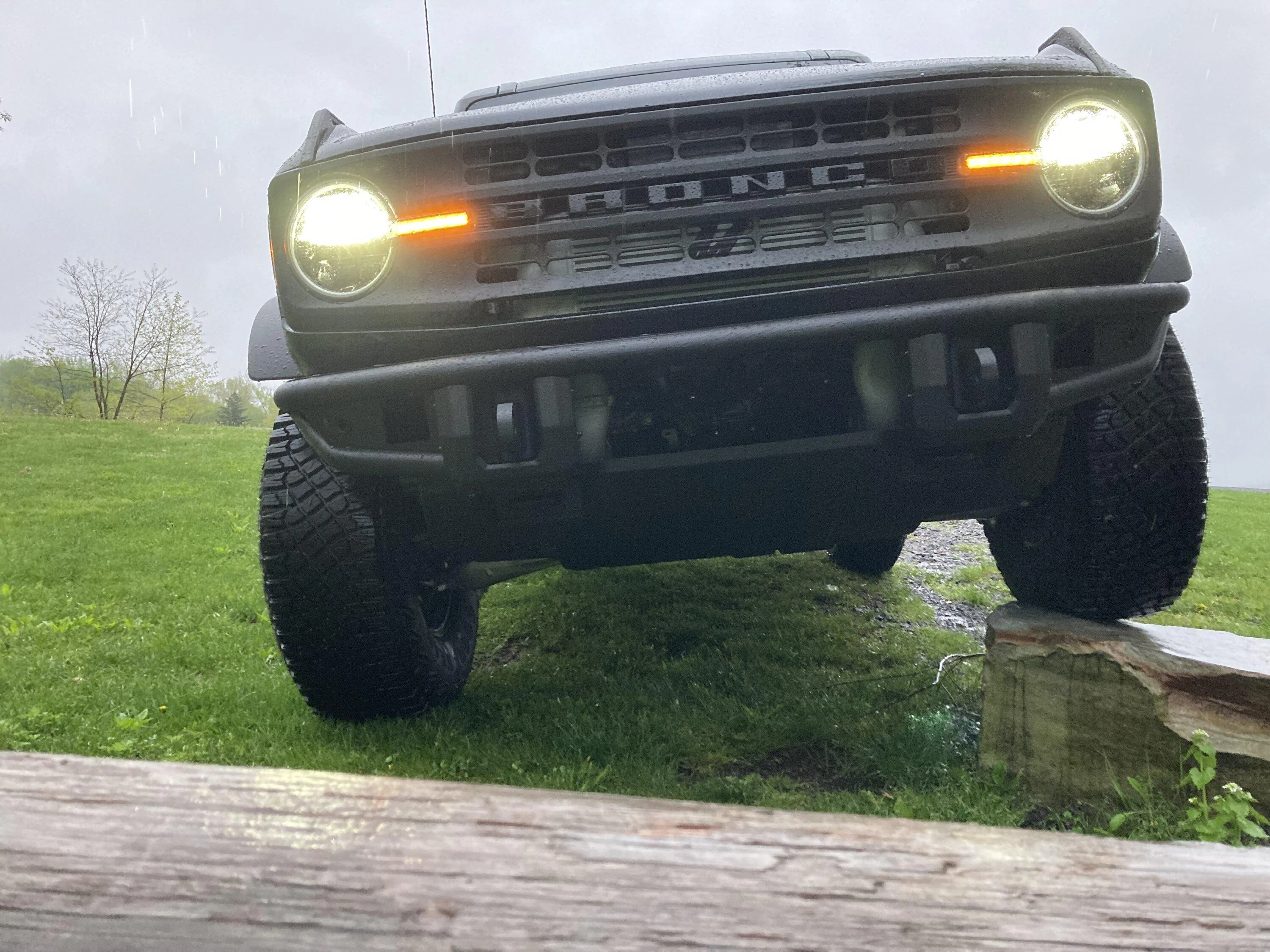

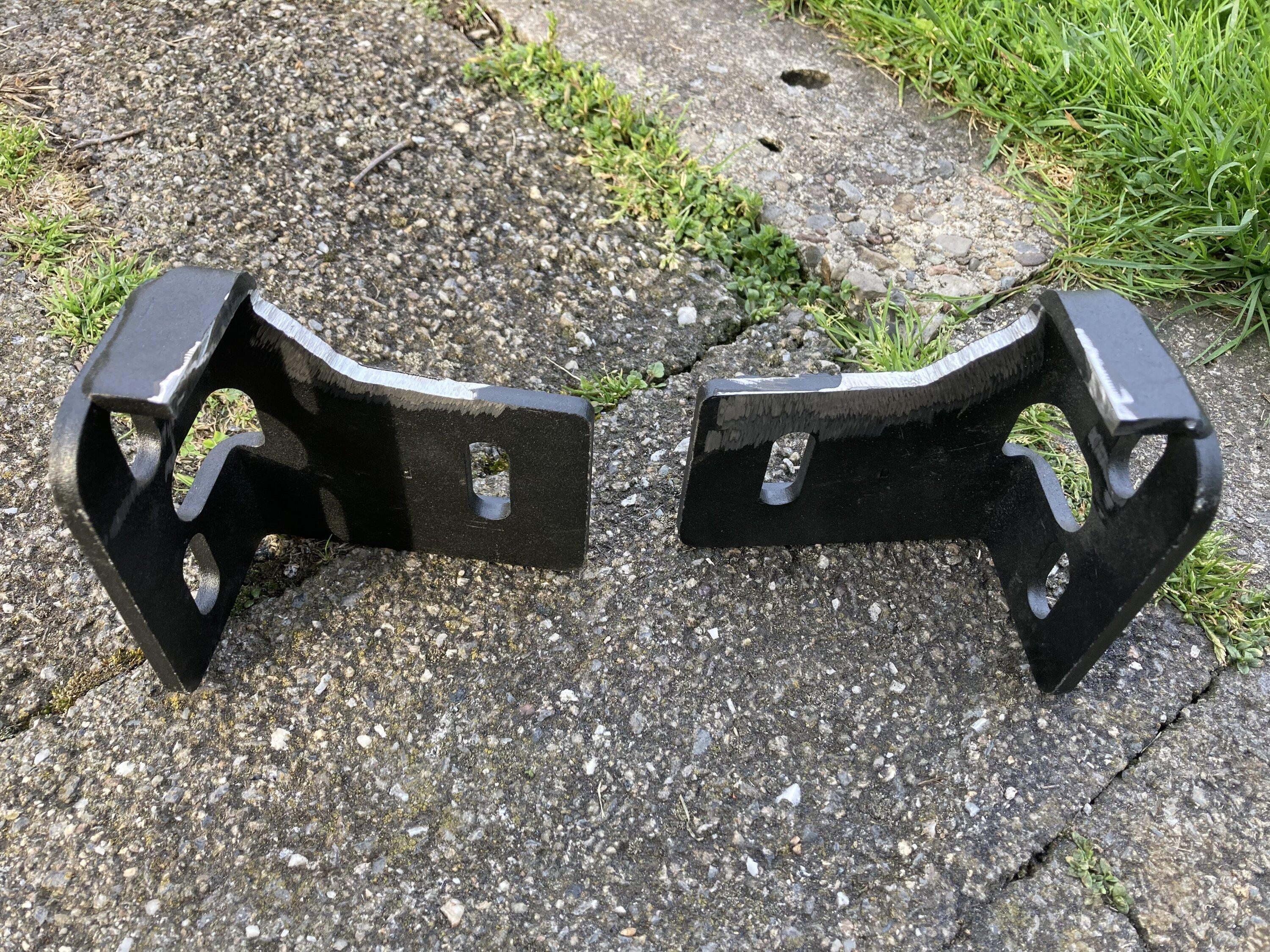

Got my front bumper installed and as usual ran into some issues, but nothing the cut off wheel couldn't handle. ;)

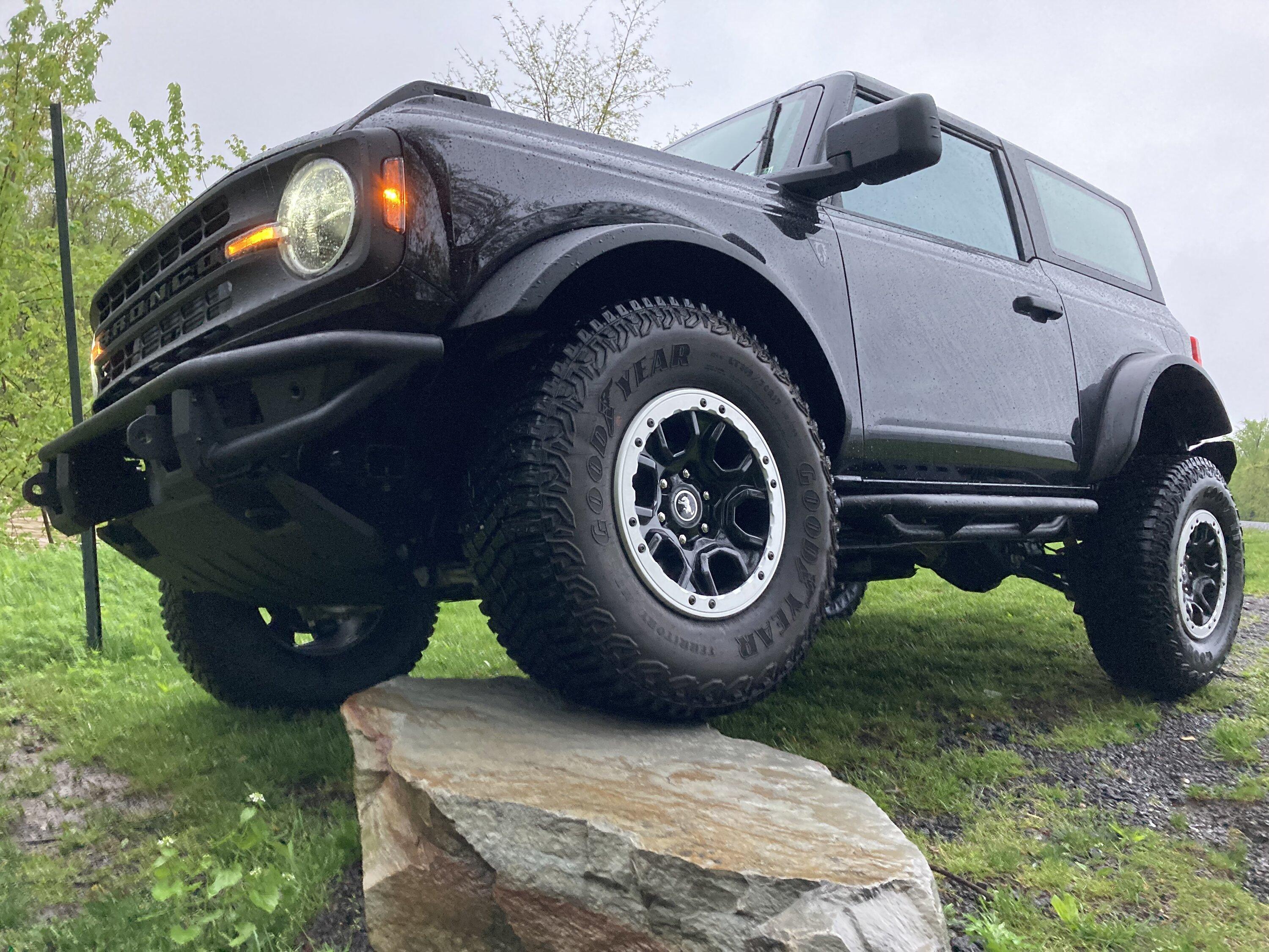

Afterwards I took it for a spin and found something a bit more appropriate than a curb to get some "action" shots. :LOL:
Ford Bronco The "Baus" Bronc IMG_0610
Kinda "dorky" looking without a winch in there, but I'm working on that, hang in there.

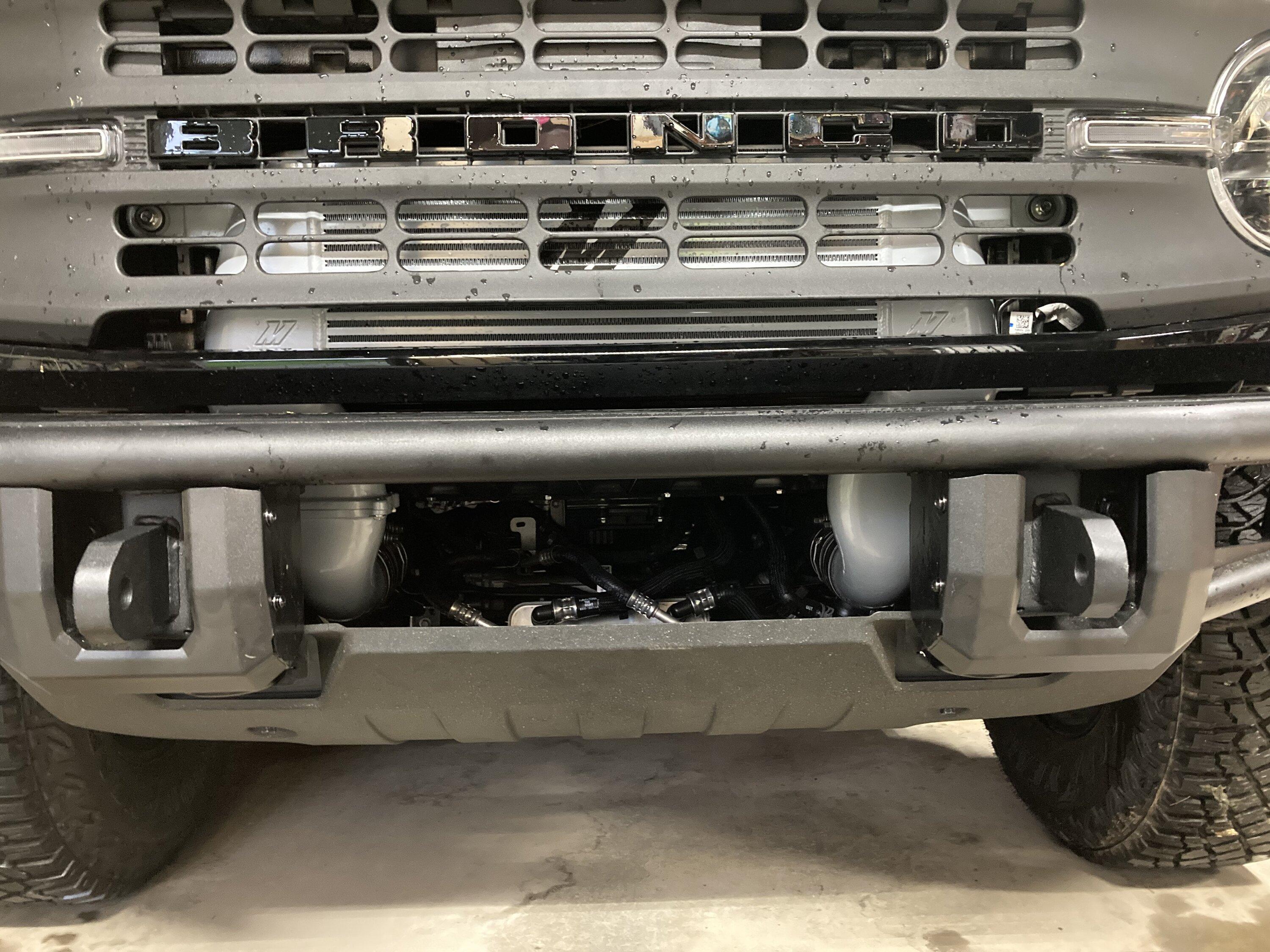

Very interested in your winch location idea as I decided to get this Baja style bumper instead from Reaper Offroad.
There looks to be the perfect location for the fairlead to sit right above the bottom bar if the intercooler moved north like yours.
Yes, that does appear to be more than adequate space. My winch/fairlead/winch plate needs almost 8", top to bottom. Good candidate.
