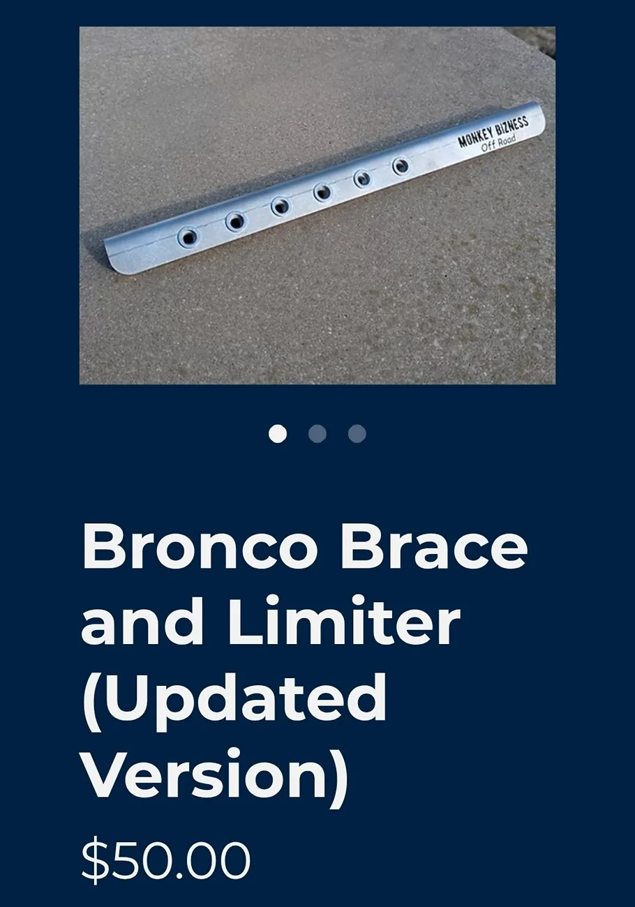

This looks great. People have mentioned that some tailgate limiters can bend the sheet metal and do damage. Can anyone mention if this design looks like it might do the same?
Depends on how it connects on the open end of the tailgate I suppose. There's no threaded insert or nut/bolt on that end to connect to, and I could see if you didn't have some secure method of installing that end, that you could warp where the brace bolts into the threaded insert on the hinge side of the tailgate.
M2M uses a long bolt and a steel plate that pulls against a piece of interior brace of the tailgate up by the latch to hold that end solid, and I've had my 38" tires on there for a long time, including many failed struts where it's slammed open hard (stupid plastic ends on the struts either wear out or break)- and the M2M brace and the way it connects to the tailgate has been solid and it's saved my taillights many times. I can't speak to any others though.
