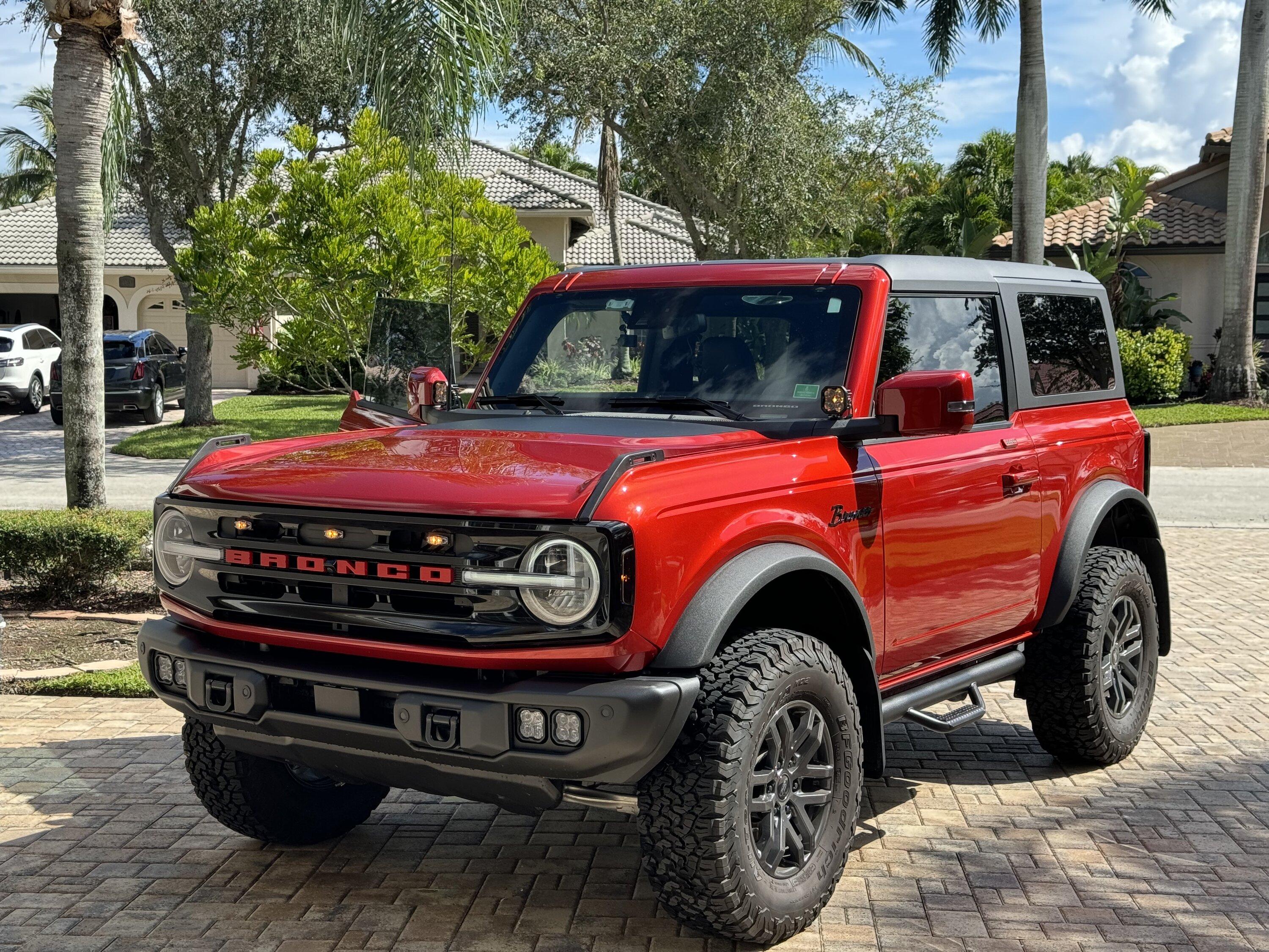

I can just about GUARANTEE that the link you sent is exactly the same one. At $600 buy it, break it down and have it all powder coated. There’s a reason it’s $600 shipped. I got my hands on a capable and added a KR off road double off road kit.

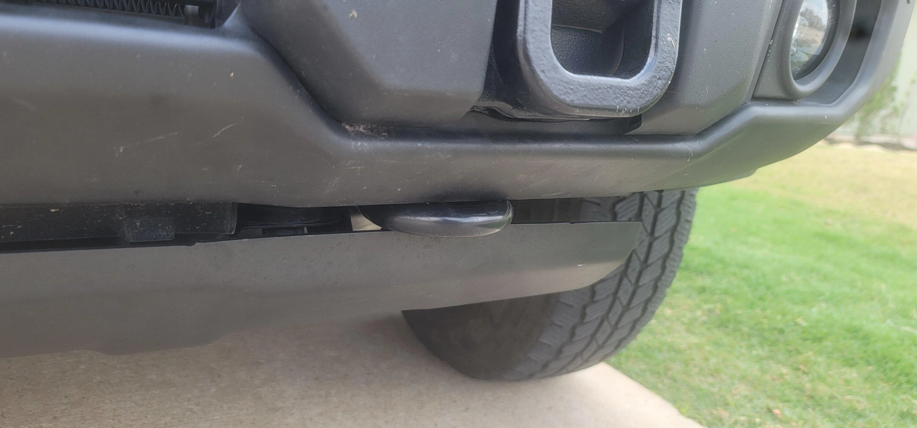

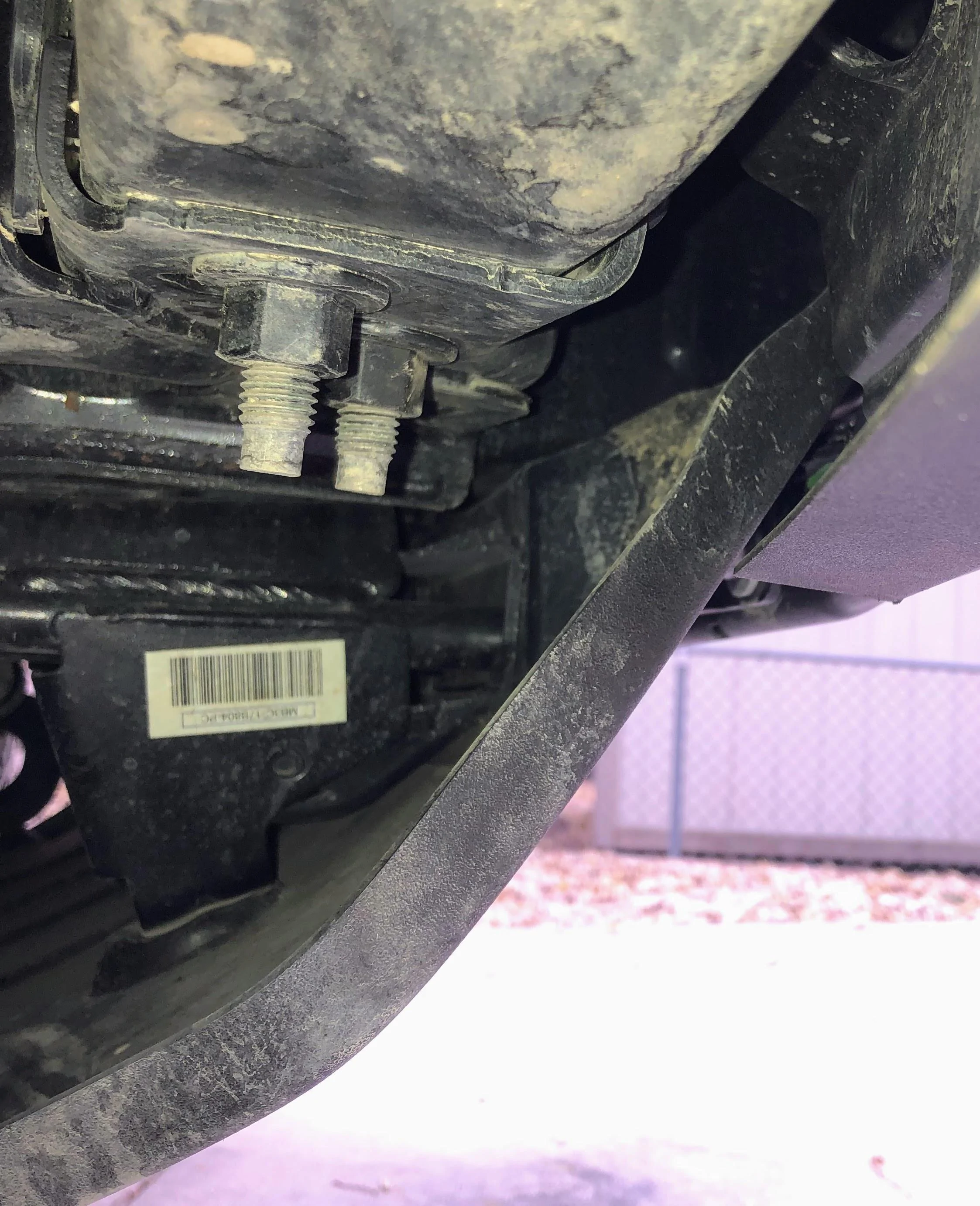

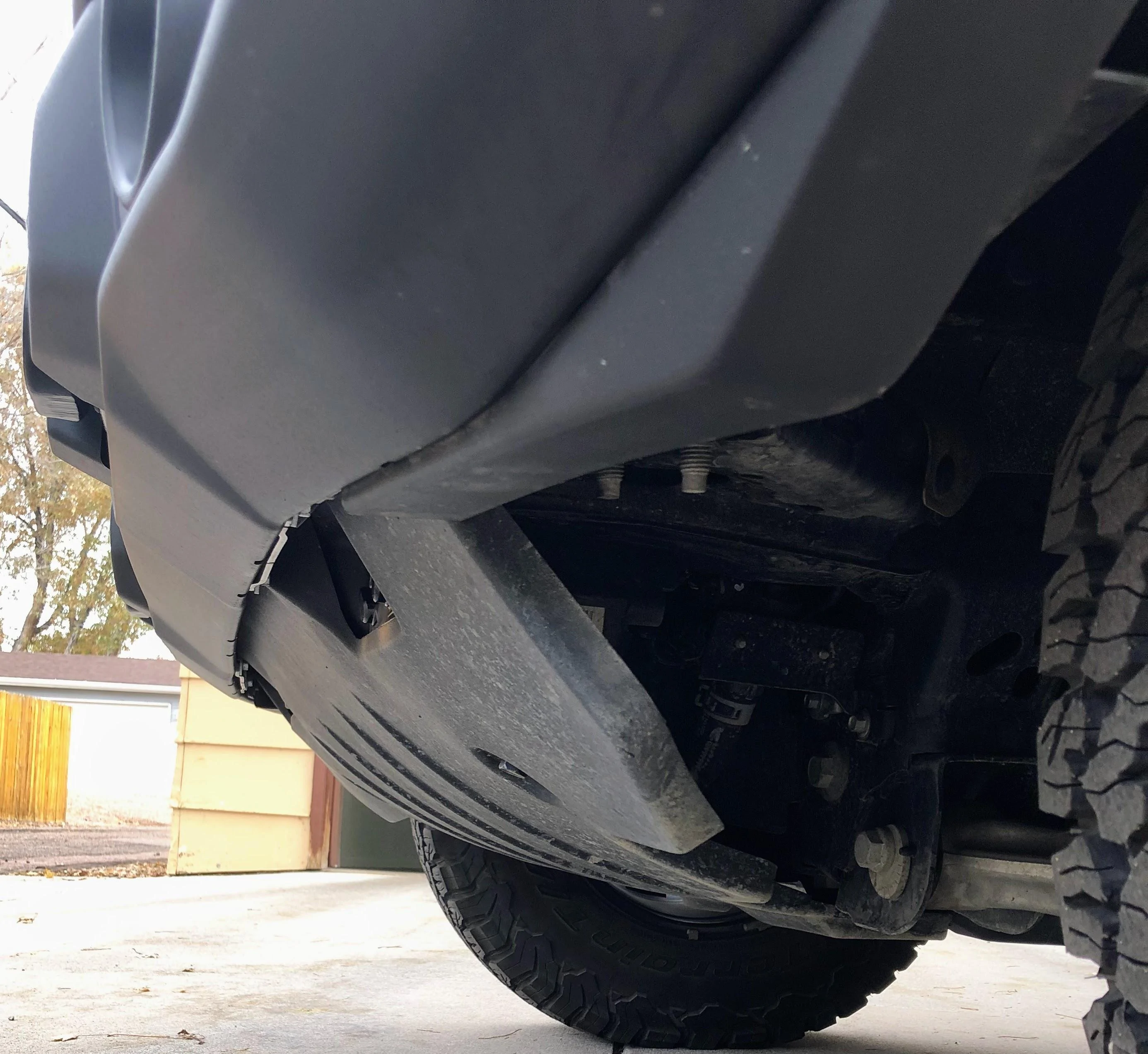

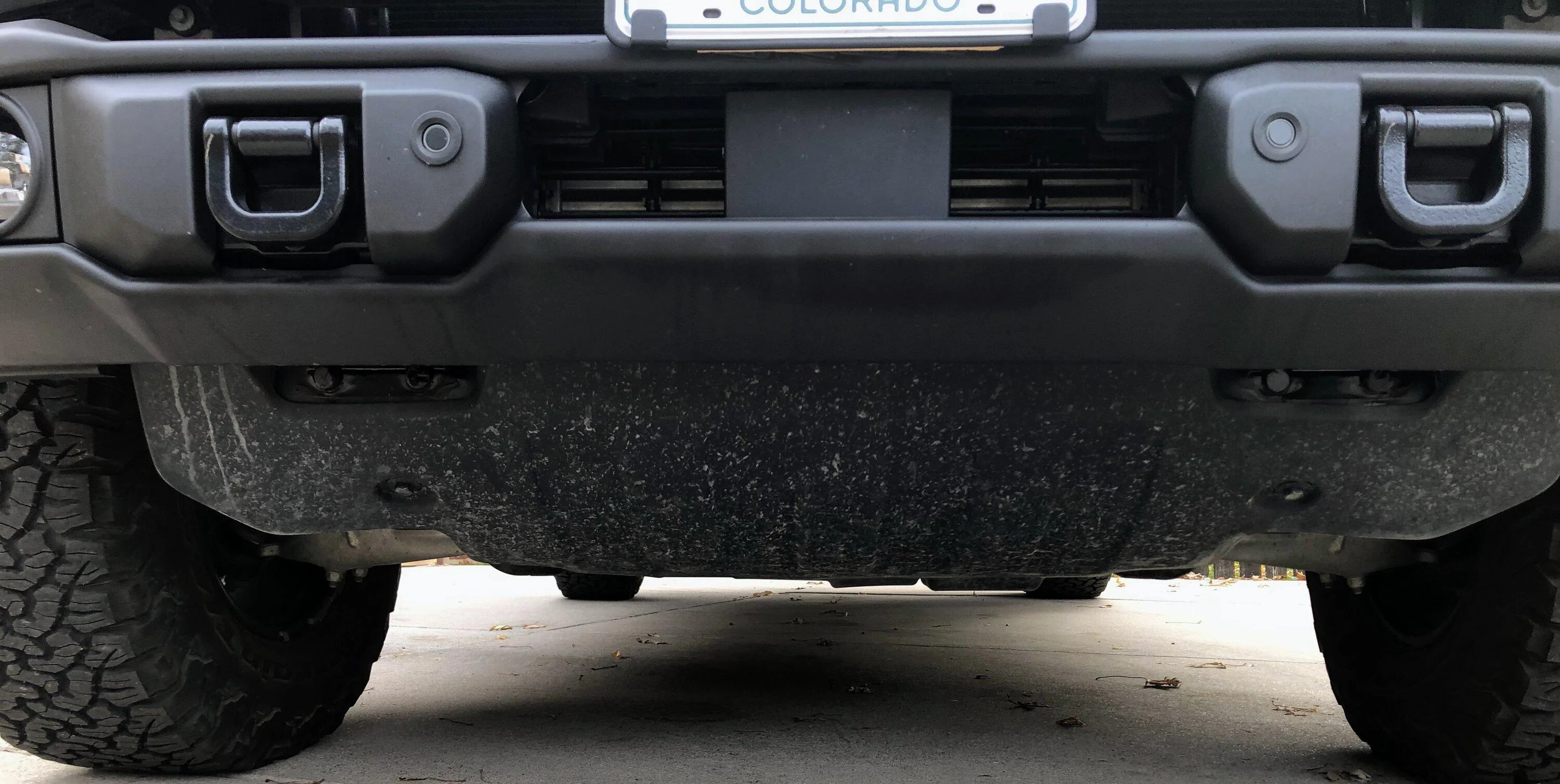

I swapped for capable and kept oem splash guard intact. It had enough give to slightly tuck up under the bumper. I shaved off the hooks, but left enough of a nubbin to hold the splash guard in place. I ground the sharp edges ad painted tips. Very hard to see unless you get down there.

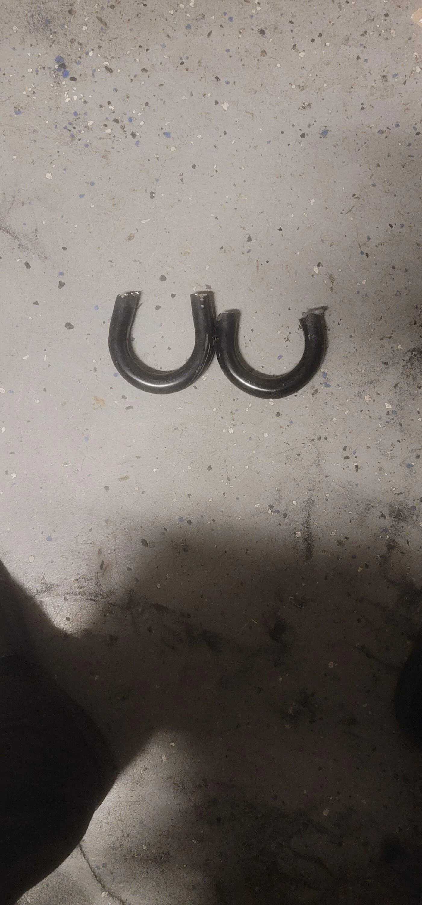

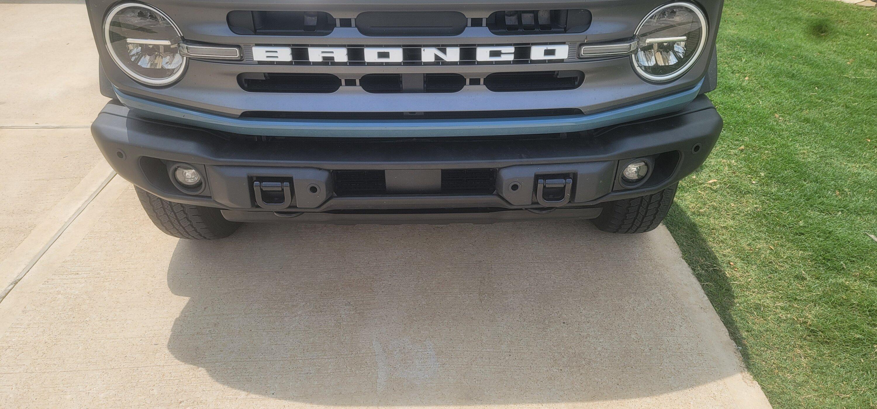

I switched out plastic for capable
on my big bend. You will need to grind off hooks or purchase the bracket and a new steel skid plate as well.
Is it possible to bolt it up this way, without cutting the hoops off, for a 1000 mile trip, till I get back to my tools? Picked one up on vacation, wife is a little peaved at the thought of an extra bumpers to pack around. Will no longer need the bumper or plastic splash guard. On the other hand, don't want to scratch it up or come loose. Base Bronco so no worries about sensors.
