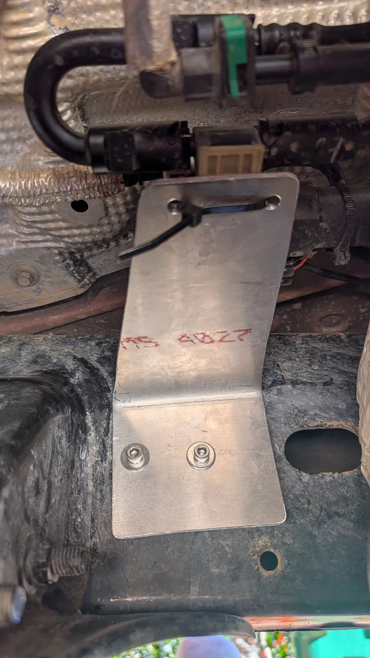

Mounted EtOH Sensor
Finally fabbed a quick custom aluminum mounting bracket for my ethanol sensor. It was basically hanging from tubing. It wasn't dangerous or prone to near term damage, but it needed something.
Ford Bronco Swamps Code Orange Bronco Raptor Build PXL_20260225_222102476
  • Mounted two stainless rivnuts in existing holes in the frame. No drilling required. However, because my installation tool wouldn't fit (entire area is super tight/awkward) and it didn't have enough leverage for these largish rivnuts, it took every manual and impact tool, extension and ratchet I own to get the rivnuts in. Multiple scrapped grade 8 nuts and bolts as tools along the way. The real trick was a compact 3/8 electric impact driver and grease on the threads for install. F%*$ing hours and with a helper on these suckers... Only option to go faster was to drop the fuel tank.
  • 1/8" thick 6061 aluminum plate, counter bored to fit flush over rivnut heads. Would gave preferred 5052 for easier bending (without a brake) but that's all that was available on the rems shelf. It has a nice large taper on the top, but it's hidden by the camera perspective.
  • There is a perfect channel on the sensor body to use a zip tie for mounting. The zip tie is way tighter than it looks and I left some to potentially snug it up after some heat and vibration cycles.
  • All stainless steel mounting hardware.

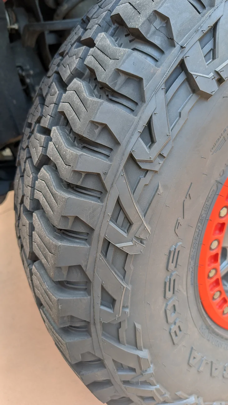

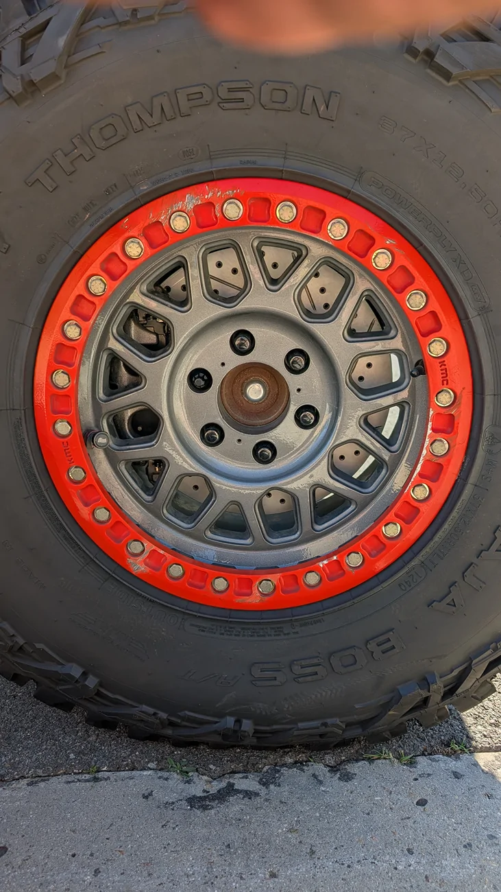

New Mickey Thompson Baja Boss A/T Tires:
Got every last mile out of the stock KO2s (51k with 5 tire rotation - thus they didn't actually meet their official 50k warranty) as they were all in the 1-2/32" range. Sand traction was particularly suffering.
These tires are beefy! 80 lb right on the money as per spec. They are a hybrid tire and are thus very aggressive for an A/T. They look very M/T-ish. Look at those side lugs 😮. They are 7 lb heavier then stock, which is only 10%. Not bad as they are D rated as opposed to C.
They were definitely harder to mount than the KO2s (bead locked). More and heavier jumping on the first bead, had to do some gentle flash trimming with a box knife and finally gave in and used screwdrivers (3!) to get the outer bead set.
They took a crap ton of balance weights, on one tire a huge patch all the way across the inner lip.
No drive feedback yet other than new tires are better than old 🤣. Quiet, balanced and less steering shake.

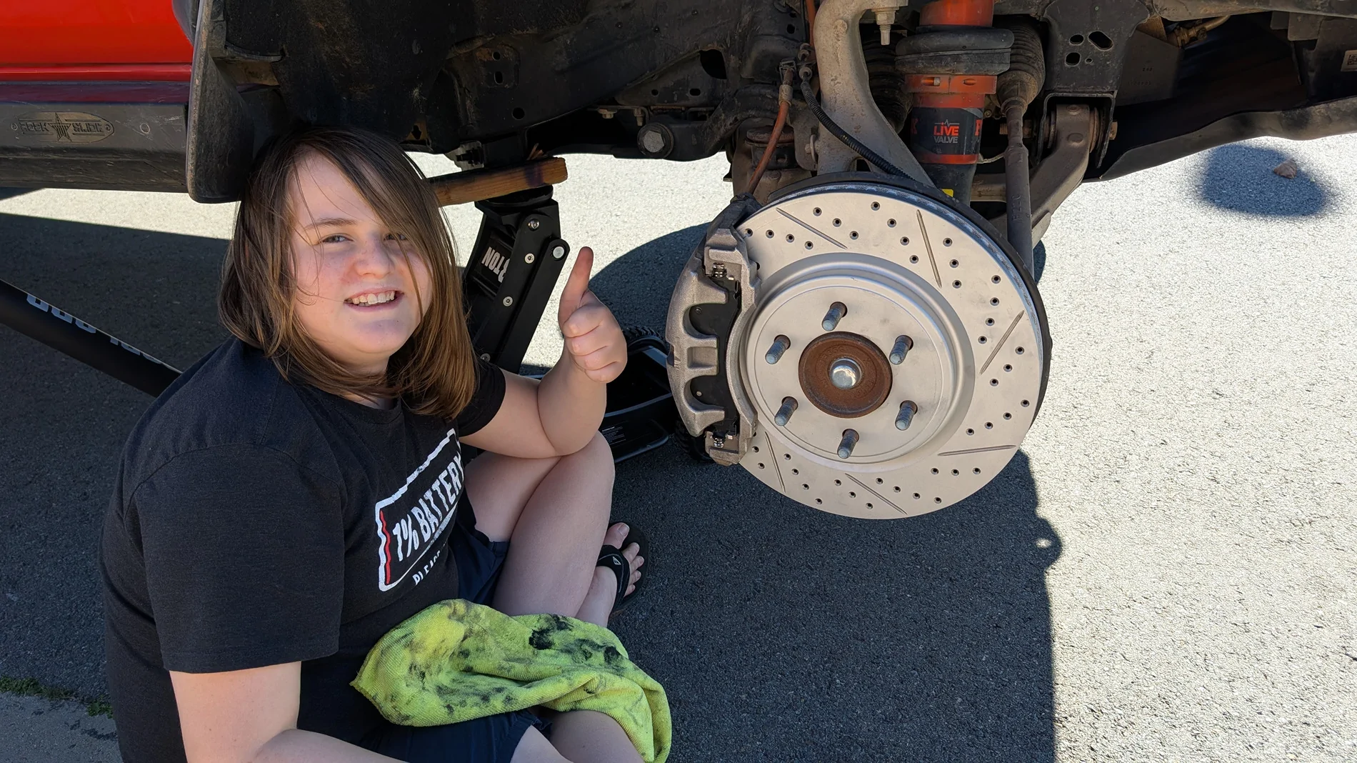

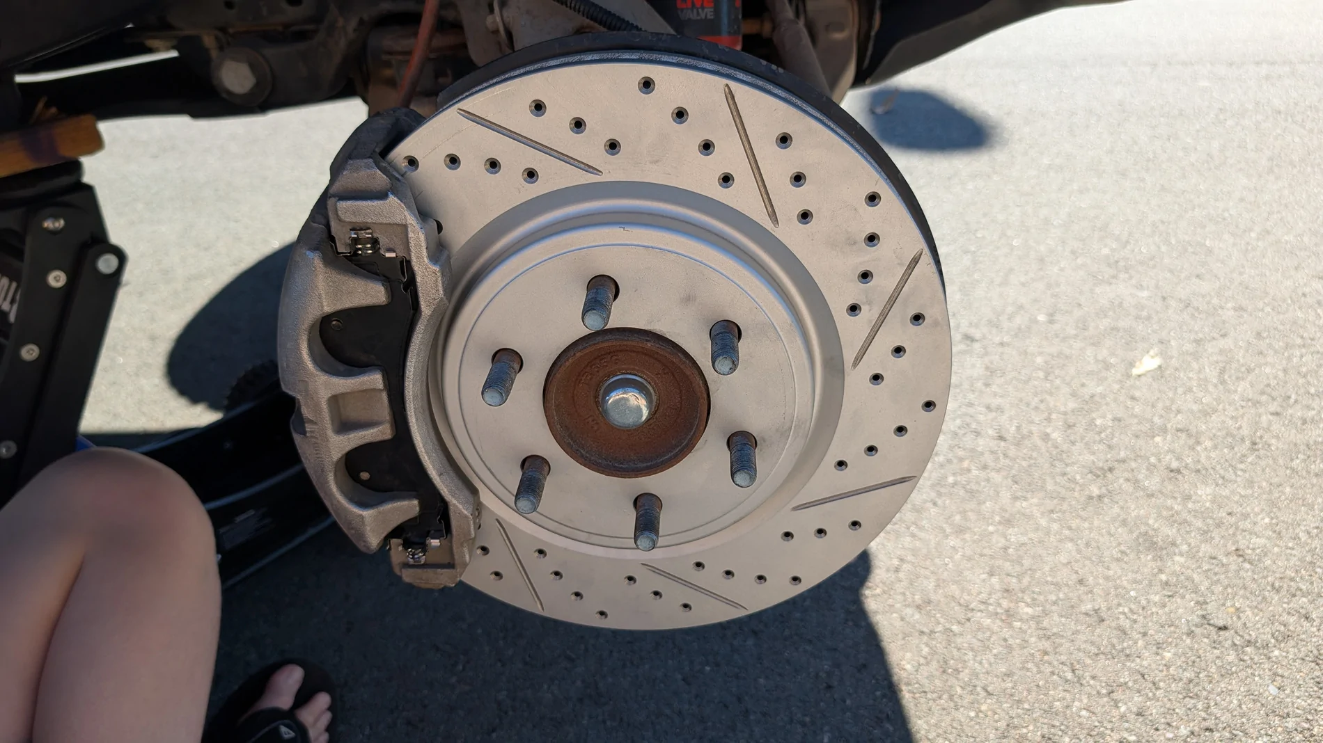

New rotors and pads. R1 Concepts Carbon Geomet rotors and Dynamic Friction Company (DFC) Ultimate Duty Pads:
Hoped to find true upgrades as the factory Raptor stuff is quite good. I think I managed. To be clear, I've not faded the factory brakes nor had any other problems with them.
I preferred slotted only rotors as opposed to drilled and slotted, but these cross drilled holes are very generously chamfered on both sides, which should prevent stress cracking around the holes. They are also zinc plated for corrosion protection. The only slotted only option was from EBC and they are massively overpriced across the board. I just don't think you get what you pay for with EBC rotors or pads.
The Dynamic Friction Ultimate Duty Pads are GG friction rated, very likely higher than the factory FF pads and they can operate up to 1400 °F. Stock will likely fade (exact information very hard to get) at around 600-700 °F. So these will have great bite (better than OEM) when cold (panic stops and crawling) as well as great bite when towing or high speed running with lots of braking.
Unfortunately, I thought my front pads were much closer to the wear limit (friction material being about the same thickness as the backing plates) here at 51k mi. However, the DFCs friction material thickness new is almost exactly the same thickness as these worn factory pads. I'm going to double check with DFC on this detail soon. The factory rotors looked excellent with maybe 1 mm or less wear.
I found the front guided clips a bit confusing as they have L&R versions. The pads came with the needed clips and are black Teflon coated on one side. Install the clips with the small loop/ears facing AWAY from the rotor (both sides) and such that the tabs on the pads are on top of the straight section of the ear spring that fits into (kind of blocks) the main guide slot, i.e. the pad tabs should be at a slightly larger radius than the long barrow ear spring tab. That will leave the tiny bent tab end clipped around the inside face of each pad tab. Obviously, I should have taken a picture. Just examine your clips very carefully, inside, out and under the pads before popping them out.
Lastly, I thoroughly cleaned the pad carrier bolts, holes and boots and applied Permatex Ceramic Extreme Brake Parts Lubricant. It's the best stuff I could find (that wasn't like $40 per 1/2 oz...). It's a beautiful bright purple color.
21 mm (head) front pad carrier bolts torque: 184 ft lb
Front caliper (slide pin) bolts torque: 27 ft lb

Mounted EtOH Sensor

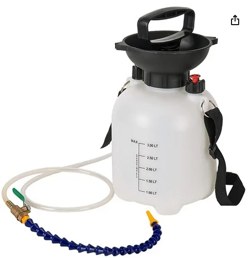

Tool tip…
I’ve been in several tight frame areas where RivNut tool won’t fit. I’ve used a small wrench RivNut tool but awkwar.
Found this one, works great in tight space… the handles swing sideways to tighten RivNut easily. It’s a little more involved to get started & released… suggest you test & waste a few first before in frame tight space.
I’ve gotten more used to this one vs my other standard long styles and prefer this one.
https://www.amazon.com/dp/B0D4Q1HX3K?ref_=ppx_hzsearch_conn_dt_b_fed_asin_title_5&th=1

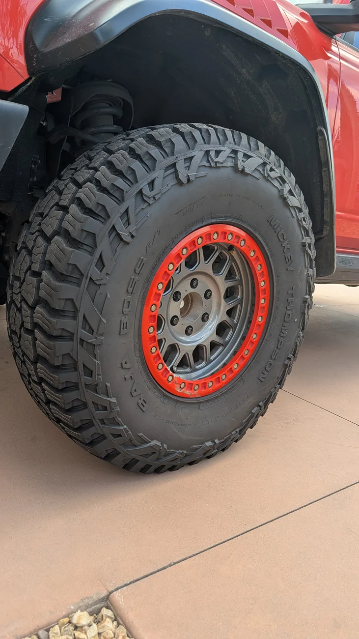

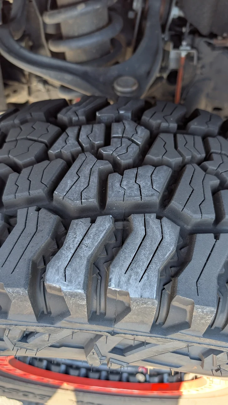

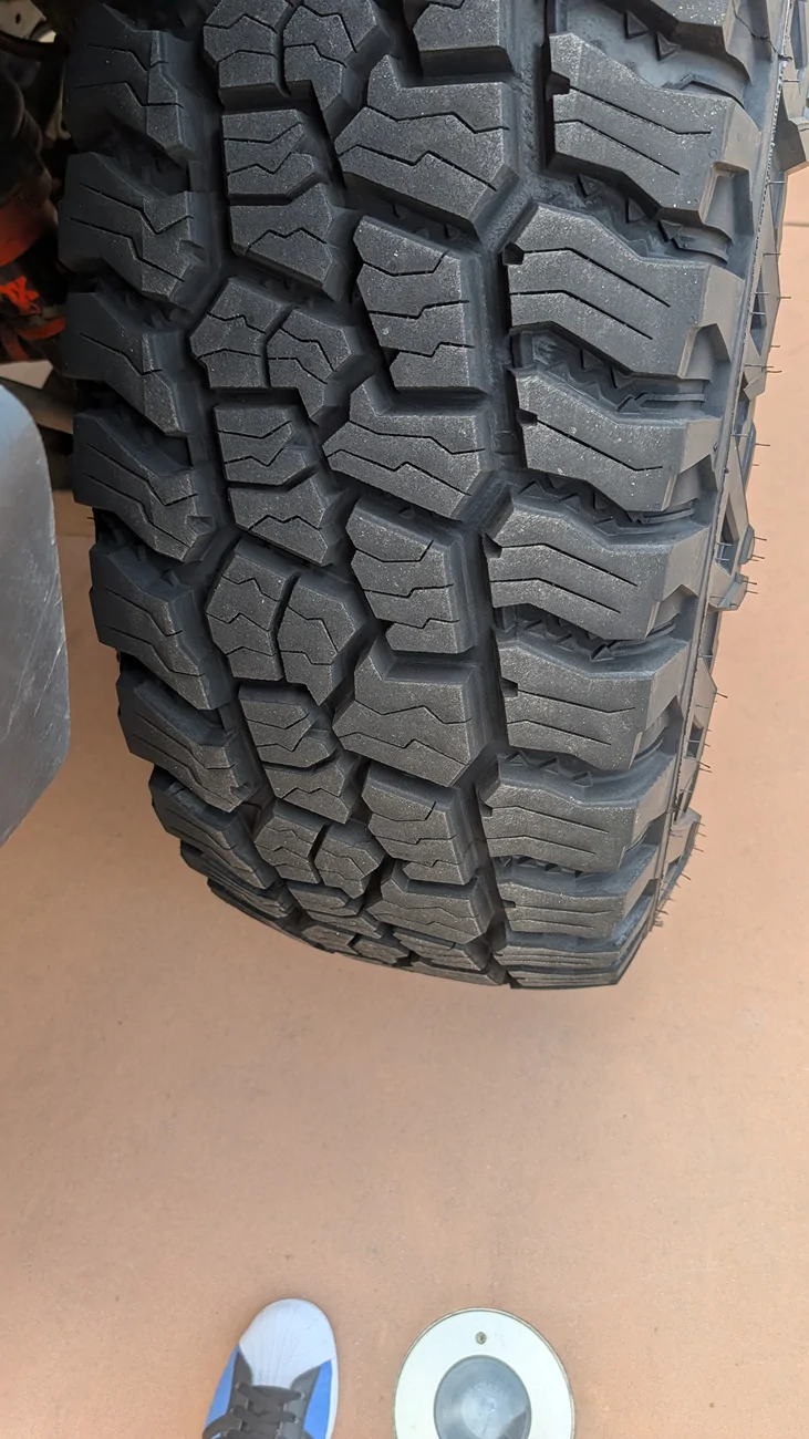

Chalk tested my new Mickey Thompson Baja Boss A/T tires.
Since these are D load rated and factory KO2s are C, I expected a lower pressure. But they are LOW.
My rig is moderately loaded (drawers, fridge, rack, RTT, EOS Water System) and has bead lock KMC wheels. Tires are brand new. I tested at 32, 30, 28 and 26. There was continuous improvement along the way. 32 was way too high. 26 is close but still showed a bit more chalk at the very edges (i.e. slight overinflation). Unlike most others, I test and monitor at warm, not cold.
I'll run here for 5-8 k mi, measure tread depth and adjust from there.
