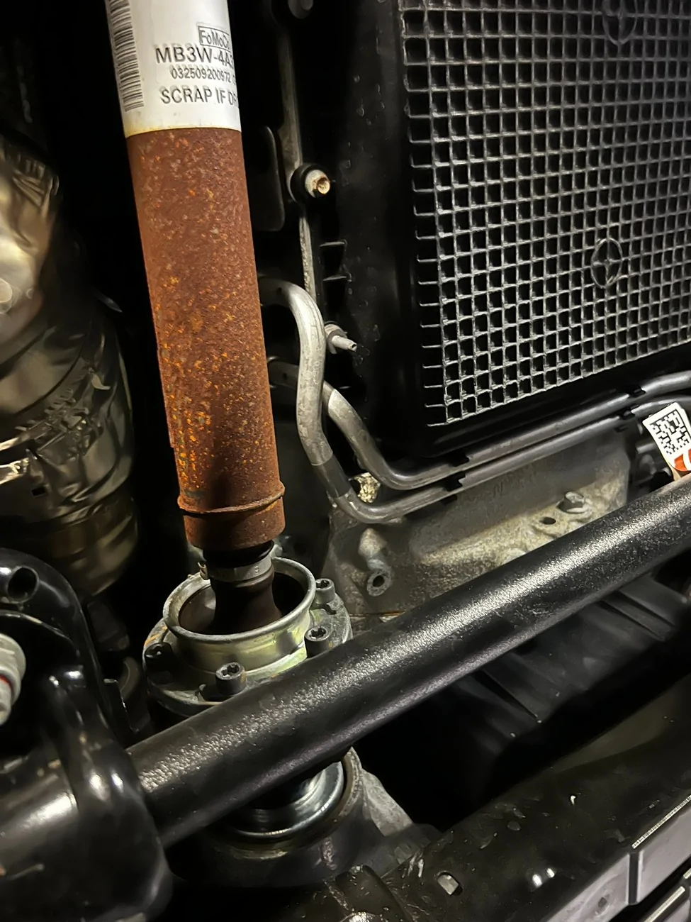

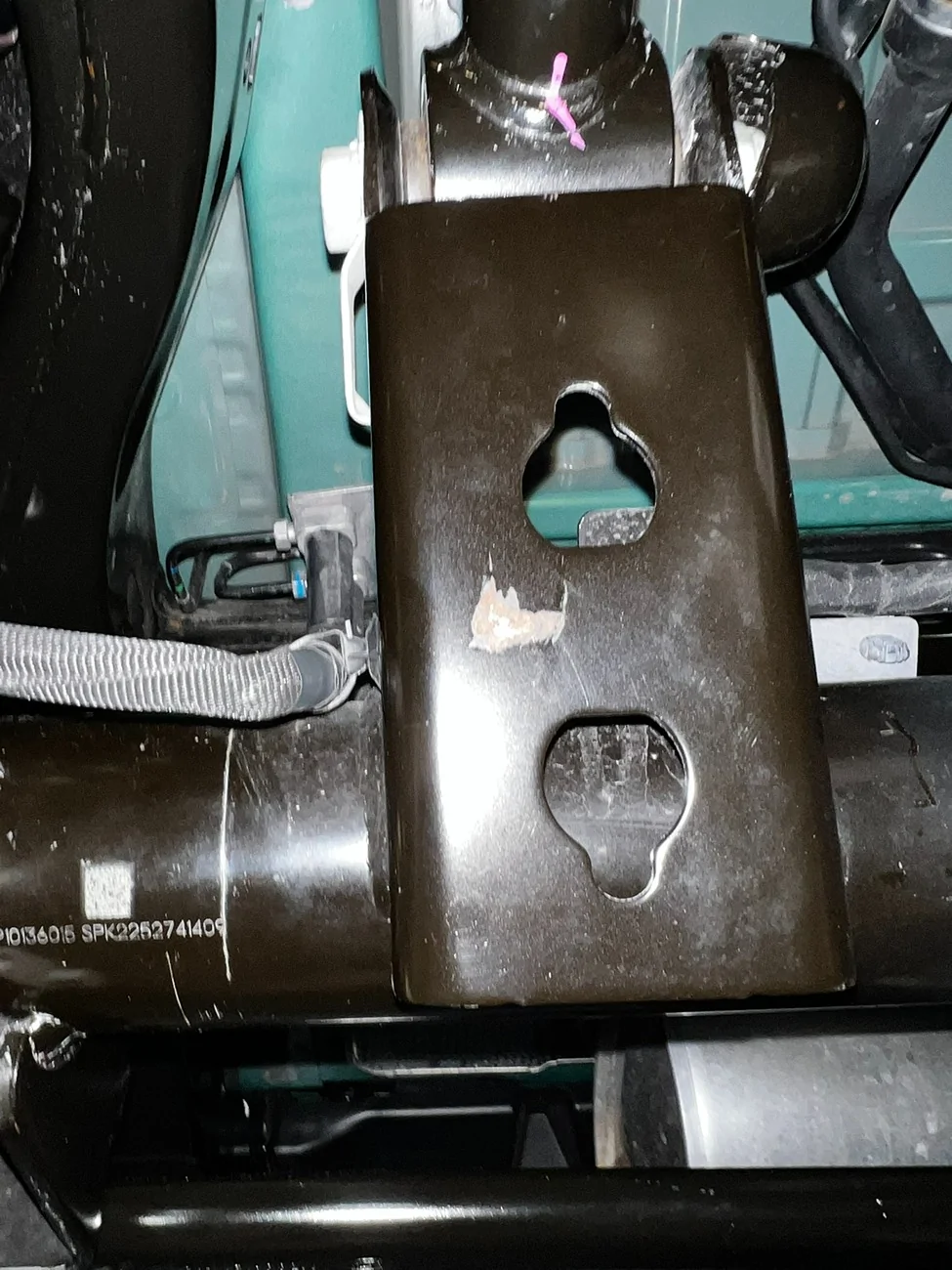

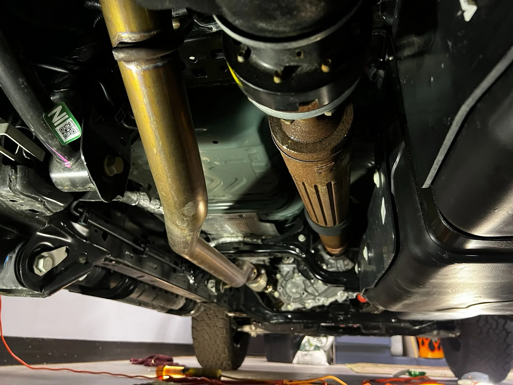

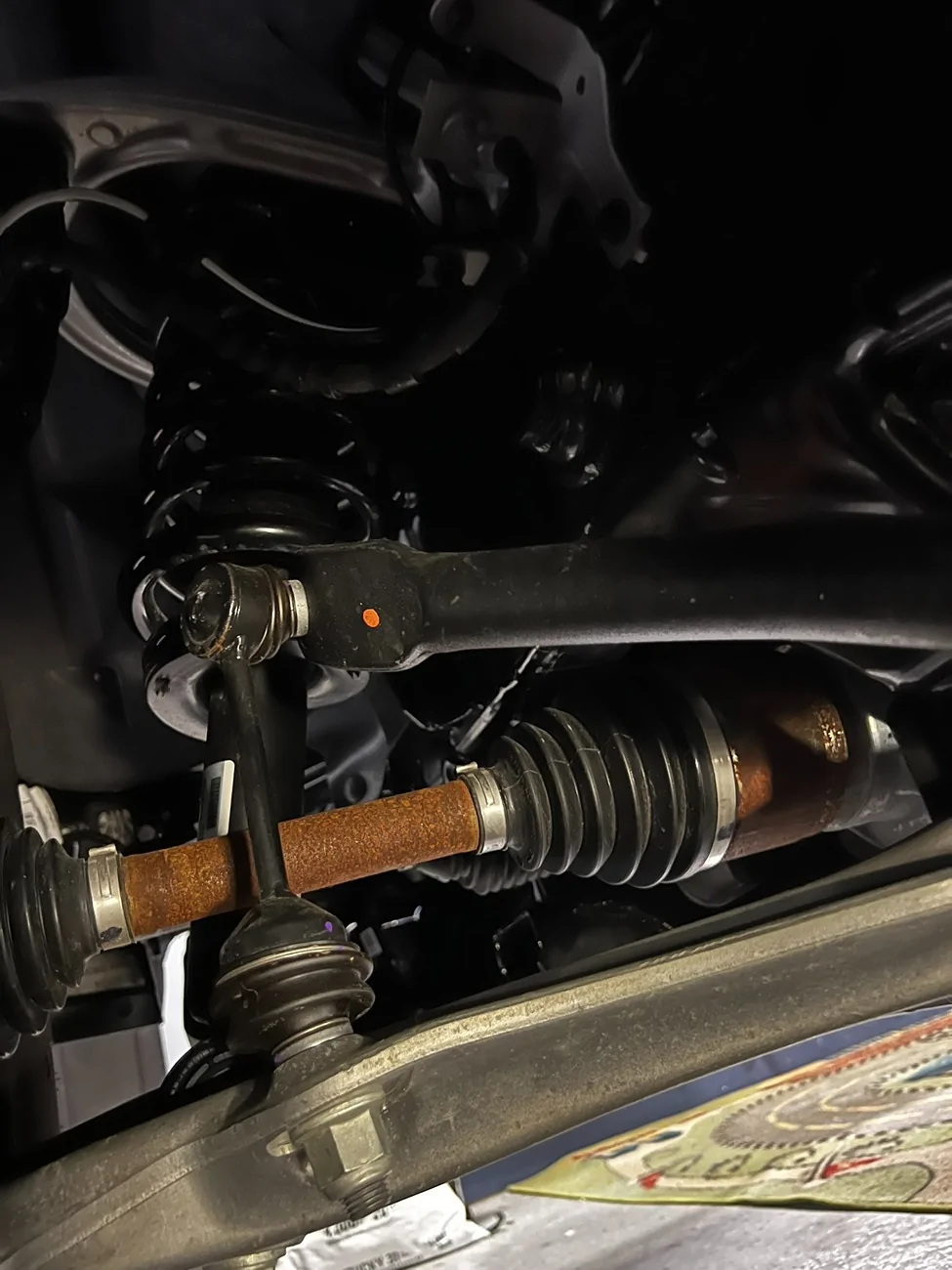

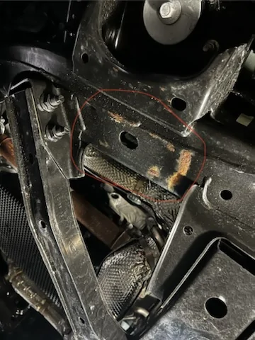

I know I'm late to this post, but I just purchased my 2025 Outer Banks in late April 2026. We have about 350 miles on it now. Just finished my complete detailing, ceramicoat on all finished paint (main body, door jams, under hood, etc).
Last night I cleaned/detailed/waxed the bottom of the truck... yes, frame and painted under body area. I'm a long time StreetRodder (1937 Dodge w/ a 351W SBF) with a bit of OCD, I want the bottom of this Bronco to last as long as the top... Garage kept, but midwest winters (e.g. salt, sand, coal, etc)... always "warm" pressure washed before nightly garage storage. I know my prep and ongoing cleaning routine will prevent rust, and I accept some rust. My 2008 Suburban w/ 283K miles has ZERO rust on the body, but I didn't wax/detail the frame and it has some rust...but overall a "top 2% condition" due to proper cosmetic (and mechanical) maintenance.
What is up with the driveshafts and front axle shaft rust??? So much from the factory/dealer. I'll investage some thin paint for them, something that won't impact balance. Consider the weight of spray can paint, and figure that a lot of it is propellant, I'll assume fractions of an ounce of paint. similary, consider the large amount of grease or crud on a lot of cars, there far more weight than paint would give, and the grease/crud isn't uniform like my paint will be.
Also, typical rust spots on front bottom of frame where lifts scratched the frame... @huey any suggestions on paint to match the ecoat? There are some weld/silica-island discolorations/oxidation, but I'll live with those and hope the ecoat doesn't "lift" next to the silica-island.
Thoughts on fun colors to paint driveshaft/axles? I'll probably go Rustoleum satin-black, but know that some fun stripes would be fun too! Not just for me, but for the folks I pass on the highway, and the maintenance guys at the Ford Service Departments.

It's just exposed metal, it isn't ever going to cause an issue.
Yes, just surface rust and no mechanical/operational issues. But it looks like $*!t under my (wife's) prestine Bronco. Again, a bit OCD, and I like to keep my vehicles just as clean under as on the top... This Bronco is great, I can roll around under it on a mechanic's creeper... Now my 37Dodge, I can't even get a floor jack under it without parking on 2x6 wood blocks... :cool:

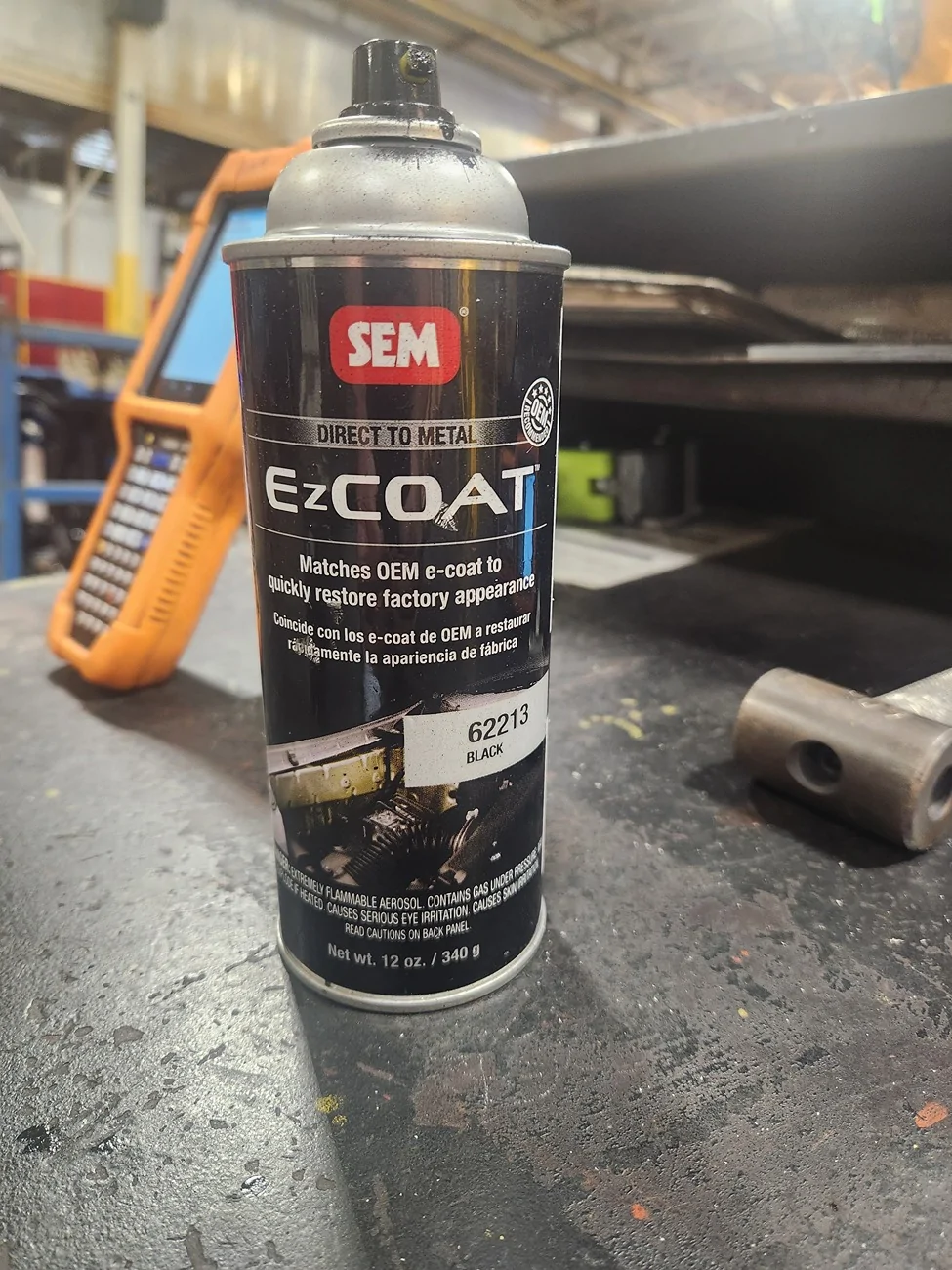

Welcome to the forum @FORDGE37 !
From reading your post you are determined to go down the OCD path - use this product from SEM. This is what we have for touch ups at our plant, it may not be what they use at the location where the Bronco frame is made but it is Ford approved at our division.
Good luck!

yep, used it on lots of pre-48 car/truck stuff, trailers, etc. POR-15 is awesome! Can be a bit heavy, won't use it on a driveshaft/axle-shaft. But is great stuff!
I would not use it on a drive shaft or axle either... I agree with you. Like I said though I think the Drive shafts are some sort of Corten steel (or similar) where the rust layer actually is intended and becomes a passivation layer where the rust can not dig any deeper than just the surface.

I'm going to touh of the paint with @huey suggestion. And I've determined that I must accept the "passive layer" of rust on the axle-shafts and driveshafts. I'm rather bummed, but with today's comments/suggestions, I'll leave the "passive layer"...

I do not know if you could paint over it or not.... I am not telling you not to.... I just do not know how well it would adhere or how long it would last. I doubt it would cause it harm... I just do not know.
