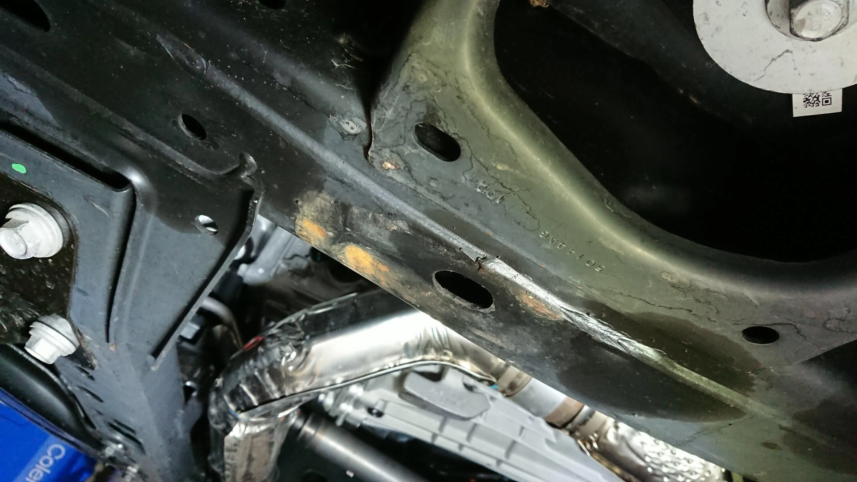

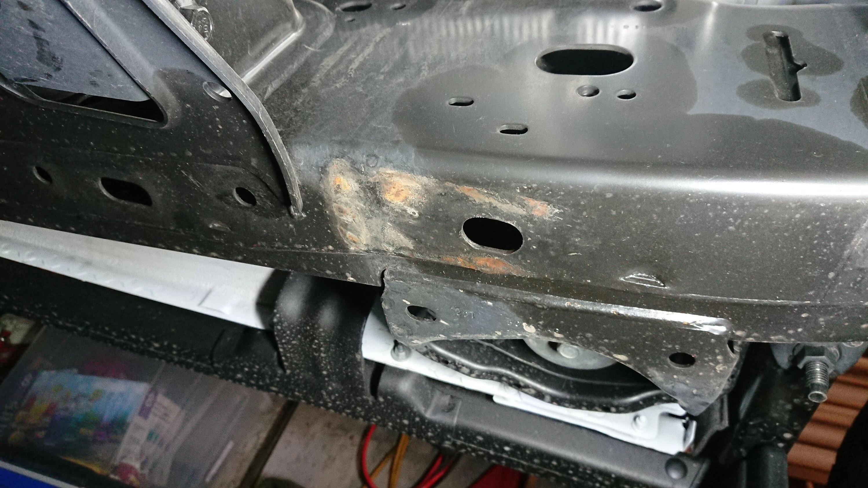

I found similar spots on my brand new bronco I picked on 7/21/22. It looks like it was put on a lift before the frame coating/paint had time to properly cure.

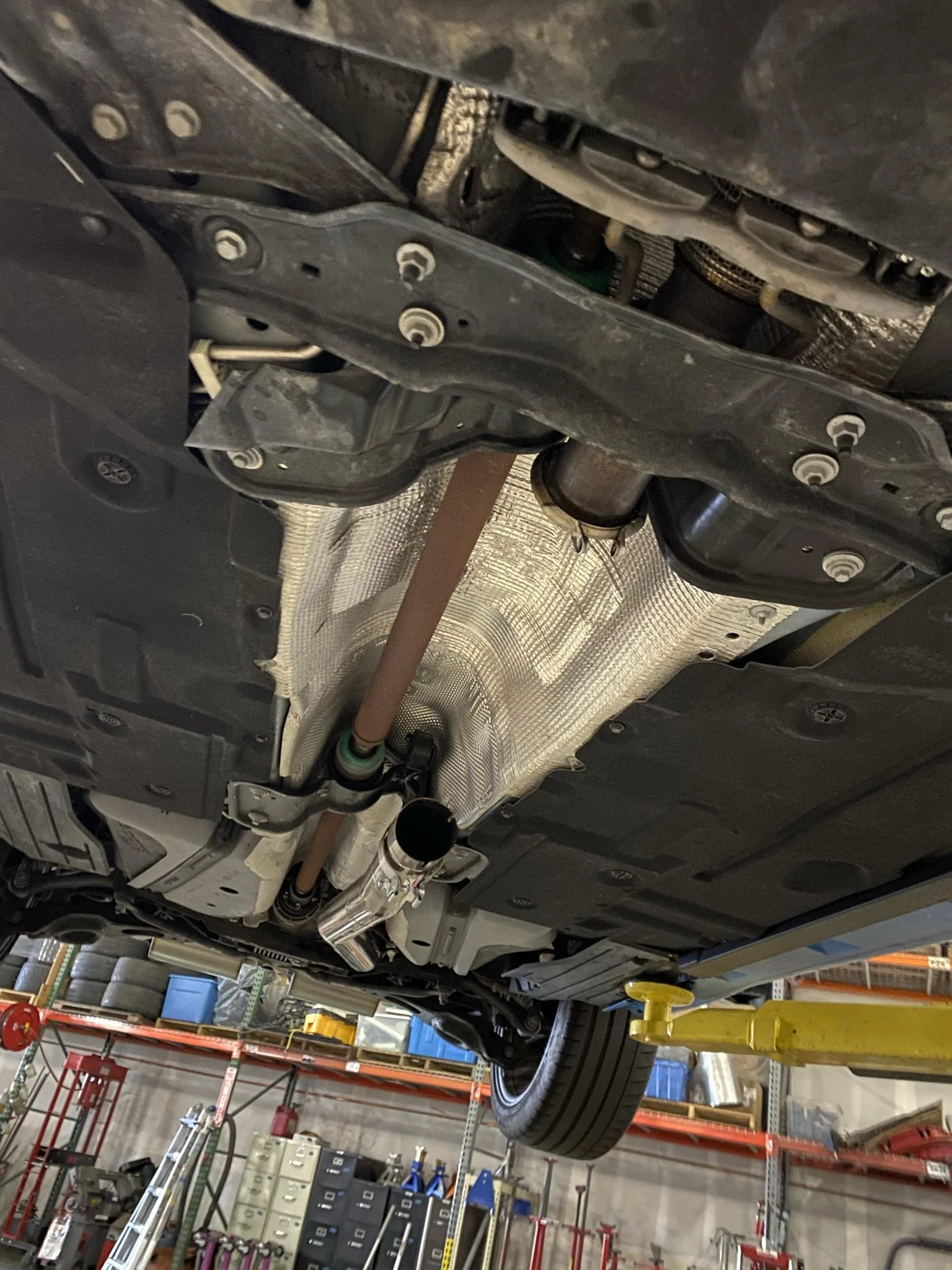

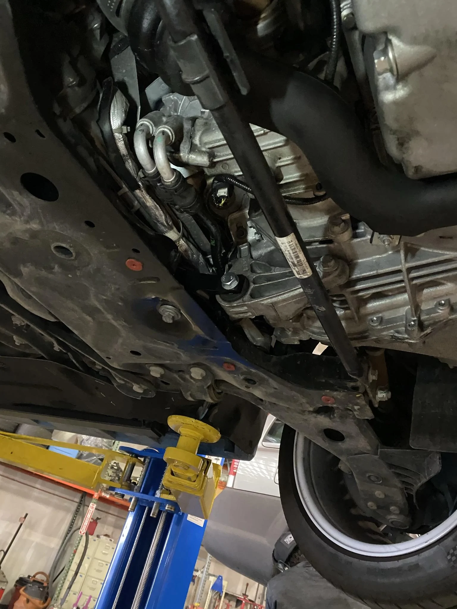

Here are some shots of my RS, including subframe components with similar amounts of rust proofing after 5 years now — I expect rust on the exhaust and driveshafts after no time at all, but haven’t owned a body-on-frame truck until now. I’d rather take the time and sand/prep these spots instead of waiting to find more rust later on.
Oh my god, just look at that driveshaft if you don't do something soon it's going to rust in half and leave you on the side of the road.

Picking up some POR-15 soon. Will sand away as much rust as I can see, degrease, and treat both sides sometime next week. Just annoyed it seems like these were caused by a two post lift.
Por 15 is the best for sure, the only downside is that it is a tedious multi step process. I am in NorCal too and am frustrated by all the rust on the frame as well - no matter what others say, Ford should have painted the frame thicker and more thoroughly. Let me know how long it takes you to do. Do you have a lift or access to one? Or are you going to do it on the ground?
Damn - just saw the post date - Did you already Por 15 it?
