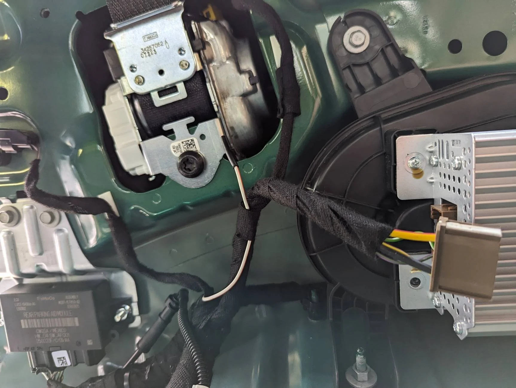

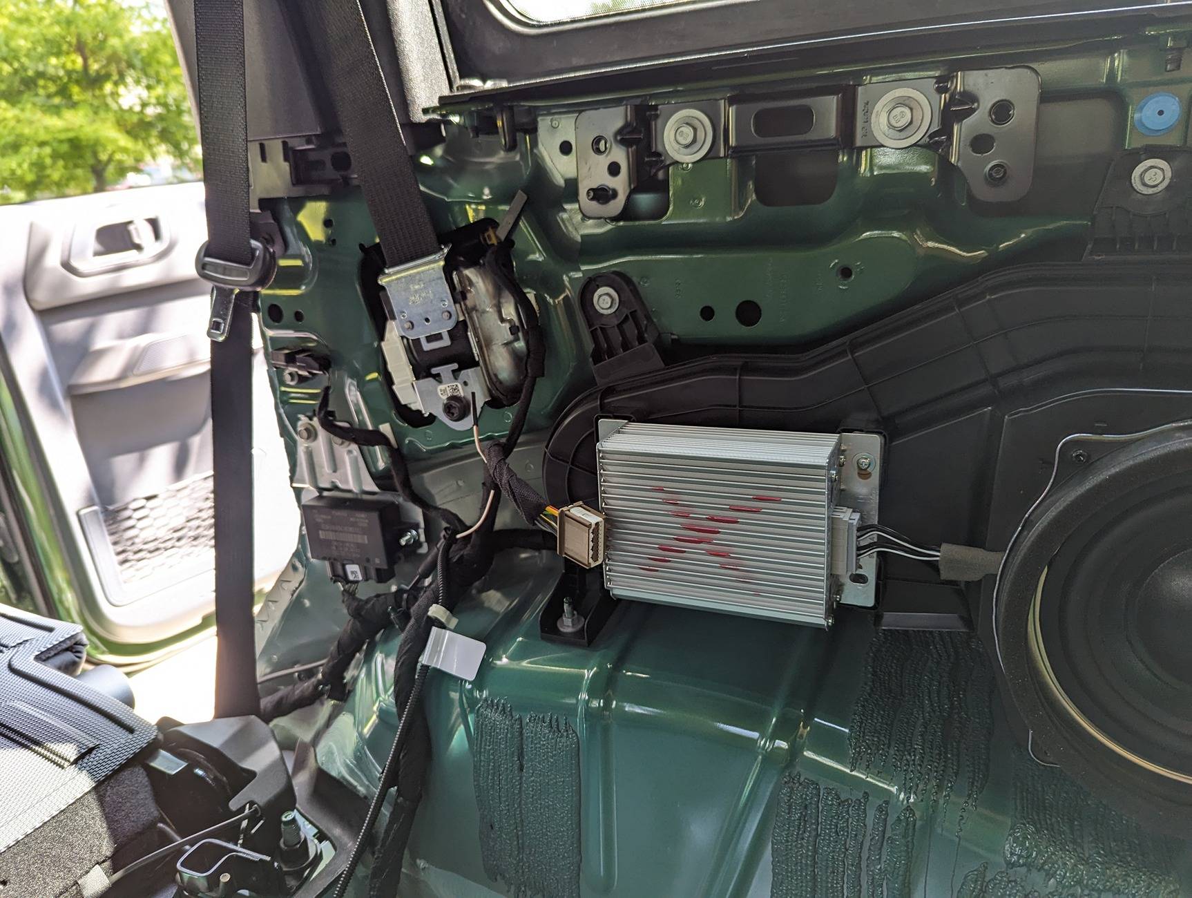

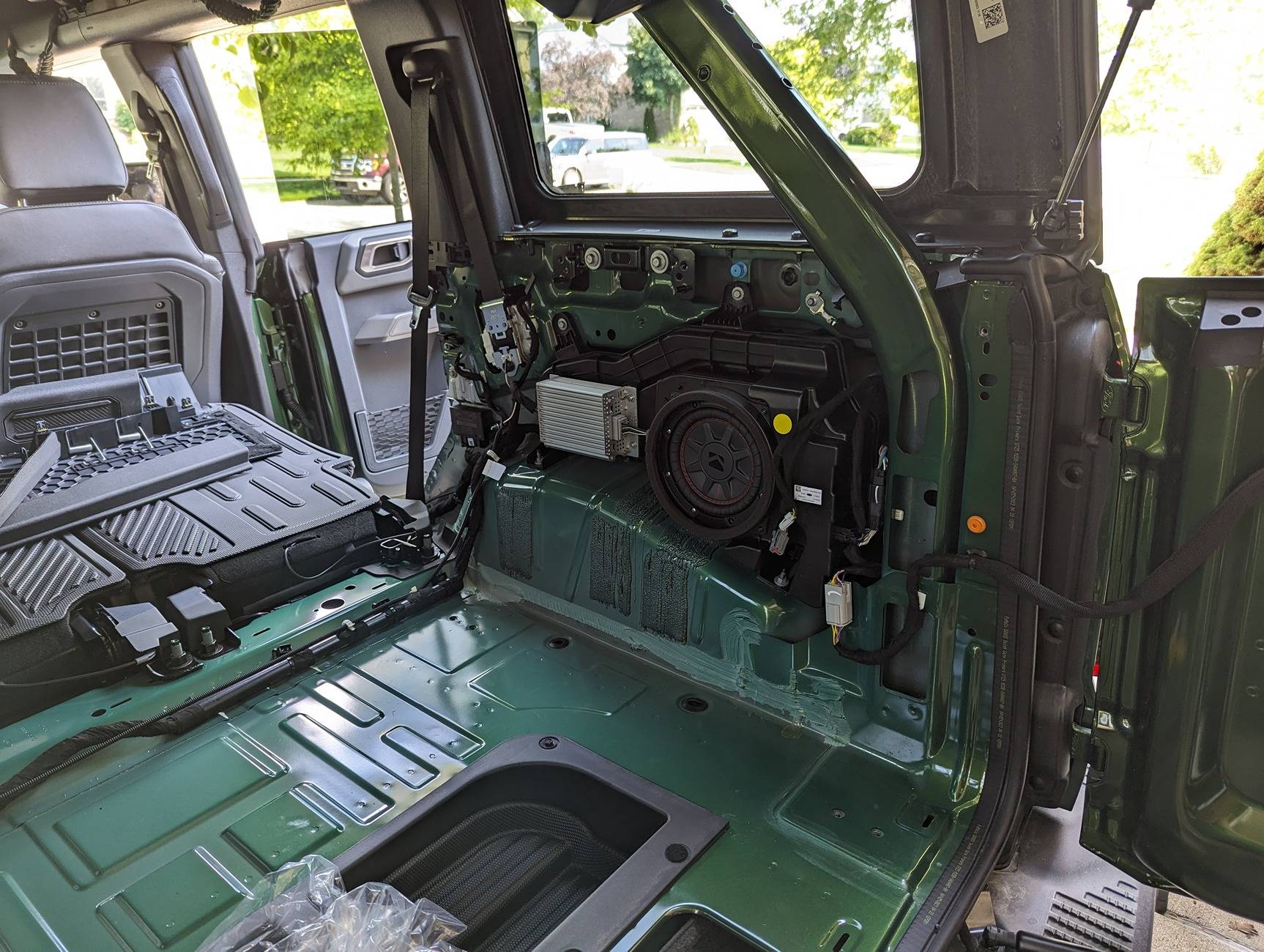

As someone mentioned, the trim is the most difficult part. The speaker is easy if you purchased the correct size. Sounds like you did. The amp mounts right in place of the old dummy amp. The wiring plugs right into the new amp. The pcitures are probably not much help but I'll include them.
If you have the accessory switches, the rear power wire ends near the amp. Now is the time if you want an accessory powered in back or rear of the car. It would be easy to connect or extend the wiring while the inside panel is off.
Ford Bronco Subwoofer delete installation advice, tips, tricks? PXL_20230804_191750534
Ford Bronco Subwoofer delete installation advice, tips, tricks? PXL_20230804_200414643
Ford Bronco Subwoofer delete installation advice, tips, tricks? PXL_20230804_191755024.MP
