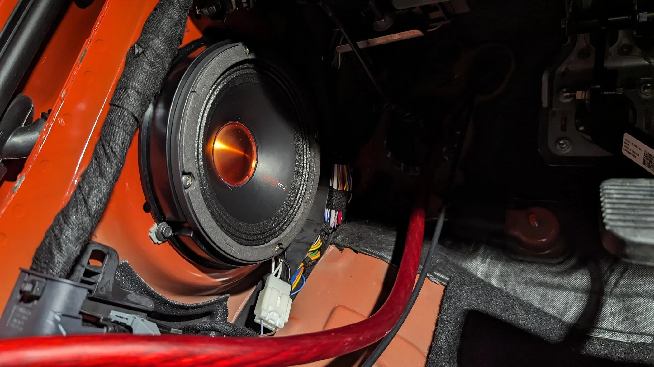

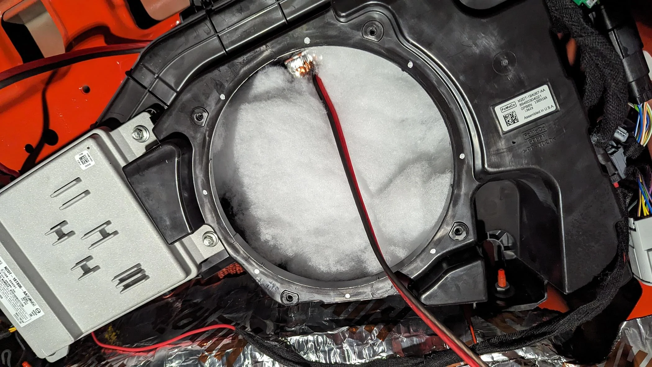

There's definitely some options out there - I think some have even installed the B&O enclosure with an aftermarket sub. Really depends on how "stock" you want it to look and how much if any cargo space you are willing to forego.

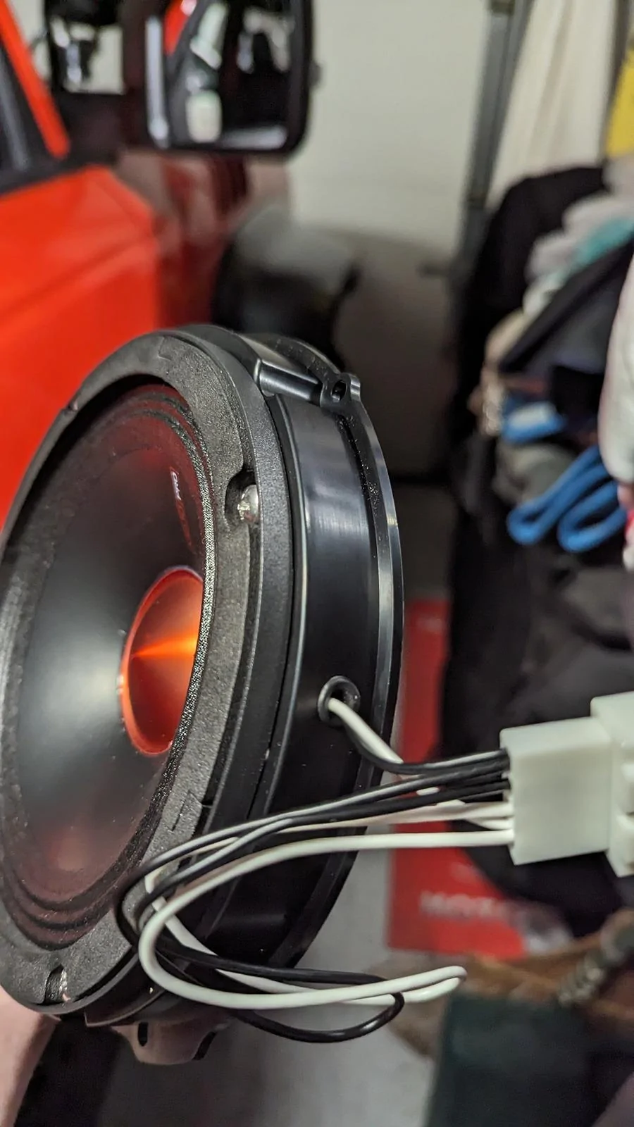

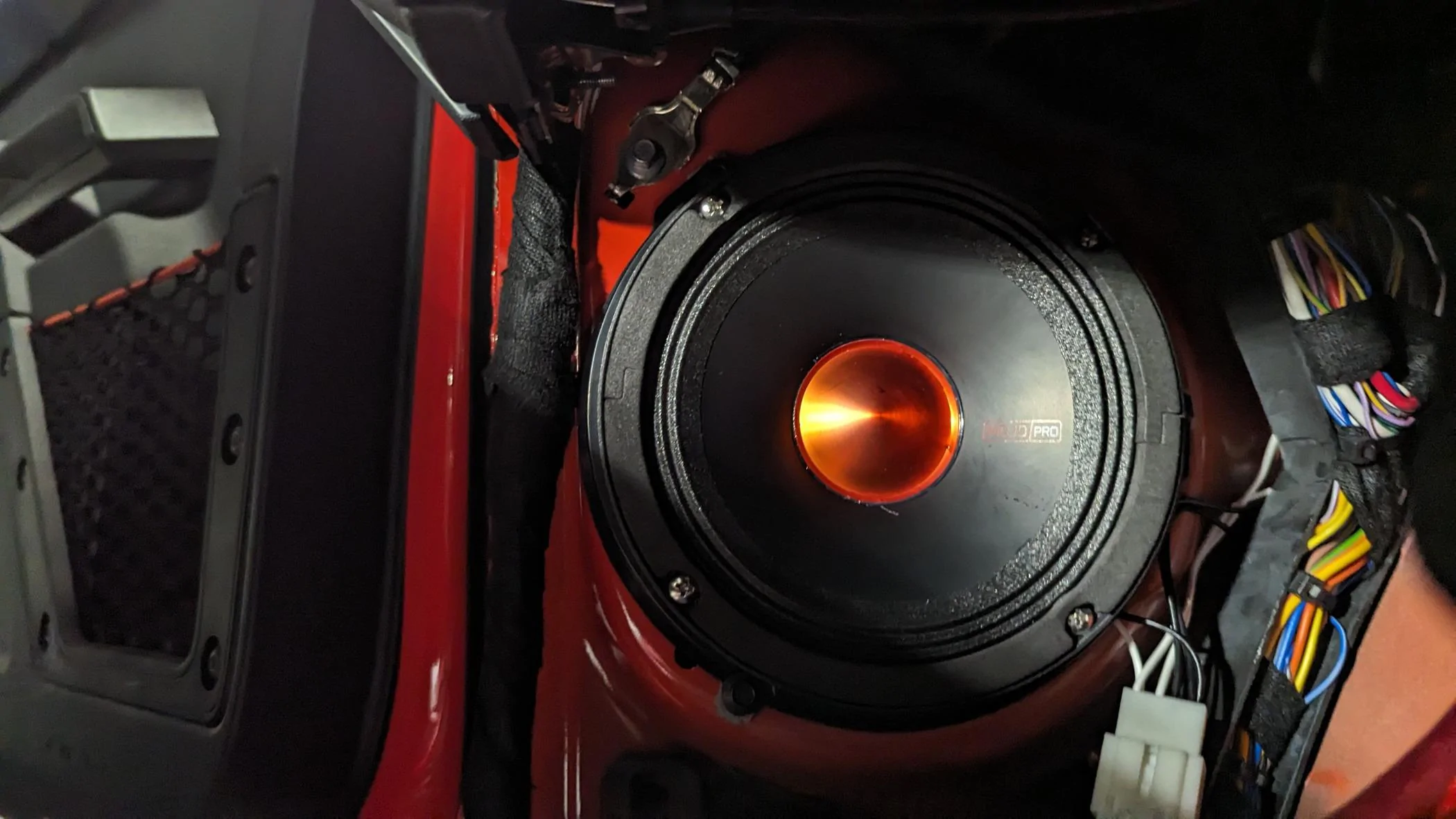

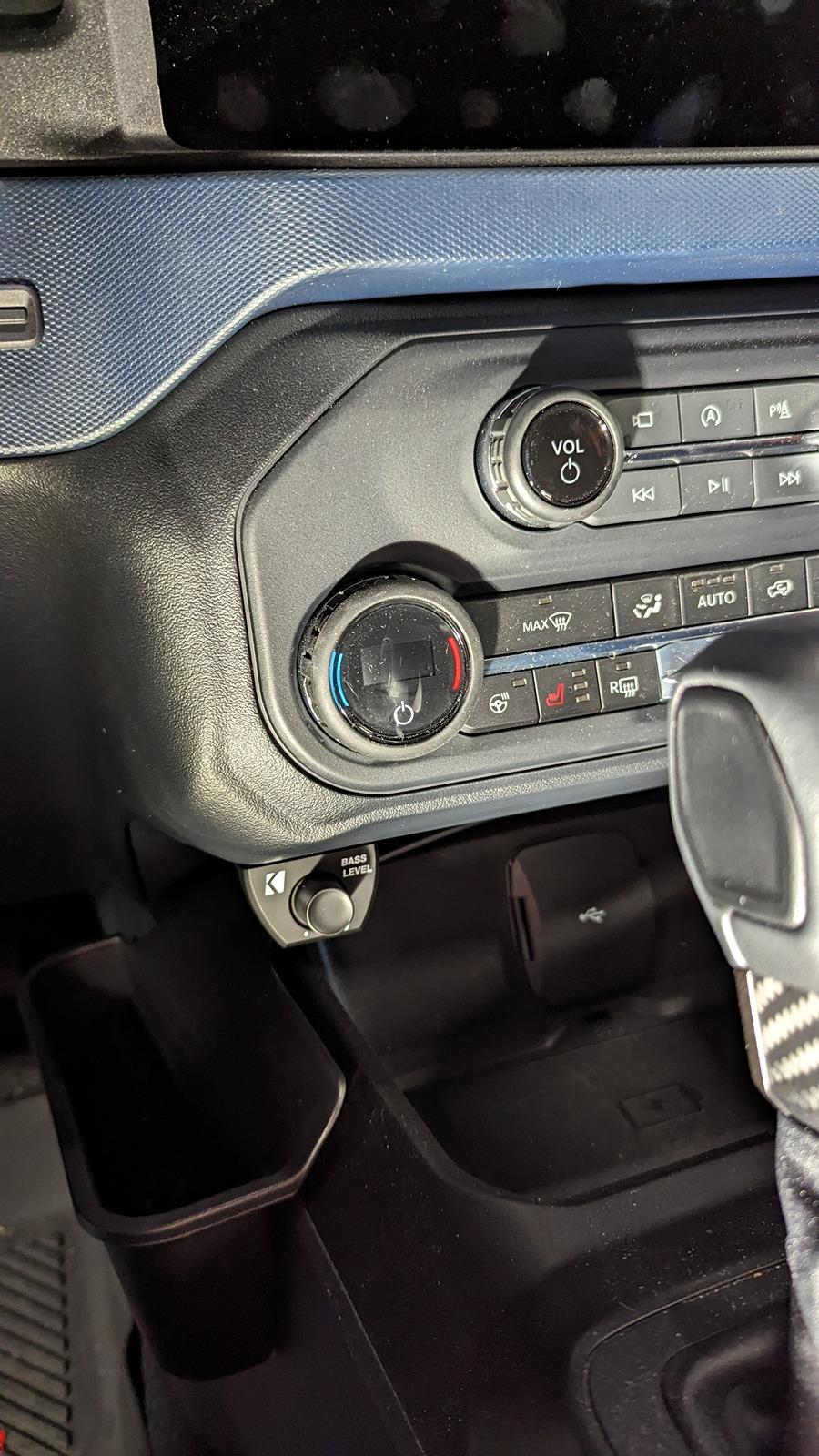

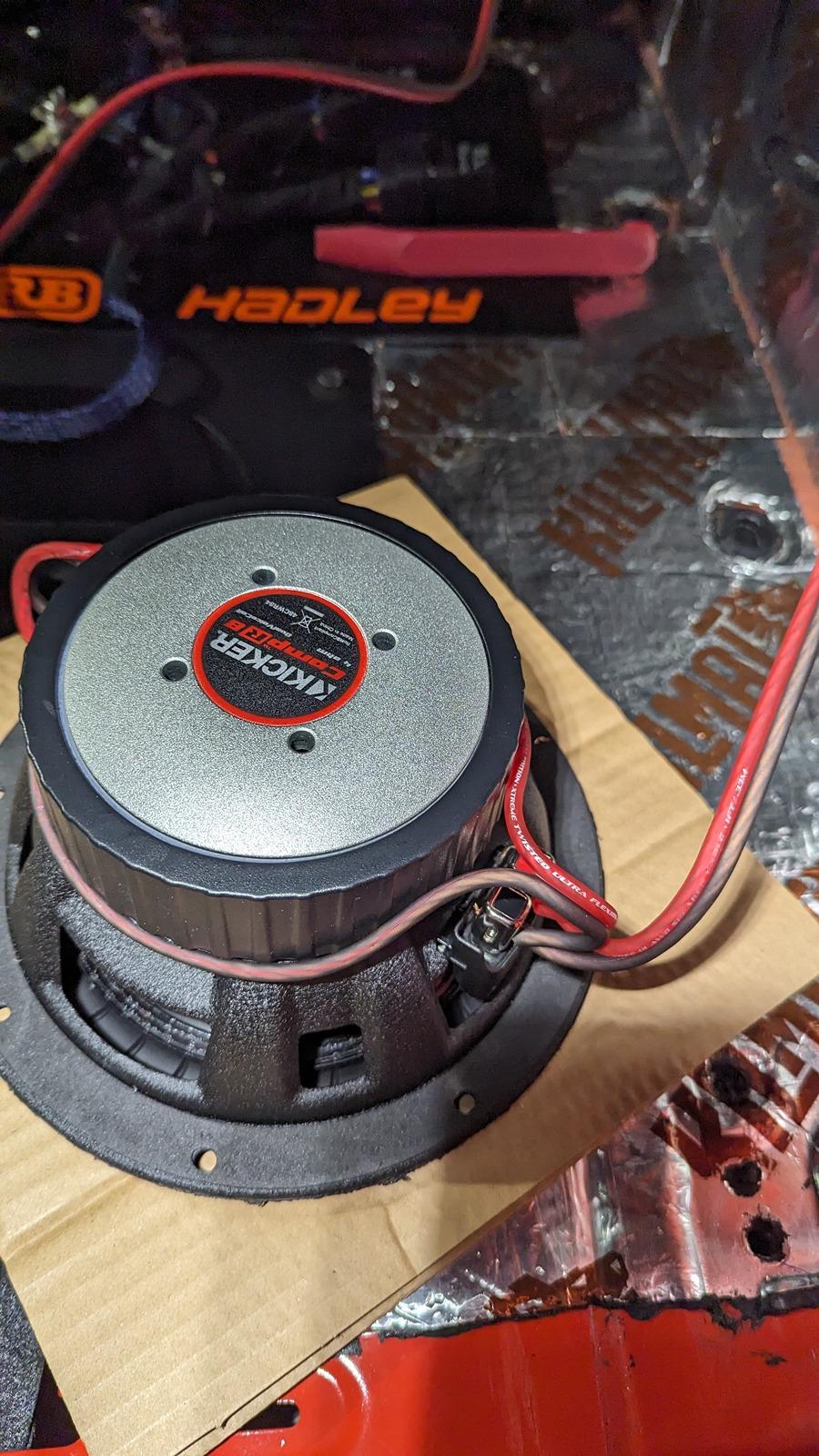

I have/had the B&O system and it was terribly disappointing (not even for the money aspect - just overall disappointing) By making a few tweaks with new speakers all around and an amp for my sub - I'm very happy with the overall system now. Personally I didn't want to give up the cargo space - for taking roof panels off on whim or other unplanned excursions that require use of cargo area. I also have the slideout tailgate so I already compressed my rear cargo space about 4" - that luckily left me some room underneath for an amp and onboard air though.
