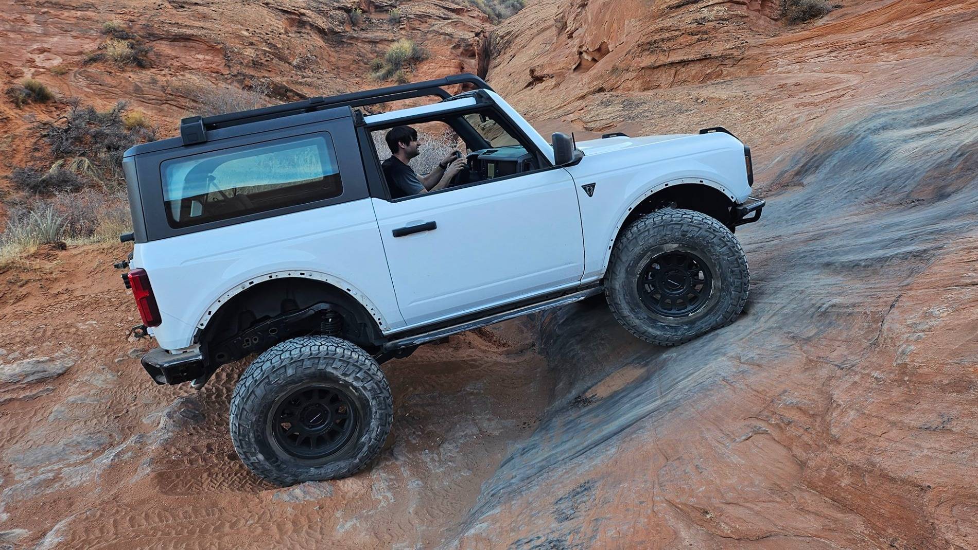

Method Bead Grip 703. 17x8.5 ~ 27lbs
The combination wheel/tire is rather light. Wheels saved weight (from factory bead lock ~34lbs). Tires are extremely light for 37 (load D) ~70lbs. Really is the perfect tire/wheel for the Bronco.
We also have them on our Raptor. It gets slightly less mpg but nearly the same as factory wheel/tire. Can hit 20mpg on the hwy.
