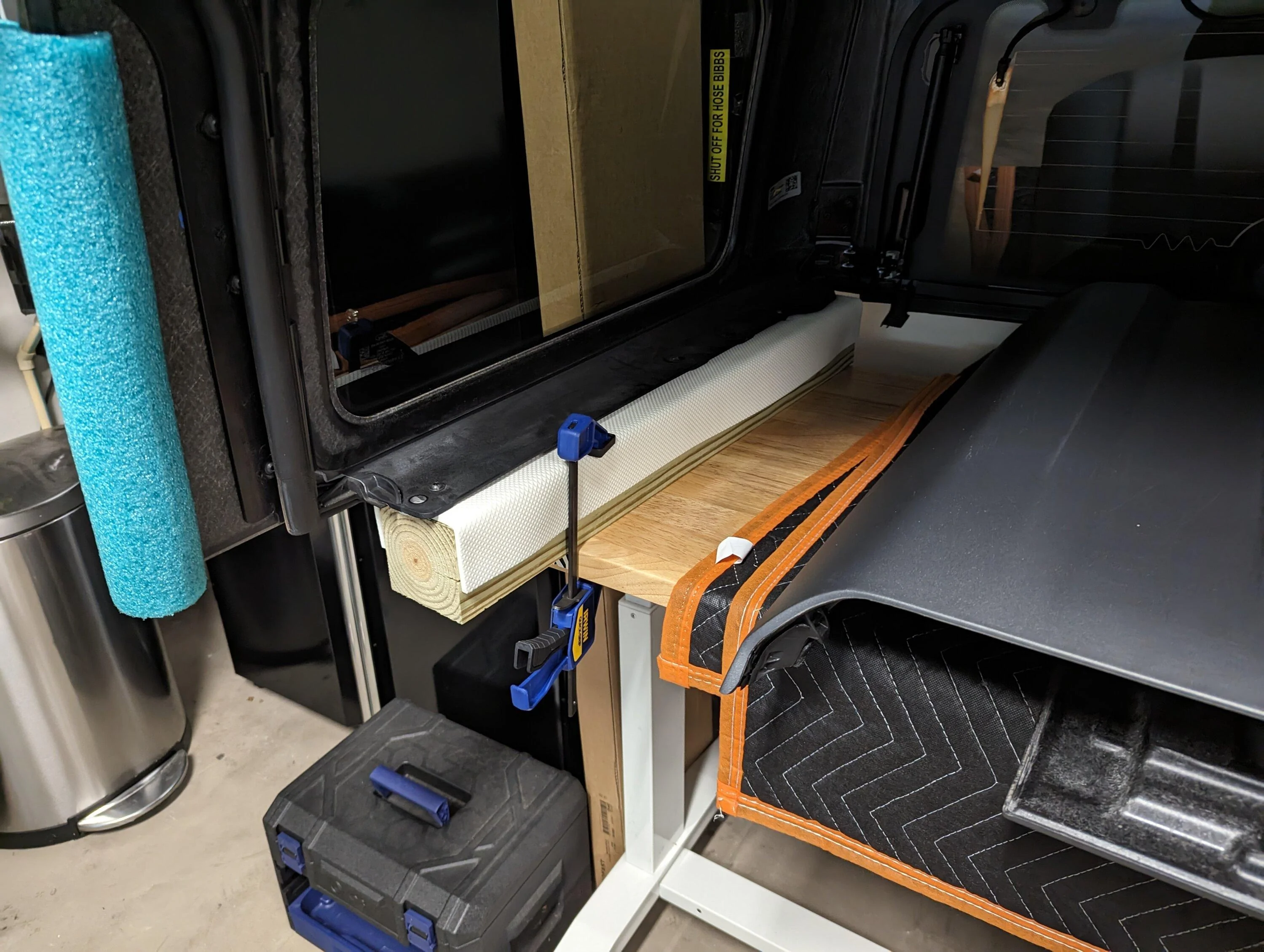

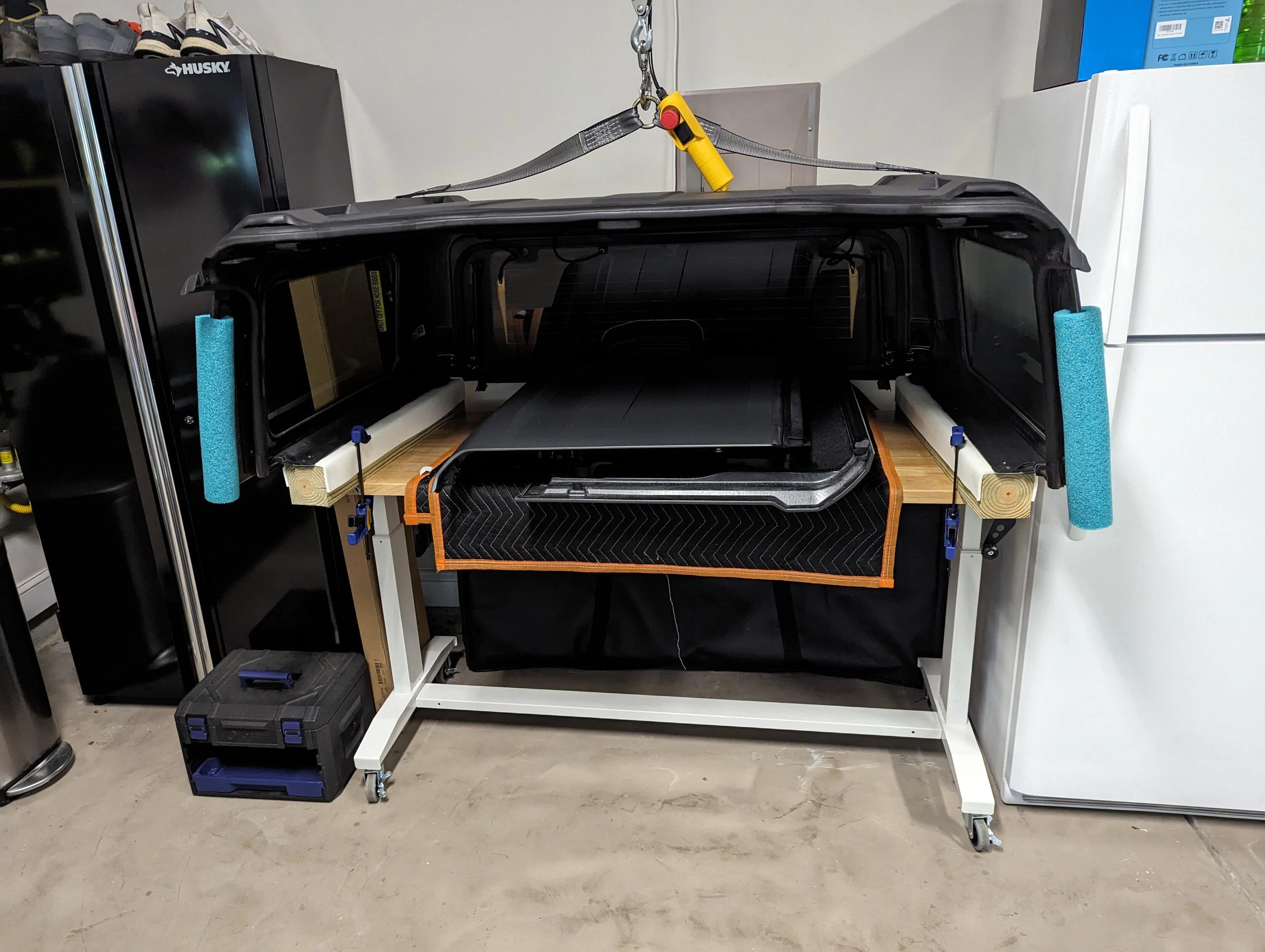

I just drilled some holes in a couple 4x4s and then threw some foam pad material on top that I had laying around. Fits like a glove. I'll be adding a shelf above the fridge and cabinet to eventually move this up to so it doesn't take up my table space. I have a winch on a trolly system to be able to clear the shelf when lifting it.

I really like this solution. How deep is the table you have that set on? And how wide is it?

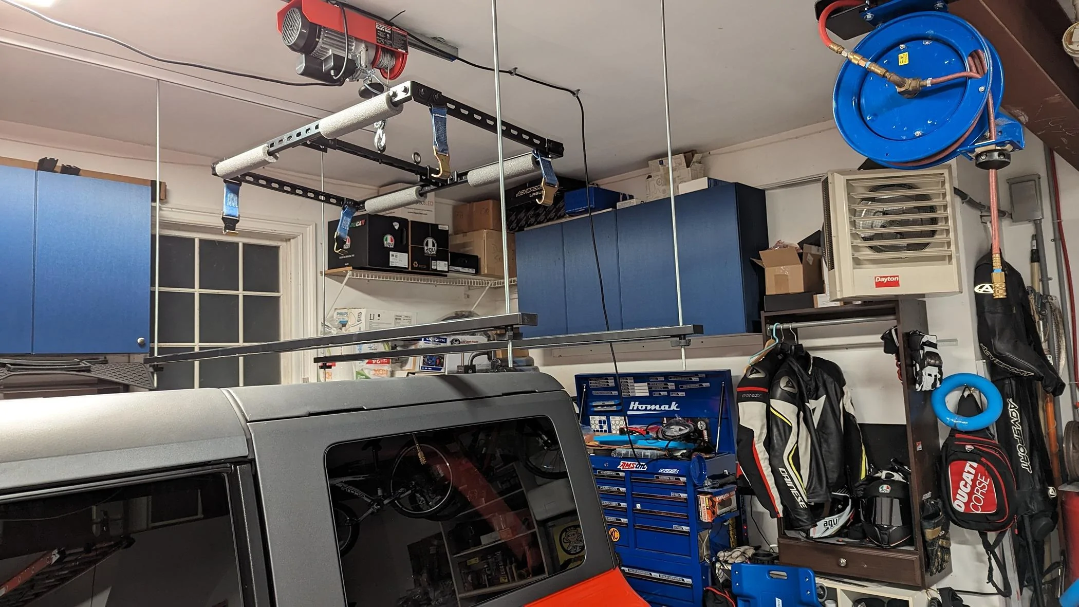

2x4s or hard foam insulation panels. Mine is suspended by a hoist but rests on a floating shelf of aluminum 1x4s with foam pipe wrap across top. Wood 2x4s was the prelim design.

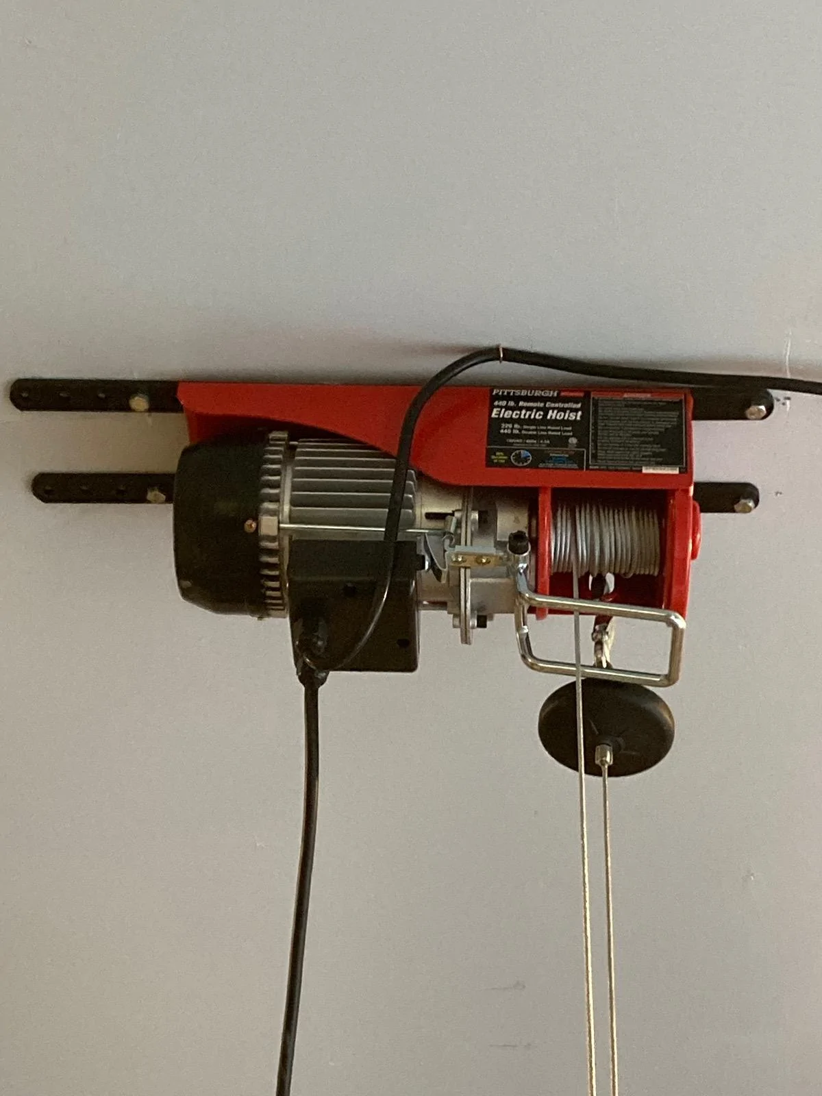

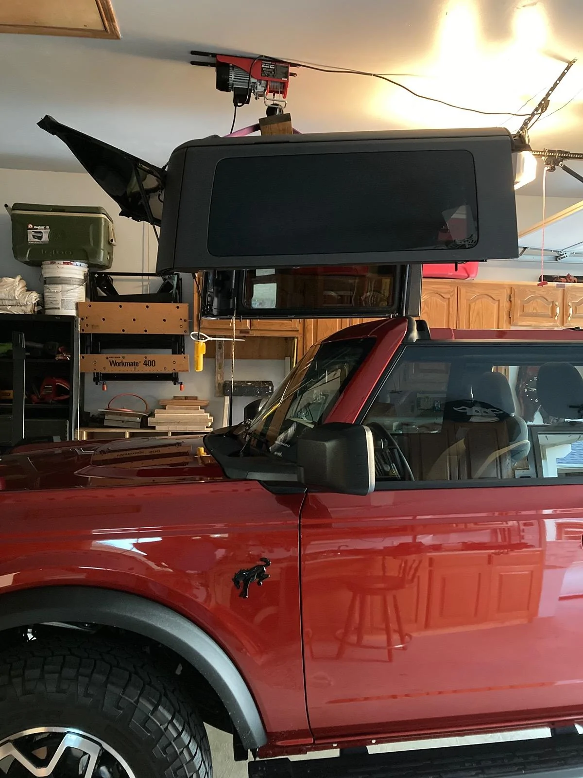

harbor freight special , find the equal / level points and lift it to the ceiling

Hell yeah. These are like the perfect use for the HF hoist.
I went all out with mine -- my garage has an accessible attic, so cut a hole in the ceiling and mounted the winch above it. Made a rack with attachment points so I could keep it relatively balanced.
Then took it one step further by relocating the raise/lower switch to a blank faceplate in a wall box. No dangly pendant for me!
Looking at yours, I may have gone a little overboard with my hoist mounting -- ran a piece of unistrut across four roof trusses to spread the force.
I really want to convert it to that hook style Johnny Mo's using rather than ratchet straps from underneath, but I'm nervous about it staying secure, especially when lowering back onto the vehicle.

I’m doing something g very similar and planning on using 2x4 like your picture. Why did you end up with the 1x4 aluminum?
thanks
The wood was much heavier and rough finish, I liked the aluminum because then I didn't also need a washer on the bottom with the wingnut. With the foam padding and plasti-dip spray on - the aluminum looks alot more "finished". I can rest the padded aluminum on the top while I remove it and then rest it on the roll bar while I "bolt up" each side. That and my OCD didn't like the look of the wood.

I got it at metalsupermarkets.com I can't find the email with the details - I'll keep looking to see if I have more details.
EDIT:
Found the packing slip - I ordered Aluminum Rectangular Tube 6061T6 Round Corner.
2" x 1" x .125" (thickness) and 78 in length.
