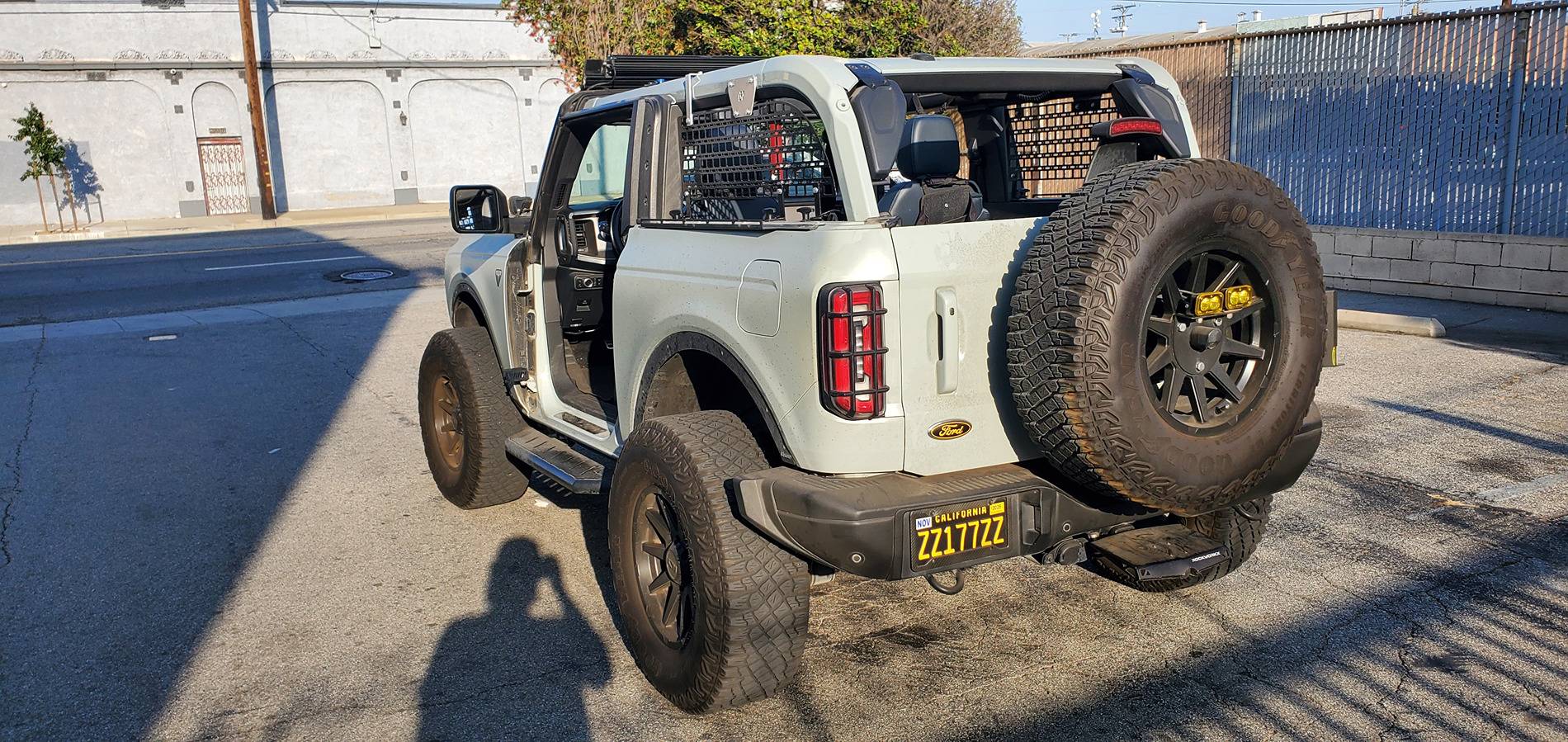

2 weeks ago I spent about 30 minutes taking off my limb risers, Trailrax roof rack, the hard top, and the doors off.
It wasn't too bad, but it got too cold during the Los Angeles mornings and nights that I had to at the least put my doors back on.

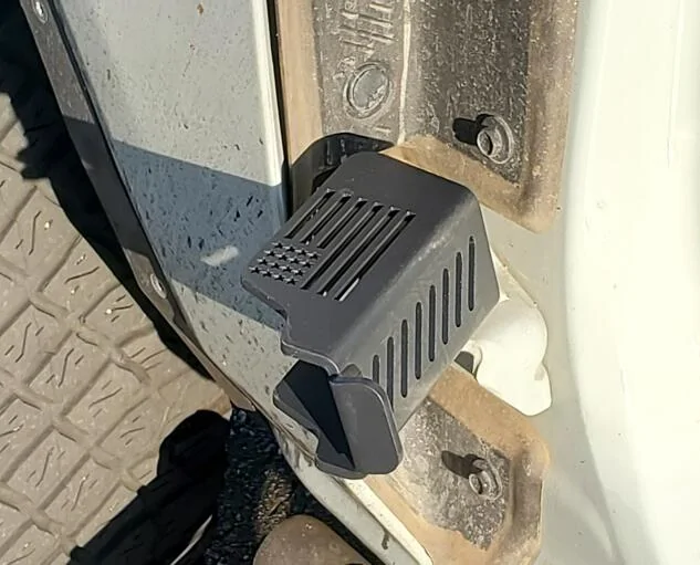

I got these permanent door guide pins from @EZ4x4 that replace the OEM bottom bolt and has a door guide built in to them.
Ford Bronco Permanent door guide pins from EZ 4x4 1751329696046-33
I cannot express how easy it was to put the door on just bolt it in place!
Putting both doors on my 2D took under 10 minutes, mostly time from bringing the doors from inside and just tightening screws.
I used these pins throughout the week with the foot rests that attach here and they were solid very solid, and also hinged in and out like the door.
Clever design.

Mike, what makes these easier to use than the guide pins that come with the truck? Just nutting these, whereas you have to remove the factory supplied pins and put the bolts back in? Does the additional height make them that much easier to align?

First, the fact that they're longer makes it much easier to align the top hinge, and second, the fact that you don't have to pull them out and be confident that the door will hang there while you go grab the hardware and tools!

I have had a set on my 4-door for about two months. The doors have been on and off 5 times with no issues. It really helps in alignment. Now I need to get the foot pegs....

I just installed a set of these today. What a difference!!! They are much easier now to get back on and being able to leave them in place is awesome. This should be one of the first mods for anyone new to the Bronco if you’re intending to ever take the doors off!!! I am so glad I picked these up!!!
