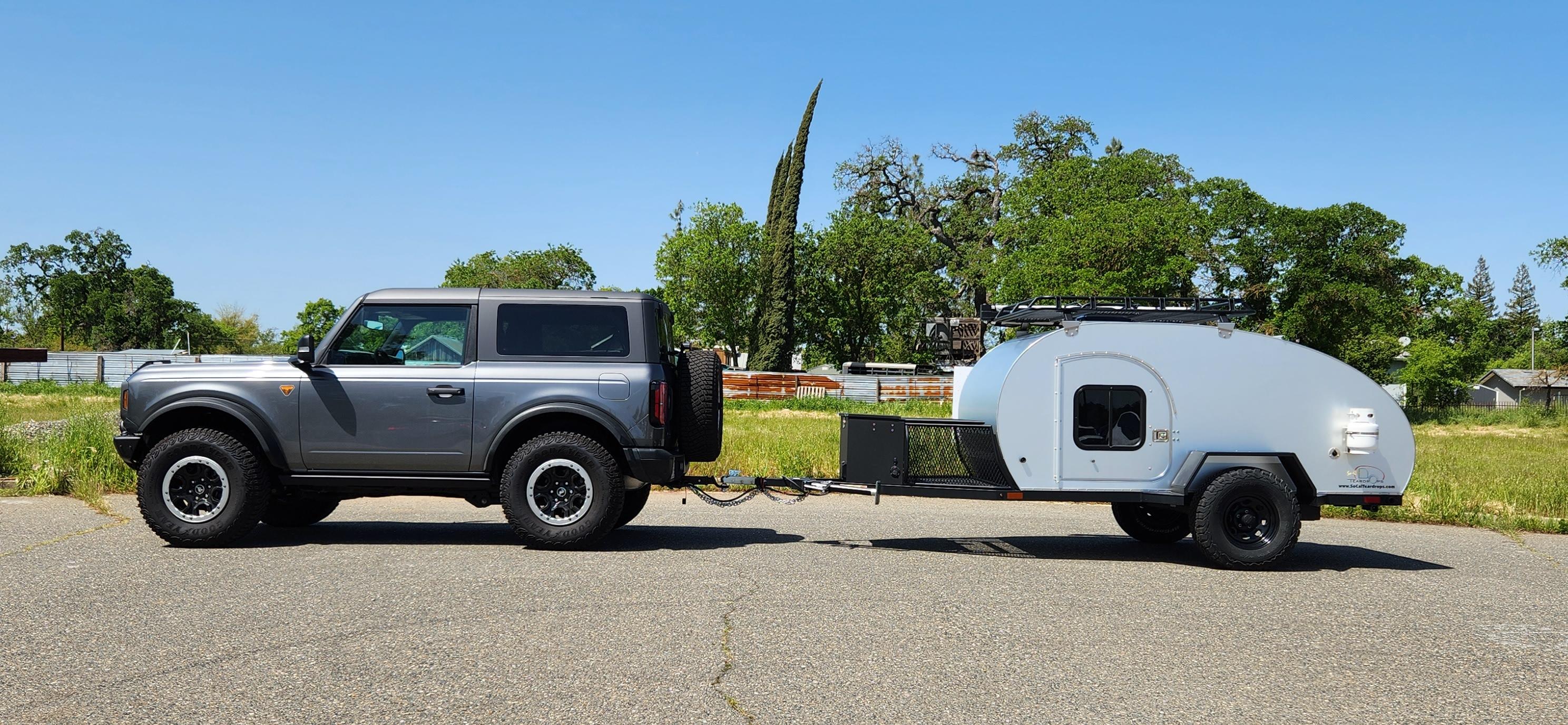

I was leaning toward sumos but after hooking up trailer and driving I'm gonna have to mull it over some more. Sag wasn't as bad as expected (1 inch lower in rear, 1 inch higher in front) but the trailer weight throws the Bronco around (up and down) more than my previous tow vehicle. Gotta be the supple suspension on Badlands? Maybe stiffer springs are better that than sumos?
