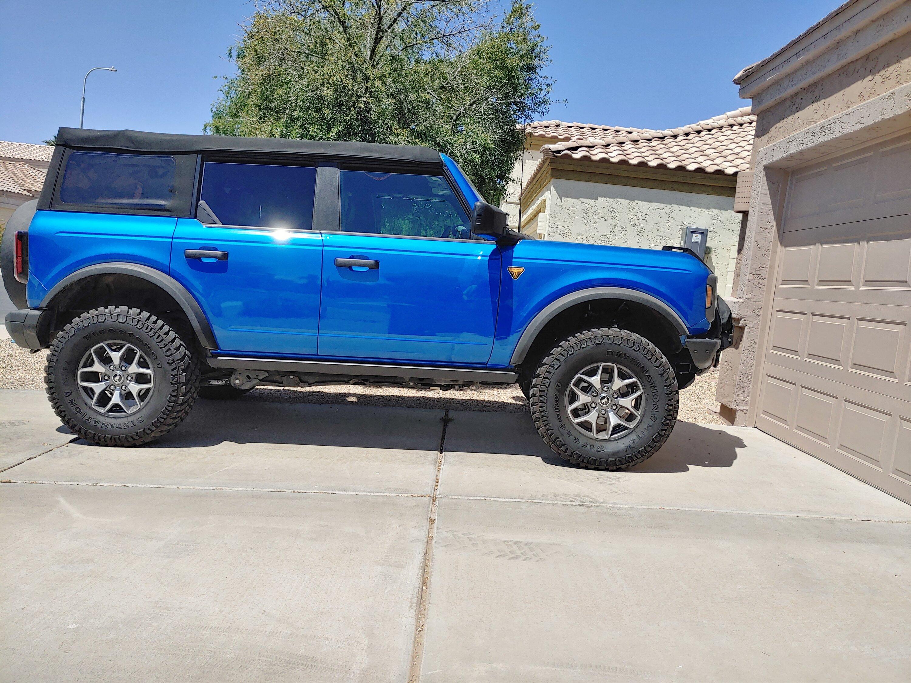

I installed the Broncbuster 1.5" spacer lift on my stock Badlands. I scored it on an early black Friday sale. Yeah it's spendy, but it is 1.5" all around. No leveling in front. It's exactly what I wanted.
Install sucked in front. I did not have fun with that, but I did it, set alignment. Havent had any problems. Rides just fine.

Looks great. Are those 35’s?

Close enough. 315.70.r17. Firestone' s exact measurements are 34.4". Not sure on width. They appear a tad skinny compared to other 315's. Maybe its my eyes, or the tread pattern playing tricks.

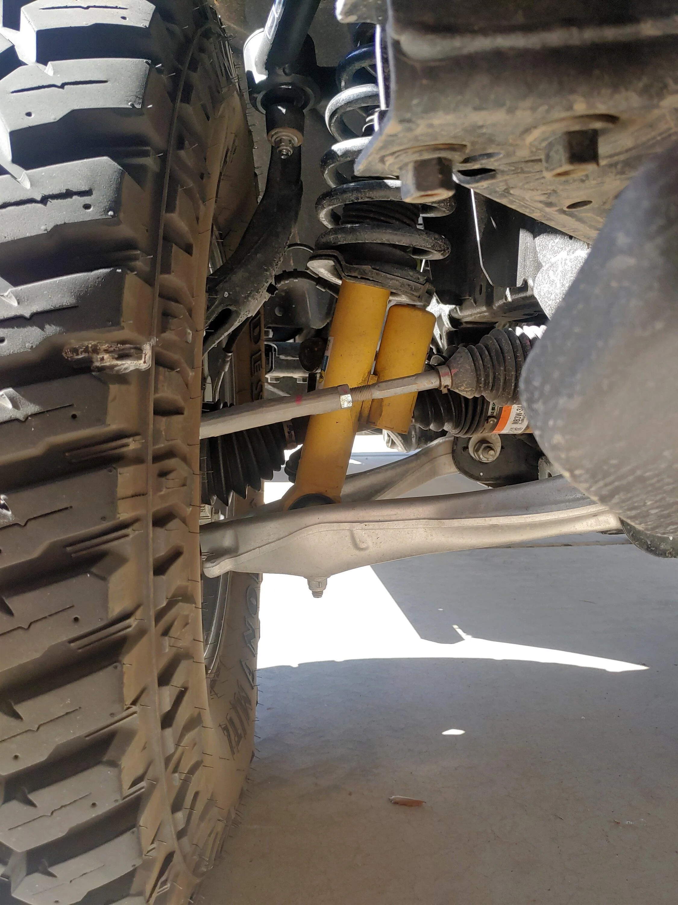

I know spacers get flak, but it seems crazy to throw away a good suspension just to drop big money on other good suspension. At full droop yeah the angles are extreme, so I guess we'll find out if sh*t grenades in Moab. Ha! Word is we have 3 inches to play with, then we need to look into diff drop, etc.
Here's a quick shot at ride height. I might have other photos on my build journal.
You can see I still have a bit of clearance from the UCA.
