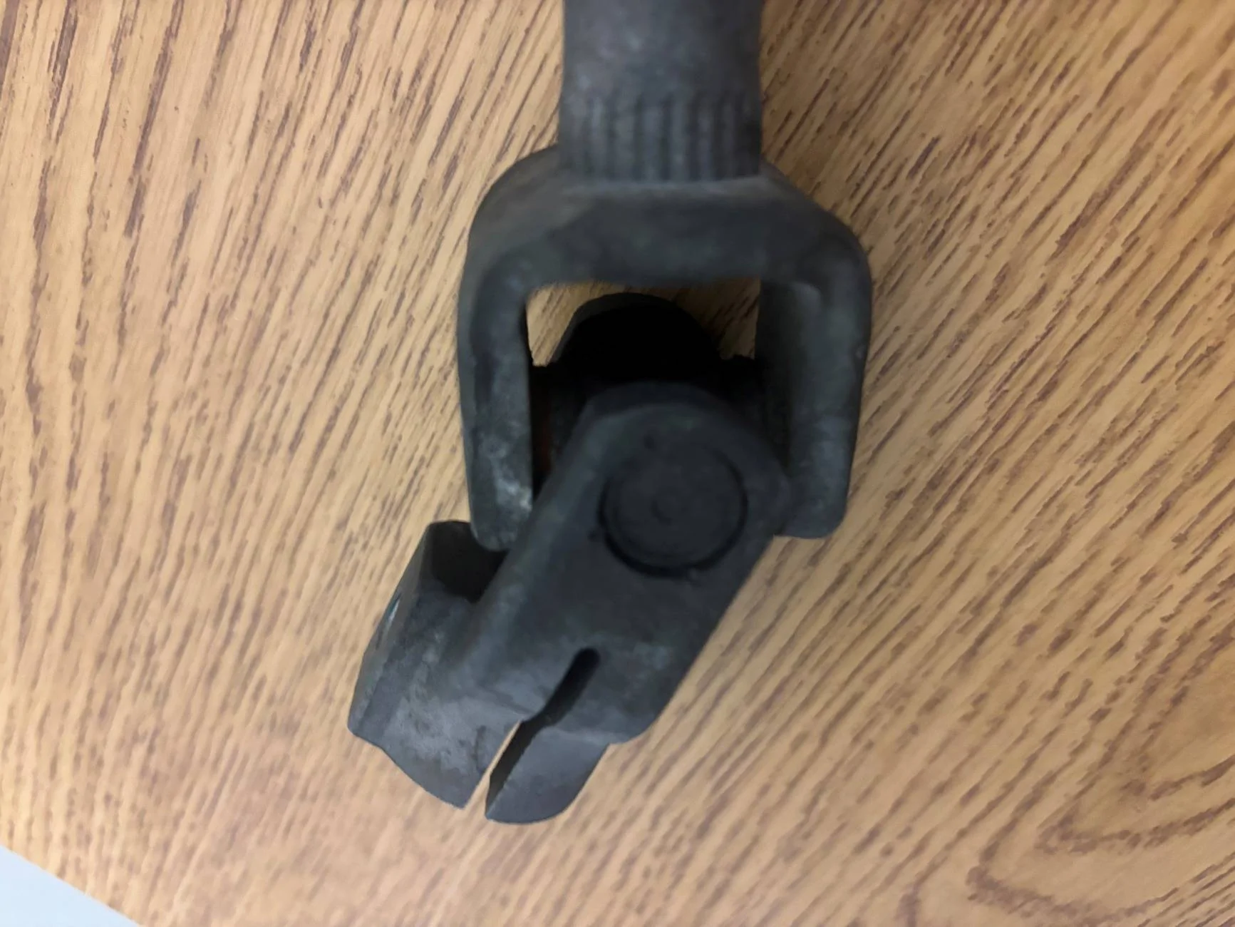

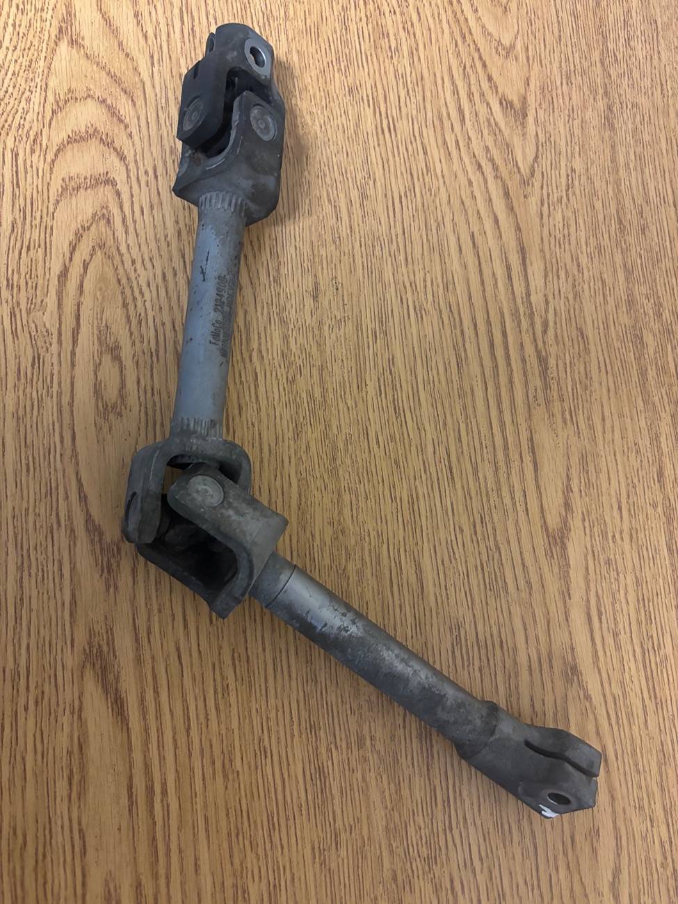

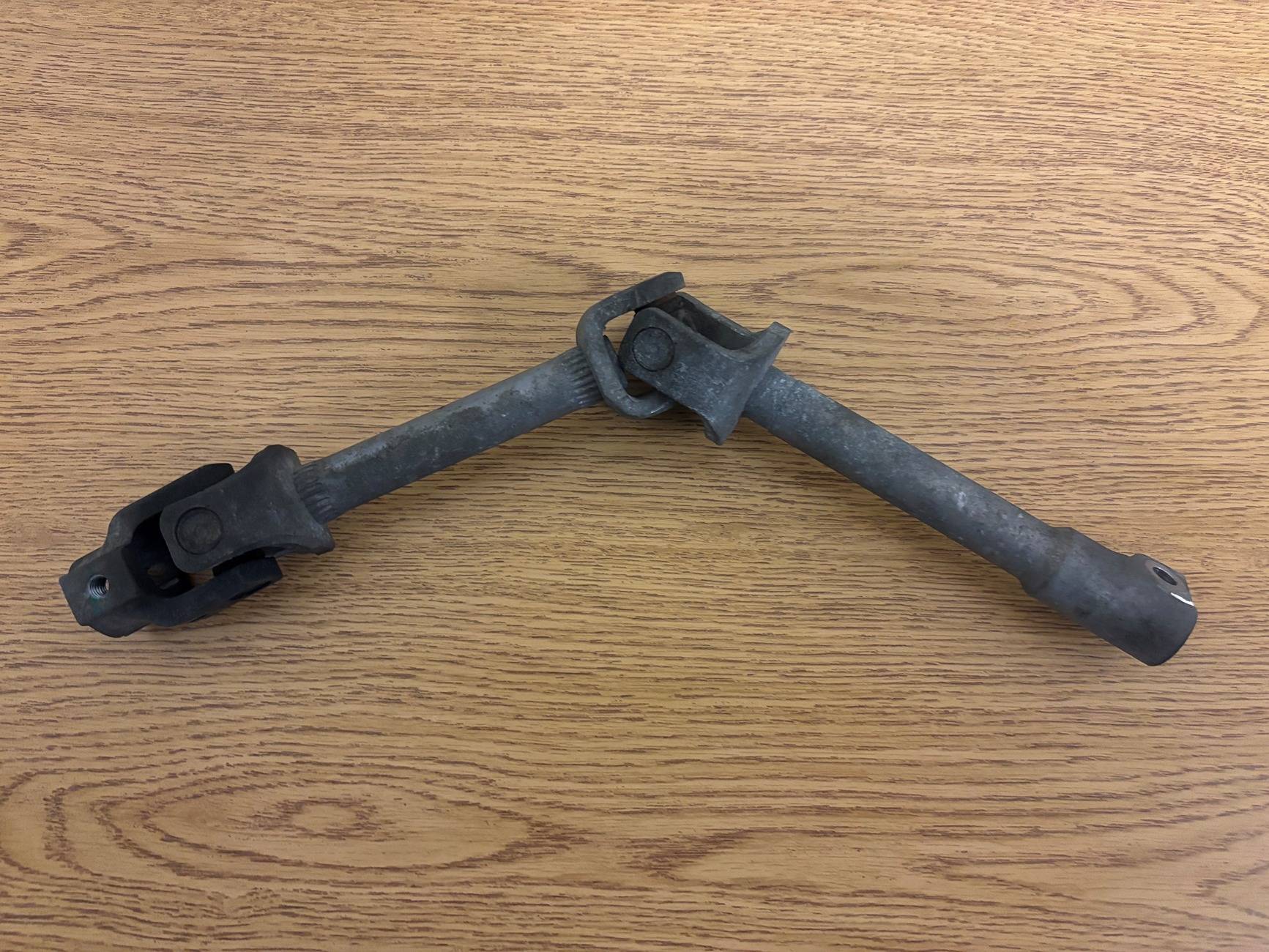

Has anyone else had to replace a steering shaft at less than 75k mi? I heard that some models had a Recall / TSB but not the '22 base I own.
Found out the hard way that it was binding up on the highway causing an inability to easily shift lanes. Glad my wife wasn't driving, it was a challenge to pull over.
Had this replaced for $500 from the shop. Glad it wasn't a rack and pinion or EPS module which would be significantly more expensive.
Hard to see but it appears that some water got into the sealed unit and caused it to seize.

2.3 or 2.7? Probably gets cooked by the turbo!
Cooked by the turbo, interesting. Wonder if moisture moving in and out from the heat contribute to accelerated corrosion
I have the 2.3L. Motor.
The other side looks lighter in color.
I was able to turn the wheel lock to lock to free up, but then the binding came back after about 15 mins on the highway.
I thought it might have been a software update so I disconnected the battery to try to reset that, but no luck.
The part was out 4 days, so I just got the bronco back.

There was no sound. In city driving no issue because I’d be turning more and loosening it up. But after about 20 minutes on the highway it wouldn’t get exercised enough and locked up.
Part was replaced and no issues. Shop said water got in and bound up the joints.
Glad it was that and not electronic issues.
