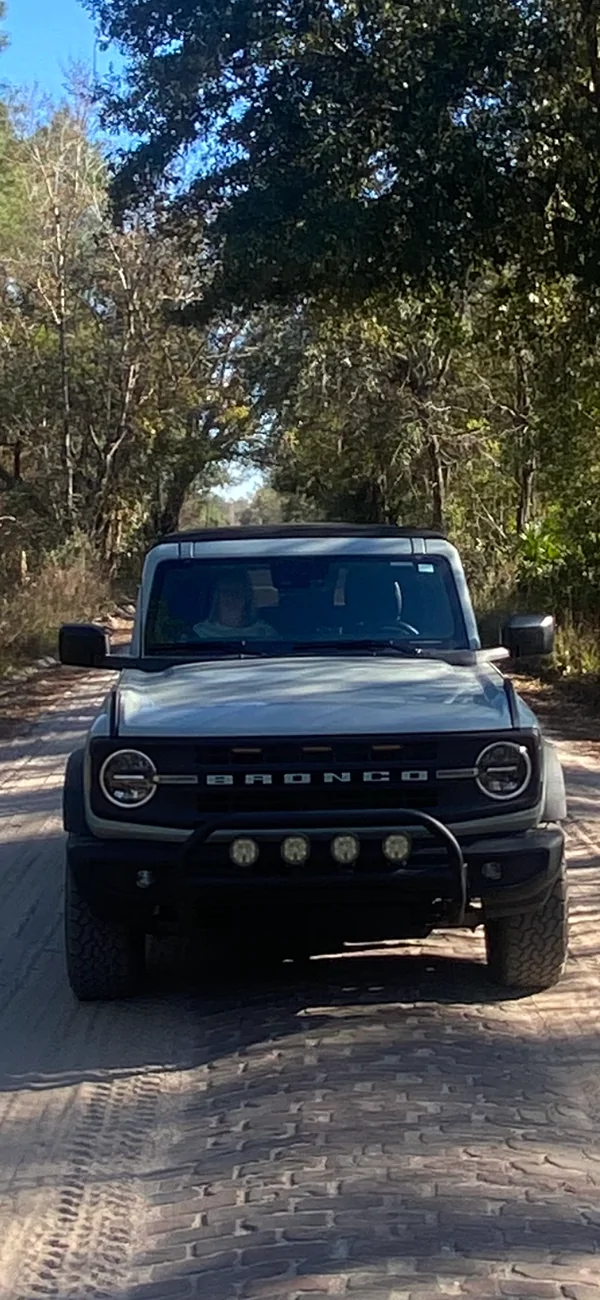

This is the best one I have right now. Might have to zoom in. Ha. The look oem tho.
https://amzn.to/4qlkjqX
There is the link to the lights I got. Doesn’t look like they are currently available, but you should be able to find something similar.

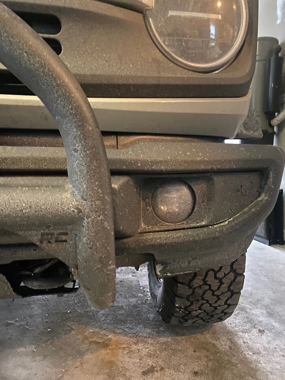

Did you buy this too. Or cut a hole in current one used the round besel.

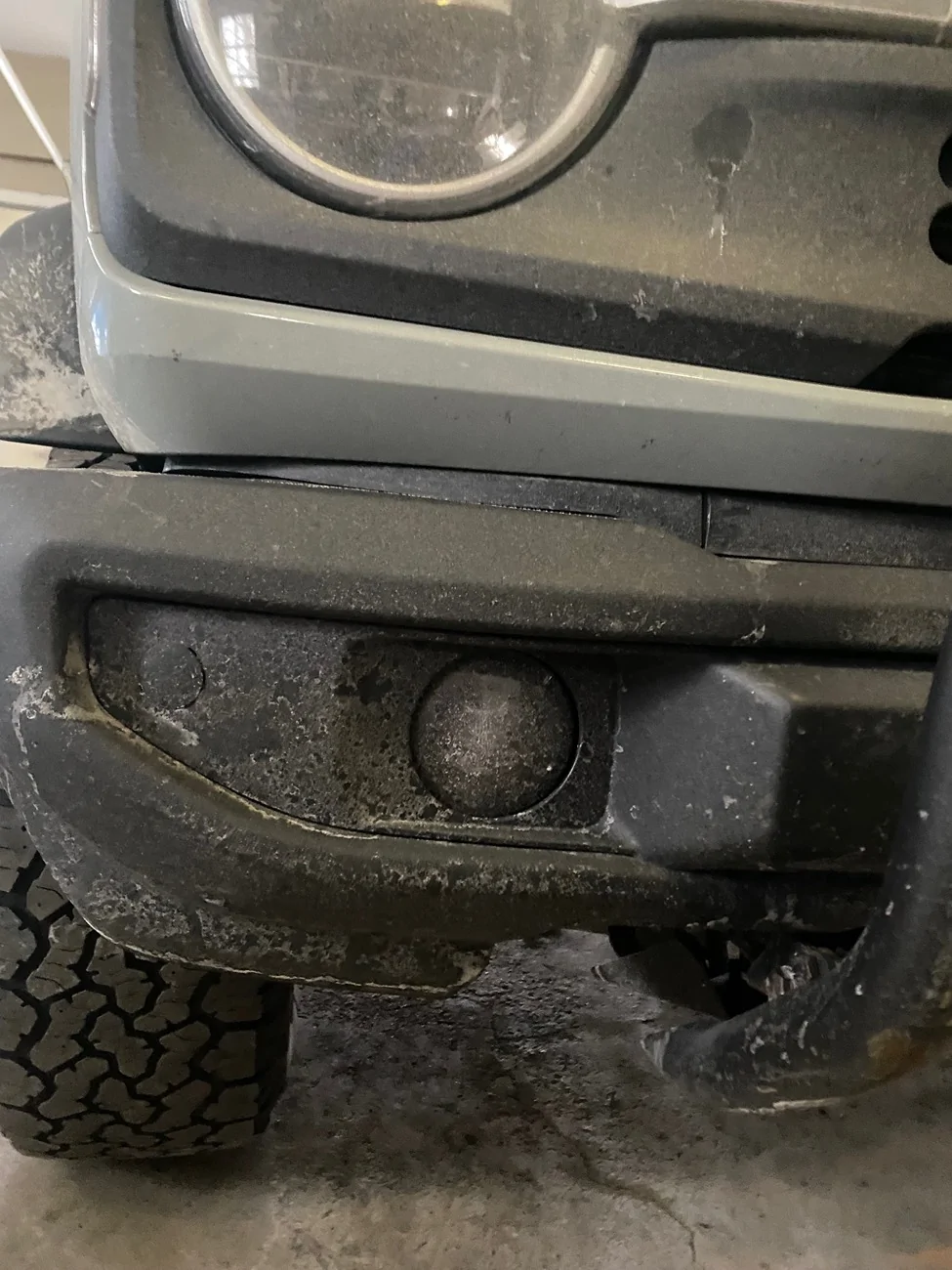

I posted just asking for some used ones on here. Just got lucky that there was a guy with some who was trail riding the same place I was camping for a weekend. I thought about cutting my originals, but was worried I wouldn’t get a clean cut.
Here are some closer pictures now. Just ignore the snow mess we have lived in for a week now.
