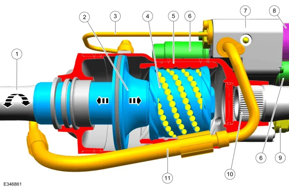

Bronco Stabilizer Bar Disconnect Operational & Service Information
Highlights
NOTE: The stabilizer bar disconnect button press information is transmitted on CAN from the SIMA to the ATCM to the CHCM, via the GWM.
NOTE: Any diagnosis of issues with the stabilizer bar disconnect button operation should include the SIMA, GWM and ATCM modules.
CHCM: The CHCM is the logic module for the front stabilizer bar disconnect system. Multiple modules/system inputs are used for the front stabilizer bar disconnect system to enable the connection and disconnection of the stabilizer bar depending on the user request or the driving mode.
