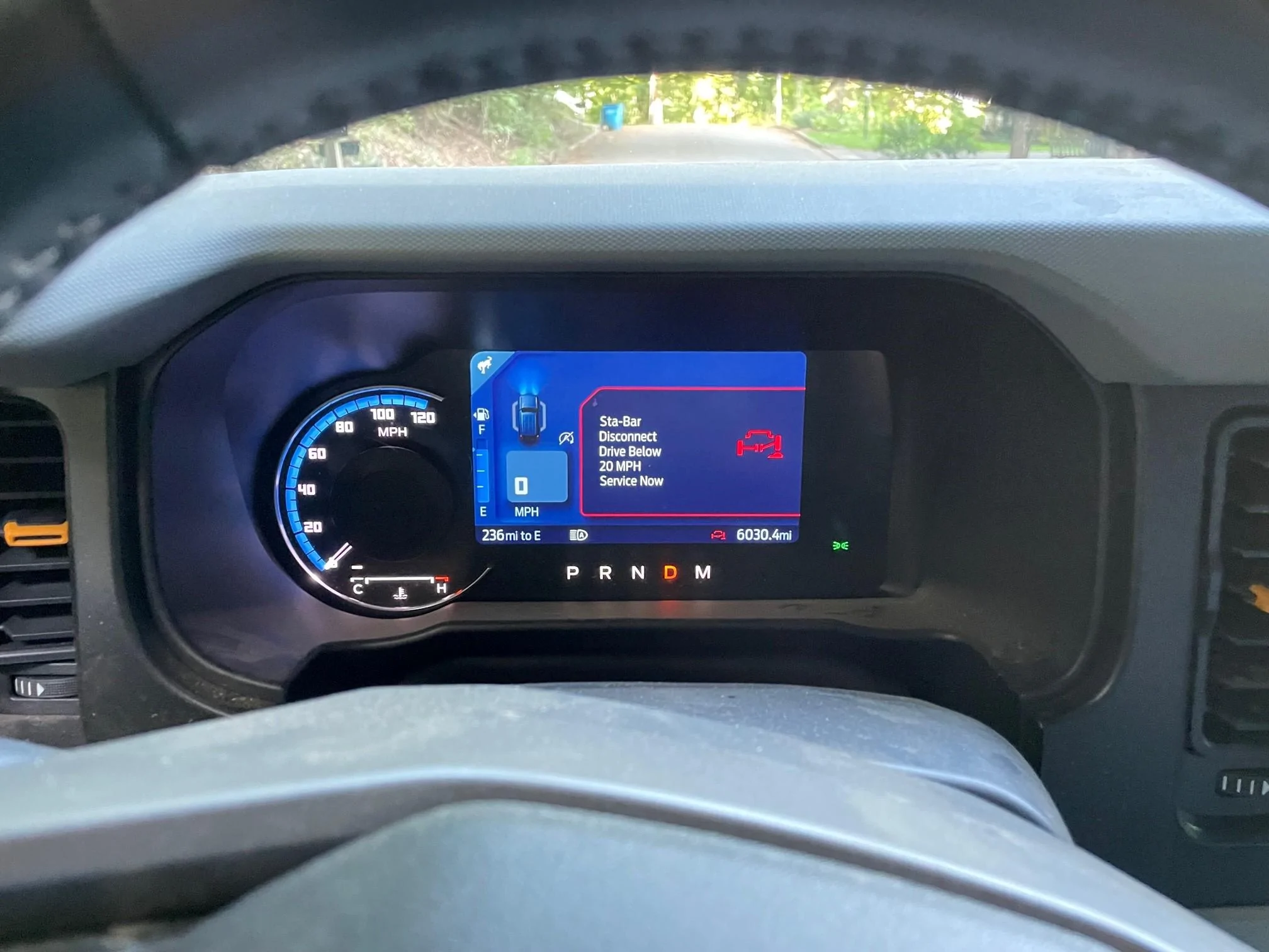

I apologize in advance if it is poor form to spam this issue. But I think I have read all the posts on this issue to no avail.
The below started popping up in early June and is still happening through this morning. Took it literally the first week of the problem and had towed to dealership. They said nothing mechanical and didn't pop up for them. Pops up totally randomly but shuts down ability to use 4wd and GOAT modes, which stinks.
Scheduled appointment where I bought Bronco. They did software update per this 8/12/22 Technical Service Bulletin: https://www.bronco6g.com/forum/attachments/tsb21-2454-pdf.378450/
Guess what. Didn't fix it and spent Labor Day Weekend in the country with no 4wd/GOAT. Any advice or suggested fixes? I really don't want to go into this Winter knowing I might lose 4wd or Slippery mode at any time when there is snow/ice on the ground.

Sucks but you are under warranty so back to the dealer. Send them a picture of the alert.

I did. Dealership has been great. Just wish there was an identifiable fix after all this time. Thanks!
