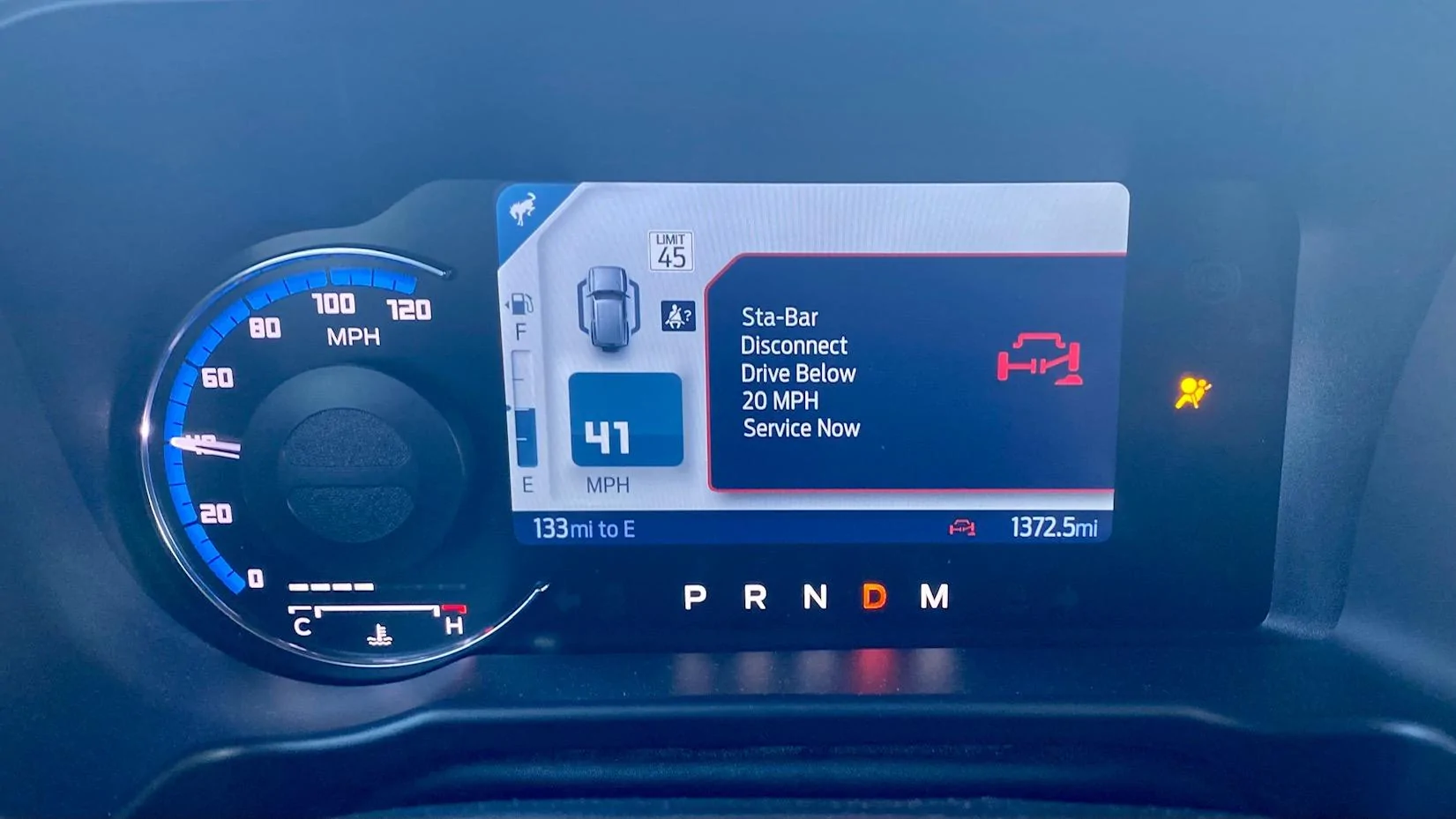

Nice. We had this pop up a couple of days ago. I just picked this up from our dealer after 1.5 days. Their internet is down and they couldn't diagnose it.
Ford Bronco Sta bar disconnect failure IMG_6694

All fine, but went out to start Thursday afternoon and the same notice screenshotted above (Sta-Bar Disconnected. Stay under 20mph. Service now) popped up and stayed up. Disabled GOAT.
After hours of calls, USAA picked up and took it to a dealership in hometown (60 miles away) that looked at it Friday (3 other dealership had no service appointments for weeks - and Ford Roadside Assistance was a nightmare, btw.) They looked at it, saw no problem. Notice didn't show up for them and then they took for drive and it popped up. I thought they addressed it but notice popped up again today. Then didn't pop up. So ?????
