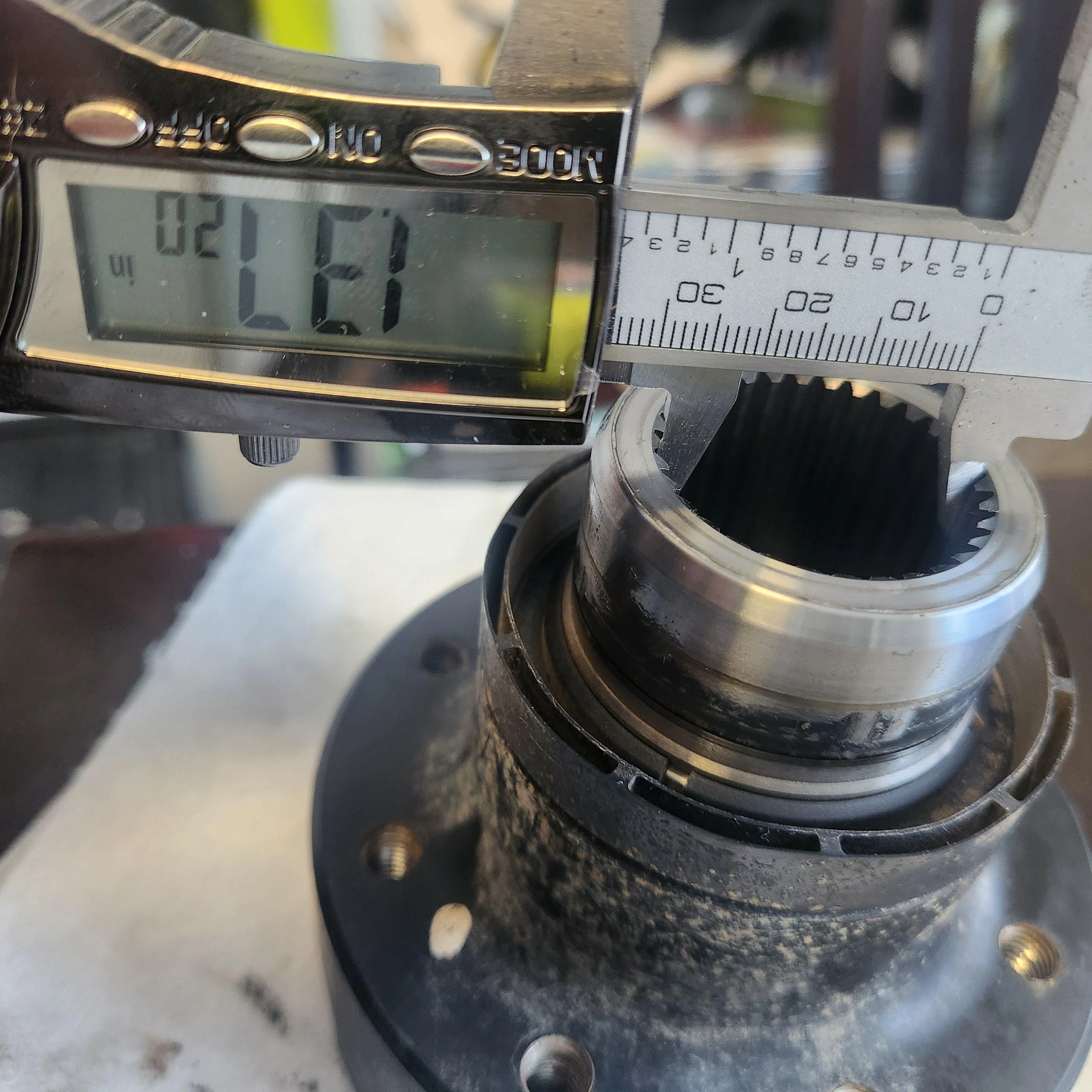

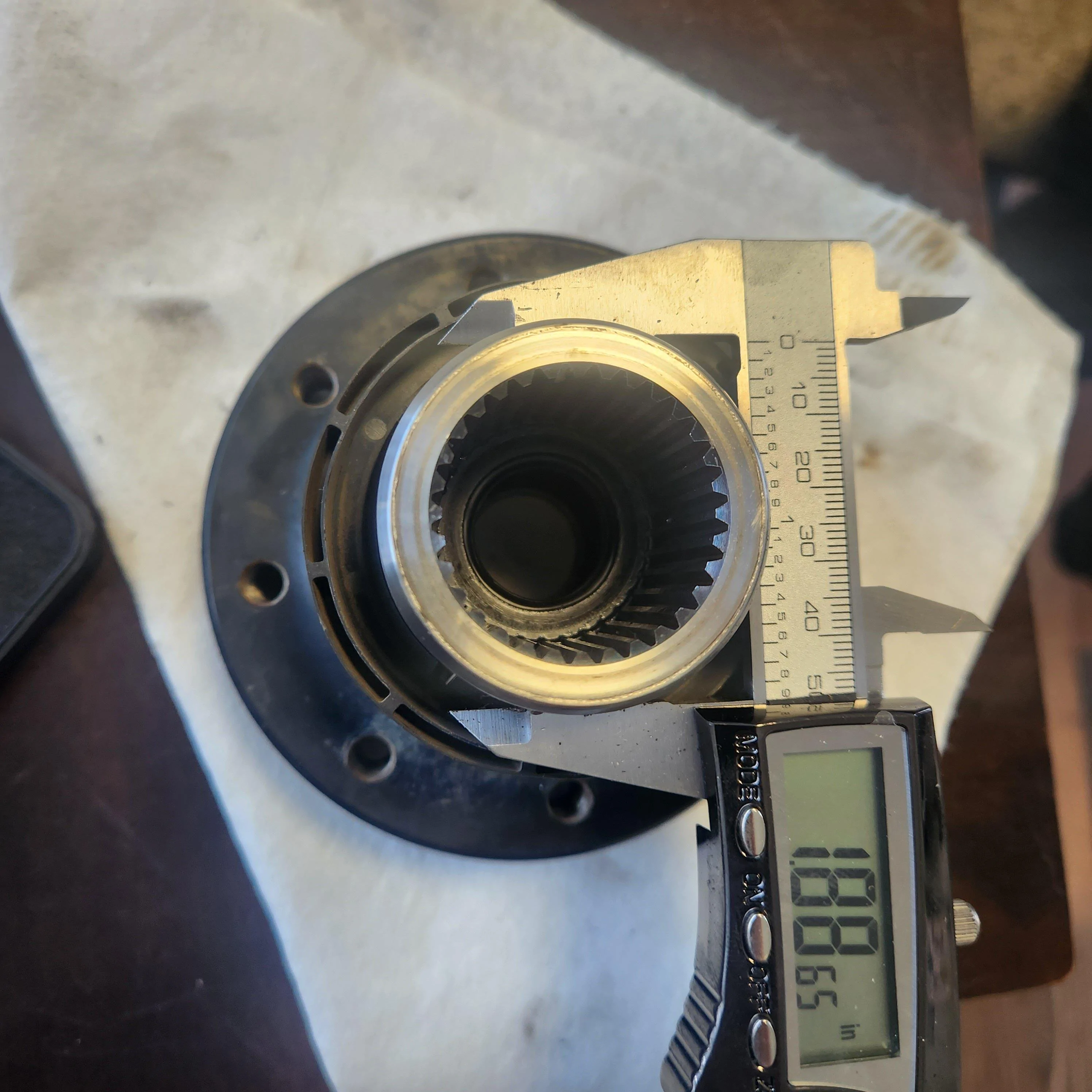

yes, that's what I'm having g built. the flange/yoke on the Bronco awd transfer case is different rhan the the normal 32 spline HD that dodge and F-series used for many years. the splines are slightly different ....the difference is the seal surface area is a different size ID. so new seal will be sourced next week when the goodies arrive. additional these flanges also have a different spline depth as well. some easy machine work will fix this.
