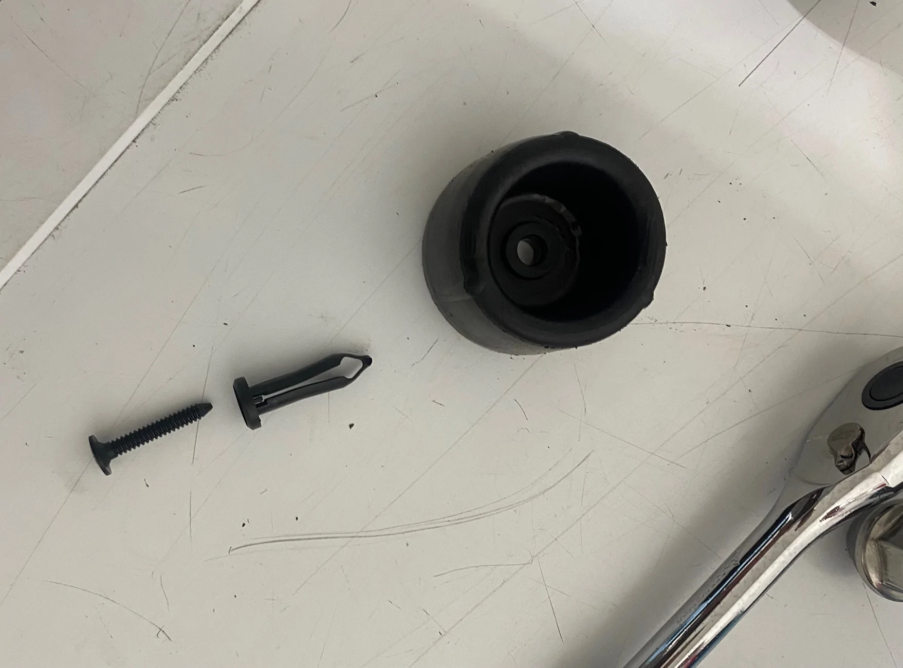

The stops are still there. Should the screws on those tighten all the way? Mine spin making me wonder if something in the tailgate is broken??
No, they don’t tighten all the way. They never snug up. They just push out the grabby part of a plastic grommet when all the way in. You can actually just thumb-push them in and skip the screwdriver. Same result.
Thank you, that helps as well.
