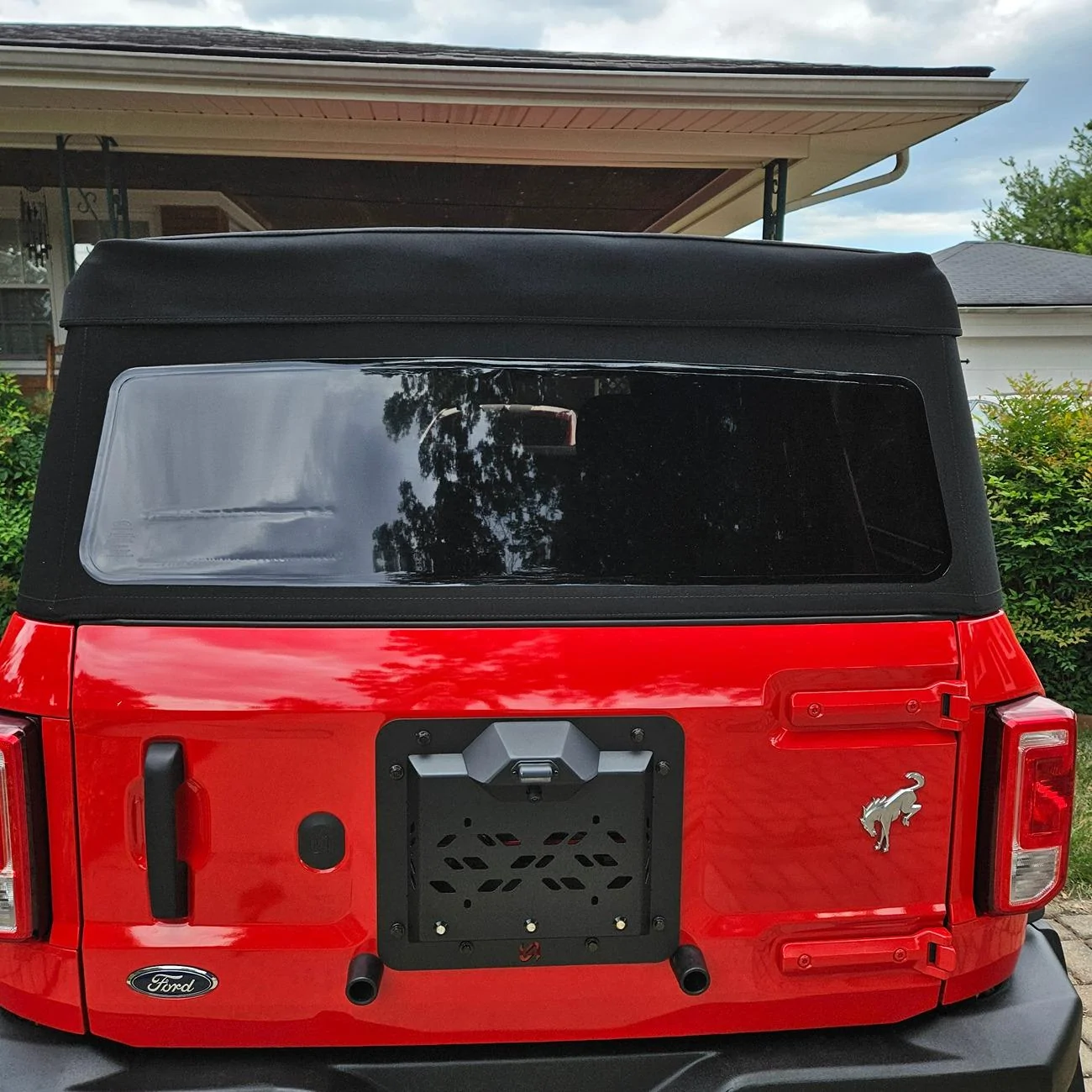

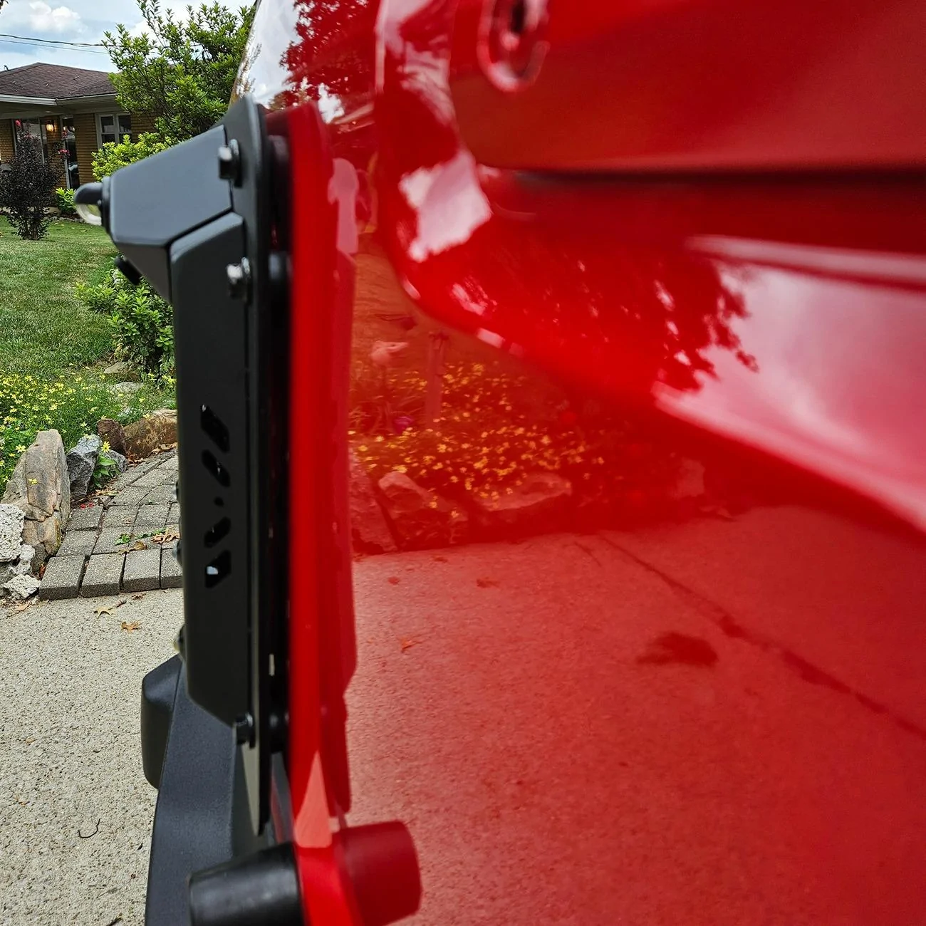

I bought the kit and installed only to find out that I have a five-pin rear camera connector which apparantly is a lot larger. I called Turn Offroad and they said that they were working on a new prototype for the correct fit. Well that was a month ago and as of now there is no progress. I was told that I could modify the harness connector to allow clearance. I modified the connector and put the tire delete back on but I still had a half inch gap all around the delete bracket. So I odered Eight 1/2 x 3/8 x 1/2 thick rubber spacers that I attached with the eight bolts around the spare tire delete. I hope this helps anyone that wants to go through the PITA.

2023 Bronco Base. I used these spacers,
Fabbay Multi Purpose Rubber Spacer 1 OD x 3/8 ID x 1/2 Inch Thickness Black Round Rubber Washers Anti Vibration Bushings Spacers Washers for Home and Car Accessories(8 Pcs)
