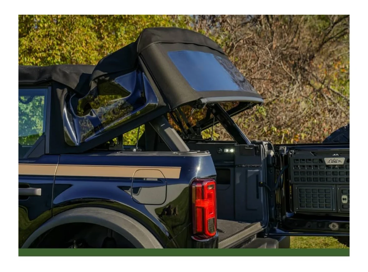

Since I installed a strut kit to lift the rear window assembly, I’ve had one hell of a time buckling the four top clips when reinstalling it after having the rear window out. It’s even hard now to buckle the tops of the side windows also.
It’s like the struts are the cause, keeping tension on the window assembly. I need an extra hand to hold down on the rear roof bar while trying to buckle the clips.
I’m wondering if folding the roof back would take that pressure off. Anyone have this issue and have you found a way to fix it?

The kit includes two struts and hardware that once installed, will lift and hold your rear window assembly up to help with loading the cargo area. The factory prop rod can be removed. Has nothing to do with the side windows.
