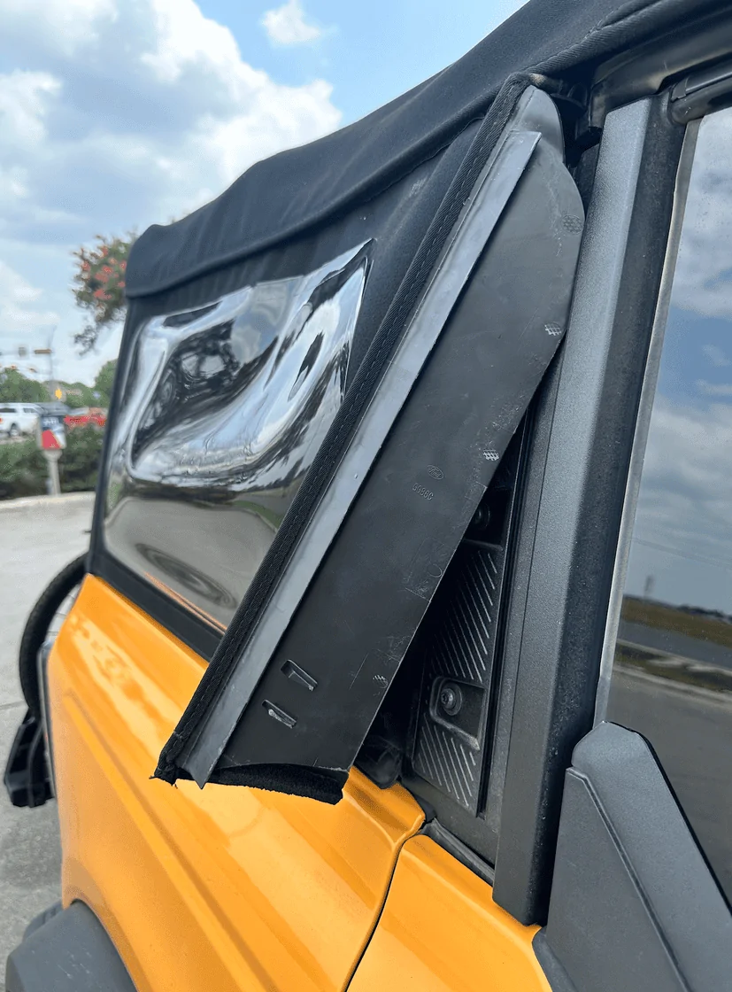

No issue with the passenger side. I keep looking out my mirror and seeing the edge start to curl (thankfully it's only popped on the highway once). I've readjusted and taken the window out, but wondering if folks have any sort of workaround/fix for this issue (or if it's a warranty issue).

Wow, mine are so tight I can barely even get them in, but I've wondered if/when this might happen. I don't like the design at all...I figure some 200 mph black tape will work if need be....

Mine did that too. I ended up pulling the top velcro tighter, along the window to snug everything up.

Came looking for anyone else with this. My passenger side keeps doing it.
Looking at the photo I'm now not sure if that bottom tab is broke or not.. I don't remember noticing it in person. Will have to check again.
Anyone know if it's possible to buy just that one panel? And given the oem nature, how many thousands of dollars it is?
