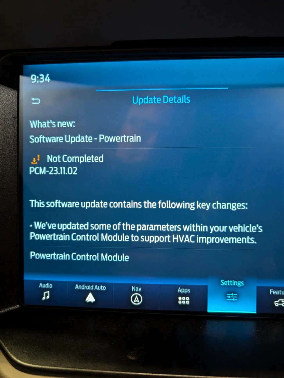

Software update error message on PCM-23.11.02 - Not Completed

I fell like I'm giving Ford too much credit to know anyone has the Performance Tune installed and preventing the PCM OTA update. Is this something you constantly have to monitor and check your ProCal to see if your tune is still installed? Or better to just turn off OTA?
Personally, I have auto updates turned off for this same reason. My Ford's are both tuned with Livernois and I know with them, it is very easy to get an updated tune with the new PCM strategy after an update.
In the case of the Ford ProCal tunes, I have been curious to see how they handle this.
@Ducati1098 What did the OTA dashboard show as the reason the OTA failed?

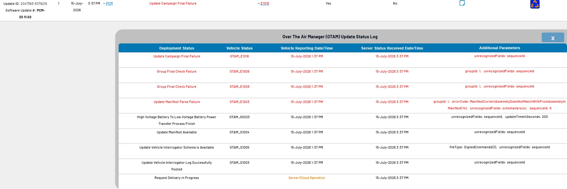

Manifest Current Assembly Does Not Match With From Assembly In Manifest"
Which to me sounds like it may know the calibration isn't factory..?

@rugedraw It's failed it 28 times now, but in the middle of all those, it did the GWM update perfectly fine
A manifest mismatch is a back-end server issue. I don't think the tune is causing it to fail. When this happens, the GWM module is doing its job and preventing the server from sending file(s) that don't line up with what the vehicle should be getting. Or, the manifest itself is corrupted or wrong. Either way, it's a server issue. There is nothing you can do but use FDRS to apply it or continue to wait for Ford to get their shit together and fix it. I'd be curious to see if others are having the same issue with this OTA. Usually these things are not vehicle specific and OTAs start failing left and right for everyone.

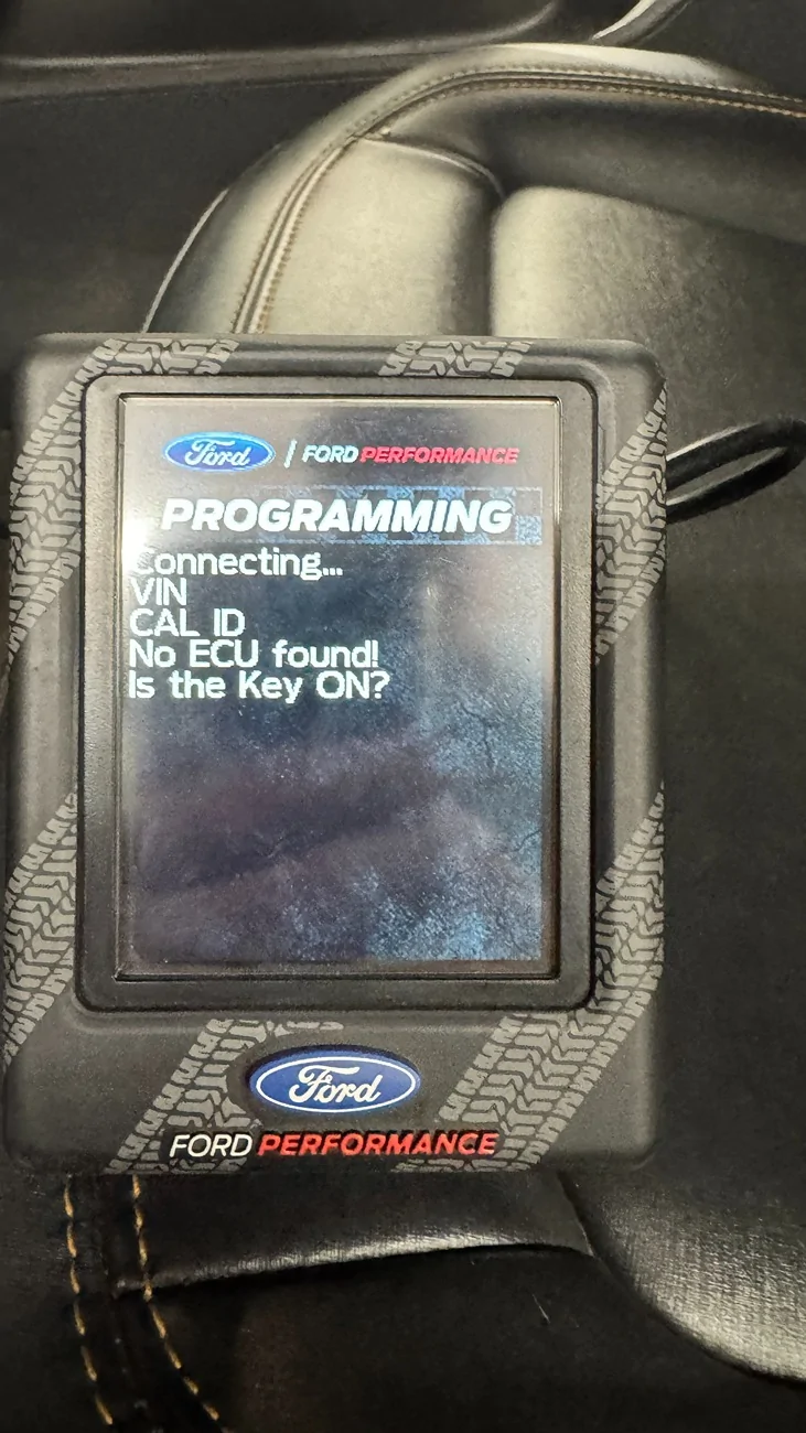

This is a heads up for anyone like me that did the procal tune a while ago and haven't touched it since. I don't have this exact issue, I'm in a different Procal limbo state. I'm a couple months without resolution, my Procal can't re-program my Bronco. Ford Performance tech was helping, but nothing for a month. They did something with the stock .bin files, an engineer was supposed to do something else, no clue at this point. I had an ASE shop where I bought the Procal, they installed the tune in 2024, this is what I got when I tried to go back to stock this May. I immediately called tech support, I didn't want to mess up anything worse.
What I was told by Ford Performance tech support, you must disable auto updates, remove the Procal tune before updating and also before taking to a dealer in case they do an update. Something about updates changing IDs and creating a mismatch to the Procal. But who knows, I'm still in limbo.
