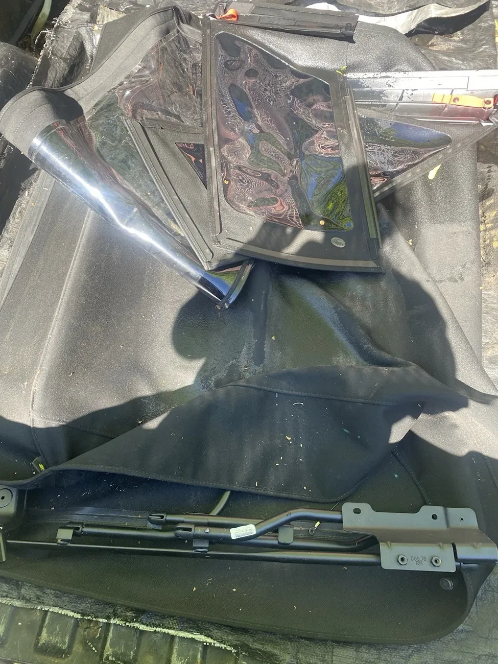

SOFT TOP CONVERSION- what do I need by looking at this picture?
ryanc721
Ryan
May 8, 2026
34
NJ
2026 Big Bend Sasquatch
Bought a soft top for $450 off ebay- what a steal. Im coming from a jeep so I know i need some extra stuff. Whats missing from these pictures that im going to need? THANKS EVERYONE!
Ford Bronco SOFT TOP CONVERSION- what do I need by looking at this picture? s-l1600 (1)
Ford Bronco SOFT TOP CONVERSION- what do I need by looking at this picture? s-l1600 (2)

That looks like the optional BesTop version to me…

Okay so what do I need to make this work?

The listing was “OEM Bronco top- less than a year old”

As others have said that’s a Bestop model not the Webasto OEM soft top

As others have mentioned its not OEM its Bestop, go to the best top site and look at their installation instructions it will show you how to get it on and if you are missing any pieces . Or go back to the person you bought it from and get your money back if you can.

I actually went on eBay and cancelled the sale and put reason “not OEM.” I appreciate all of you. In the process of getting an OEM one now.

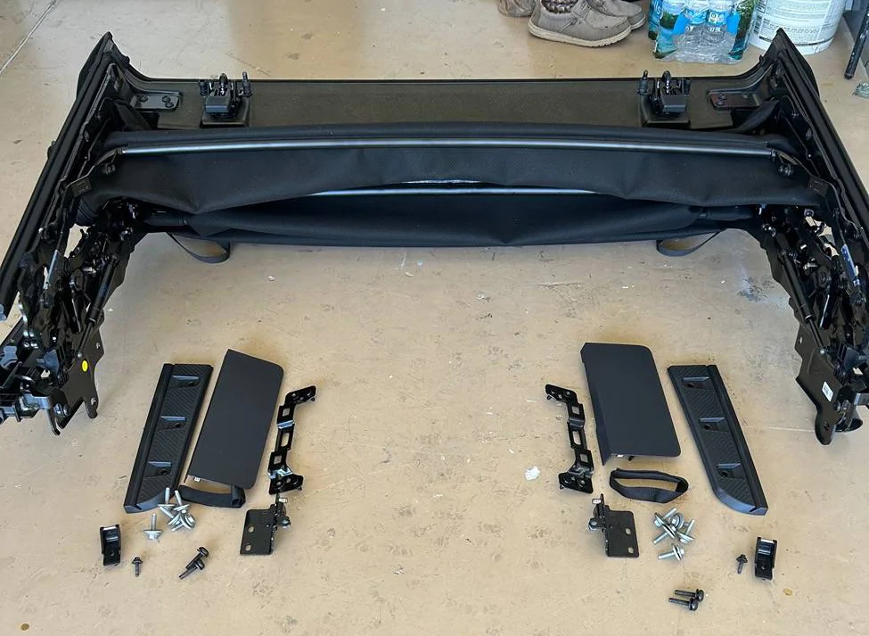

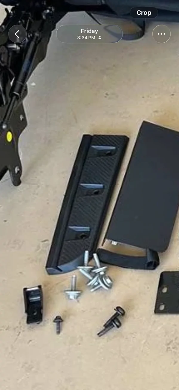

Here is a photo of a complete soft top setup, this is what I used when I bought my soft top to swap over for the summer. Big thing I missed is the side plastic pieces, I didn’t look closely at them and thought the ones on my Bronco were the same, they were not.
Ford Bronco SOFT TOP CONVERSION- what do I need by looking at this picture? IMG_0120
Ford Bronco SOFT TOP CONVERSION- what do I need by looking at this picture? IMG_1686
