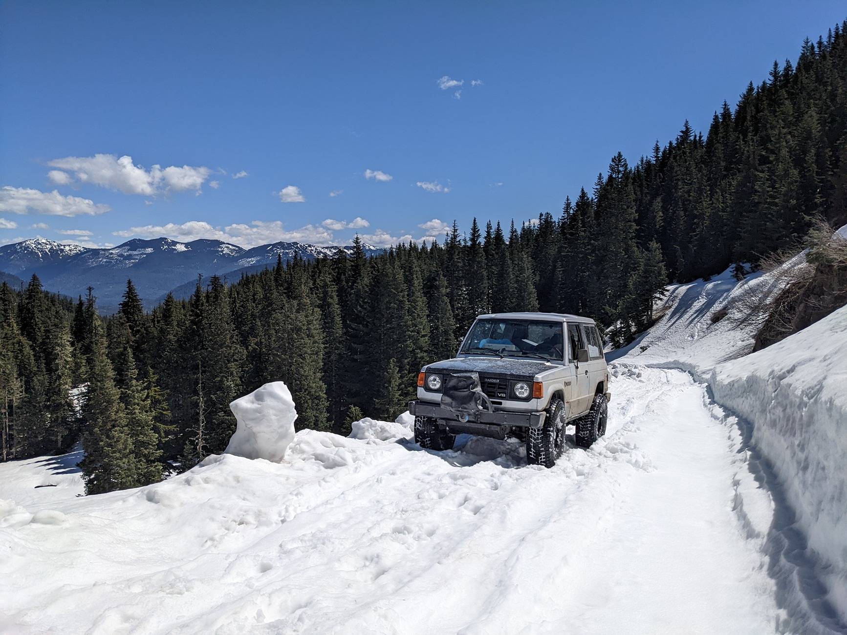

I think this is what you're looking for.
There's been a number of times where I've been on the same trails/roads as them. If a trail has had significant snowmobile use (which packs the snow) it is often fairly easy to drive. Also, a few snowmobilers will run the roads that I use during the winter. That is, roads that are not officially closed to wheeled vehicles, but that most wheeled vehicles avoid due to the 1 to 10 feet of snow. 😁 I had a snowmobile once, but I just prefer snow-wheeling. I like not needing to trailer my rig to the snow, and the challenge is fun too.
Note: I follow the rules carefully. I don't run dedicated snowmobile routes during snowmobile season. But I will run them before and after snowmobile season. The picture shows a groomed snowmobile route in mid May 2022 (well after snowmobile season).

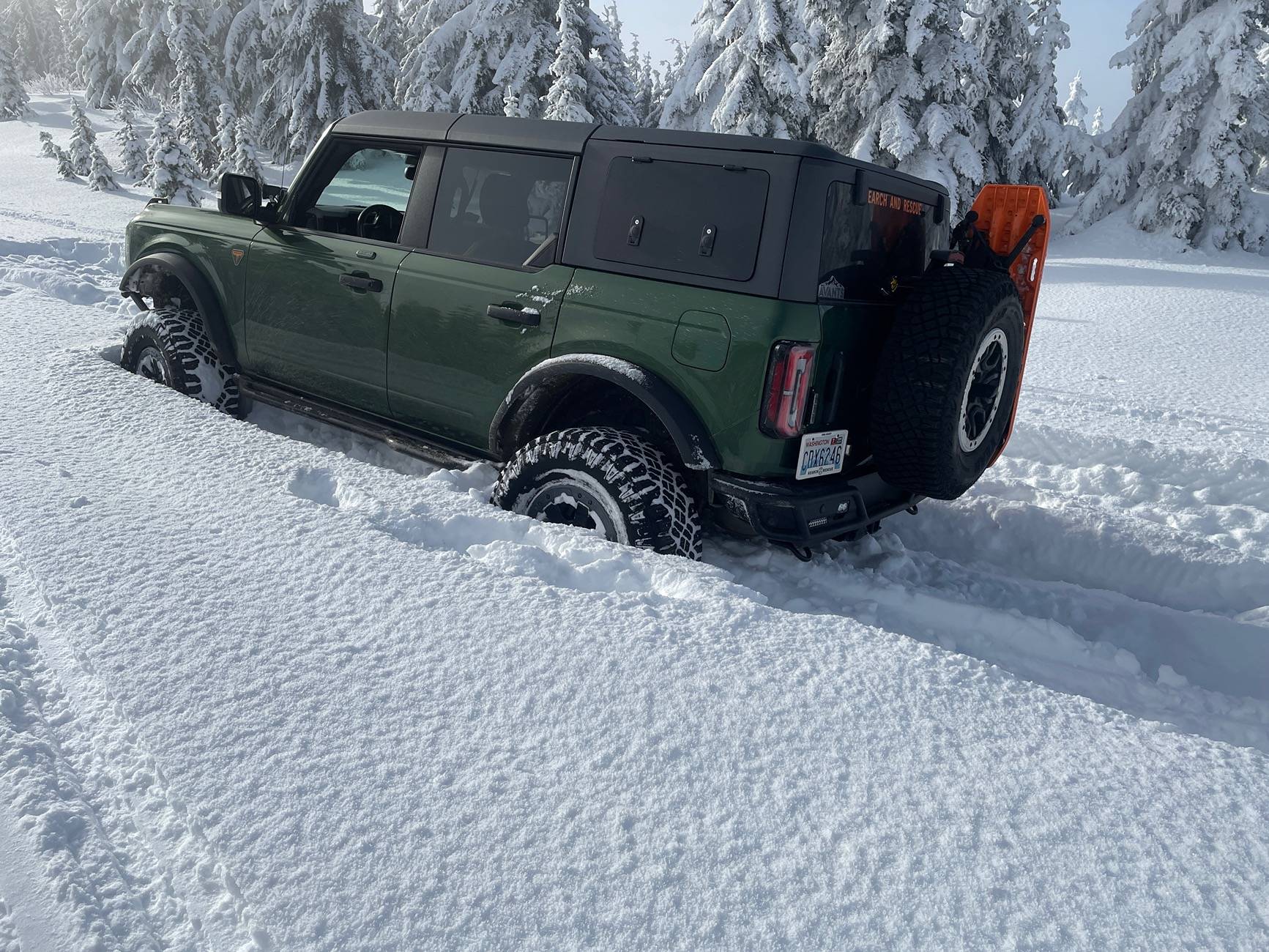

Last winter I had no problem going through some fairly deep snow, but did get it high centered on a packed drift at the end of my drive. It rode up on the skid plate until the weight flattened it down. Easy to dig out, but I’ll be more careful around drifts.
Stock Sas with the stock tires and skid plates.

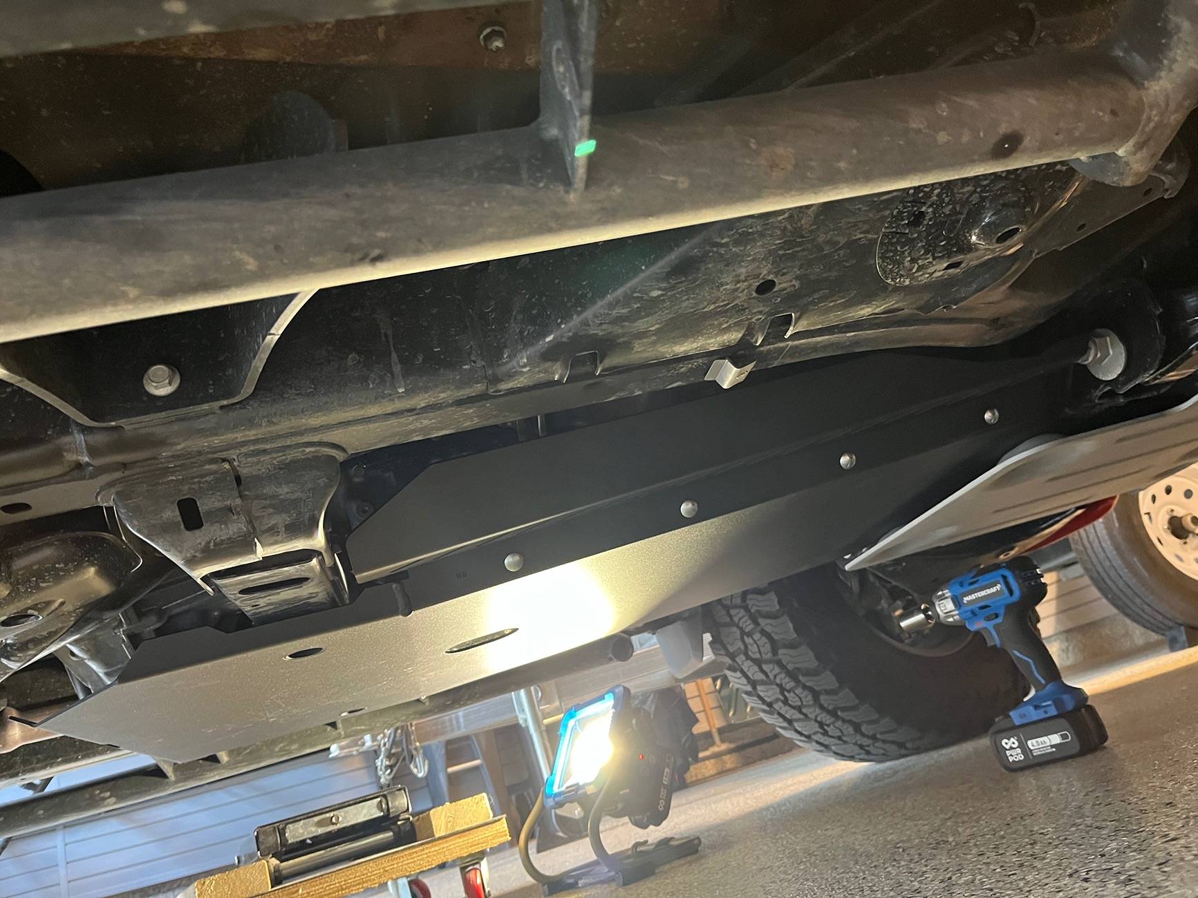

Hi Roger, glad to see your considering a bronco. As far as I am aware the Next Venture motor sports plates are the only ones with UHMW. They have some contour to them but do provide excellent coverage. and give a nice slippery surface. I went with ARB for mine but they are far from the most slippery in the snow. ( my priority was cost, and keeping the plates up high for max clearance.
Excited to see what you do with your Bronco, I love seeing your raider out on the trails.
The bronco does well in the cascade concrete we get most of the time. it does start to dig a bit faster then some of the other rigs I wheel with but it holds its own. loose snow under crust is where I run into the most issue, when you break through a freeze thaw layer into dry layers below you really start to notice the weight of the bronco. I have had good luck at 5-7 PSI.

Thanks, I really appreciate your Input. It's nice to get a relevant response including pros and cons. That picture looks like an excellent day! I'm guessing you were around 4500 feet there. Nice going.
Good Guess, right around ~5300 feet there, and it was a very good day.
