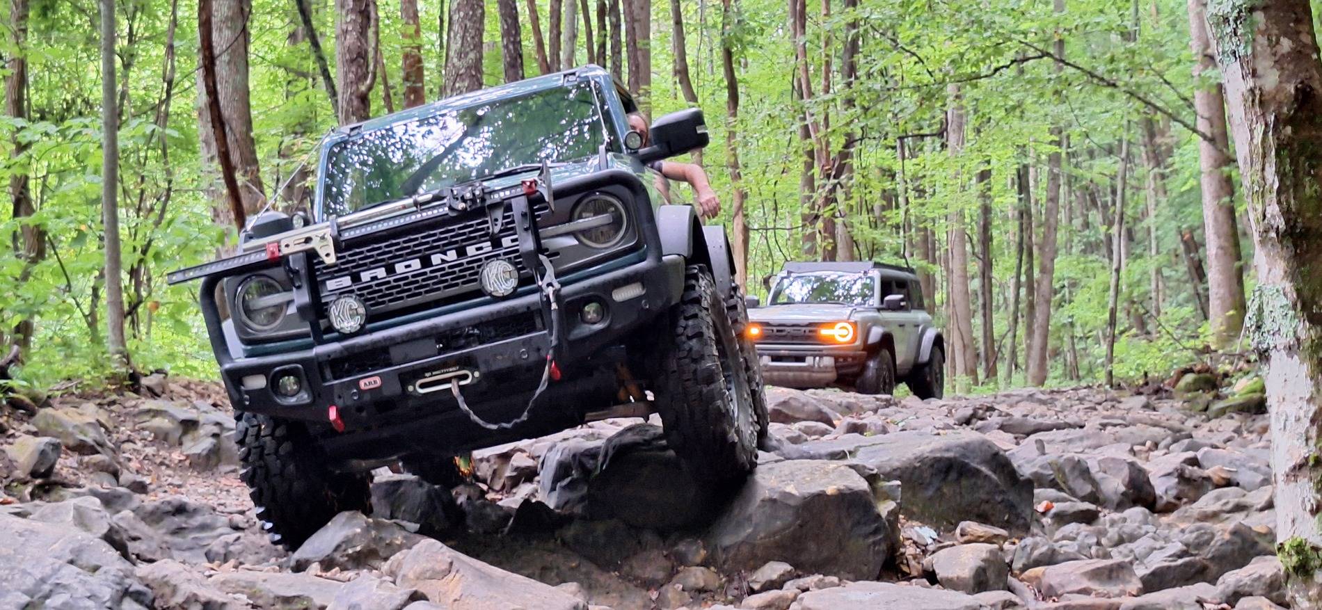

When you say "light but nothing over a 5", do you mean like this (see slide 4)?
https://docs.google.com/presentatio...SukYyA/edit?pli=1#slide=id.g2ec405a0f7d_0_101
Because very much, if you're in those conditions, you want full skid plates and rock rails.
So we're already at an impasse on terminology (I would consider light maybe moderate fire and forest roads that are maintained but not perfect). From advising-a-stranger-on-the-internet POV, I'd say risk is high I miss what you're actually doing, so I'd say get full plates and rock sliders, just to be safe. It's just hard to say because there's a lot of variable terrain and experience.
So if I were to dial that back a little bit, seeing as you don't think it's very hard, I'd say the Ford stock plates w/gas plate skid and the trail armor rock rails that come stock on the Badlands. I'd look for some takeoffs perhaps, although you won't get the gas tank most likely. But they're light and do a decent job if you're not going crazy on the Maze or whatever.
From a minimum, gas tank and rock rails. Then preferably front and engine skid that are steel. A boulder or step could take out transfer case, so if you're doing those, consider that as well.
So yeah, you're a prime case for the stock armor, and you can leave the plates sans front plate and gas tank skid off when you don't need them. They are pretty easy to put on/off and aren't very heavy.
Looking at that rock garden the mod'd jeep is tackling looks more than "moderate" but im not a rock crawler...
