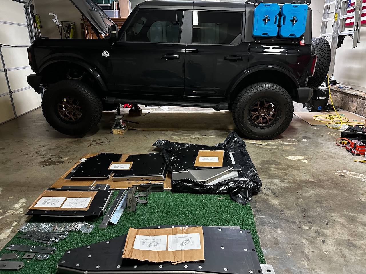

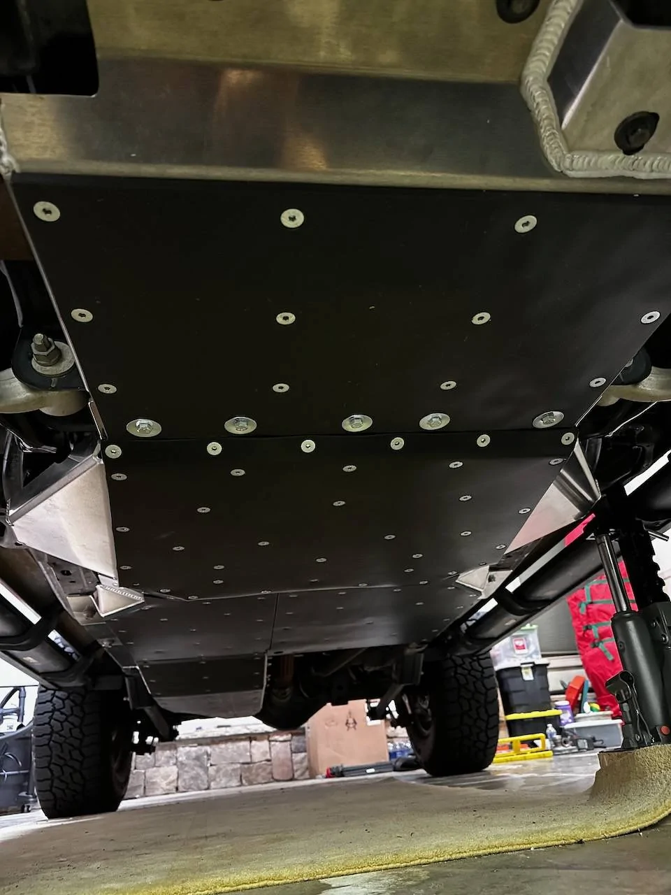

Fuel tank - fuel tank, def fuel tank. If you're not doing trails with biggish embedded rocks / boulders you likely aren't going to hit that front skid plate at all. But you got the OEM one so it's fine. Tranny pan is also plastic and although it's elevated in comparison with other things, it's vulnerable to sticks. Really. But if you're going light, you can replace the pan rather than use a skid. user's choice. I covered most of my underside (steel) as where I live trails are all rocks.
As for corrosion, aluminum, steel, et cetera, your use case seem support aluminum. Less weight and strong enough for occasional bumps. Corrosion is out the door then. If you do use powder coated steel, it's gunna get gouged anyways down to bare metal. And when it does, rubberized undercoating spray it or I personally use krylon fusion all in one textured matte black. Looks identical black textured powder coat. Just shot some on the bottom this past sunday actuall.y
